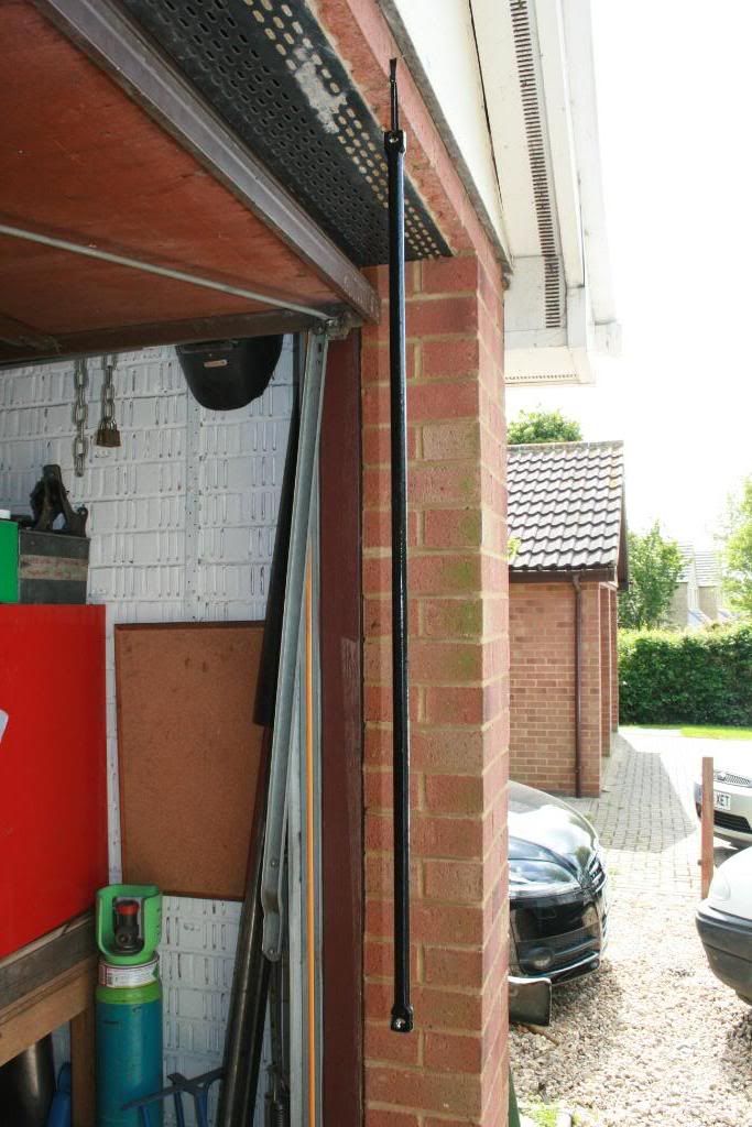

I checked clearance when i constructed it and it looked fine but all will tell in time lol
Hope so for your sake. So you have offered the beam up into position?
Oh yes
I thought the same as Craig tbh but then looked at some pictures of my beam in situ etc and deduced it should all be fine - not that you wouldn't have checked anyway!! lol
I havent looked at mine with a tape measure & thought aah... But I just recall how flat the beam sits when the car is lowered a significant amount.

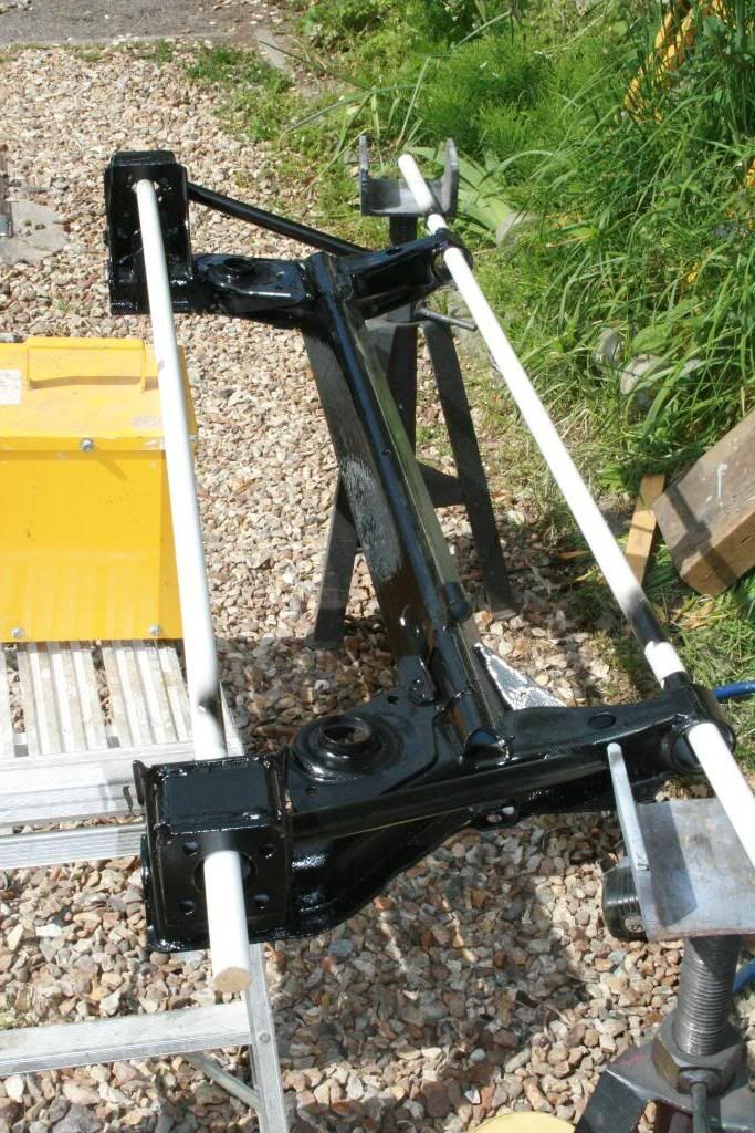

I finished off the axle and gave it a lick of paint (i also ordered up some 100mm alen key head 12.9 bolts to hold the hubs on)

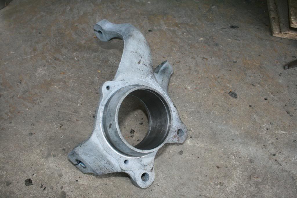

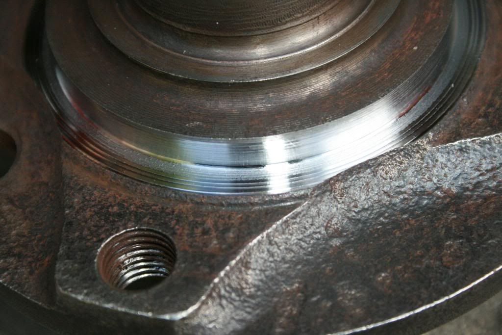

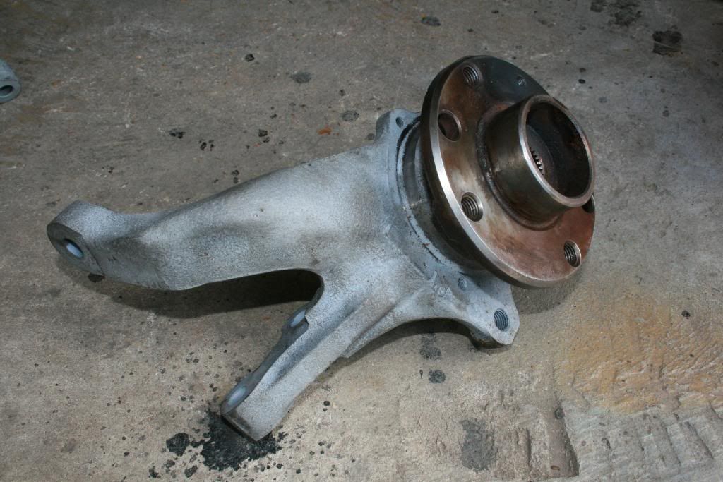

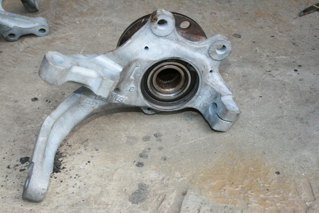

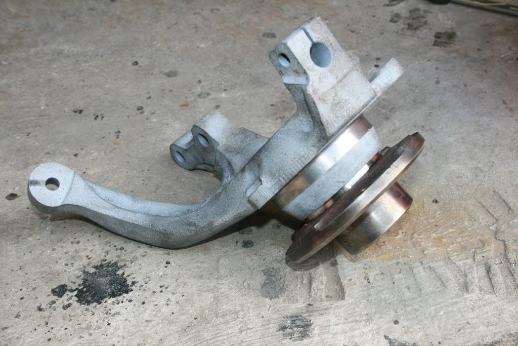

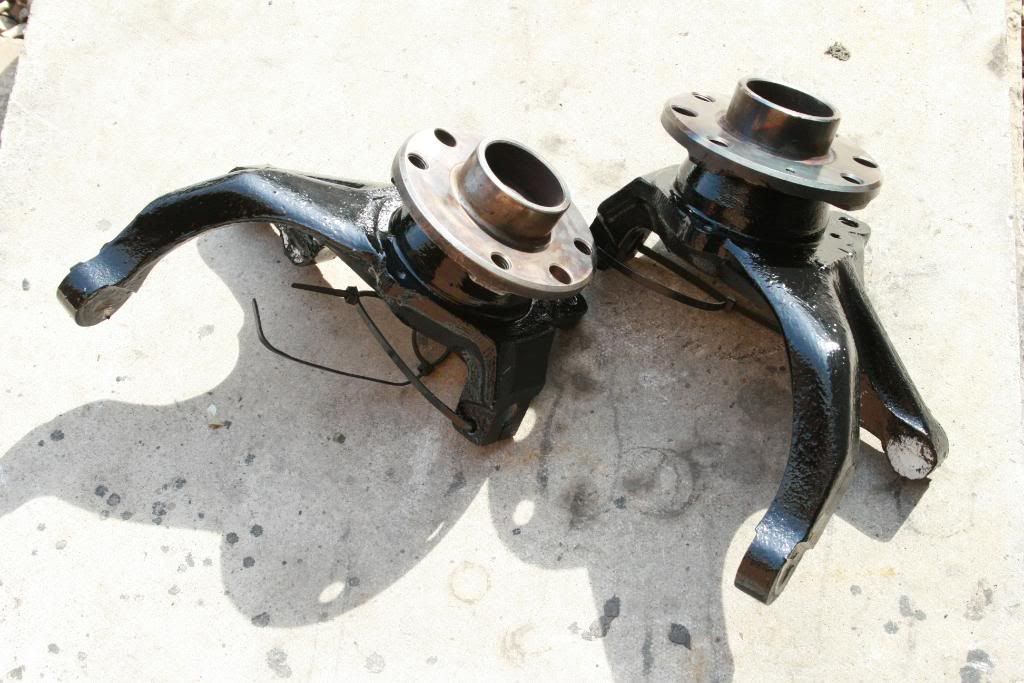

Then on to the front hub carriers that i got back from the machine shop on friday - what can i say they have done a top job at a very reasonable price including remachining the circlip grooves and were very friendly. They are callled Earth Tech Ltd and are contactable on 01525 374362.
http://i248.photobucket.com/albums/g...tsypics003.jpg
http://i248.photobucket.com/albums/g...tsypics004.jpg

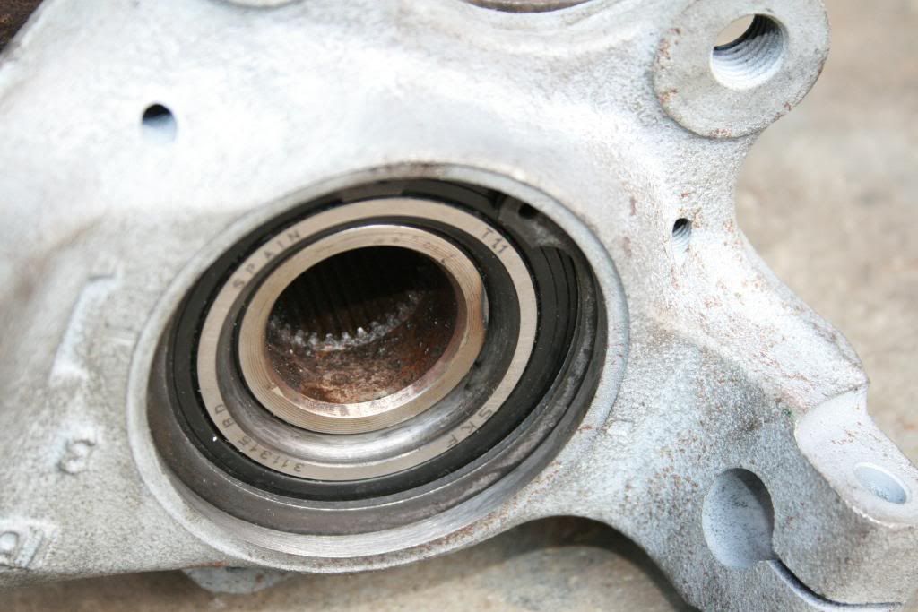

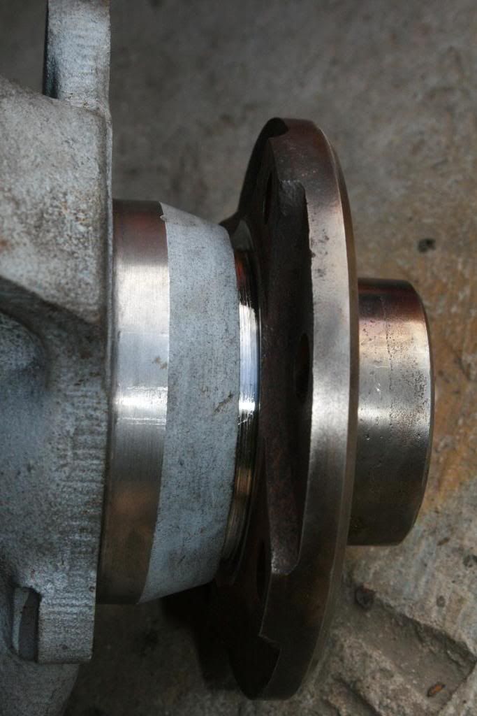

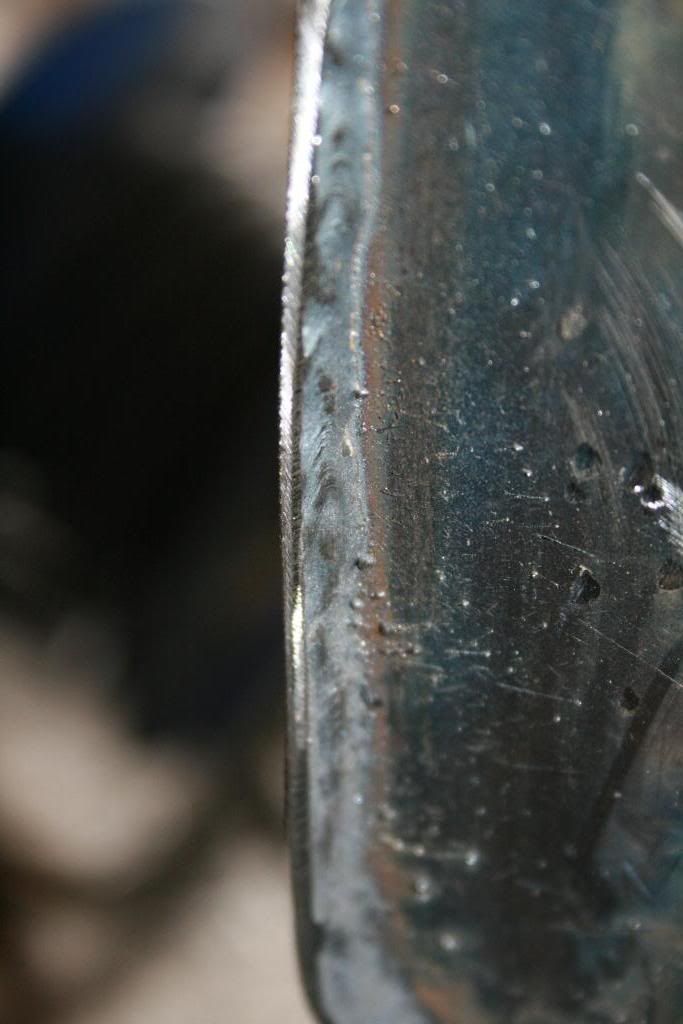

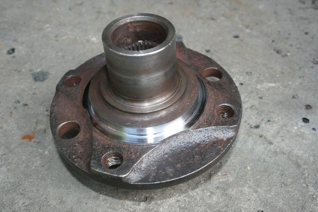

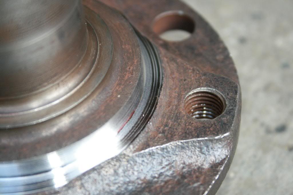

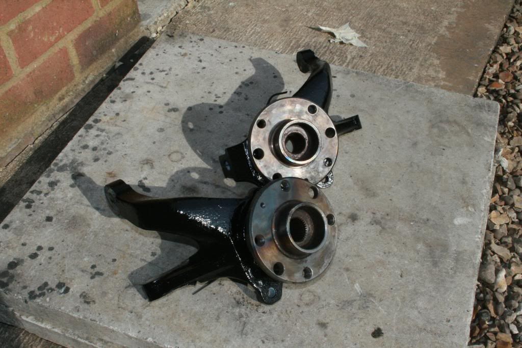

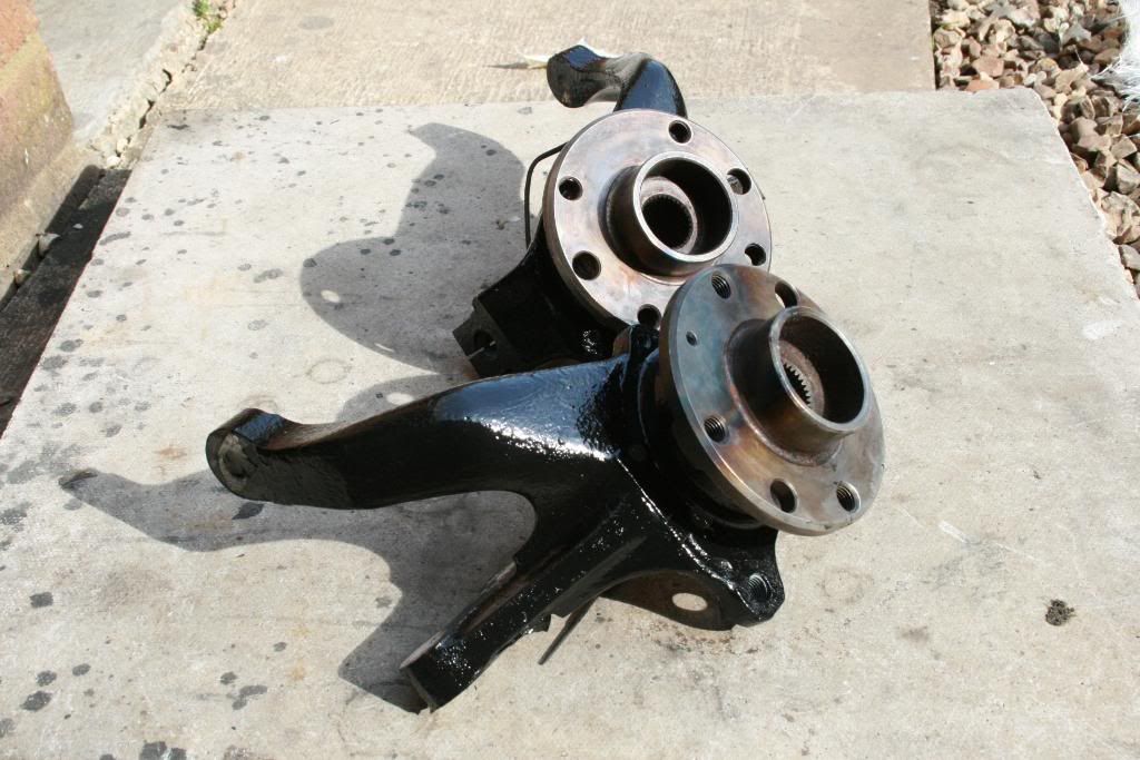

Once i had the hub carriers back i could lathe the small amount of material of the big block hubs myself so the would fit in to the hub carrier as so
http://i248.photobucket.com/albums/g...tsypics008.jpg
http://i248.photobucket.com/albums/g...tsypics006.jpg
http://i248.photobucket.com/albums/g...tsypics007.jpg
The shiney freshly lathed area would have fouled the hubcarrier as you can see below
http://i248.photobucket.com/albums/g...tsypics010.jpg
And a few pics of it all together it fits as if it were standard out of the factory

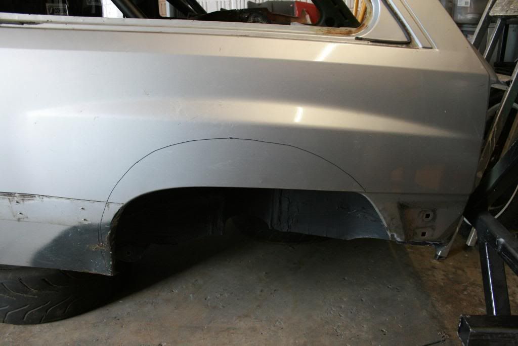

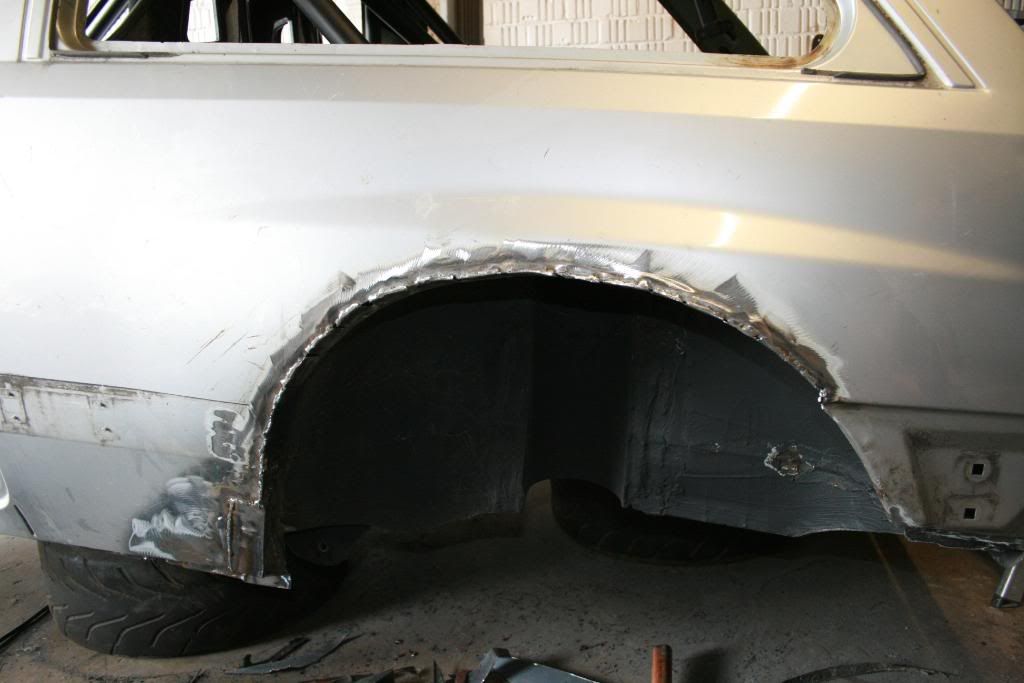

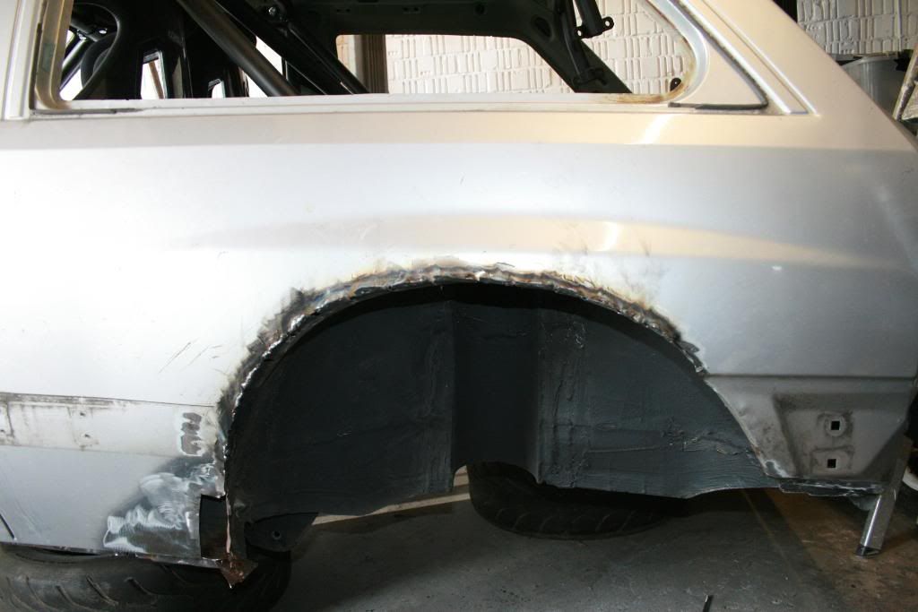

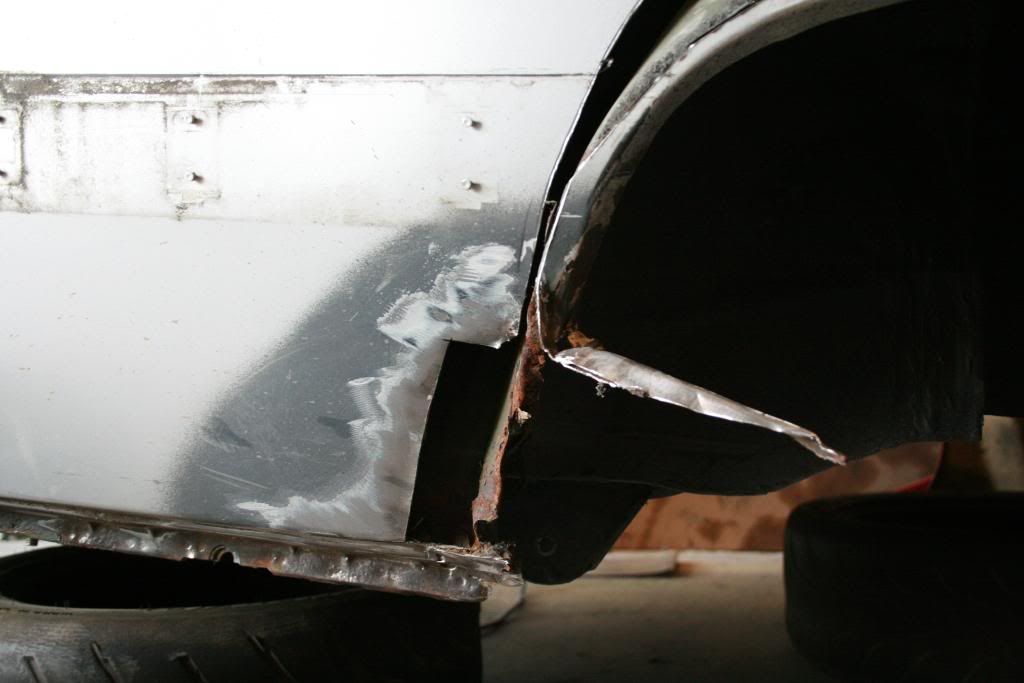

Then on with the actual car, it was time to attack the N/S arch and get it ready to fit the wide arches
The 'cut here line' marked out on the arch
http://i248.photobucket.com/albums/g...tsypics014.jpg

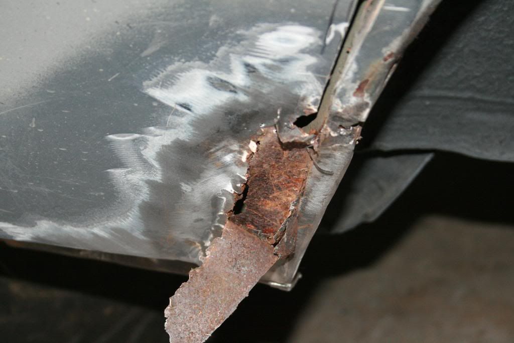

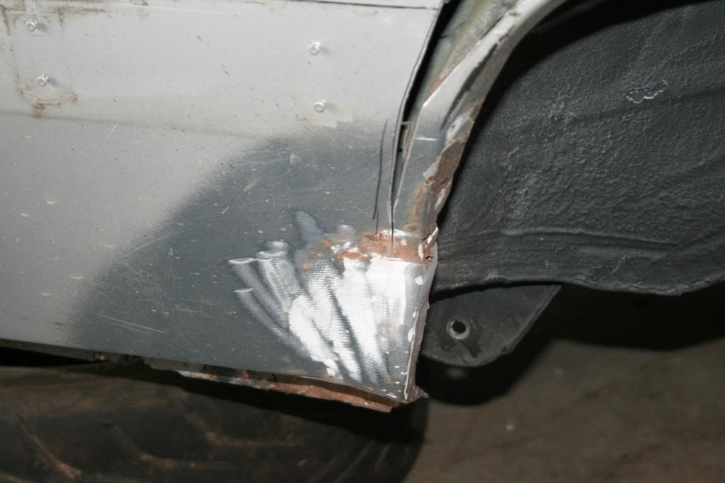

And a previous shonky repair in the corner that had to go
http://i248.photobucket.com/albums/g...tsypics016.jpg

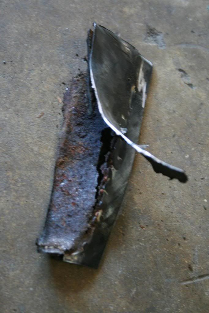

After some digging i discovered a terrible repair basically consisting of 3 layers 1. the old rust patch 2. the repair patch also rusty and at 3. an inch of filler :( so this one goes out to all you bodge artists please don't funking bother.
http://i248.photobucket.com/albums/g...tsypics017.jpg
http://i248.photobucket.com/albums/g...tsypics018.jpg
Anyway i cut it all out (wide arches or not i don't want the side of my car rotting away just because you cant see it)
http://i248.photobucket.com/albums/g...tsypics015.jpg
http://i248.photobucket.com/albums/g...tsypics019.jpg
Bent the inner arch up to meet the outer arch and tacked it together
http://i248.photobucket.com/albums/g...tsypics020.jpg

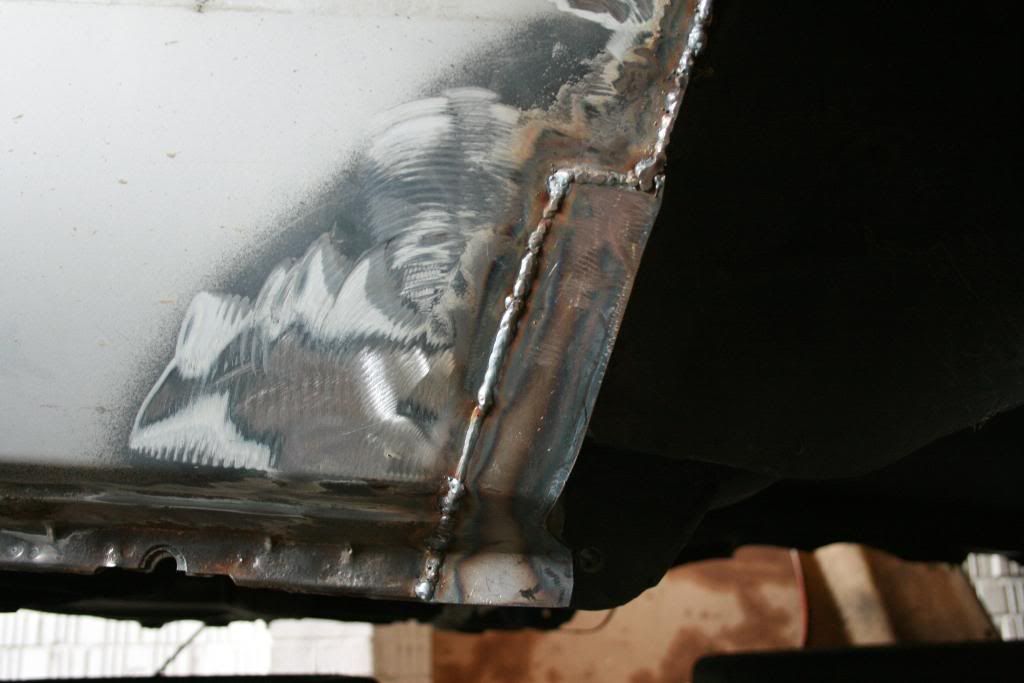

Made up a repair section for the bottom corner as i didn't have one
http://i248.photobucket.com/albums/g...tsypics026.jpg
http://i248.photobucket.com/albums/g...tsypics027.jpg

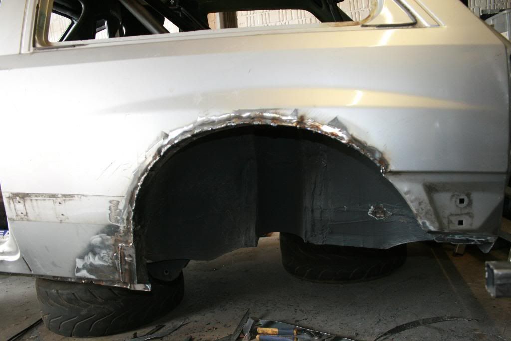

Then welded and tidied it all up with a new rapired corner
http://i248.photobucket.com/albums/g...tsypics023.jpg
http://i248.photobucket.com/albums/g...tsypics030.jpg
This is how i left it for tomorrow ready for sealing up with some paint and seam sealer then its on with the wide arch fitting which will be interesting.

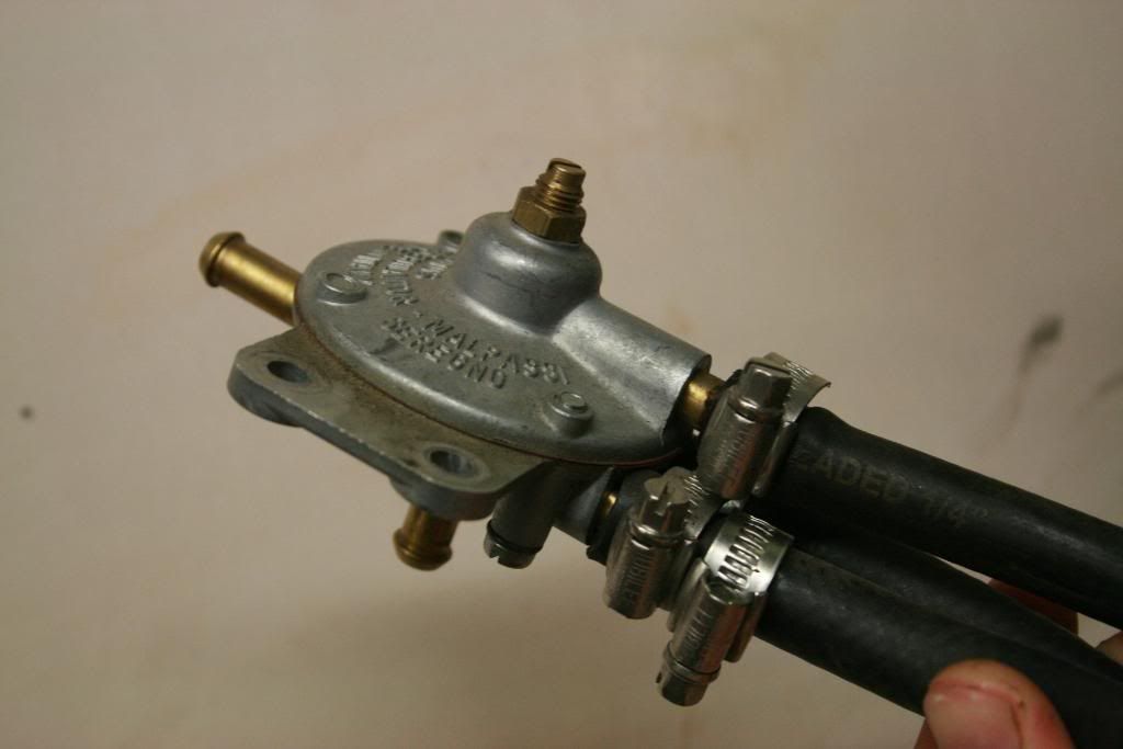

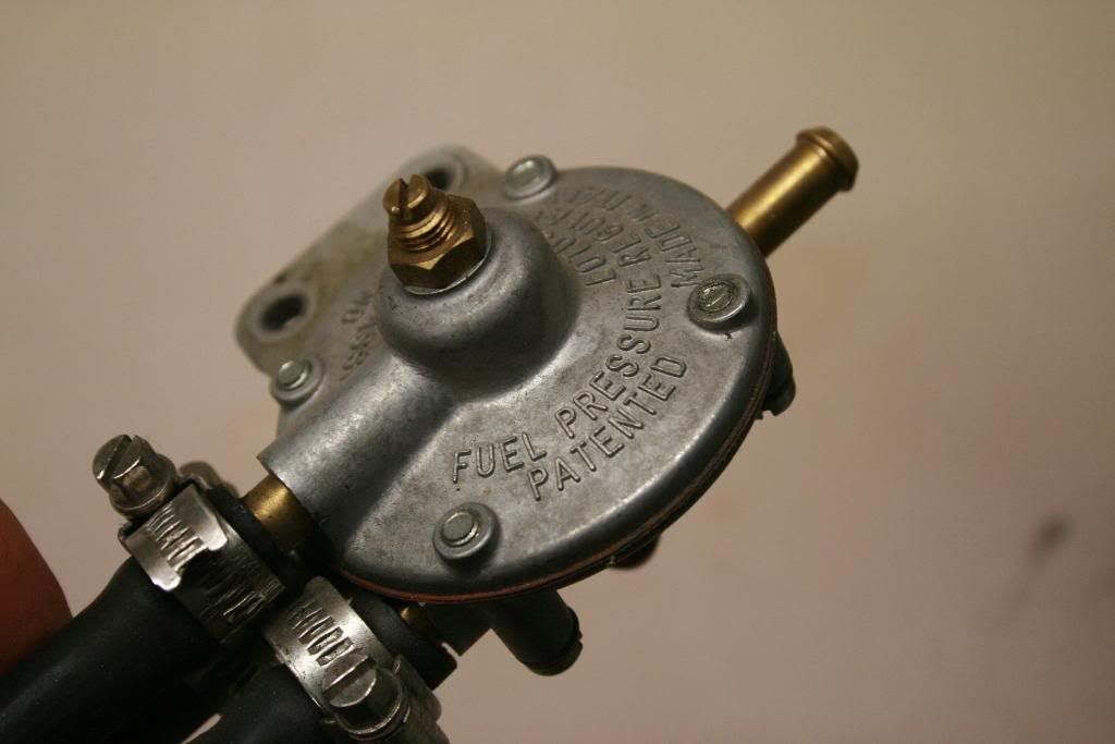

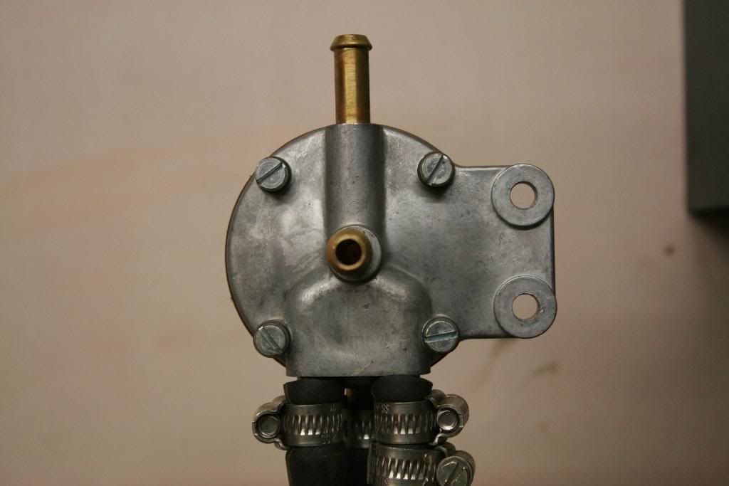

Oh and does anyone know if this FPR will be any good with my TB's?
http://i248.photobucket.com/albums/g...tsypics034.jpg
http://i248.photobucket.com/albums/g...tsypics035.jpg
http://i248.photobucket.com/albums/g...tsypics036.jpg

not too sure about the FPR, so will leave for someone else to advise either way...
I'm loving the bare round rear arch look tbh lol
Arch work looks scarey but good.
Whats hub carrier is it? Doesnt look like a nova hub?
