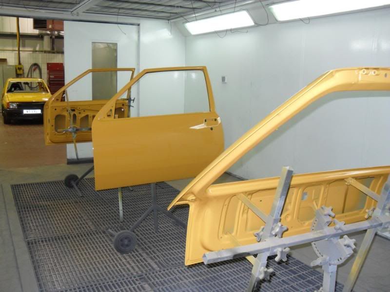

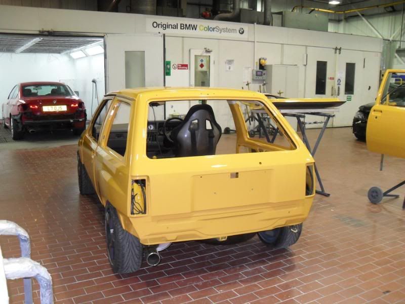

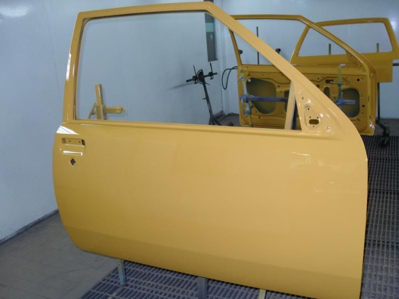

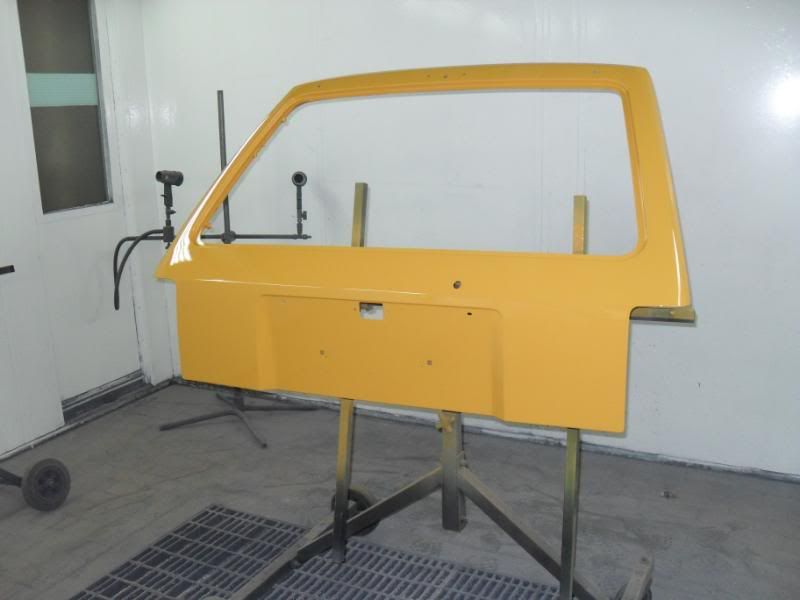

Onto a little update then. Monday eves saw the doors and tailgate have their final prep and into the booth they went for paint. The following morning this was how they were looking........
http://i84.photobucket.com/albums/k2...g?t=1269461513
http://i84.photobucket.com/albums/k2...g?t=1269461532
http://i84.photobucket.com/albums/k2...g?t=1269461551
http://i84.photobucket.com/albums/k2...g?t=1269461571

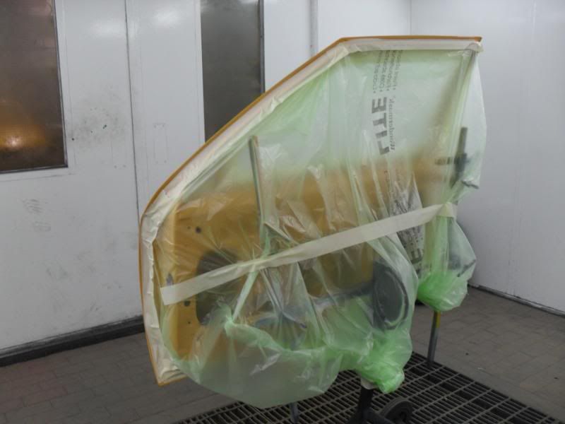

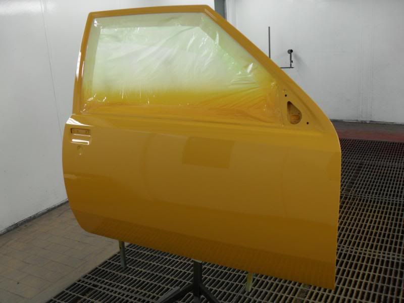

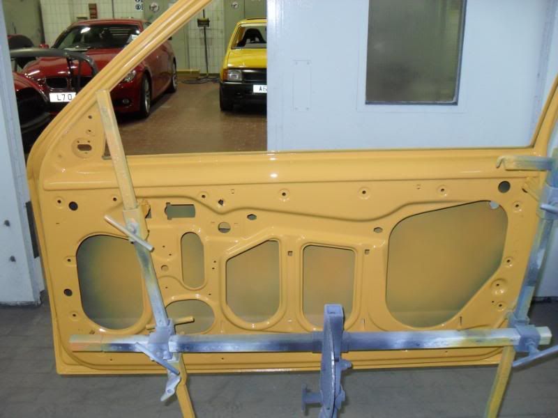

The passenger door and tailagate were excellent but the drivers door had a tiny hair on the top swage line. I tried to flat and polish it but it must have been under the lacqeur so I couldnt get it out. So the next night it was rubbed down again and back into the booth it went......
http://i84.photobucket.com/albums/k2...g?t=1269461711
http://i84.photobucket.com/albums/k2...g?t=1269461730

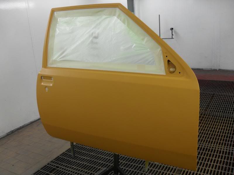

Perfect this time round, Phew!......
http://i84.photobucket.com/albums/k2...g?t=1269461776

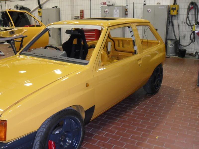

The passenger door meanwhile was going on along with the tailgate too....
http://i84.photobucket.com/albums/k2...g?t=1269461831
http://i84.photobucket.com/albums/k2...g?t=1269461847

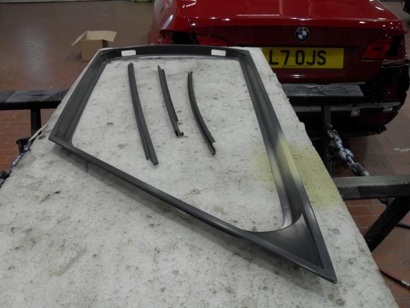

Also some windows surrounds were prepared for paint. One of the rears had a slight dent in which was fixed and primed......
http://i84.photobucket.com/albums/k2...g?t=1269461973

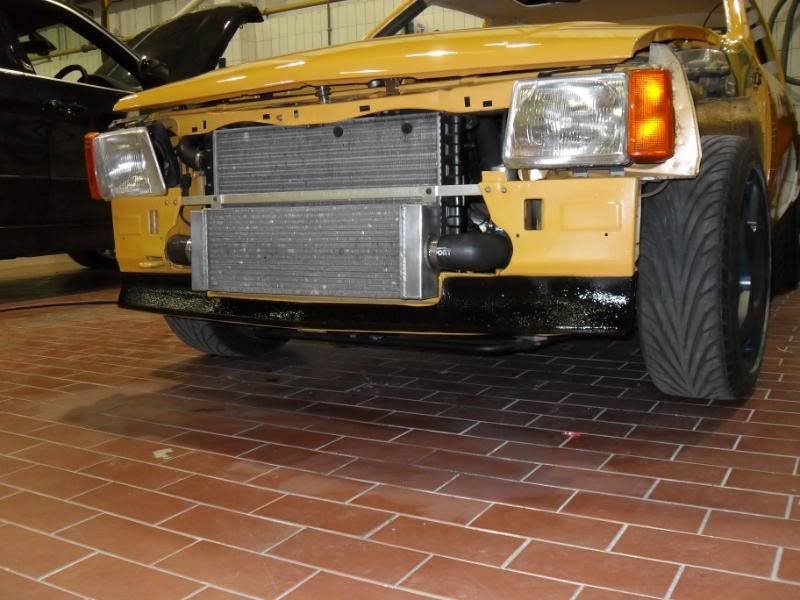

And lastly for this eves the front end came back off so I could gravitex the front panel. Using the fine line tape I masked a nice neat line across the lower half of the front panel and just underneath the cooler. Once overpainted it'll look good whilst adding to the protection of the panel etc.....
http://i84.photobucket.com/albums/k2...g?t=1269462193

Trims are going same colour as door handles and fuel cap which is actually a different colour to the wheels and bumpers just slightly though.... I did it this way to break up the two main colours a little.Quote:

Are you painting on the grey lower half like you have the wings?
Yes fella, I want the doors on and fully lined up before I do that though. Then I know things we be accurate etc. :)Quote:
