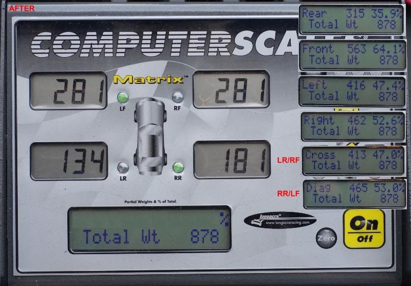

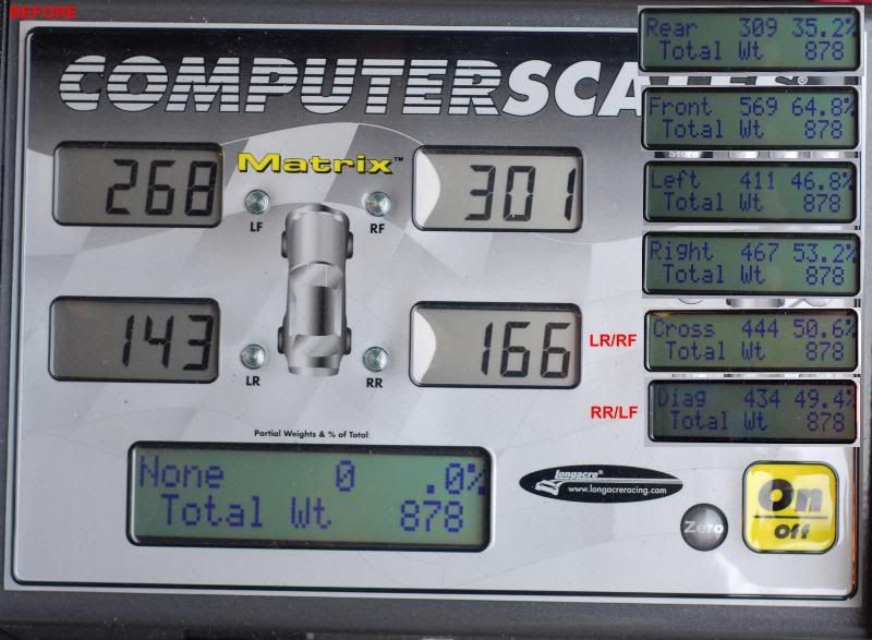

So, here are the before and after results...
BEFORE ~ geometry ~ AFTER
-1.25° ~ front camber ~ -2°
+1.25° ~ front castor ~ +3°
-0.5mm ~ front toe ~ +1mm
-1.5mm ~ rear toe ~ +1mm
http://i136.photobucket.com/albums/q...ure/nc0876.jpg
http://i136.photobucket.com/albums/q...ure/nc0877.jpg
As you can see, we managed to split the front axel left to right weight distribution bang on 50/50, which as important.
We've shifted 6kg over the rear axel more, and lost it from the front - which is good
To help even the weight out - along with altering the ride height, I am to change the position of my battery from the centre of the wheel well - over to the far passenger rear as much as it can go.
65% / 35% split front to back isn't as bad as I was expecting from a stripped out Nova with a XE :thumb:
