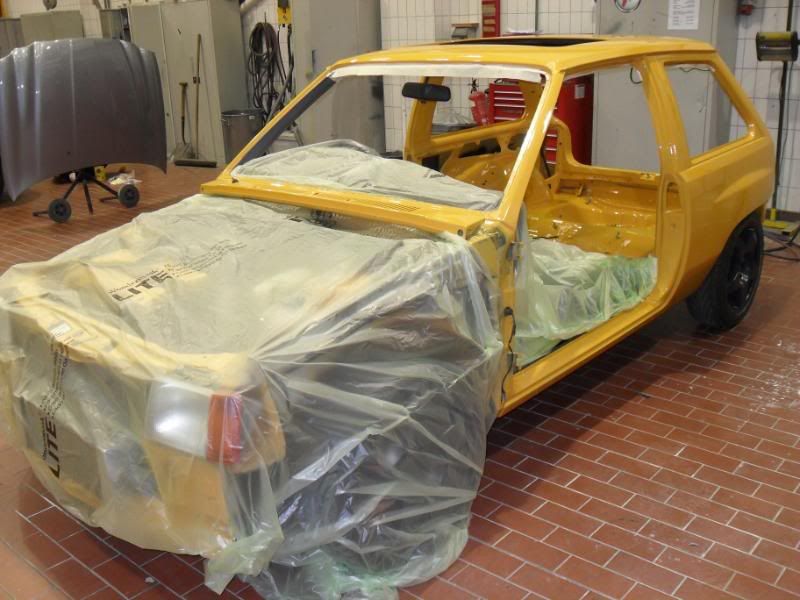

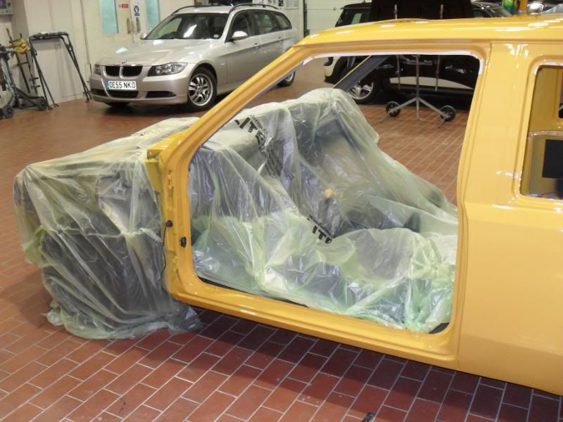

It came out very well and very clean which is always a bonus! I left it to air dry rather than baking as it lets the clear flow more and the finish wont nip up. Today I went back in to work and demasked it then rolled it out of the booth and bagged up the inside and engine bay ready to flat and polish it. This can be messy hence the precautions!...........
http://i84.photobucket.com/albums/k2...g?t=1269193856
http://i84.photobucket.com/albums/k2...g?t=1269193980

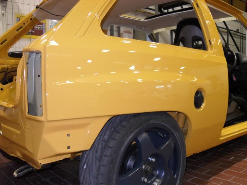

After a good few hours with the polisher the paintwork is absolutely gleaming. This finish it excellent and its totally imperfection free leaving it looking like this........
http://i84.photobucket.com/albums/k2...g?t=1269194118

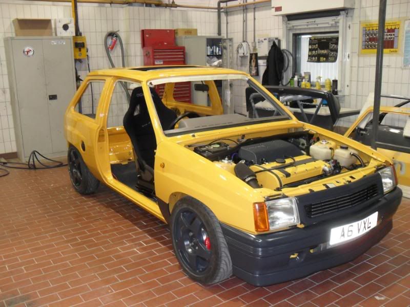

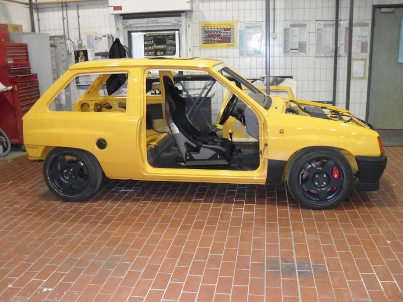

With the polishing complete for now I bolted the wings,bumper,grill,seat and a few other parts back on so they arent kicking about when were all back in work tommorow etc. Today finished with the car looking like this......
http://i84.photobucket.com/albums/k2...g?t=1269194352
http://i84.photobucket.com/albums/k2...g?t=1269194435
