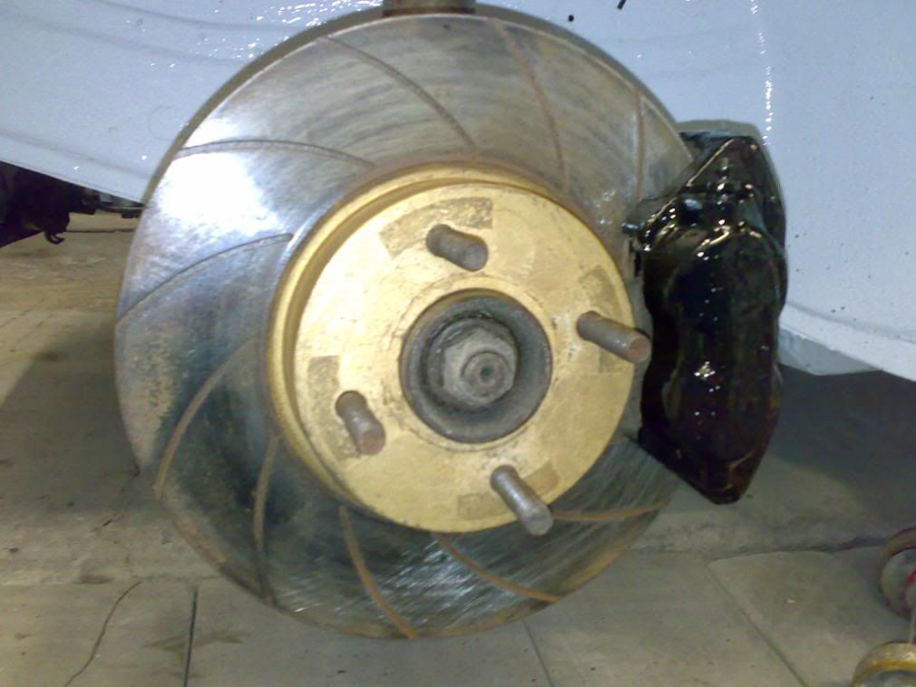

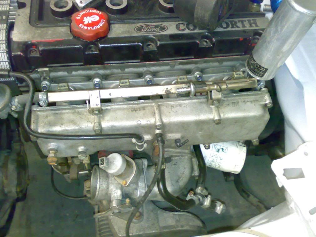

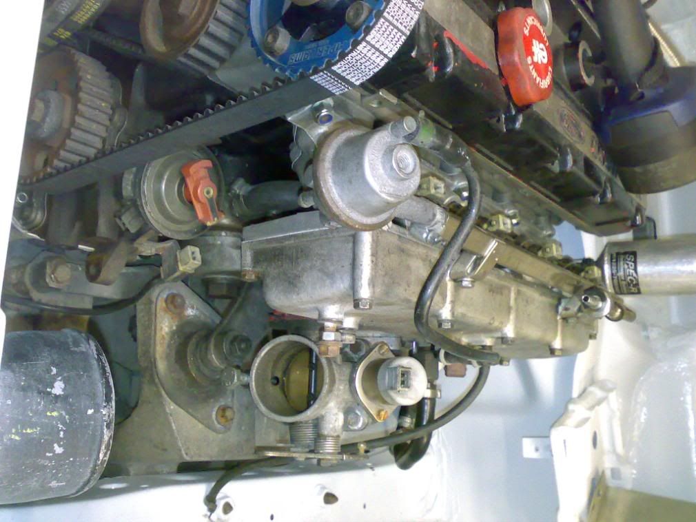

Had a couple of hours today to spend on the car so started with lowering the spec. Removed the front mount oil cooler and fitter standerd one. then fitted standard inlet plenum with Bosch 403 injectors that will be staying in now since im only planing on 380 400 bhp. Also since im now planing on running 15" wheels i have had to fit standard size 2wd brakes to the 4x4 hubs. Im using the 2wd as they are i little bigger than 4x4 and they have 4pots where as the 4x4s just use a forked type caliper
