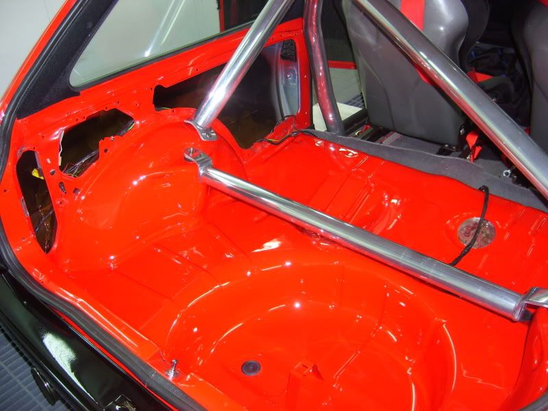

Hi all, Well things went to plan and I got the car to work on Friday, One of our panel chaps removed the unwanted brackets at dinner time for me meaning I could crack on in the evening. Unfortunatly the weather changed around 430pm and totally holed it down completely soaking the car. (First time its been wet since billing last year! lol ) This slowed things down as even after leathering it off I didnt want to paint a damp car as some of you paint chaps know bagging up a wet car can cause the paintwork to sweat. This leaves marks that are a real pain to get rid of. So my plan was to prep the inside and mask it up ready to mask the outside of the car saturday morning once it had dried out etc. Here's how I got on.........
Unwanted bracketry removed....
http://i84.photobucket.com/albums/k2...g?t=1241881790
Bracket areas cleaned up and filled (sorry next few are phone photo's and a bit dark!).....
http://i84.photobucket.com/albums/k2...g?t=1241882764
http://i84.photobucket.com/albums/k2...g?t=1241883028
With the bracket areas cleaned up I gave them a quick coat of primer and then a few coats of aerosol red as a body up for saturday morning. Then I pulled the car into the booth and masked the inside off.....
http://i84.photobucket.com/albums/k2...g?t=1241883255
http://i84.photobucket.com/albums/k2...g?t=1241883284
http://i84.photobucket.com/albums/k2...g?t=1241883311
I also had to mask it so I was able to get access to the front of the rear seating area so I could paint past were the carpet will sit etc. Damn fidly! But just enough access to get the gun in at either side.....
http://i84.photobucket.com/albums/k2...g?t=1241883404
And a random shiny shot!.........
http://i84.photobucket.com/albums/k2...g?t=1241883481
That was how the car was left friday evening. I didnt get as far as I wanted but as said I didnt want to paint the car whilst it was damp. Least it will by dry for the next morning though. :)

Back in work early saturday I got the rest of the car masked up and just had a quick scotch over the areas that had seen some aerosol action yesterday. (Didnt want any flaky paint later!) Once that was done a good blowgun and tack off and we were almost ready for paint......

With the inside painted I still had a thought there may be some unwanted moisture behind trims etc so I thought it best to demask the exterior of the car and let it airdry until tommorow when I can demask the inside and get the car home....
http://i84.photobucket.com/albums/k2...g?t=1241885312
And how the car was left until tommorow...
http://i84.photobucket.com/albums/k2...g?t=1241885367
Hope you all like. Its the first time Ive had a nova almost fully stripped and painted on the inside. But I think it looks really well plus I've done a little weight saving! Lets hope I can put up with the noise! lol Thats all for today.

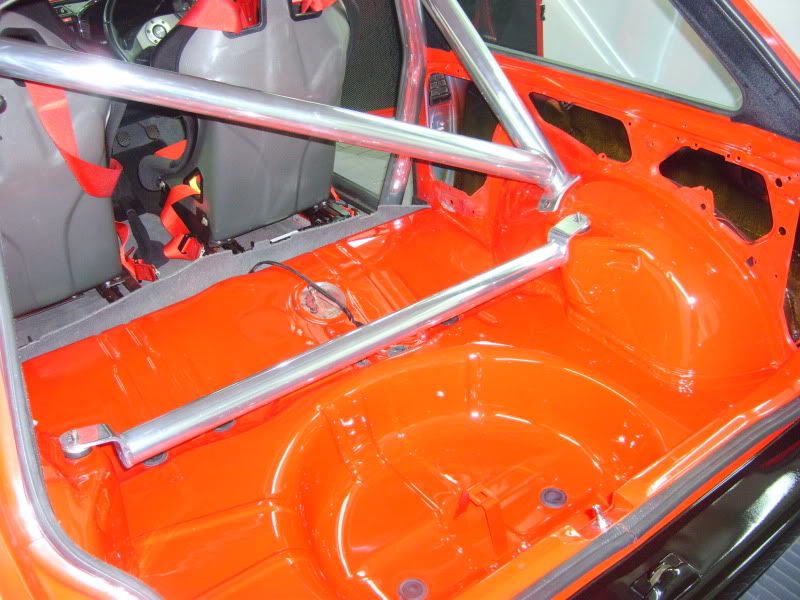

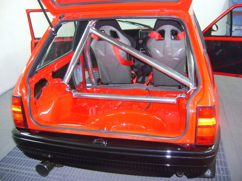

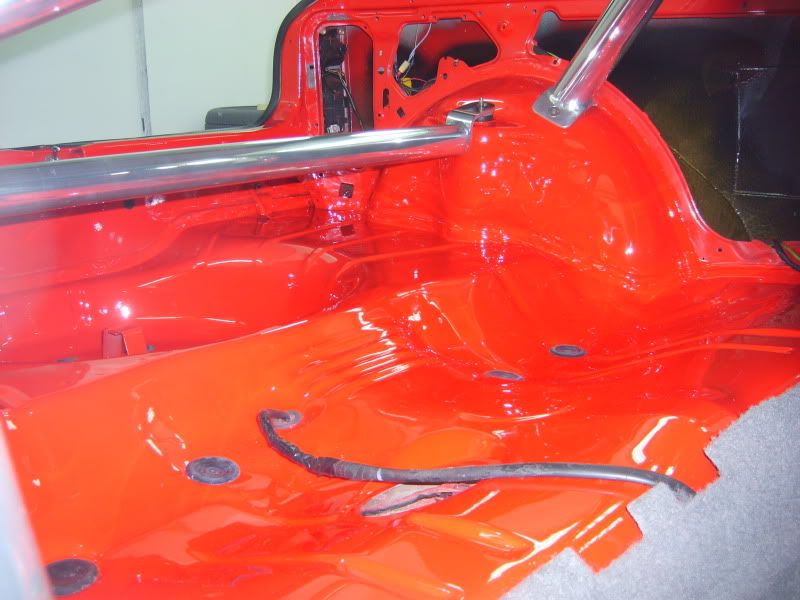

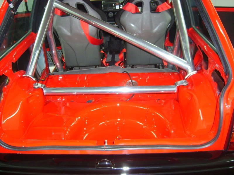

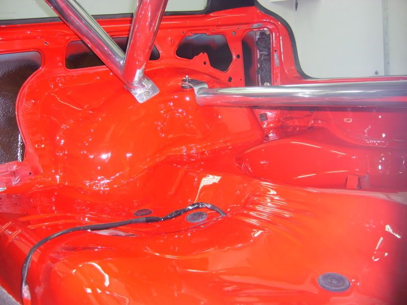

Afternoon Guys, Ive been at work since 8.00am and only just got the car home into the garage. I went back into work this morning and cracked on demasking taking it nice and steady as I didnt want to mark any fresh paintwork, Once it was fully demasked I gave it a good coat of wax which then led to me doing the full car! Also whilst I was there I applied some fresh waxoil here and there. Followed by a quick vac out and it was ready for home! Anyhow heres some pics of the almost finished article just the quarter cards to go in followed by my fifth allesio as a spare once I get a tyre on it in the next few weeks. Enjoy the pics Im really pleased how its finished up, I drove it home with a big smile on my face! :)

have you cut the mouts off where the rear seats bolt/clip in to nick. really like this car

Tommy...... Thanks, yes bracketry etc has been removed,smoothed.
