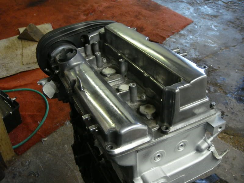

The rest of the weekend (here n there) was spent polishing! woop.
http://img.photobucket.com/albums/v1...r/DSC00032.jpg
http://img.photobucket.com/albums/v1...r/SP_A1566.jpg
The longish wait for the parts has allowed me to do a bit more tarting-up to the engine than i thought id do. But all good, anyway.

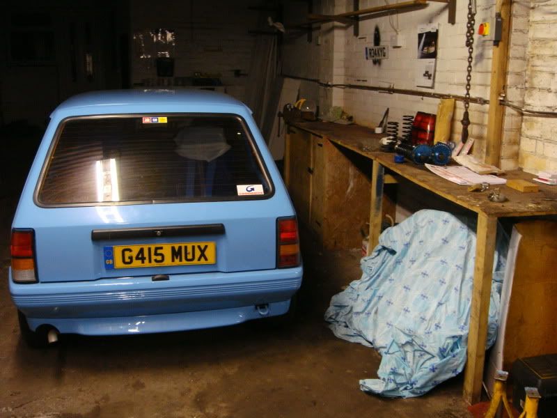

Car passed MOT yesterday, so thought to give an update; (even though not that much has happened) as it will reside here for the next few weeks whilst we finally start this darn conversion.

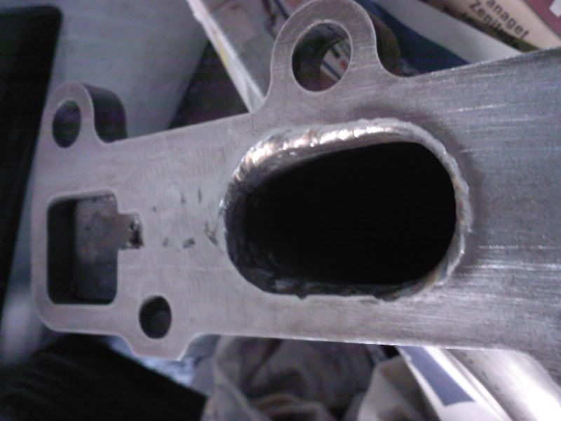

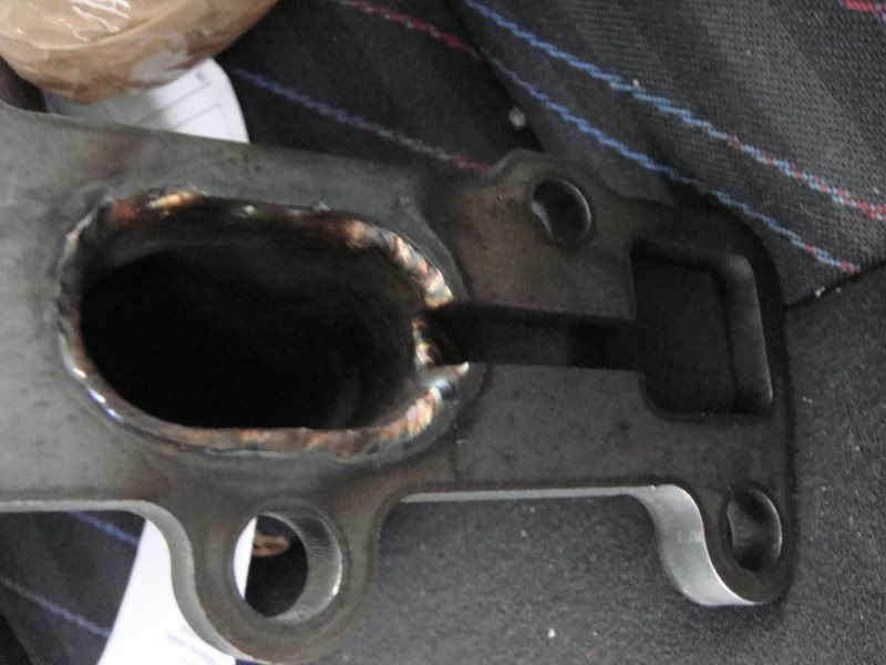

Piper Corsa C 1.8 Sri. From work, discounted and on 6 months pay later lol. It needed a small channel welding up nad the manufacturer welds needed a bit of smoothing out..

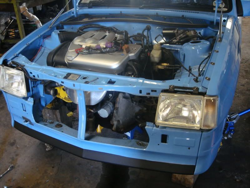

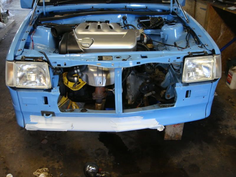

So! Engine out time! This was a tricky job as we'de forgot to position the car better, under the block n tackle..
http://img.photobucket.com/albums/v1...r/DSC00072.jpg
http://img.photobucket.com/albums/v1...DSC00073-2.jpg
Oooh-err
http://img.photobucket.com/albums/v1...r/DSC00074.jpg
Ive no more pics of the engine drop as ive left the camera at the unit..
but yeah - all in all ; it could and should have gone smoother.

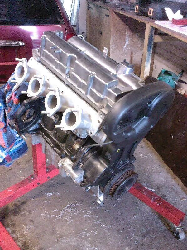

Away from the car, prepping the Z18XE:

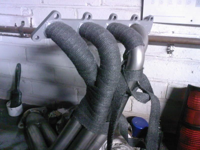

I needed to sort the Corsa C Sri Z18 Piper Exhaust Manifold, from this:
http://img.photobucket.com/albums/v1...r/DSC00037.jpg
To this; blanking the vac (i think) channel..
http://img.photobucket.com/albums/v1...r/SP_A1583.jpg
Then wrapped it..
http://img.photobucket.com/albums/v1...r/SP_A1597.jpg

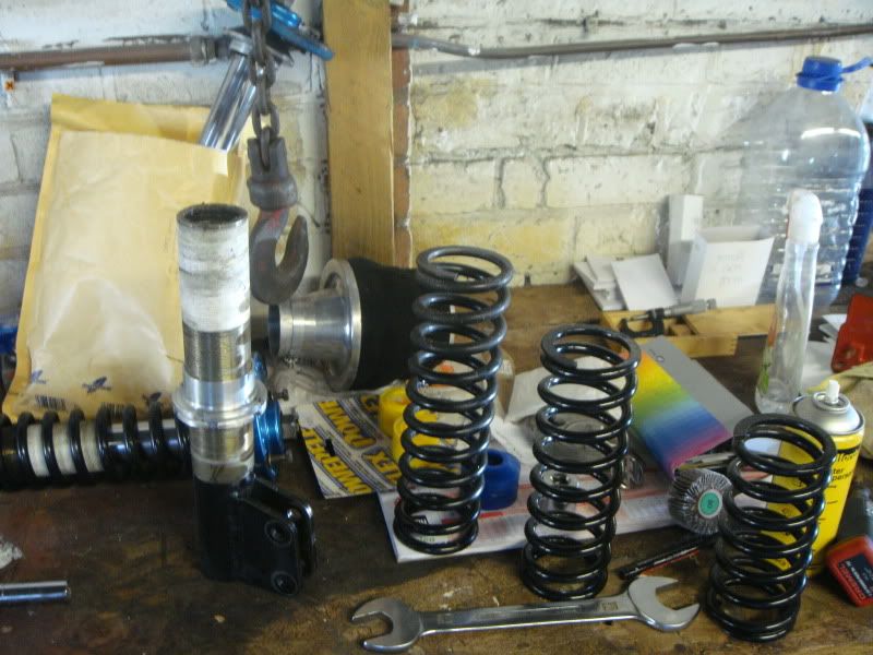

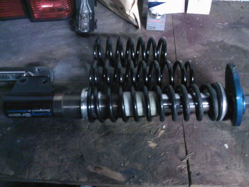

Trying another set of springs on da coillies.. hmm which ones..
http://img.photobucket.com/albums/v1...r/SP_A1589.jpg
Will be fitting the middle ones. Hope it helps improve the ride.

So i shall be at pv in the vectra of fail. But at least ive now got used to knowing it wont be there and have more room and time for doing this job proper.
