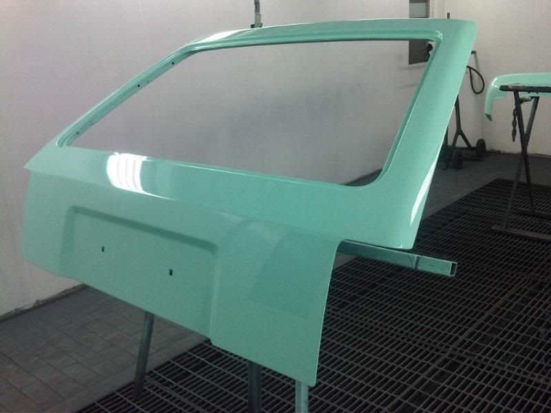

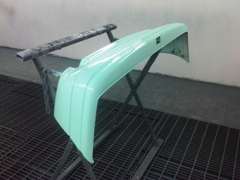

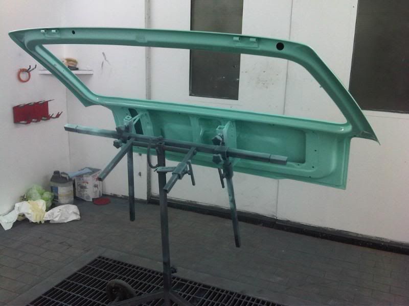

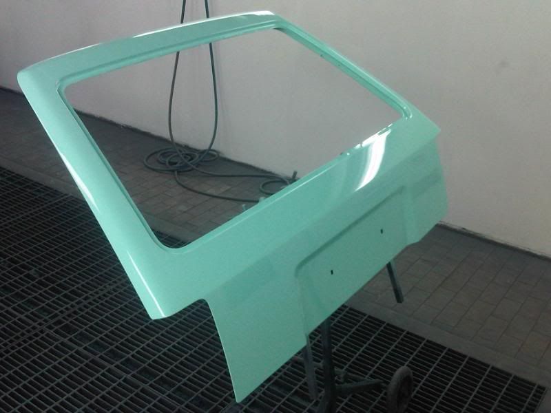

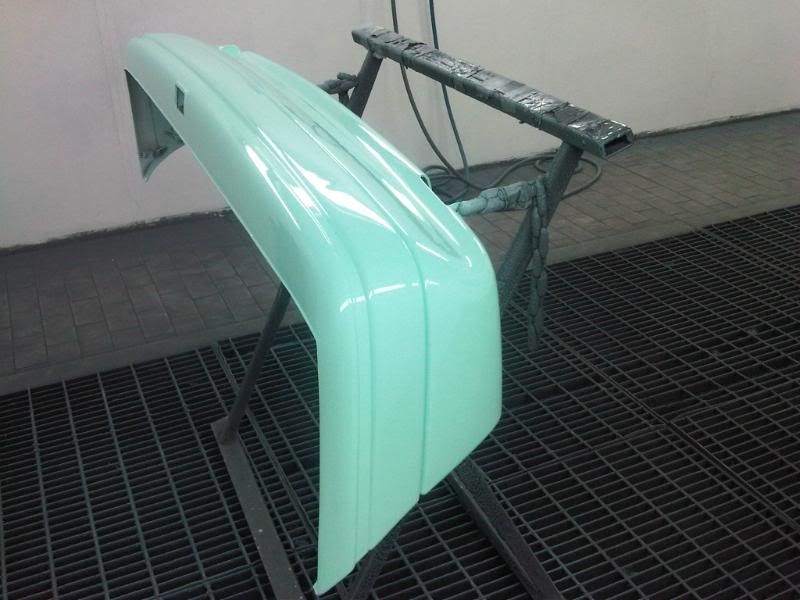

Hi guys, This is a little update of what we've been up to for Matt recently........... As some of you know he's never been a big fan of the back end of his motor and has wanted to change it for a while. Now I just happened to have a mint early tailgate sat around which I let him have and he found himself a genuine gsi rear bumper. Im sure you can guess were this is going! However he did want to go for a smoother look so we welded up the holes and filled/primed it to suit...........
http://i84.photobucket.com/albums/k2...11222-1555.jpg
That was left over christmas to allow for any movement in the primer and blocked down once I was back in work along with the bumper. We opted to use the original 2k solid paint the car was previously painted in as oppose to base and clear not only for a better colour match but also so these panels will in time fade with the rest of the cars paintwork and not standout at a later date which is what could have happened if we'd have used a quality clear. Just earlier today I got the colour on and heres's the results..........
http://i84.photobucket.com/albums/k2...20103-1657.jpg
http://i84.photobucket.com/albums/k2...20103-1658.jpg
Hopefully tommorow will see them flat/polished ready for Matt to collect sometime later in the week. Im sure the majority will agree they should really suit the car and improve its overall look no end. I for one cant wait to see them on! This car is going to look stunning once its roadworthy again fella. Hope you enjoy the pics,

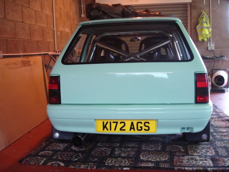

Ive just recieved this from the homo sheep farmer his self...... seems he has been busy and the results are looking great! :)
http://i84.photobucket.com/albums/k2...to/Unnamed.jpg
Nick.
Looks the dogs :)
That number plate held on with a dirty great big screw?? :)
Looks great, please say they arnt screws thru the plate!
New tailgate/bumper looks great (though i have to admit i quite liked the old setup) This car is crying out for a harry hockly T45 cage!
