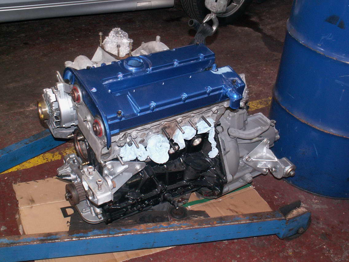

Been just prepping up some bits tonight for the engine :-
Camshaft cover :-
http://www.elsamak.karoo.net/Camcover1a.jpg
Hope you like the carbon plug cover !
Cambelt cover (sprayed Europa Blue and also a carbon one) :-
http://www.elsamak.karoo.net/Beltcover1a.jpg

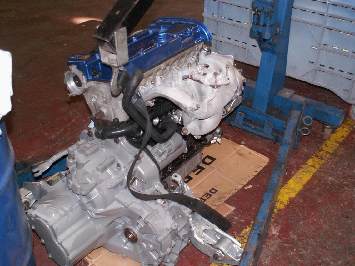

All was going well got the gearbox mated to the engine block ..
http://www.elsamak.karoo.net/Engine4a.jpg

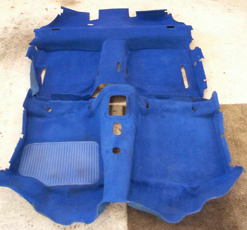

Progress on work - whilst the shell is out of the garage I've got the carpets out for a clean - they have come
up fine with a vax but one big problem - the car they came out of had a dog with white hair - how do you get
animal hairs out of the carpet fibres??? It won't hoover out, or vax out and my clothes brush ain't much cop either??
http://www.elsamak.karoo.net/Carpet1a.jpg
Any tips or ideas would be appreciated!!!
Joff
you can get dog hair removers - theyre like a roll of sellotape with a very sticky backing - try that.

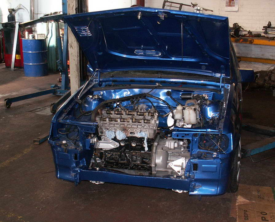

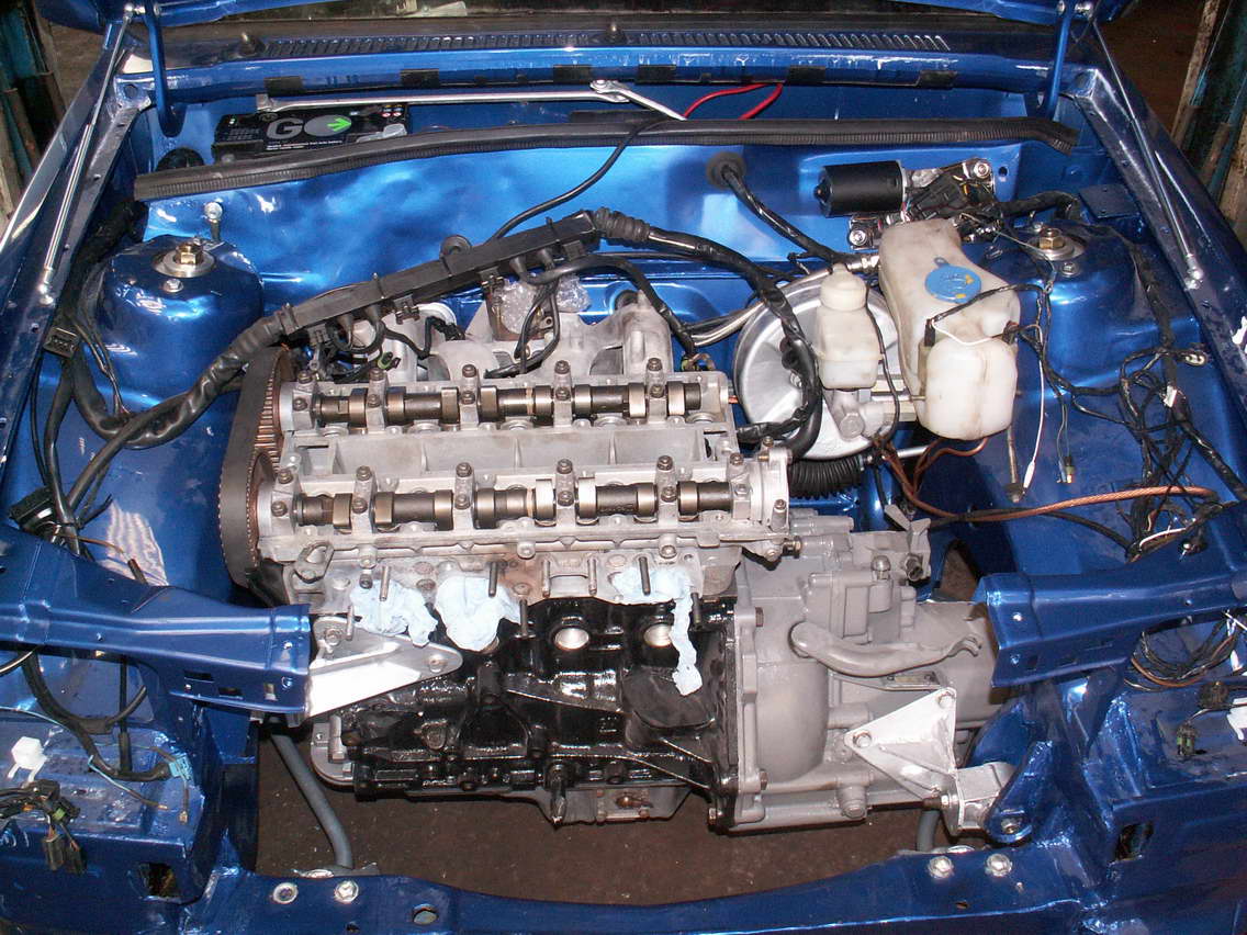

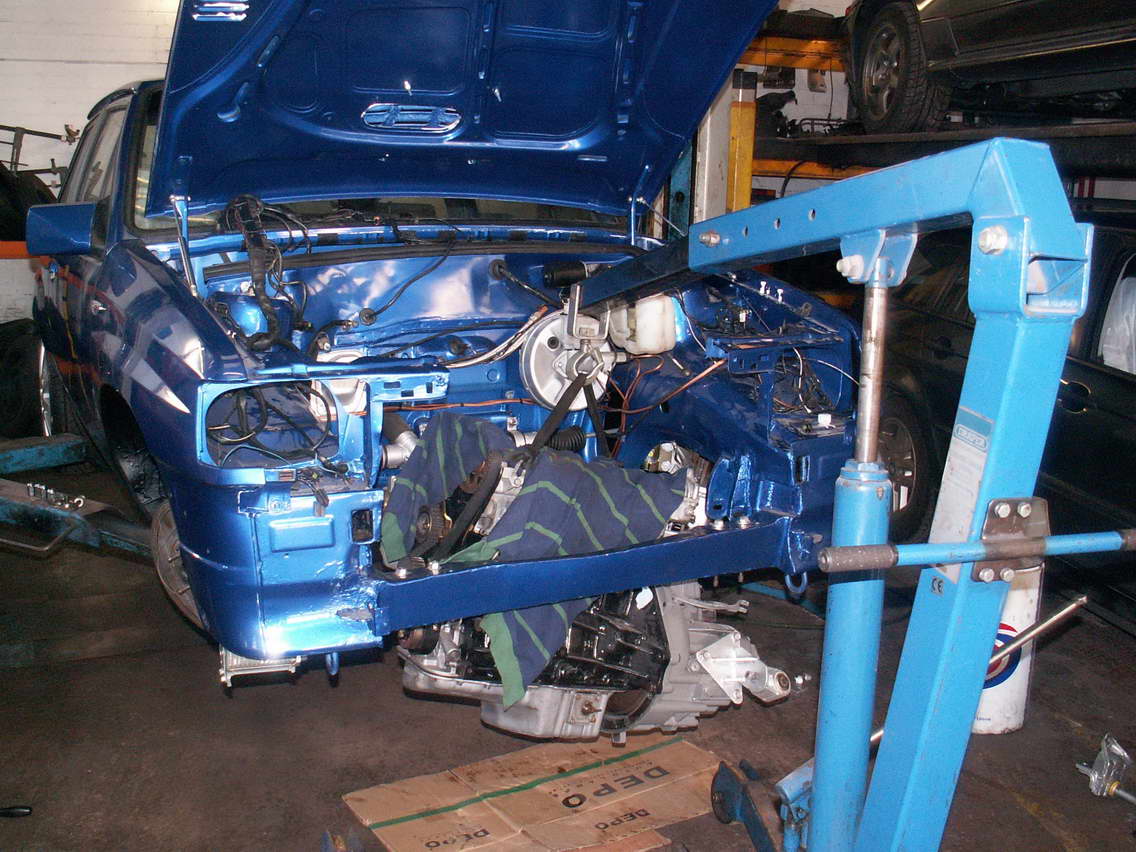

We now have an engine installed again after 3 years of being separated they are back as one unit!!!
Anyway ..... got the water pump in and all the pulleys back on, cambelt on and tensioned and ensured that the engine was timed up correctly!!!

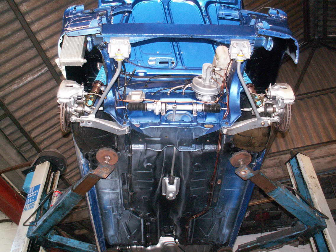

It was then craned over to a two post where my shell was waiting , heres a snails eye view of the underside of the shell on the ramp ...
http://www.elsamak.karoo.net/Install1a.jpg

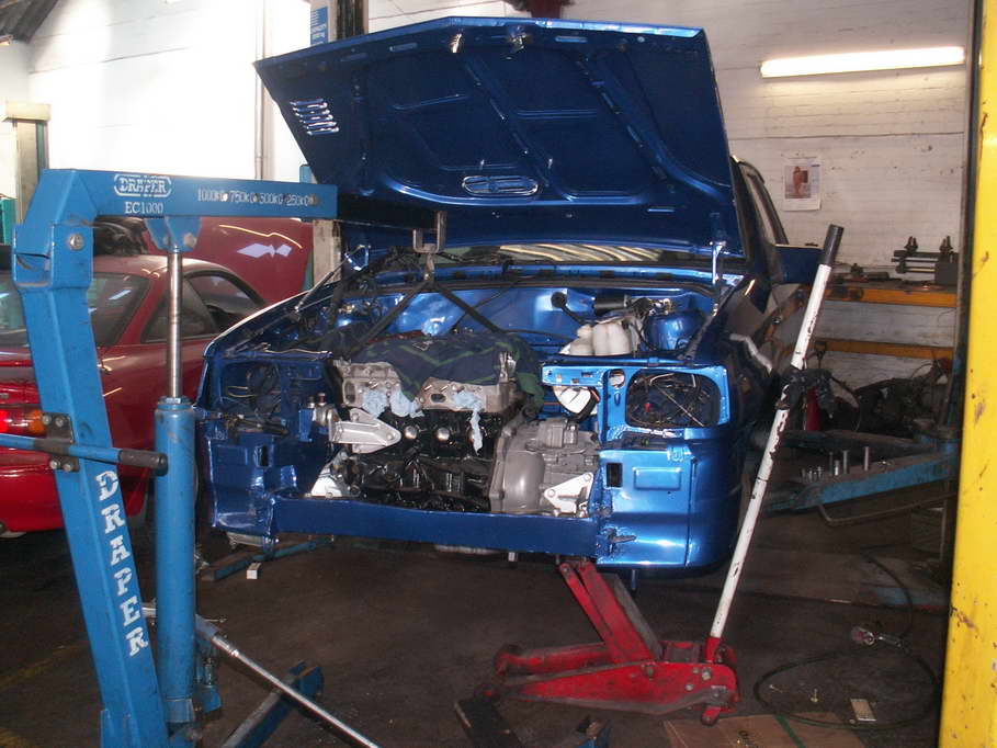

With engine positioned correctly under the shell we pulled the engine through with the crane being carefully not to catch the bodywork!
http://www.elsamak.karoo.net/Install2a.jpg
I then got the mounts lined up and tightened so it sat in the shell correctly ...
http://www.elsamak.karoo.net/Install4a.jpg
I then bolted the suspension back on and put the wheels on and ....
http://www.elsamak.karoo.net/Install5a.jpg
And one newly installed engine and F28 gearbox in the bay (with lots of wires looking messy that need sorting) ....
http://www.elsamak.karoo.net/Install6a.jpg

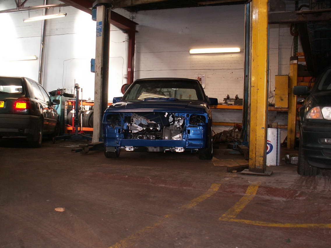

And all finished ready to roll onto the back of the recovery truck for the trip home - car is now back in my garage where
I have the task of pumbing everything back in!!!!
http://www.elsamak.karoo.net/Install8a.jpg
Big cheers to Andy at Bridlington Care Car for the lend of the ramp, rescue truck and general brute strength getting the lump in!!
Enjoy
Joff
