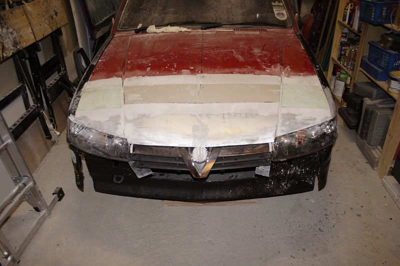

Been busy doing the front end - spent most of the weekend messing with the bonnet, smoothing it and shaping it to get the lines right. Also filled the void underneath and started to smooth it (the extension bit) - ready for casting.

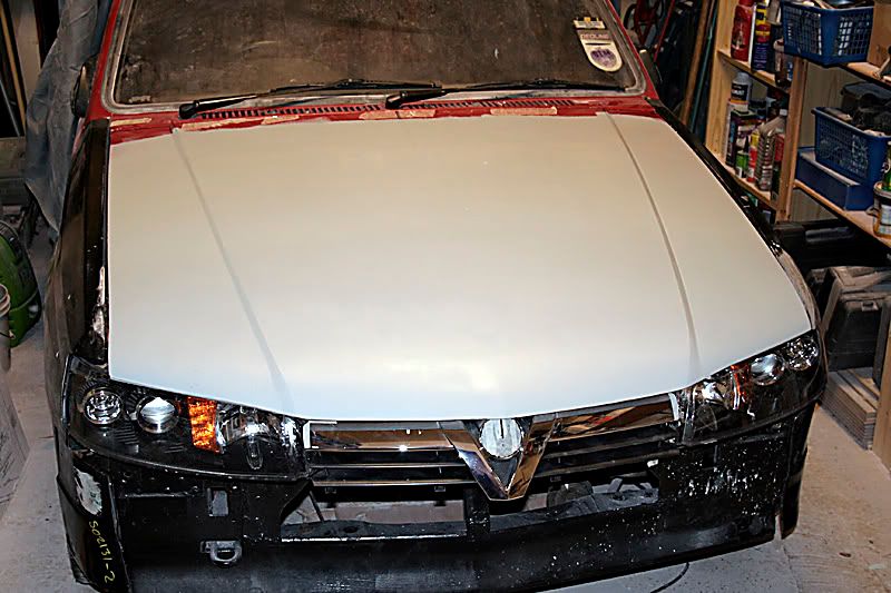

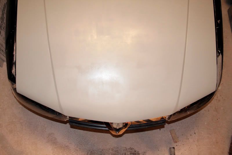

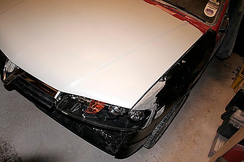

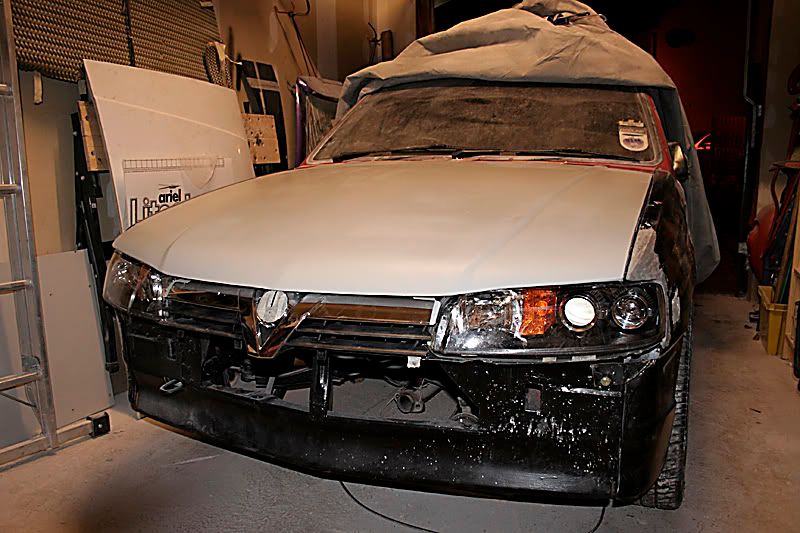

Tonight though I finally got it to a stage where I could give it a coat of primer. This will allow me to assess the work to date as well as tidy it up a bit - letting me see where I need to work on next.
Heres what it looked like prior to priming...(this image was prior to the bonnet being smoothed over as well)
http://img.photobucket.com/albums/v1.../bonnet045.jpg
This is how it looks now after the lines have been started and the 1st coat of primer is on -
http://img.photobucket.com/albums/v13/danga/bp6.jpg
http://img.photobucket.com/albums/v13/danga/bp2.jpg
http://img.photobucket.com/albums/v13/danga/bp9.jpg
http://img.photobucket.com/albums/v13/danga/bp8.jpg
http://img.photobucket.com/albums/v13/danga/bp7.jpg
http://img.photobucket.com/albums/v13/danga/bp5.jpg
http://img.photobucket.com/albums/v13/danga/bp4.jpg
http://img.photobucket.com/albums/v13/danga/bp3.jpg
Primer hides a miltitude of sins (especially in these pics) - theyre not as nice as they look.
Next step is to dust the whole surface with a speckle coat of black paint then give it a light sand to see where the dips and flat areas are. Then I need to continue working on the 2 lines - get them nice and even.Theres some depth issues I need to address which can be seen in a couple of the pics.
Once the tops done I then need to work on the underside - At the moment one sides slightly higher than the other caused by an uneven underside.
I'll try over the next day or so get a draft with the grill and bumper on the front - give an idea of what it will look like...

Re the underside - yes it will be strengthened - remember the above bonnet is a master from which an entire fibreglass skin will be taken. The skin will cover the WHOLE bonnet front to back incliding sides - there will be an underside section reinforced and rivitted top the existing nova lip. you can see the bonnet I'll use in one of the above pics (white one).

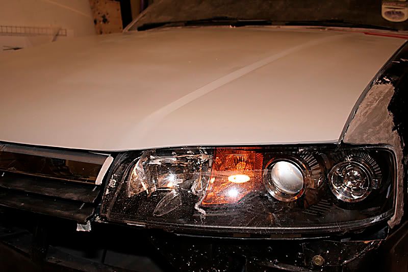

Saturday 3/11/07

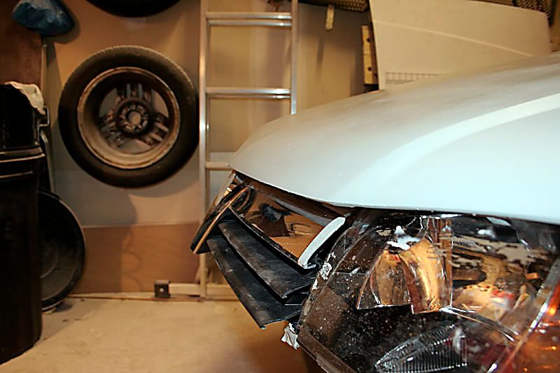

Spent the last few days smoothing the imperfections out of the bonnet (most of the primer in the above picks has been sanded away from the front now).
Cleaned up and balanced both of the bonnet lines so they are now exactly paralell, the same height and the same distance from the edge.
Started work on the underside of the bonnet - cleaned up the area between the bonnet and the grill/light tops and started to smooth the underneath that joins on to the existing bonnet.
Fitted both wings to ensure they still line up and cleaned up the plastecine on the passenger wing to match the bonnet - smoothed it ready for casting.
Added custom clips to support the "V" grill

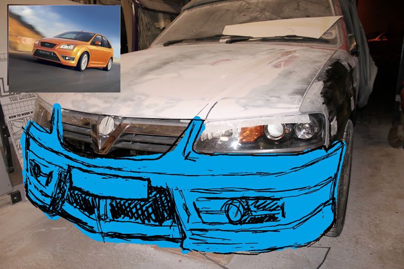

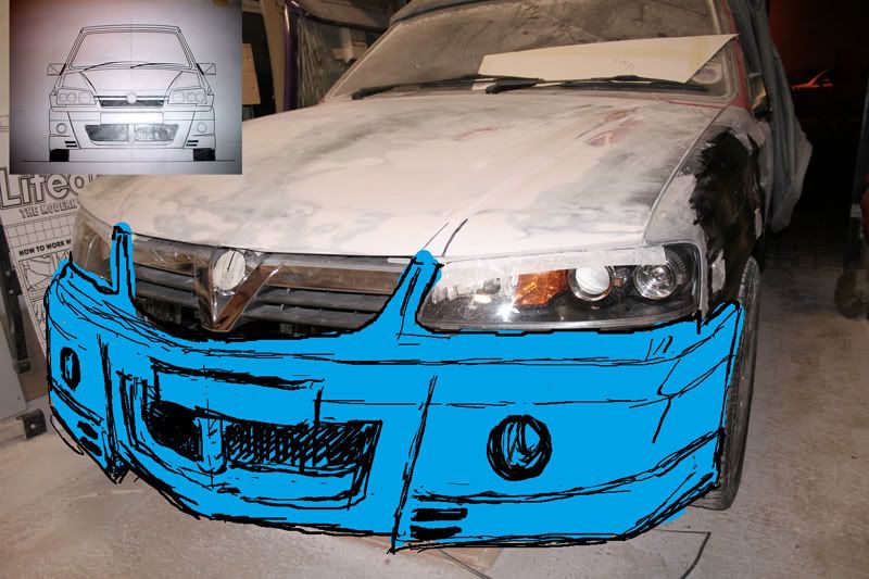

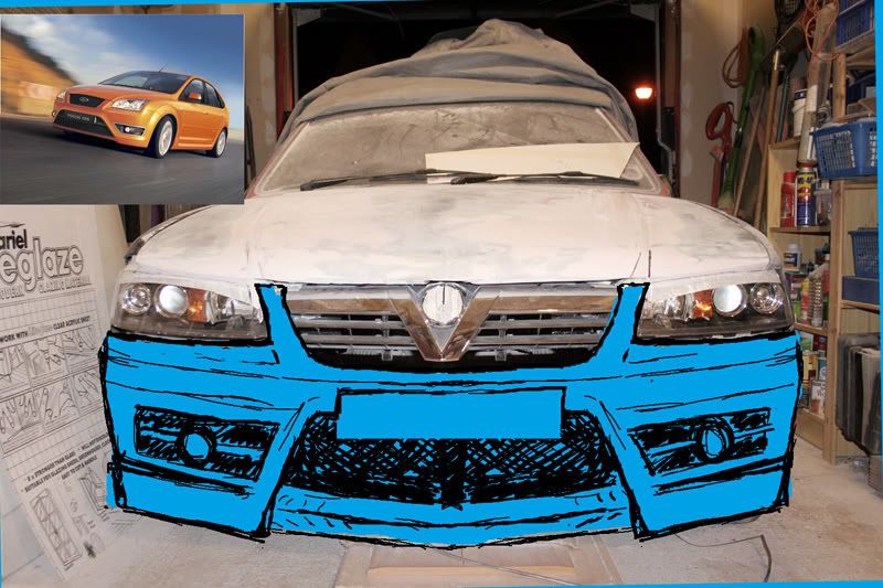

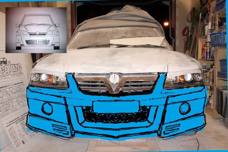

so - heres some "very rough" images of 2 possible bumper styles -
1st - the "Nova" one - based on the drawings from page 7
http://img.photobucket.com/albums/v13/danga/nova1.jpg
http://img.photobucket.com/albums/v13/danga/nova2.jpg
and the 2nd - based on the focus sti
http://img.photobucket.com/albums/v13/danga/focus1.jpg
http://img.photobucket.com/albums/v13/danga/focus2.jpg
I'm torn...
Cant really do a combination on both because the angles of the lower section are opposite.
What do you think - and feel free to post you own designs.
I like the STI 1
IMO id go with what ever is going to be the easiest to produce.
The ST item, if based upon a genuine ST bumper is obviosly going to cost a fair whack. Personally id keep GM :D
First one, focus is just too ugly!
i prefer first one, they are two top designs but
The top one I reckon :).
Why not just make both then decide once you have seen them on the car...
Top one imo
the top one is more stocky looking in the sketch - both items will be made from scratch - unfortunately I cant afford to make both at the moment.
Theyre basically the same just the centre lower vent is inverted...
I think I'll need to draw them up to scale see if that makes a difference...
Top one ade.. defo..
been looking at them in more details and I think the top one wins it over. the focus styles one just seems a little bit too "flimsey" looking for some reason.
My PU foam arrived today so will probably start carving it out over the enxt few weekends. Getting Sky fitting this weekend mind so may just turn into a "Homer"
D'OH!
Glad your leaning towards the first one Ade.
I think you'd regret doing the ST based one as people might think its an ST bumper.
You've always been original with your own designs and ideas... stick with that and you won't go wrong ;)
It's a shame you can't use an 07 number plate as I'd imagine a lot of people will look at the finished car and think Vauxhall have re-vamped the Nova.
