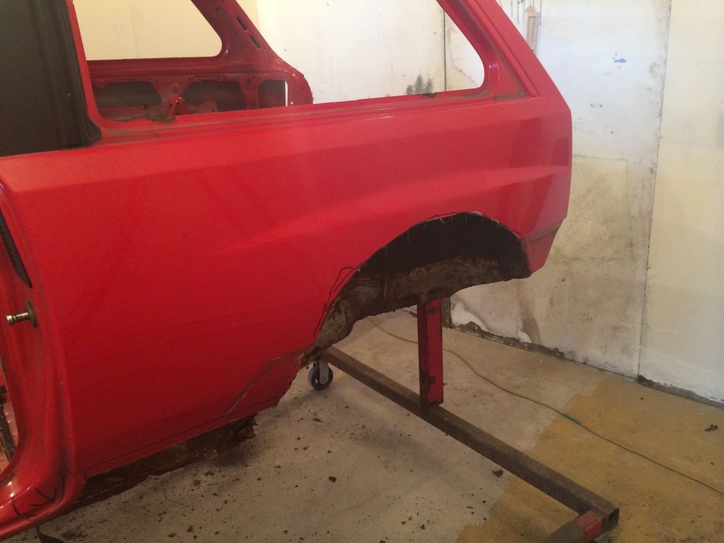

I went over to see the car in Saturday, it's not quite as bad as I thought bud still not great, the work starts in it today though so hopefully have some decent updates shortly :)

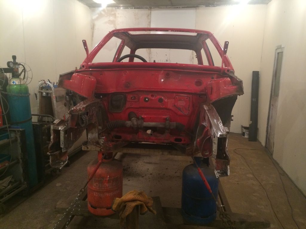

Your jig is a lil eek looking lol

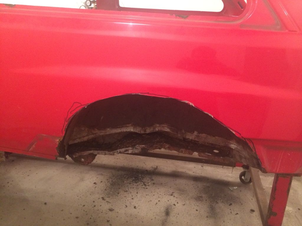

Good work on cutting the rust out.
That's some weight saving Bazz, I hope it all pans out for you on this build, it's going to be one expensive nova though when it's finished but my words it will be worth the hard work ;)
lol it's more sturdy than it looks lol best way to
keep it in the air since we can't use the spit for the time being lol

Whot like is boot floor and rear chassis legs silly qestion when you hopeing to have it on the road
It's not that bad and you got the whole front new anyway just standard nova spots I'd be happy taking that on seeing you have the pannels and the rear legs just need plates doing tidy and will be fine

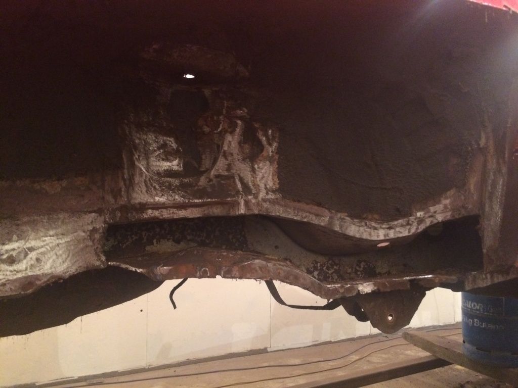

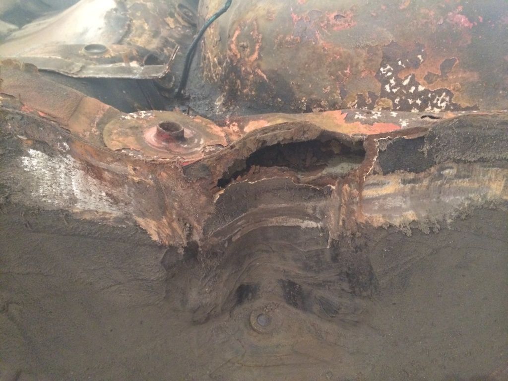

boot floor has holes in it etc think I'm cutting out the wheel well as well. Chassis legs aren't that great. Hoping to have it done by the end of 2015.
yeah just gone in the usual places really,hopefully it all comes together well, got told yesterday it's almost ready to build back up so will be more progress over the next week or so :) buzzin!

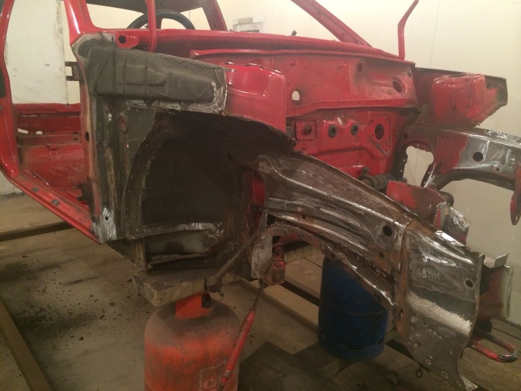

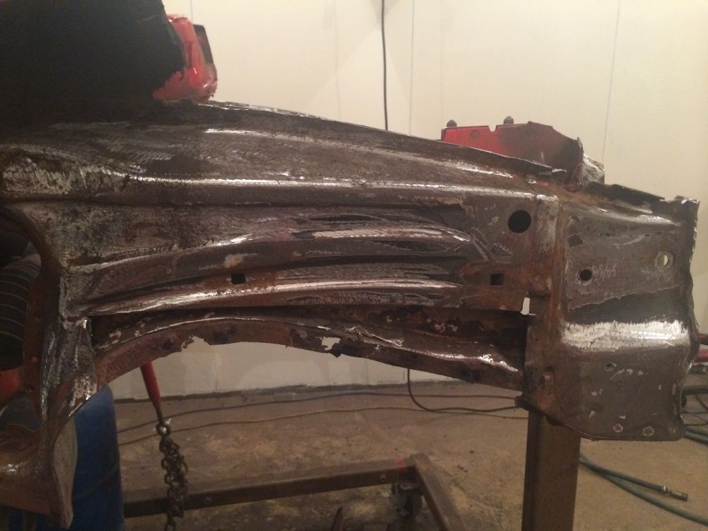

Bin that front end and replace the lot, id give it 4 years tops before its needing rewelded

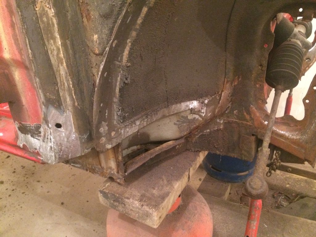

The rot between the seams can not be treated and once you cover it with cavity wax your fcuked, it will rot from the inside out. Cutting through the inner wing brace panels aint so clever either, you need them removed and the rot behind them cut out at the very least.
You have spent a fair few quid on the carbon bits so please dont over look the metal bits.
