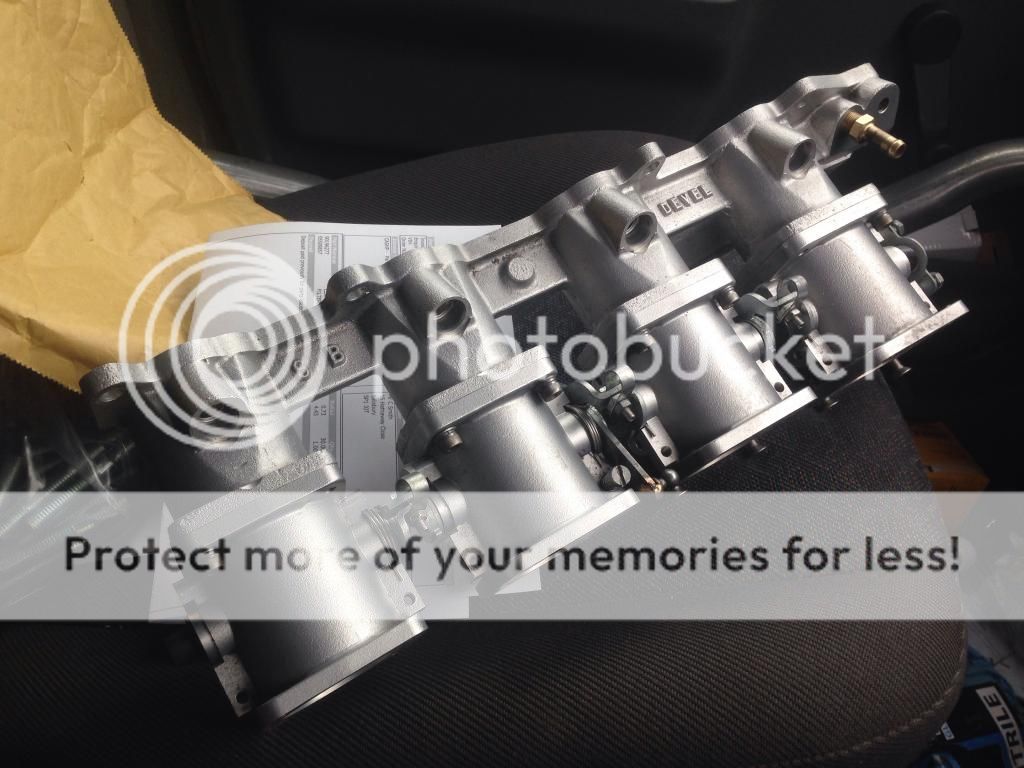

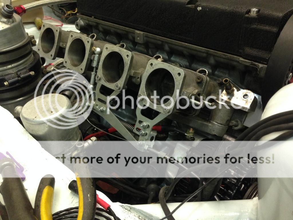

A little progress, but still slow as all the jobs are despite being small, very time consuming. Started by fitting a Jenvey linkage and a throttle cable.

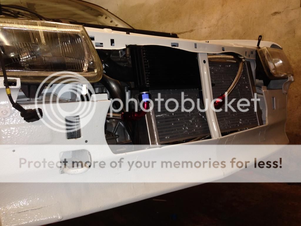

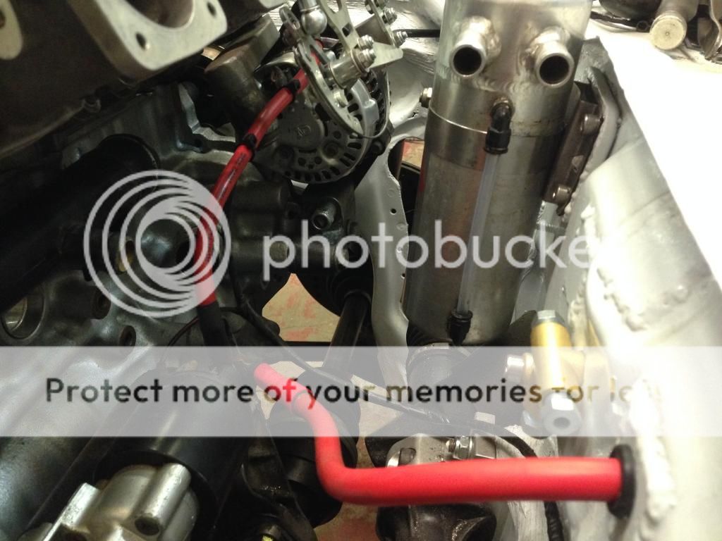

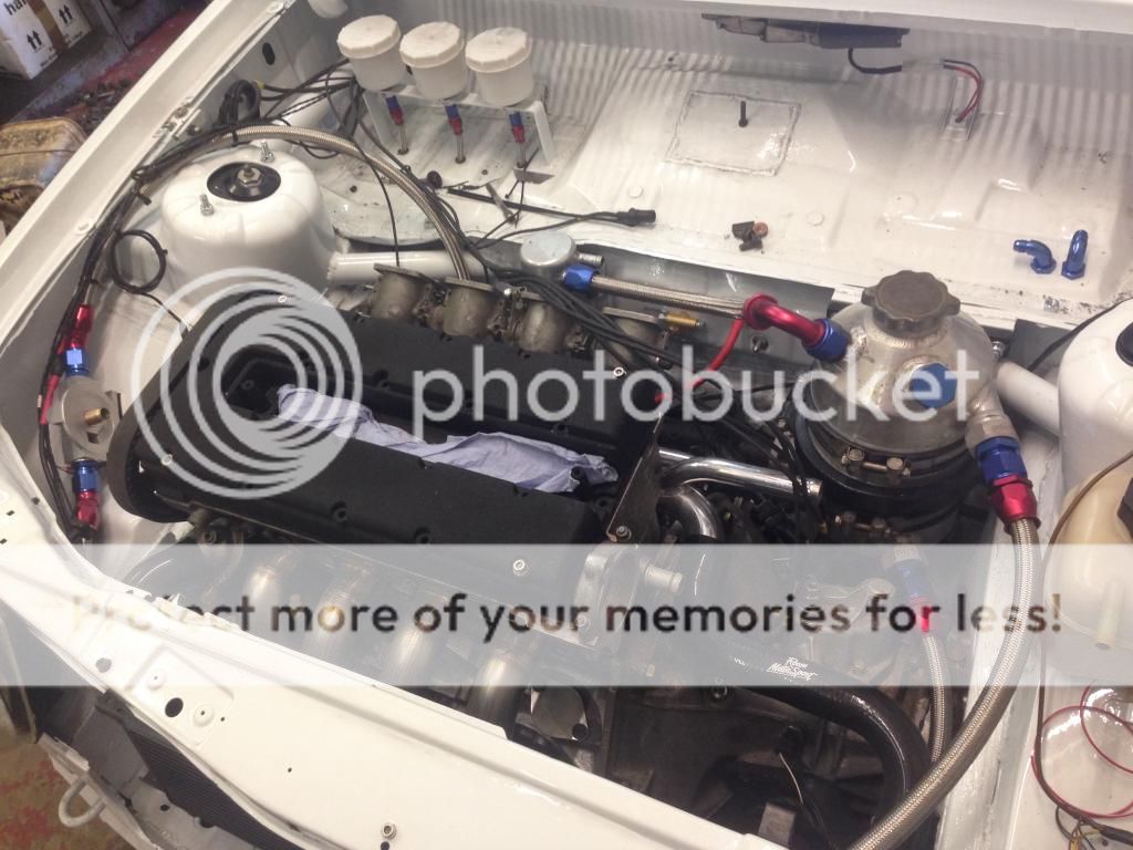

Started work on the Oil fittings. (Lets not have the upside down cooler debate, it's fine).
http://i995.photobucket.com/albums/a...ps4ff4da55.jpg
Wired the alternator and starter
http://i995.photobucket.com/albums/a...ps336d65bd.jpg

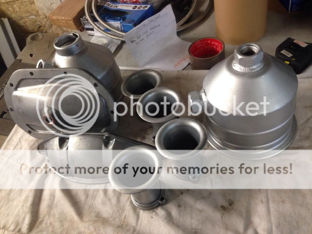

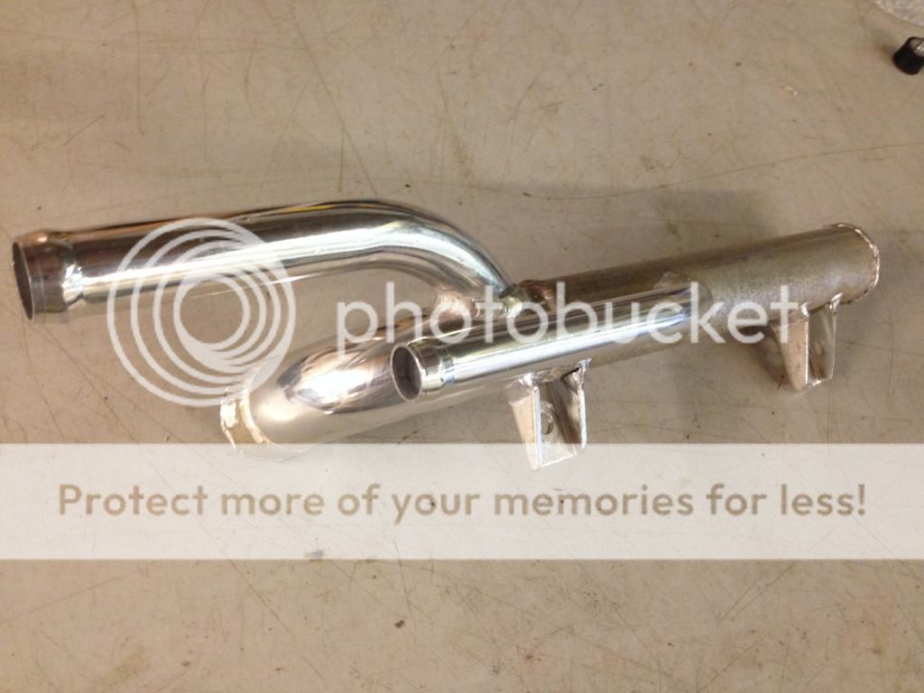

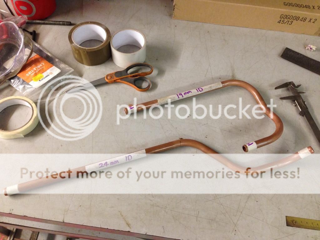

Then made up some templates for my new coolant feed hoses.
http://i995.photobucket.com/albums/a...ps096f68c4.jpg
Sent them off and went to see my welder friend who helped me knock this up together.
http://i995.photobucket.com/albums/a...pse862a434.jpg
Still might need the tails trimming, but will keep them long if I am able to due to the bead roll's.

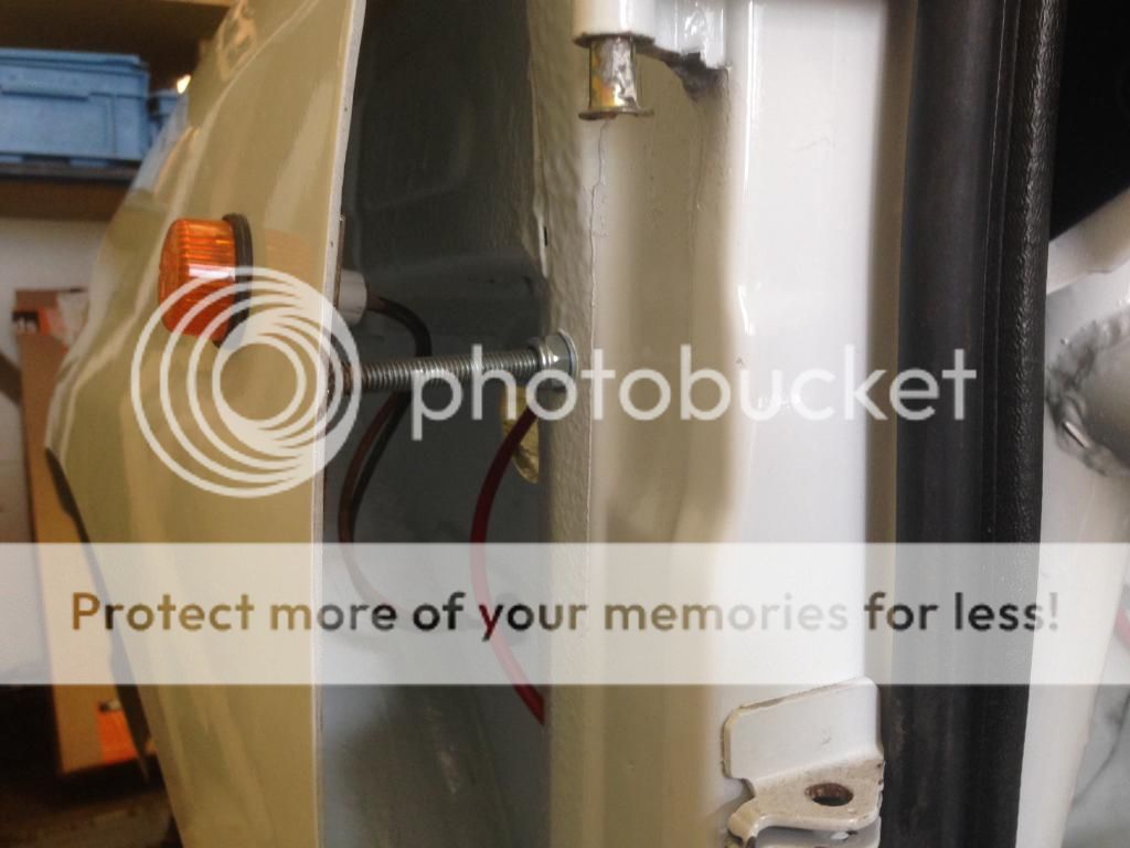

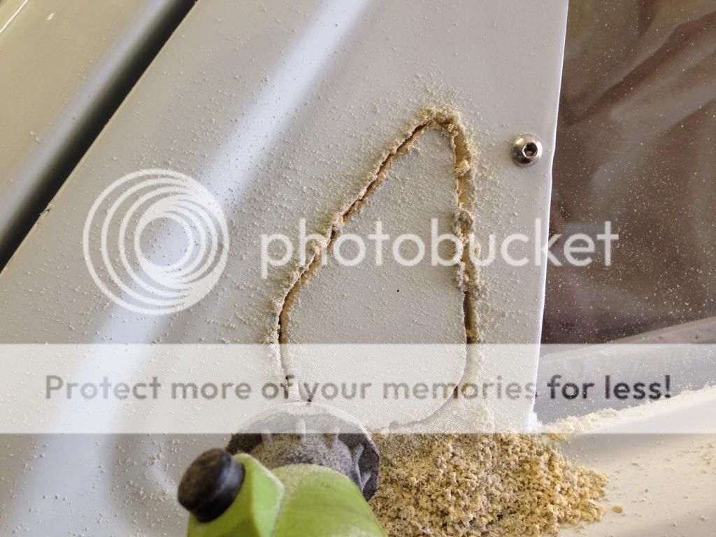

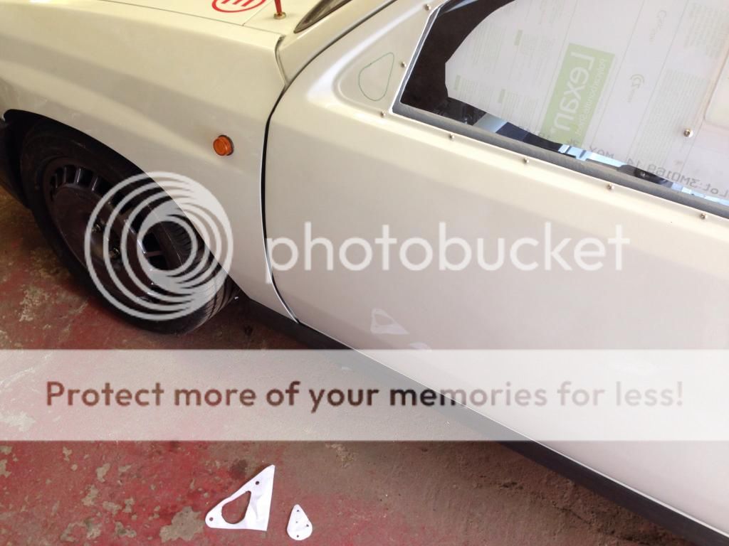

Side repeaters, (Thinking possible MOT).
http://i995.photobucket.com/albums/a...ps859a317c.jpg

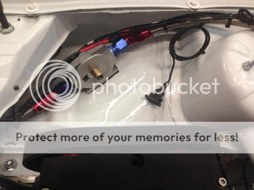

Oil filter
http://i995.photobucket.com/albums/a...psf0e82ae7.jpg

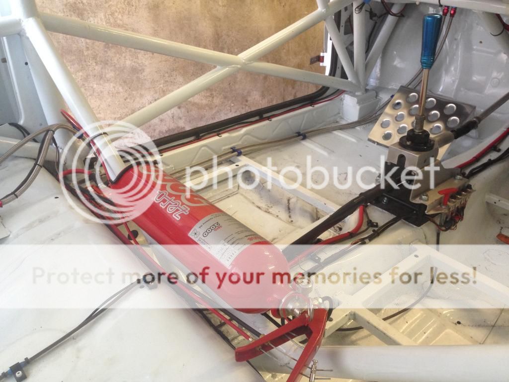

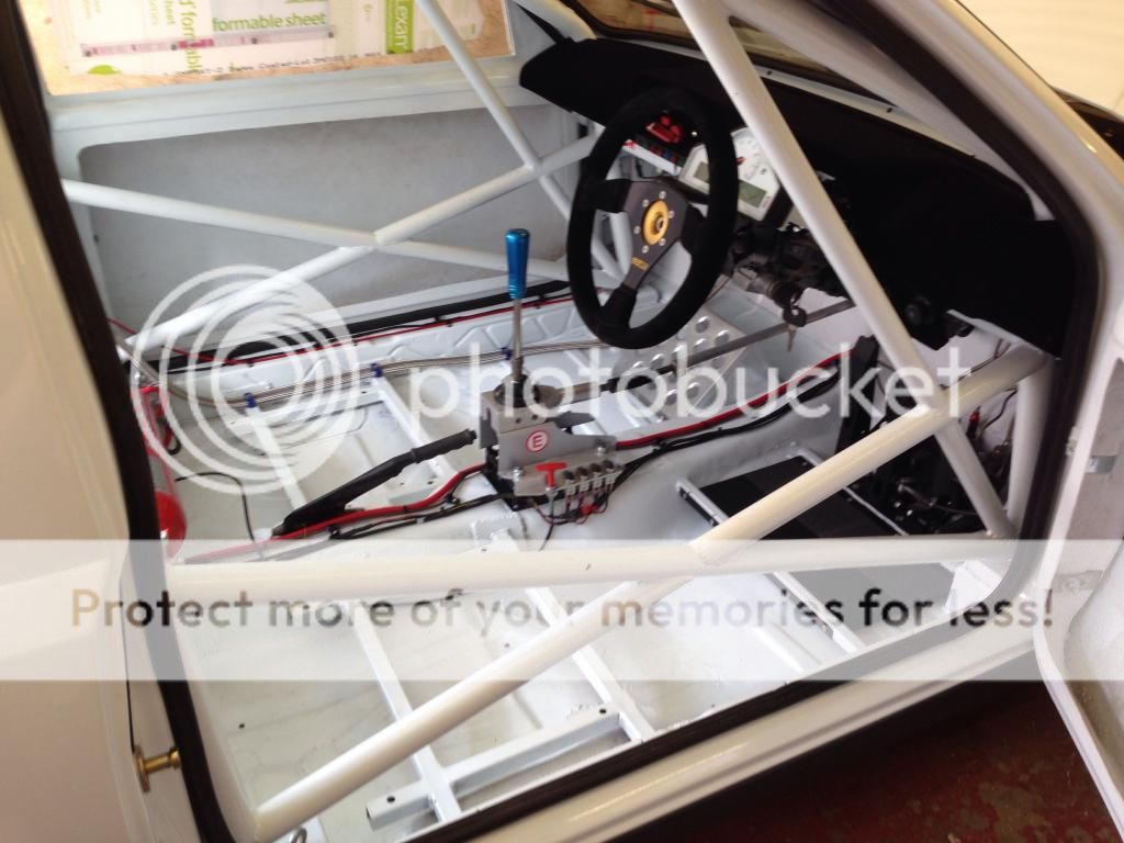

Exterior pull cords sorted.
http://i995.photobucket.com/albums/a...ps1acaa221.jpg
Fuel lines secured, cable's ran, passenger footrest in.
http://i995.photobucket.com/albums/a...psc029bf40.jpg

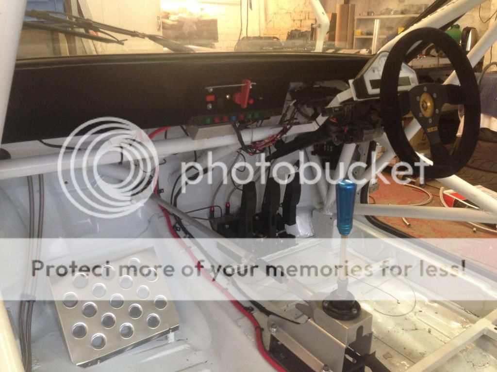

Dash flocked and re-assembled (Thanks Al)
http://i995.photobucket.com/albums/a...ps99ef745b.jpg

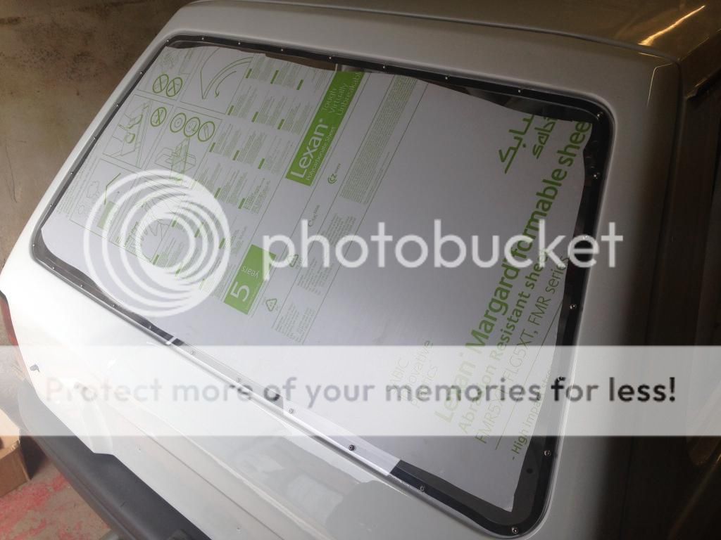

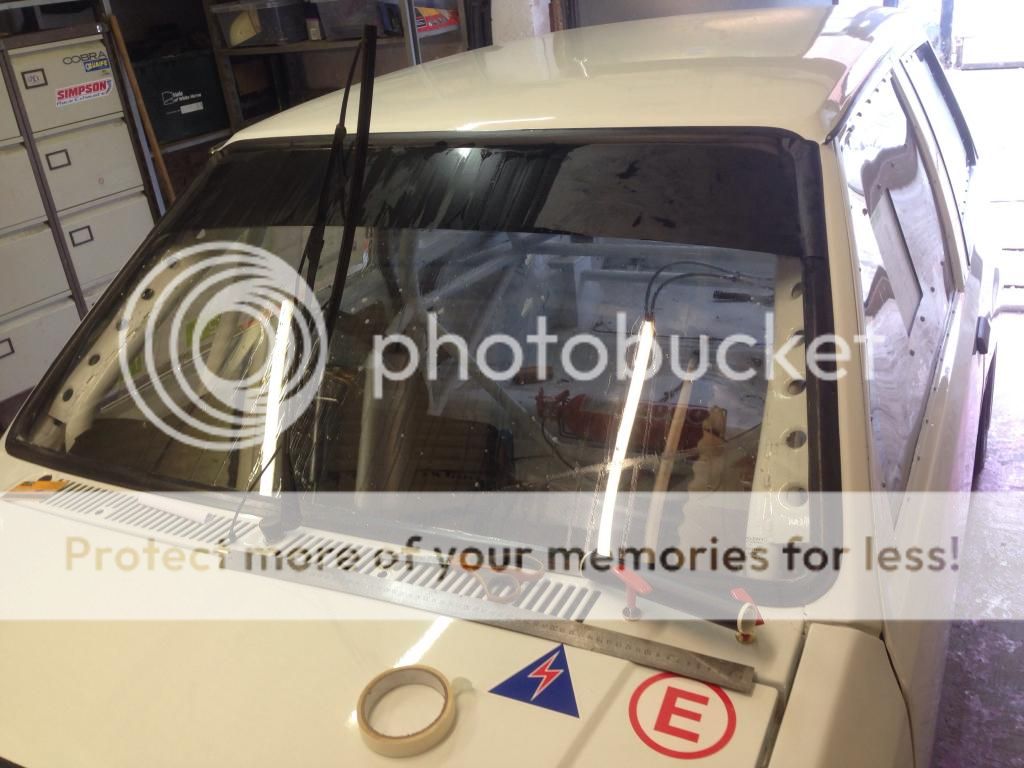

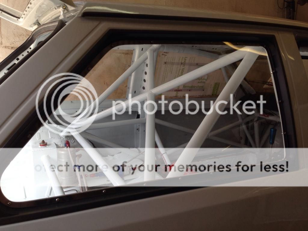

Rear window fitted.
http://i995.photobucket.com/albums/a...ps2d86a158.jpg

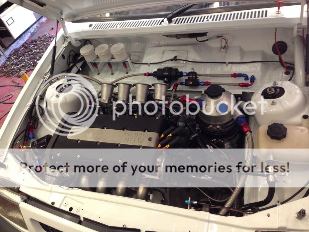

And finally the bay starting to fill up.
http://i995.photobucket.com/albums/a...pscfc26469.jpg
Shouldn't be long now. I just have one more bout of spending to do on Leads, Fuel reg and injectors then we should be good for a start up.

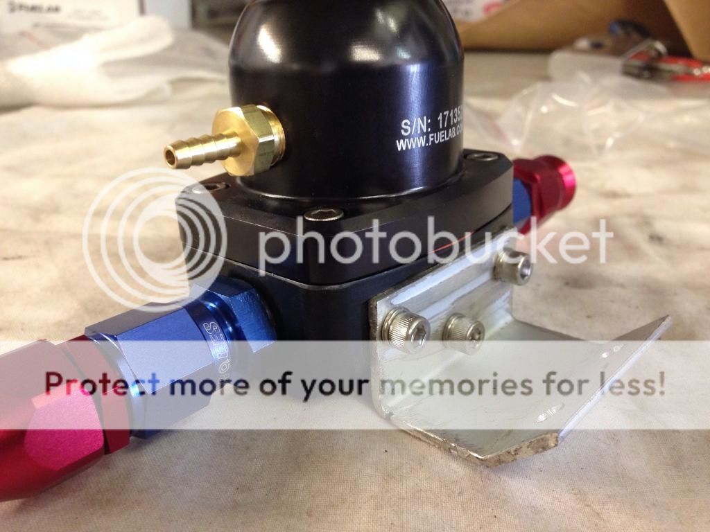

Superb! What regulator are you going for? May seem an odd question, but I've just bought a new aeromotive one.
Thanks Will. Im looking at the Fuelab regulators.

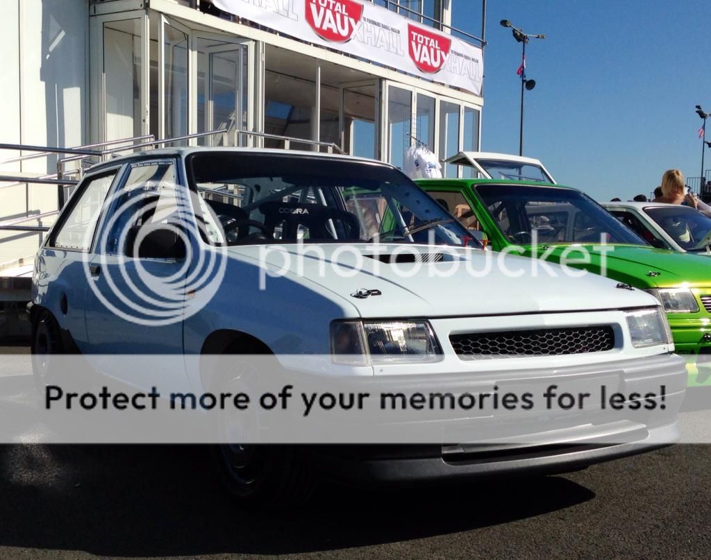

Anybody who attended PVS yesterday and wasn't completely overwhelmed by the vast variety of top class cars to look at may have spotted this at the front of the Total Vauxhall stand, looking remarkably complete. Its nigh on finished, and despite trailering it there, there is no reason why without some vital fluids it wont start up.

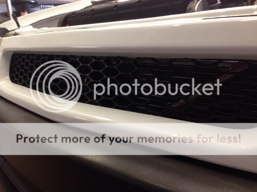

Front grill, Wasn't happy with the standard one so removed the slats and grafted in some honeycomb mesh from another vehicle.
http://i995.photobucket.com/albums/a...ps9cb88380.jpg

The only picture I have of the windows going in. 121 M4 stainless button heads with nylock nuts inside. I never want to see another 4mm drill bit or 7mm spanner again.
http://i995.photobucket.com/albums/a...pse2bc96e1.jpg
http://i995.photobucket.com/albums/a...ps5d961c23.jpg

Made a neat little bracket for the regulator and plumbed up the rail. Fuelab do supply one, but I didn't like it.
http://i995.photobucket.com/albums/a...ps56e6498e.jpg

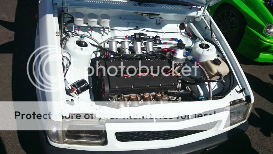

Under the bonnet finished.
http://i995.photobucket.com/albums/a...psb7f1aa56.jpg

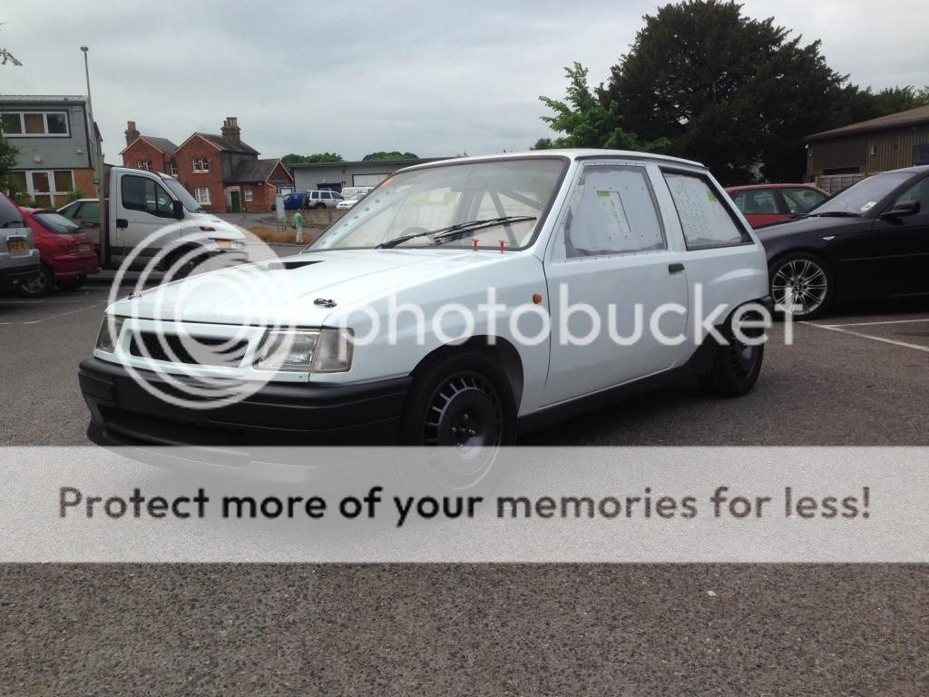

Seats went in at 9pm Saturday night, gave it a quick chamois off then home to bed. Back up at 3am to load it and arrived at Santa Pod 7:30.
http://i995.photobucket.com/albums/a...ps80e70b15.jpg
http://i995.photobucket.com/albums/a...ps5ee525e4.jpg

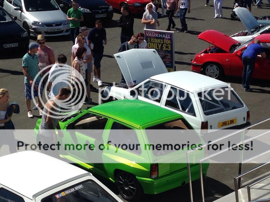

And a shamelessly stolen bay pic thanks to Johnny. I actually watched you take it but was lording it up on the balcony so couldn't say hi.
http://i995.photobucket.com/albums/a...psdec15477.jpg

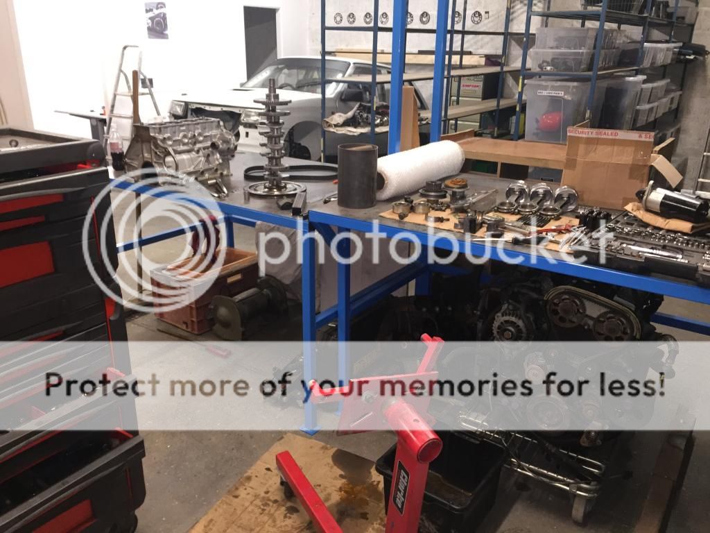

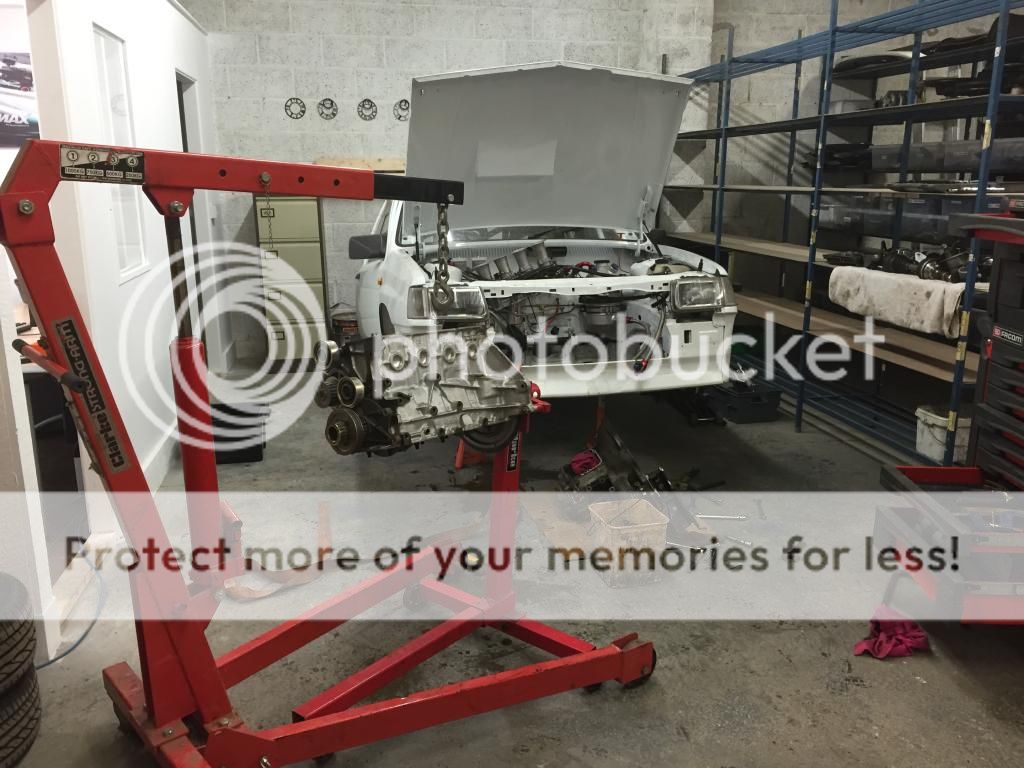

I spent last Sunday taking the remains out. The head was already off as its been for crack testing at Ridgeway, so didn't take long.
http://i995.photobucket.com/albums/a...ps487593b4.jpg

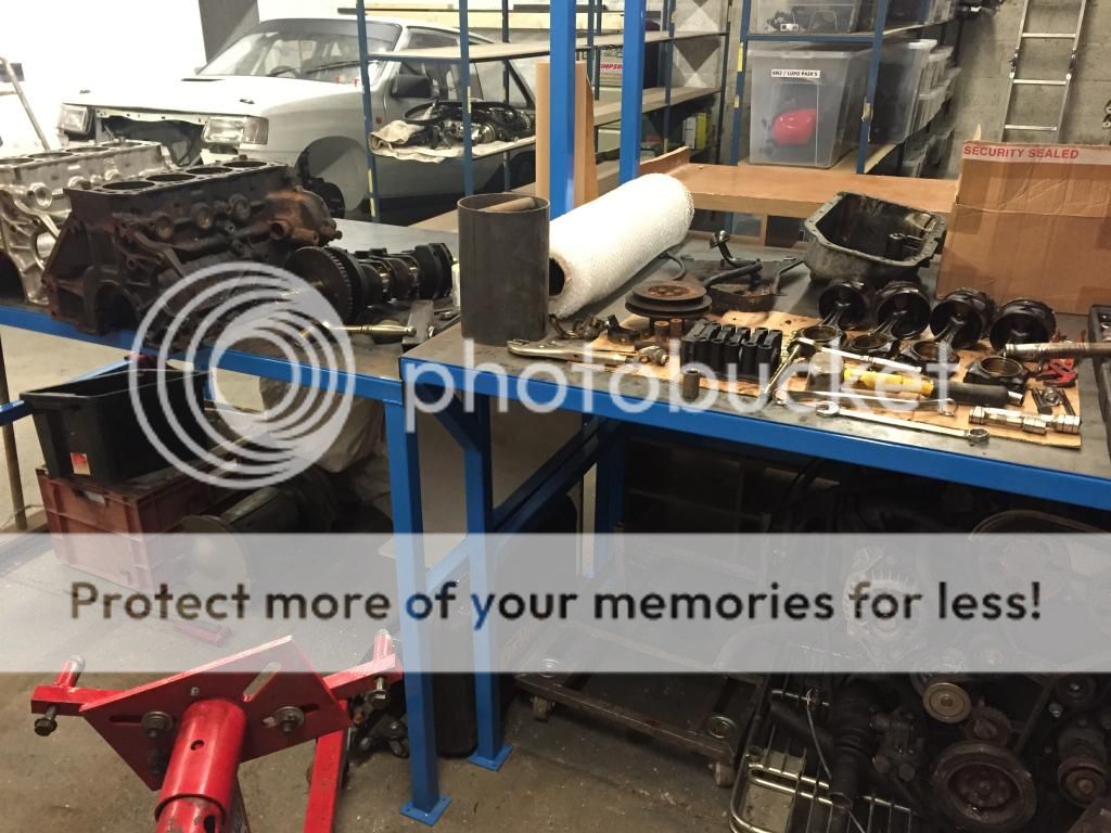

Got the rest of it apart.
http://i995.photobucket.com/albums/a...ps32f4d4c0.jpg
Then seeing as I'l be needing a new block and crank decided to strip another XE as a donor.
http://i995.photobucket.com/albums/a...ps64a966c0.jpg
