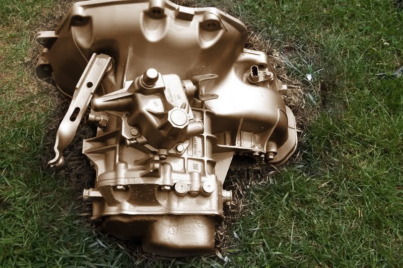

I done my corsas gearbox silver, used spray hammerite smooth. Two coats was enough and it looks fine imo
http://i252.photobucket.com/albums/h...6/100_4087.jpg
/\/\/\/\/\/\/\ nah
\/\/\/\/\/\/\/ win
http://i345.photobucket.com/albums/p...OLDGEARBOX.jpg
LOL. You even got the grass to go gold...
That end cap needs wire brushing & doing again.
Looks good. Can Hammerite be laquered?
Gold looks alright Southie but I dunno lol
It was a quick spray job but looks more realistic lol
Looks like AW06 rushed his silver one that's why the end is still peeling away.

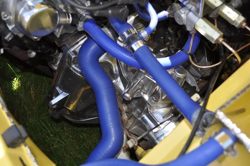

What about Phil Lofthouse's (iirc) highly polished box!
http://i5.photobucket.com/albums/y19...0052_Small.jpg
Hand polished f20 looks ace
The polished box looks good but it was a pain cleaning the thing, can't imagine how hard it'll be to polish it :(

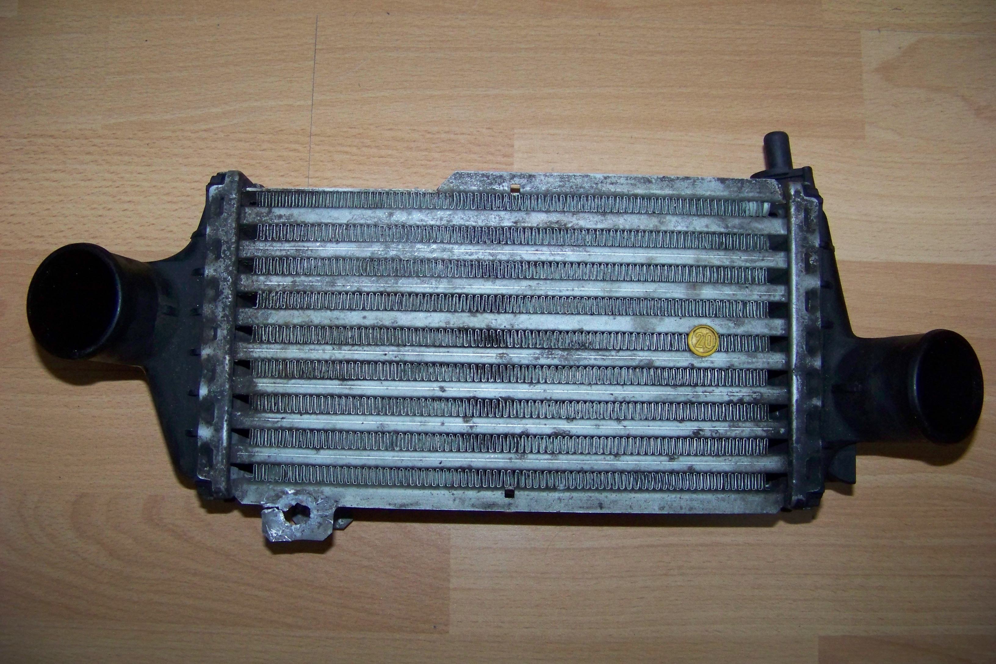

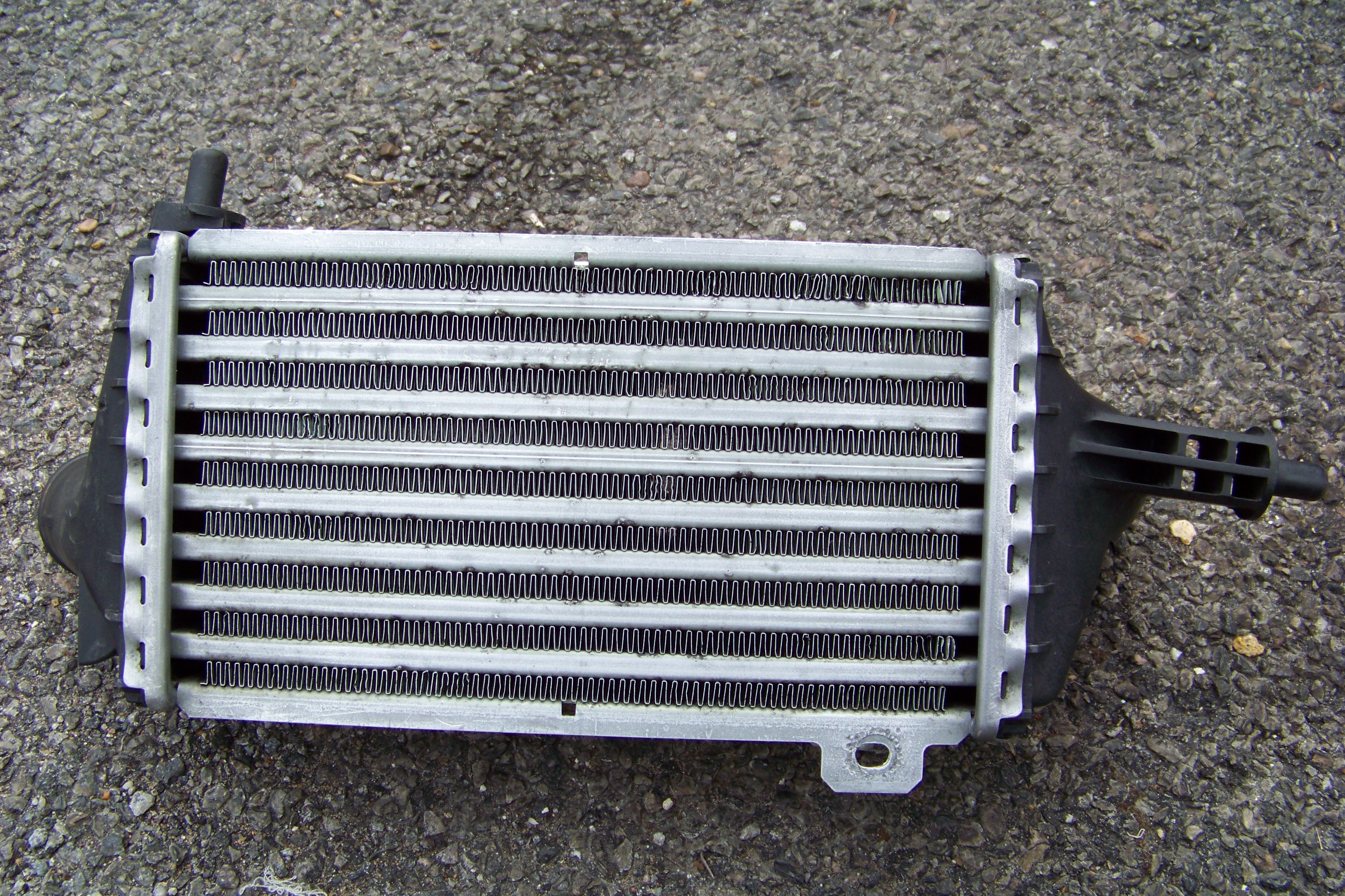

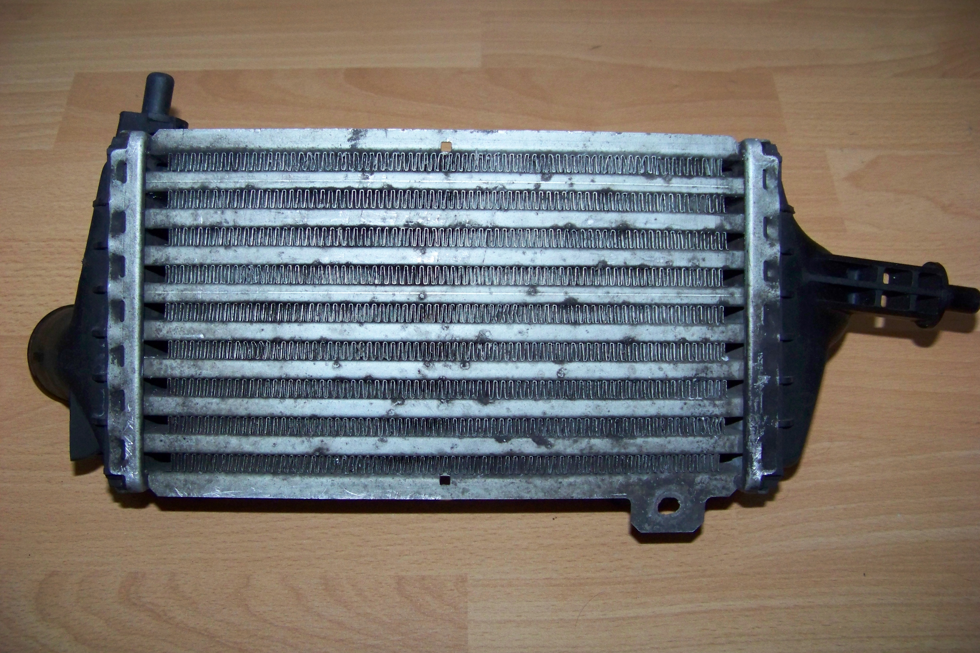

Another day of cleaning, this time the intercooler. Not that it was filthy but it could do with a clean.
Again used the ususal stuff, wire wool, detergent, degreaser, toothbrush etc. It came out rather well. There were also a few bent fins which I bent back into its correct position and shape.
Before

http://a.imageshack.us/img13/1219/1001780a.jpg
https://images2.imgbox.com/e0/ae/3XKBLHuG_o.jpg
After
https://images2.imgbox.com/b0/7c/quwbtUJ0_o.jpg
http://a.imageshack.us/img411/2161/1001782o.jpg
https://images2.imgbox.com/9b/0c/F0Fh7NnY_o.jpg
Sometimes the fun is seeing a used part look almost new with just a clean. The way I see it is if I don't use it, I'll put it on eBay and get back more than what I paid for it ;)
Came up like new mate :) I'm into the OE look rather than painted and polished etc
any idea how your going to get the intercooler to fit ?
Yes mate, came up well, nice and bright.Quote:
A few bent fins but still nice and straight, well chuffed with it as I only got it for £12 lol
Somethings look good OE but at times things are difficult to get back to OE look without a lick of paint (obviously a colour that looks OE :) )
You sold your project or stil got it?
It's still here mate...Not touched it though since the last update on the thread
Have a couple ideas, but need to get the Nova out and mock fit the new rad and fan just to try mock up the intercooler.Quote:
Originally Posted by Edd
Hope you get your enthusiasm back and get it finished ;)Quote:
Maybe one day lol :)
i do think this project is cool as funk!
but really do not understand your choice on intercooler. going to be barsteward to mount and get to function properly. especially without bodging it in.
Should have got a frontera one mate, nice and easy to fit and there only cheap. also look OE.
Just my input, as the engine bay gets feckin hot on my let nova
Cheers dude.
In have read up about the Frontera one, did look big but have seen others use it. Not sure how effective it'd be with a snowplough, so I thought I'd try something a bit more compact. I know it may be a task to fit but have to try.
If it goes t*ts up then it only cost £12 and now that it's clean I'd get more for it probably lol
That intercooler is a bad move IMO. Too small & hard to actually fit infront of the rad. I used to have a BMW 5 series intercooler which would've been ideal for you, but couldnt flog it so binned it. doh!
We'll see how good/bad it will be. It can handle power (ok not major power maybe upto 250BHP) but for the time being that is much more than I'm looking for. It may be awkward but I'll find a way to fit it. If not then I'll buy something else.

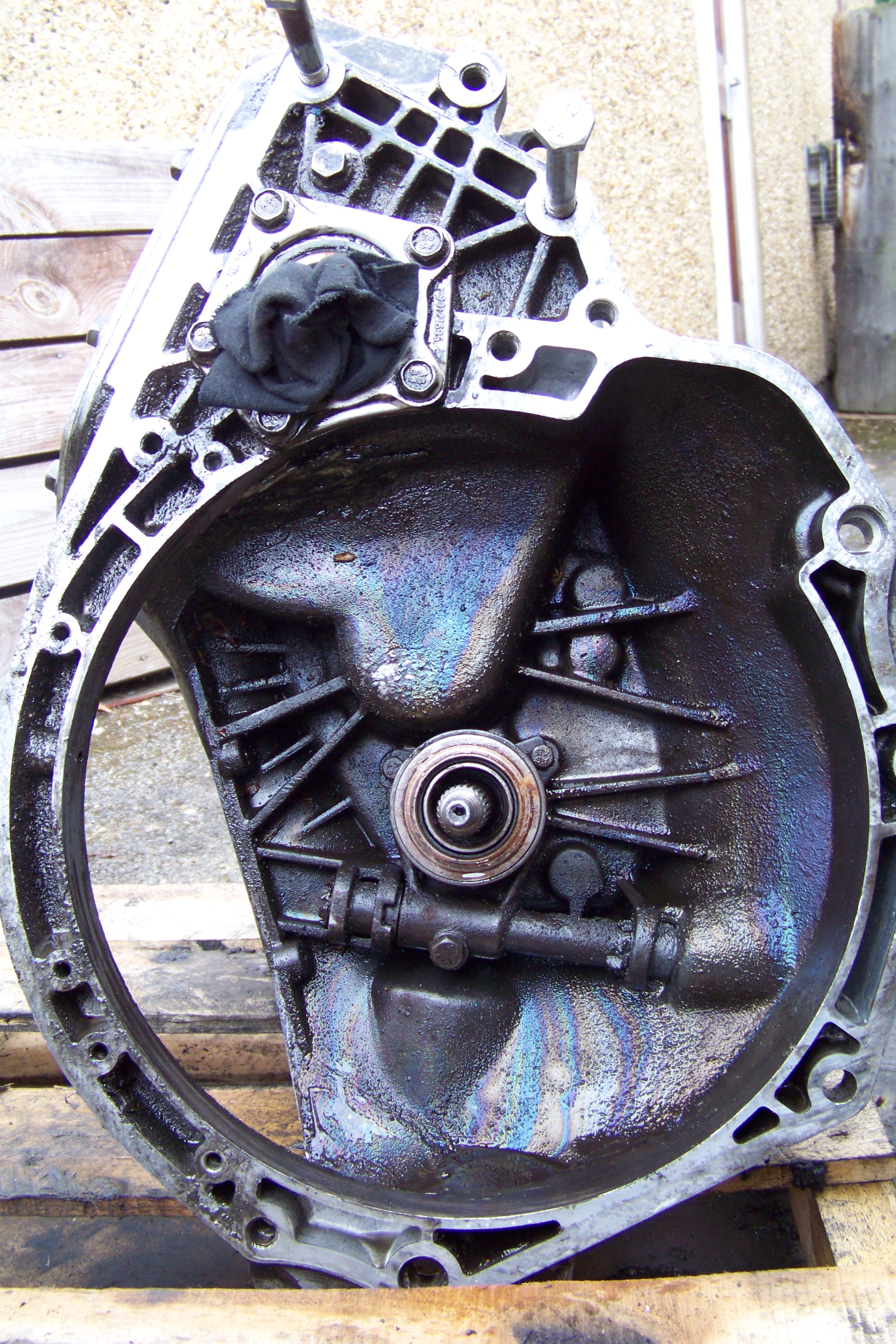

I wanted to finish off the gearbox so I could prepare it for paint. Really didn't like the inside all greasy and full of crud, so I decided to get that and the inspection plate sorted.
Before I started
https://images2.imgbox.com/33/f2/jXgyEsvd_o.jpg
https://images2.imgbox.com/56/70/j1zSmLGR_o.jpg
^^Inspection plate full of crap, sprayed degreaser on it to loosen the oil/grease.

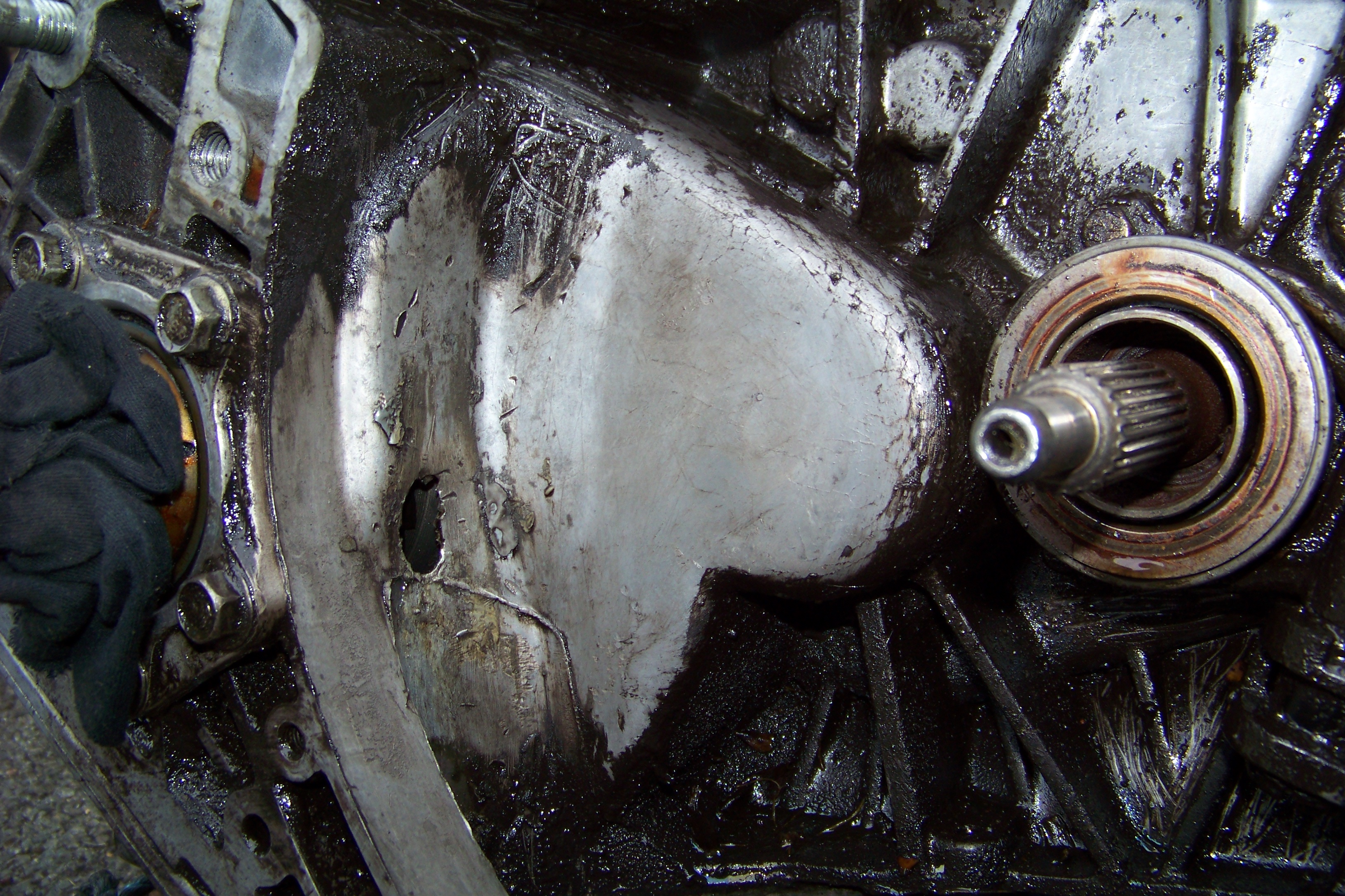

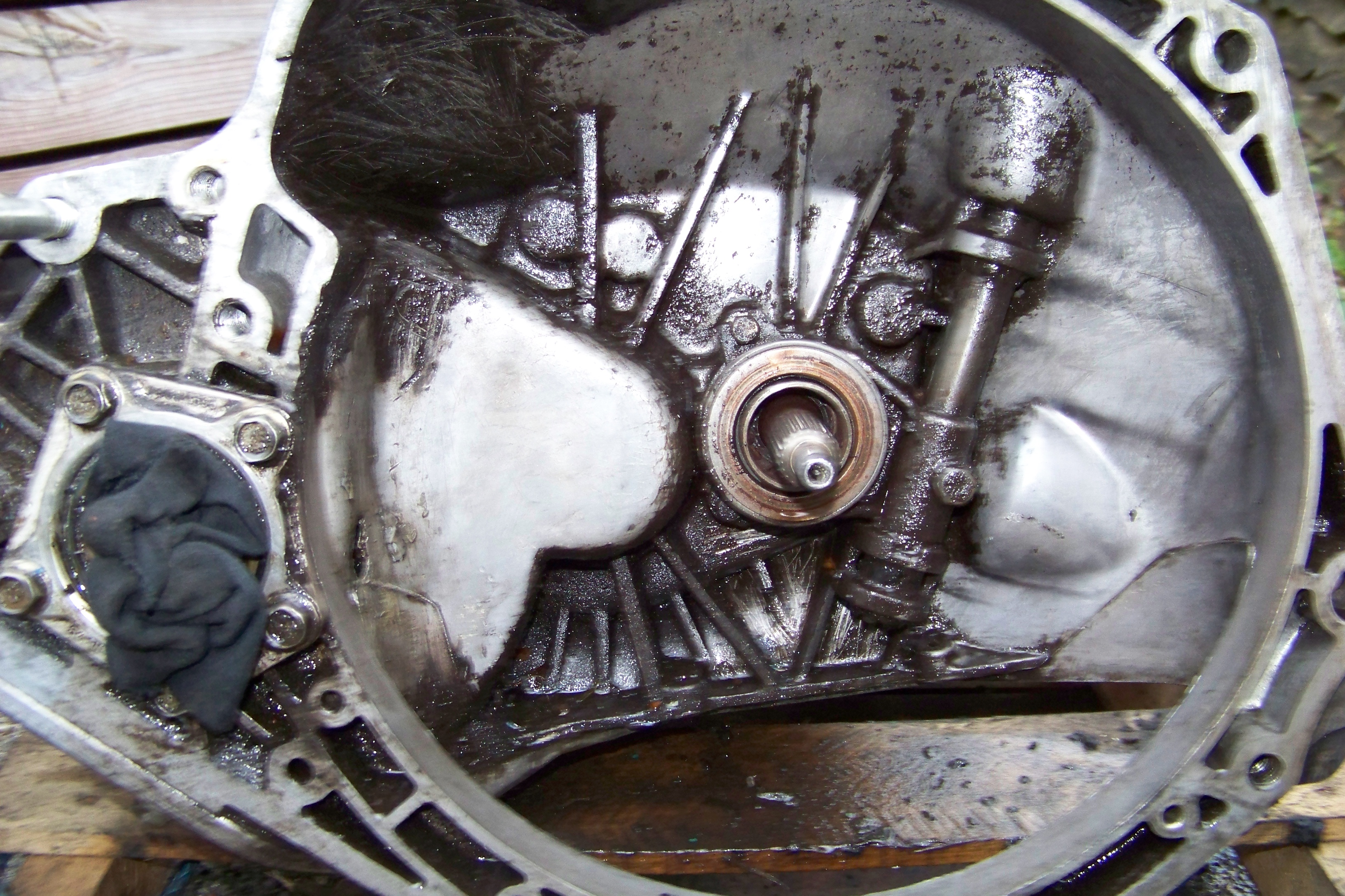

The cleaning was going well, even though it was taking a lot of elbow grease to shift all of that gunk. As I continued cleaning the inside area, I went to scrape off what looked like a dollop of grease. On further inspection it was rock hard... tapped it with a screw driver and it sounded hollow. Decided to investigate further, top part of this foreign matter seemed to have a gap bewteen it and the metal. I put the screw driver in between it and prised it open.
Here's what I found
https://images2.imgbox.com/31/16/4aivN79u_o.jpg
Close up
https://images2.imgbox.com/30/28/1CM8VWUF_o.jpg
This really pissed me off!
Now I dunno what I should do with it, attempt a repair or use it as spares? Would a repair be possible or would it be risky? I'm guessing, from looking at the location of the hole that the only problem is fluid leakage and guess that it wouldn't impede the operation of the box as long as it was repaired and sealed well.
What would cause that to happen anyway?
Once I saw that, I gave up and went indoors and I'm still not in very good mood :mad:
Get it welded over...
Was thinking that, any other method to plug it would be a bodge (like it was)

was the gear box sold to you being stated as a good one? if so, id take it a welding place and have it tig'd up. depends if you want to take a risk on the internals being fine. you could always have a gearbox specialist strip it down and inspect to make sure all is good before you have the case repaired.
keep it up bo.
Poor luck on the gearbox matey!!
I have seen holes larger than this plugged in work.
They use a piece of copper behind the hole, and fill it with a pool of weld.
A local fab/engineering shop will be able to sort it.

Got it off a user on Mig IIRC he's on here too. Was sold as a 'good'un' with 75k on it. Don't wanna name names as sometimes if this box was bought and sold on then the seller may not have even been aware, so it may be unfair to speculate.
Hard one to call, I got it end of may, but I wasn't around and only recently have been able to inspect it so... you know.
Will have a word with my mechanic to see if he knows any specialists that can have a look for a decent price, would be nice to get it inspected and feel reassured that it's a good'un.
Looking at where it is, repairing it won't cause an issue, so I'll go ahead and get it repaired. Really considering to get it checked though.Quote:
