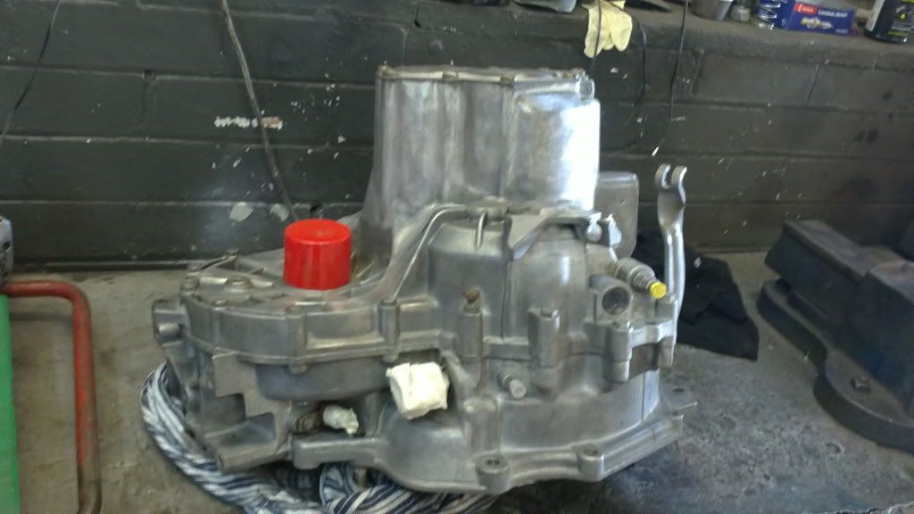

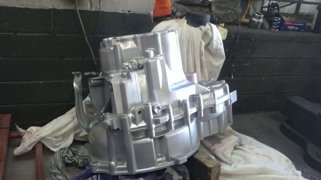

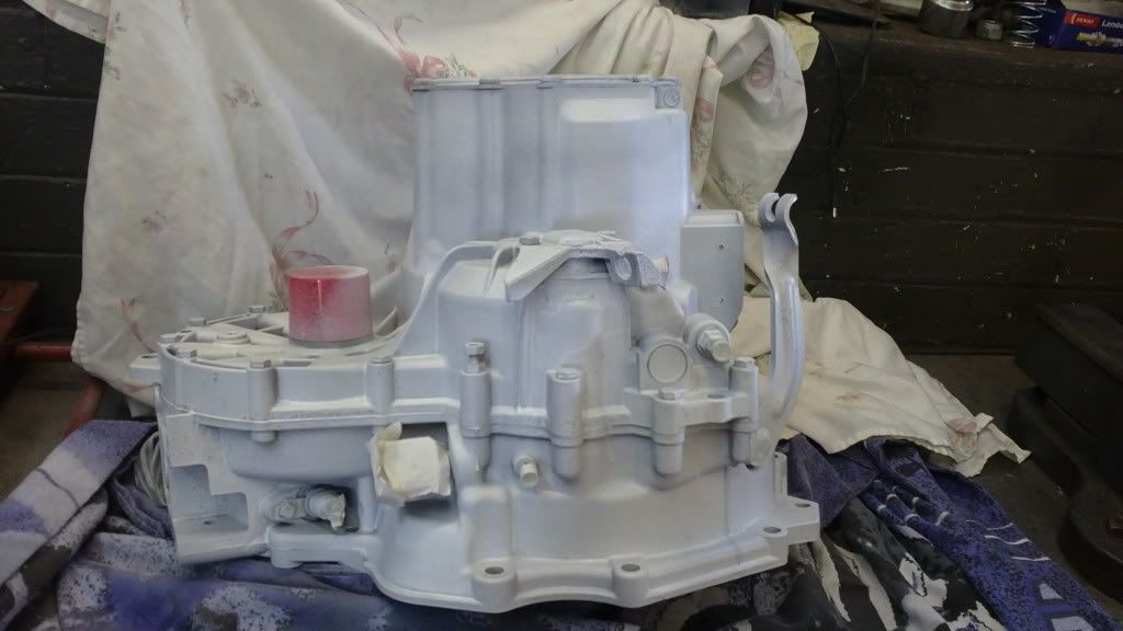

during the week the gearbox got a freshen up. mire wheeled it down ready for the primer. once primered, it got a coat of silver.
http://i193.photobucket.com/albums/z...0042011180.jpg
http://i193.photobucket.com/albums/z...0042011182.jpg
http://i193.photobucket.com/albums/z...1042011183.jpg

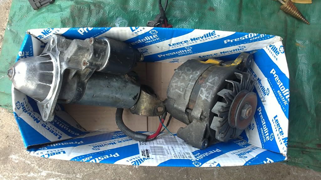

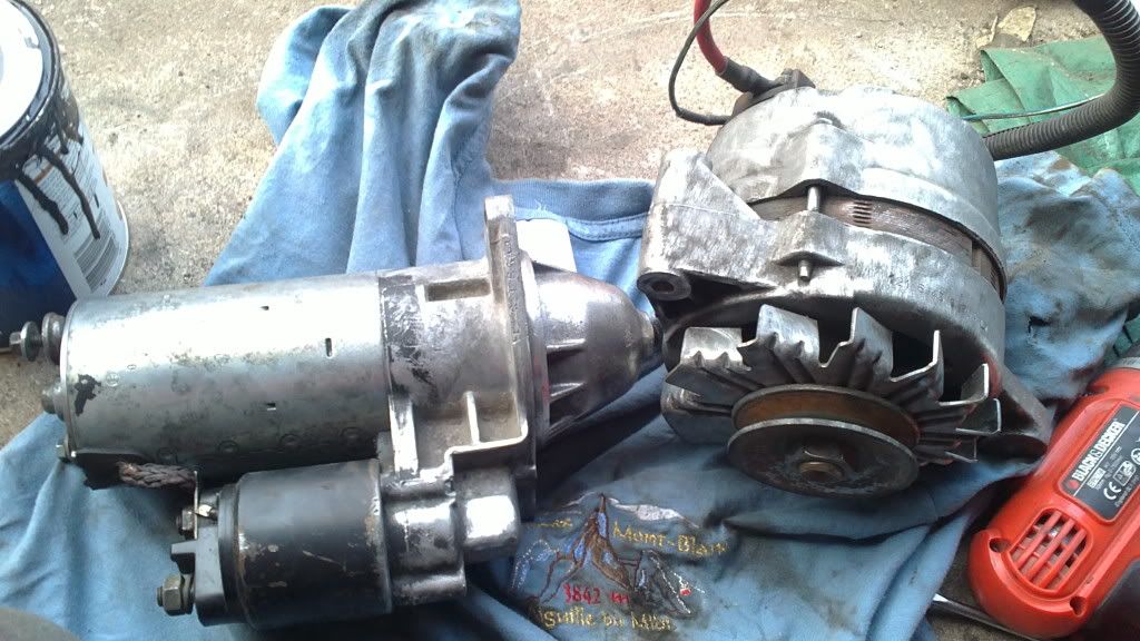

picked up my starter and alternator which i had checked over and a couple internal things replaced. were rather grubby so wire wheeled them and gave them a quick coat of black.
http://i193.photobucket.com/albums/z...1042011184.jpg
http://i193.photobucket.com/albums/z...1042011185.jpg
http://i193.photobucket.com/albums/z...8/DSCN3060.jpg

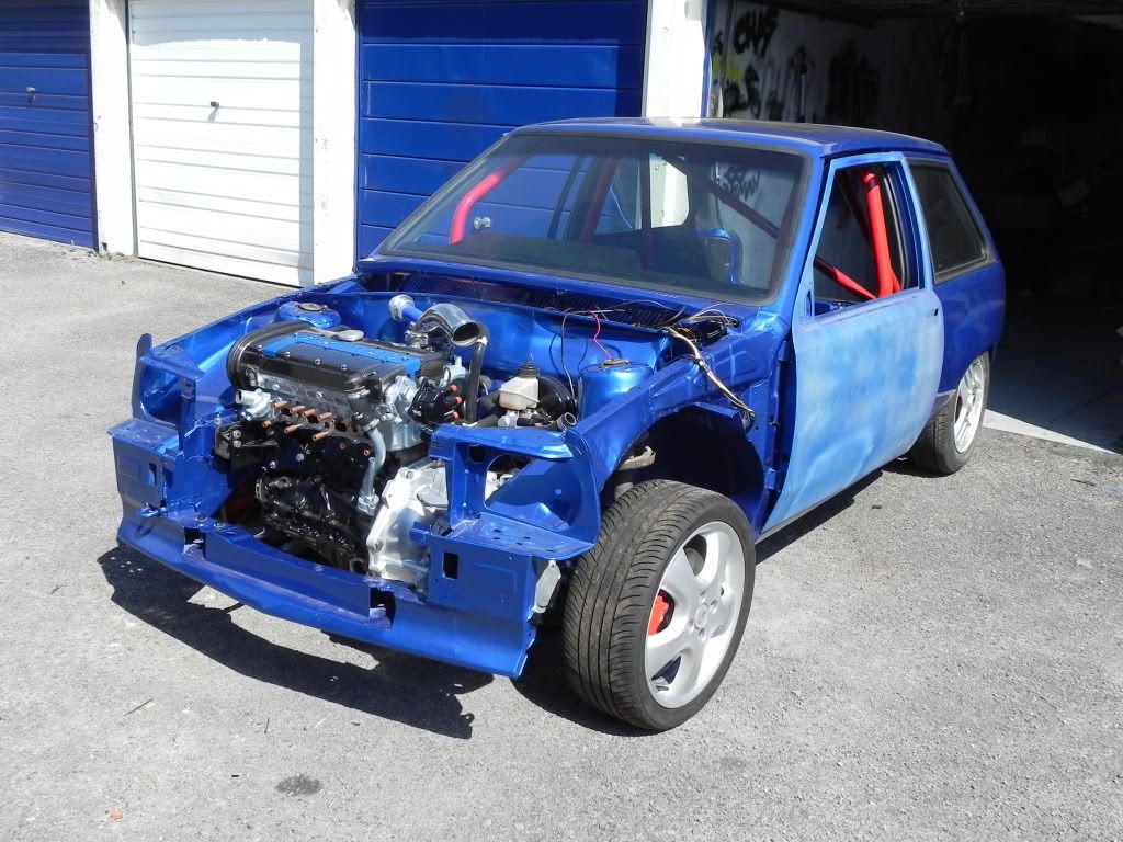

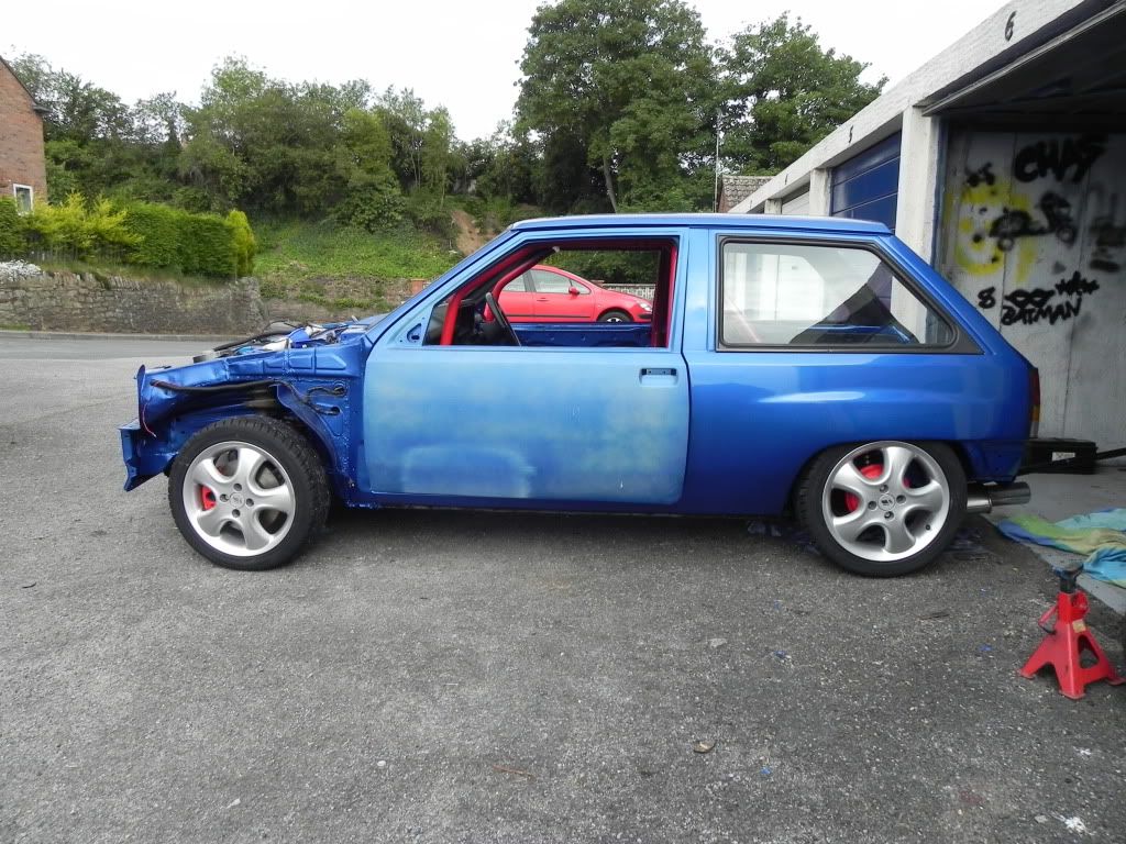

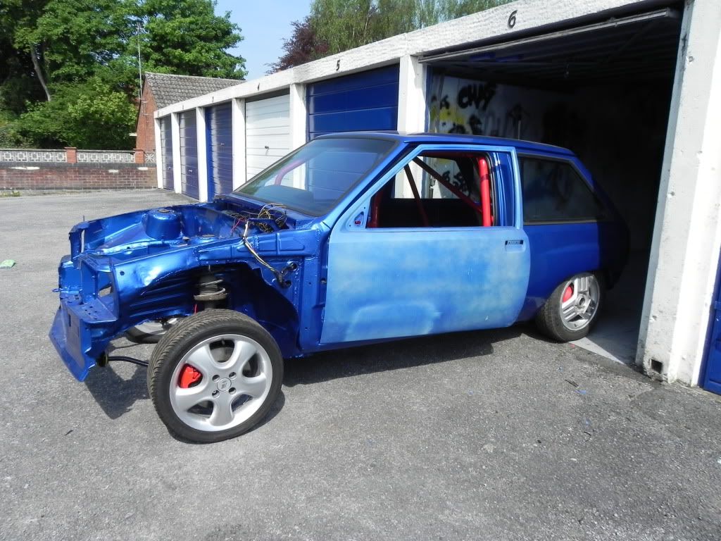

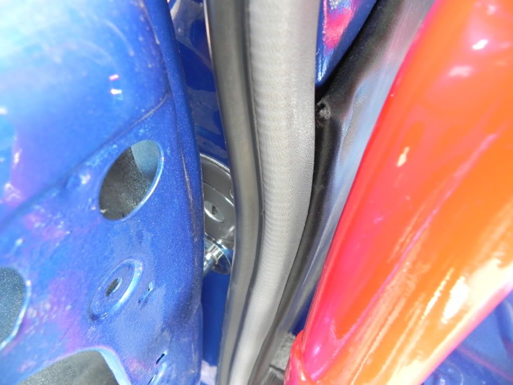

today saw more progress on the car, not much though. both doors fitted on awaiting paint. i didnt use the original door pins but m8 x 60mm button head bolts and nyloc nuts.
http://i193.photobucket.com/albums/z...8/DSCN3056.jpg
http://i193.photobucket.com/albums/z...8/DSCN3055.jpg
fortunatley the door misses the filler cap.
http://i193.photobucket.com/albums/z...8/DSCN3059.jpg

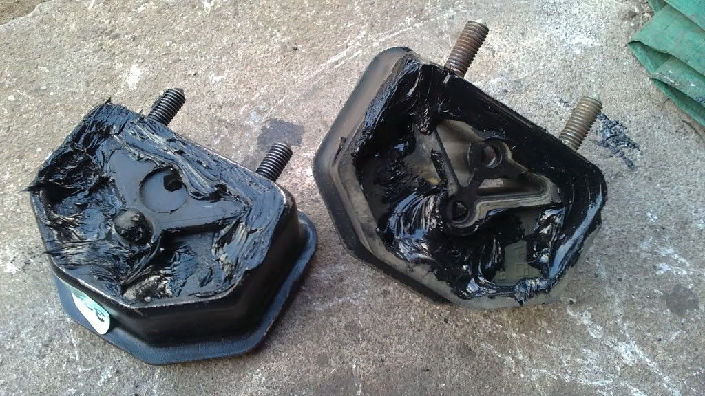

filled both the front engine mounts with lots of the black stuff
http://i193.photobucket.com/albums/z...1042011186.jpg

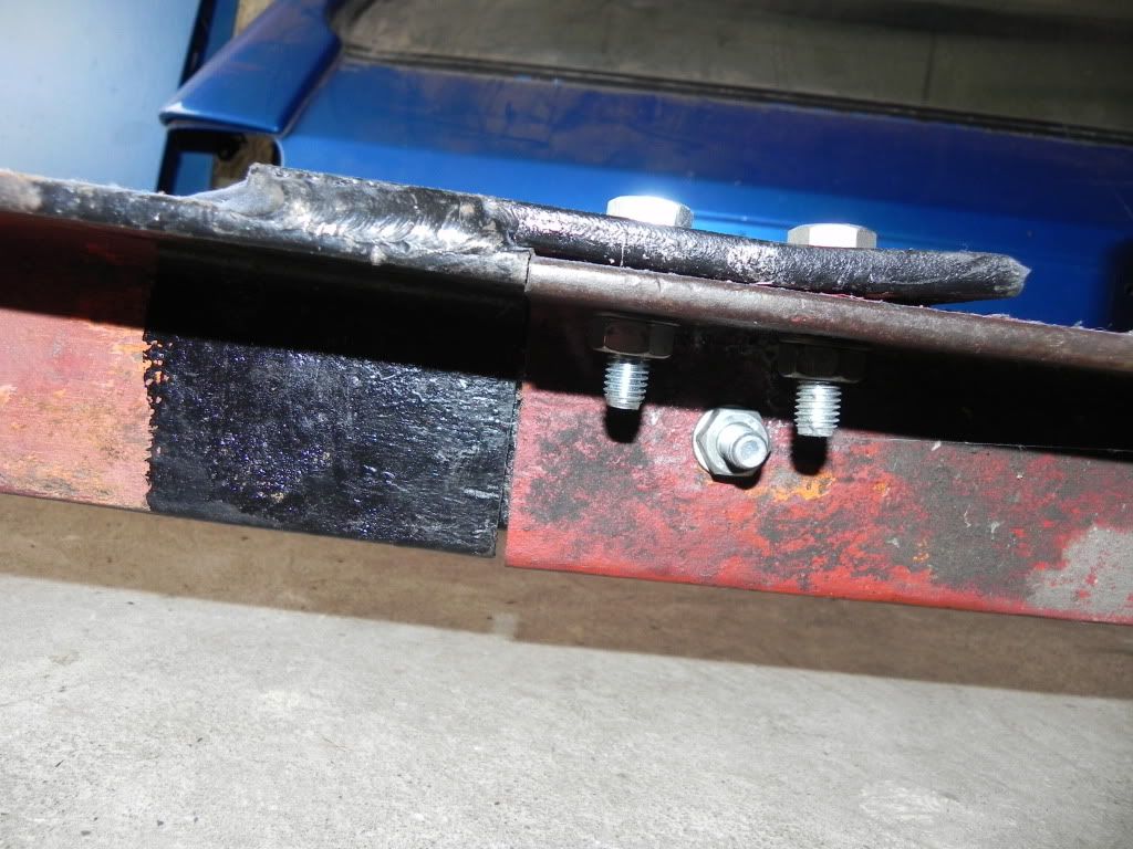

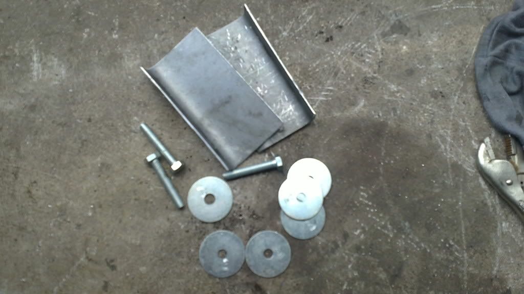

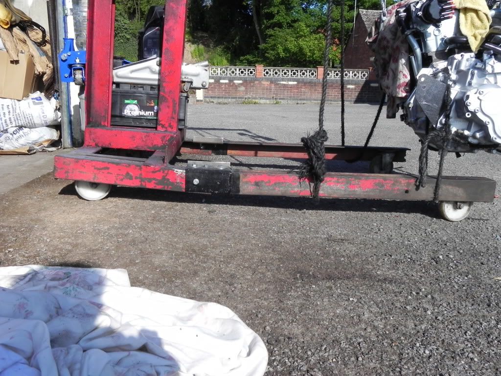

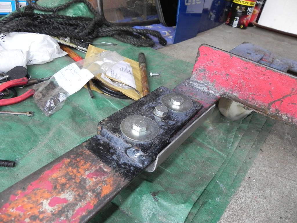

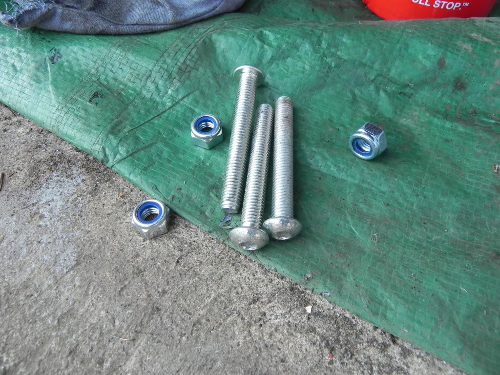

now, some of you might remember what happened with my engine crane when i used it last. if not, check page one.
put a little thought into the strengthening of the legs, quite a cheap fix and hope it holds up. i got 2 3mm thick plates and bent the one edge up 90degrees to provide some strength to it if it decided to bend again. got some wide washers to spread the load even more from any stress of having the engine on the crane.
http://i193.photobucket.com/albums/z...1042011187.jpg
http://i193.photobucket.com/albums/z...8/DSCN3054.jpg
http://i193.photobucket.com/albums/z...8/DSCN3062.jpg

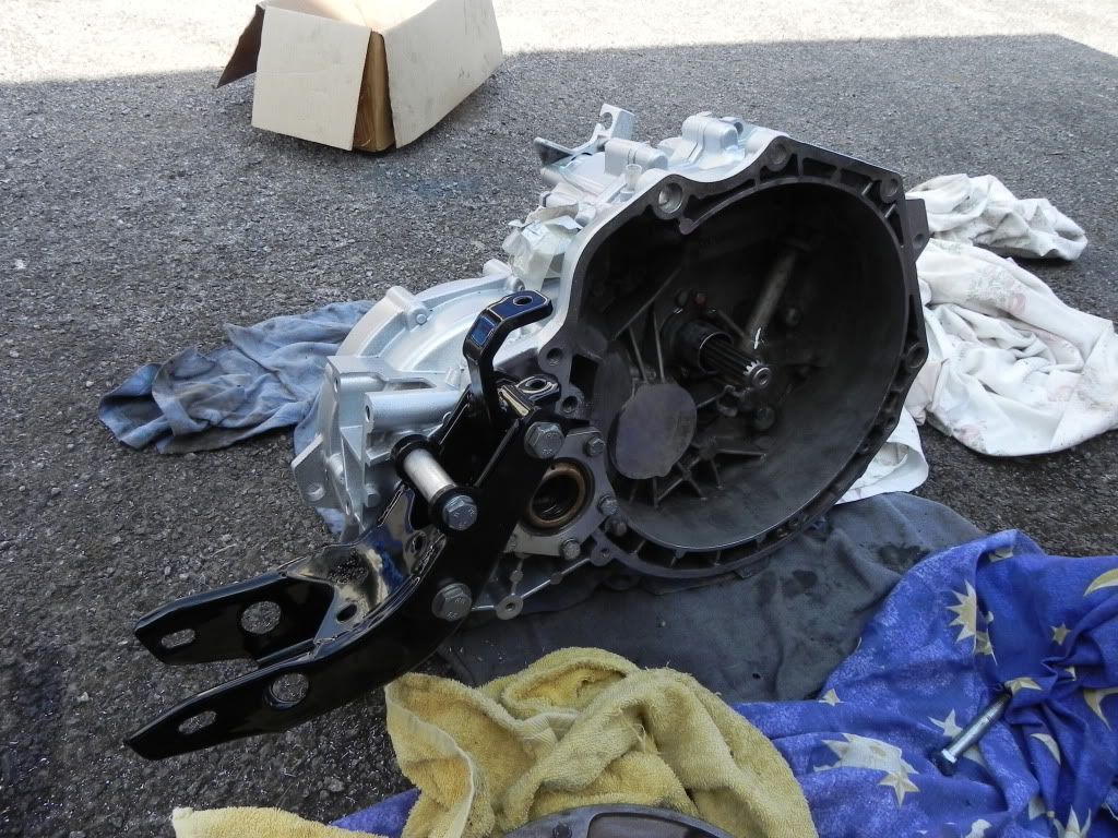

fitted both gearbox mounts to the box ready to be mated to the engine.
http://i193.photobucket.com/albums/z...8/DSCN3061.jpg

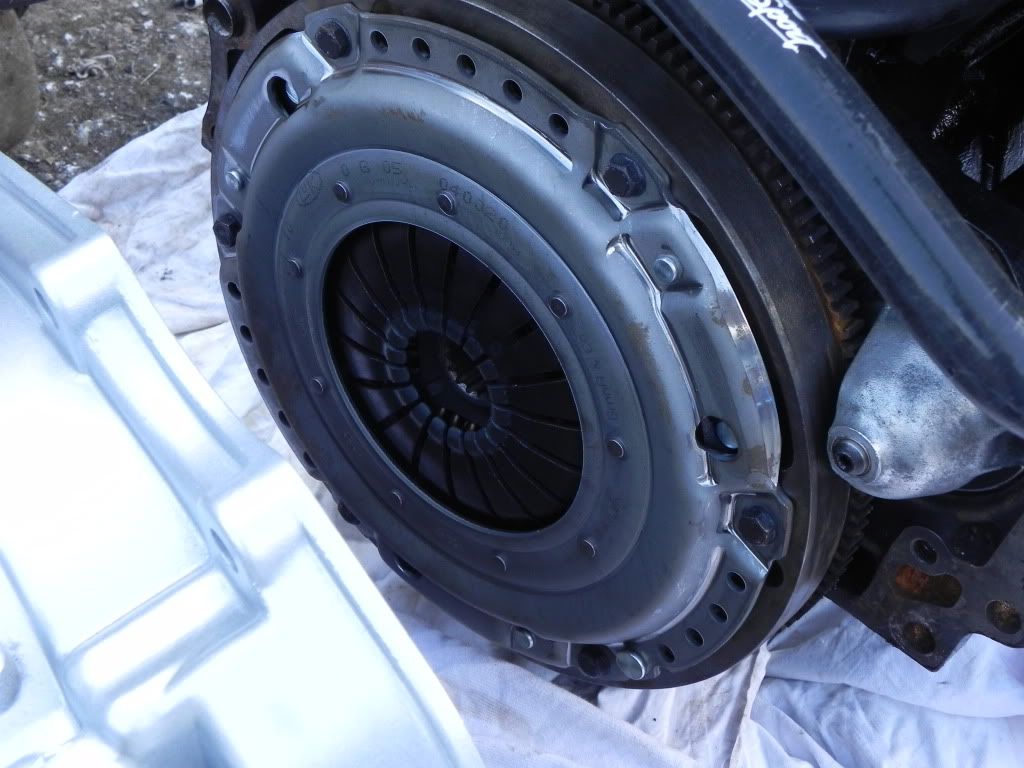

fitted the flywheel with the arp bolts and clutch onto the engine.
http://i193.photobucket.com/albums/z...8/DSCN3063.jpg

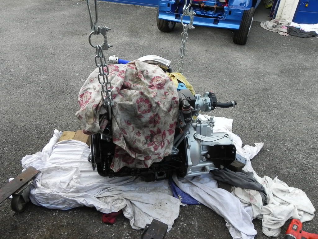

got the gearbox ready to attch to the engine. was rather tricky doing it alone and on the ground, but i got it on and bolted up.
http://i193.photobucket.com/albums/z...8/DSCN3066.jpg
http://i193.photobucket.com/albums/z...8/DSCN3065.jpg

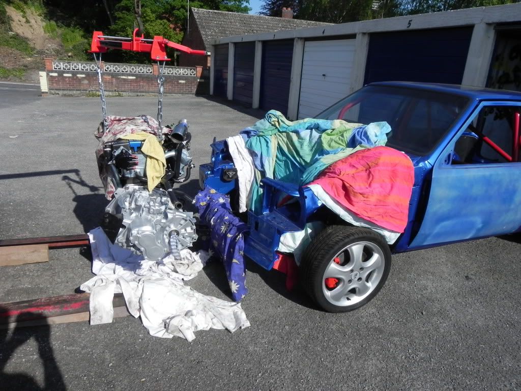

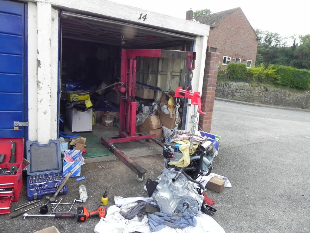

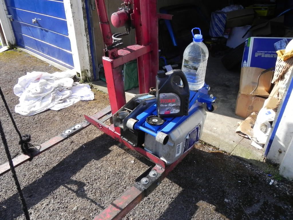

this morning i went down my garage armed with some ballast to stop the crane tipping.
http://i193.photobucket.com/albums/z...8/DSCN3071.jpg
all full with water
http://i193.photobucket.com/albums/z...8/DSCN3073.jpg

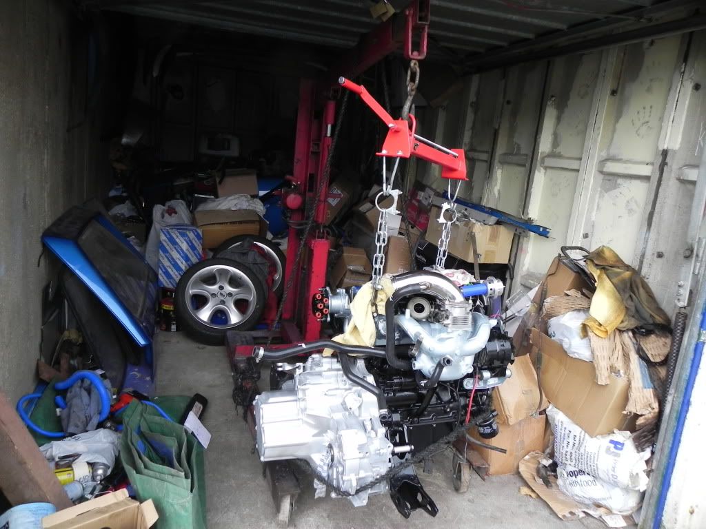

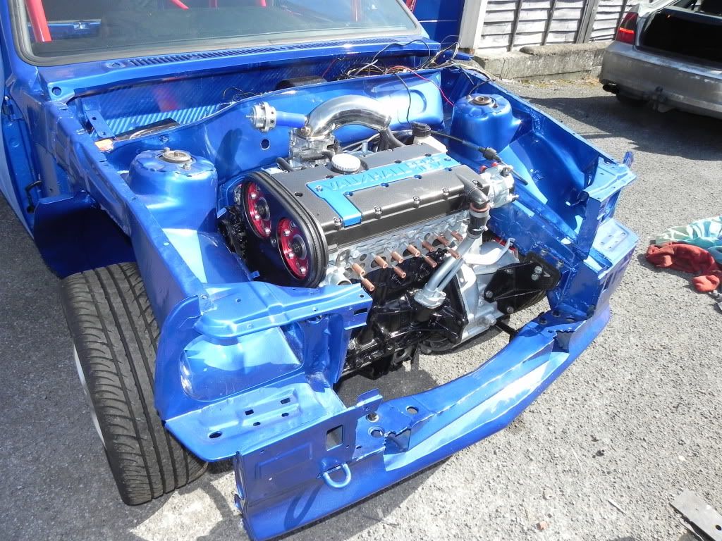

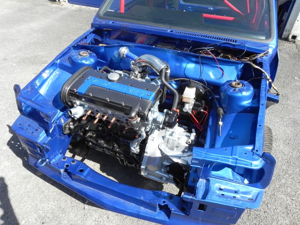

got the engine in the air and tilted sideways ready for entry, brought the car closer to roll the engine into it. the crane was still bending.
http://i193.photobucket.com/albums/z...8/DSCN3074.jpg
http://i193.photobucket.com/albums/z...8/DSCN3075.jpg
got the engine in eventually and all the mounts lined up. pic of me looking busy. :d
http://i193.photobucket.com/albums/z...8/DSCN3082.jpg
http://i193.photobucket.com/albums/z...8/DSCN3090.jpg
http://i193.photobucket.com/albums/z...8/DSCN3094.jpg
http://i193.photobucket.com/albums/z...8/DSCN3110.jpg

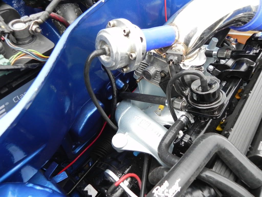

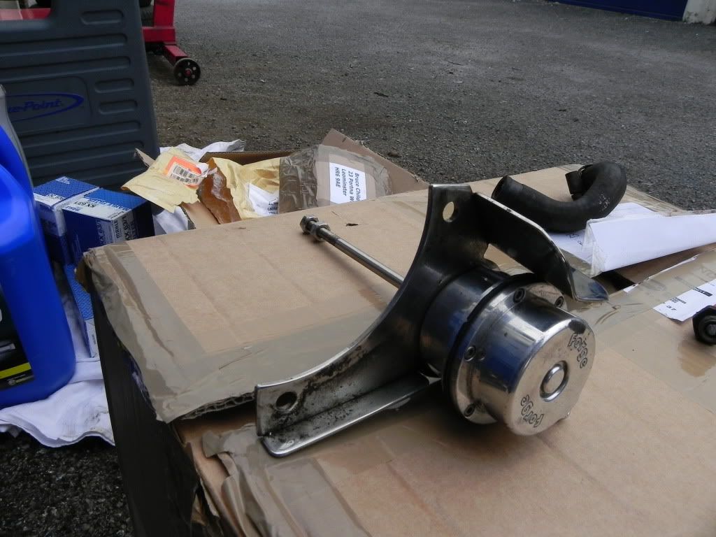

purchased a 3month old forge actuator for the turbo
http://i193.photobucket.com/albums/z...8/DSCN3578.jpg
painted the turbo in heat paint (like mr tek has) and fitted the actuator.
http://i193.photobucket.com/albums/z...8/DSCN3579.jpg

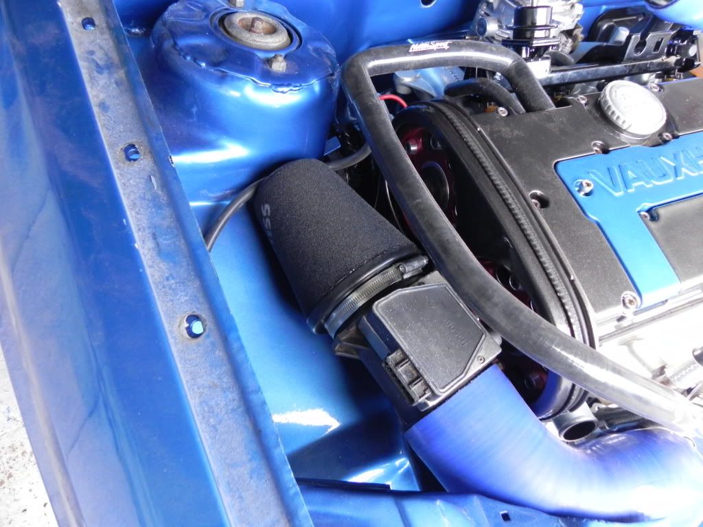

pipercross air filter turned up also
http://i193.photobucket.com/albums/z...8/DSCN3629.jpg

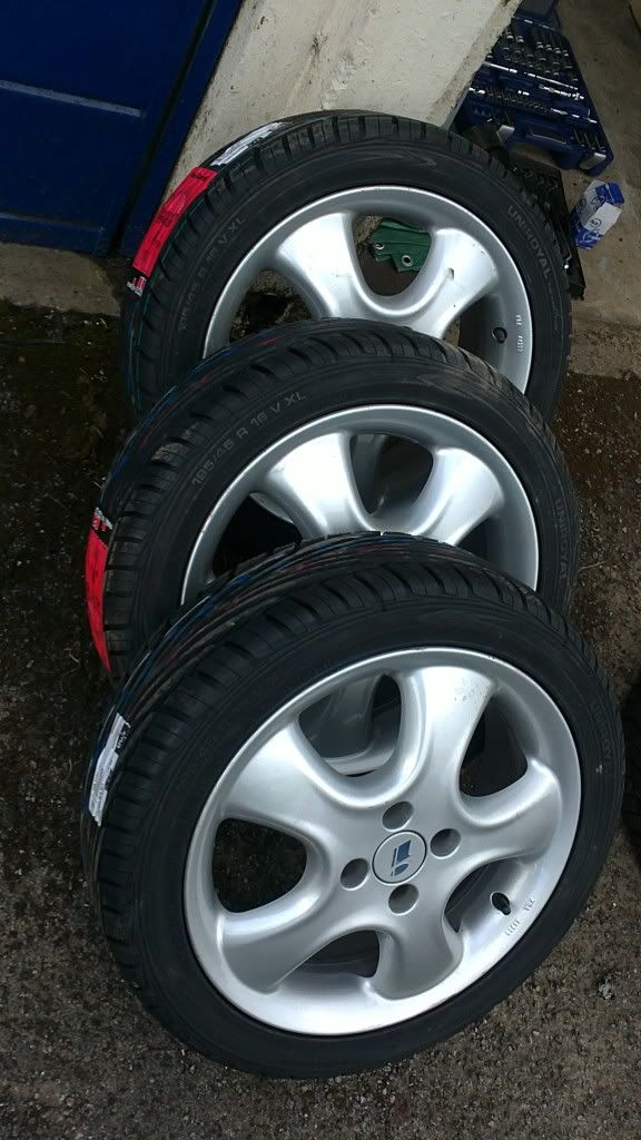

after reading some reveiws on which tyres i wanted it was between toyo t1r's and uniroyal rainsport 2's. i opted for the rainsport 2's as they apparently have the same grip capability as the t1r's but last longer. plus there meant to be awesome in the rain.
so i got 3 ordered up at work as they had none in stock. the t1r's were in stock but as mentioned i didnt want those.
http://i193.photobucket.com/albums/z...9052011201.jpg
and fitted...
http://i193.photobucket.com/albums/z...0052011203.jpg
my forth alloy already has a t1r on so that takes care of the tyres and wheels.

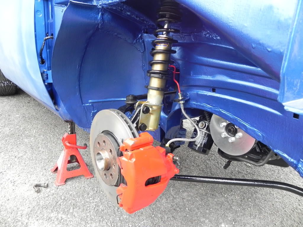

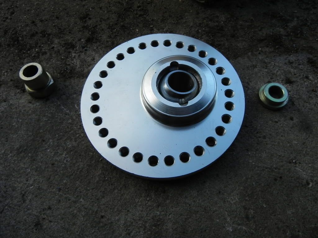

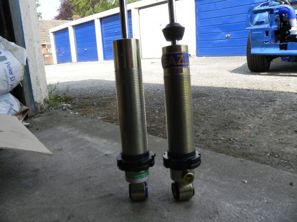

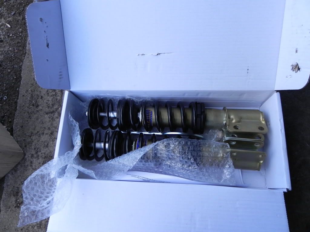

my coilovers turned up from gaz, top blokes to deal with. had the fronts machined ready for the eccentric top mounts.
http://i193.photobucket.com/albums/z...8/DSCN3630.jpg

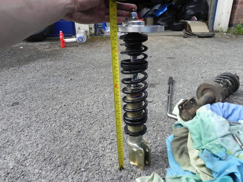

removed the rears i already had and measured them up against the new shorter bodied ones. there's about an inch between them.
http://i193.photobucket.com/albums/z...8/DSCN3588.jpg
got those on along with my wheels which i gave a clean and polish.
http://i193.photobucket.com/albums/z...8/DSCN3636.jpg

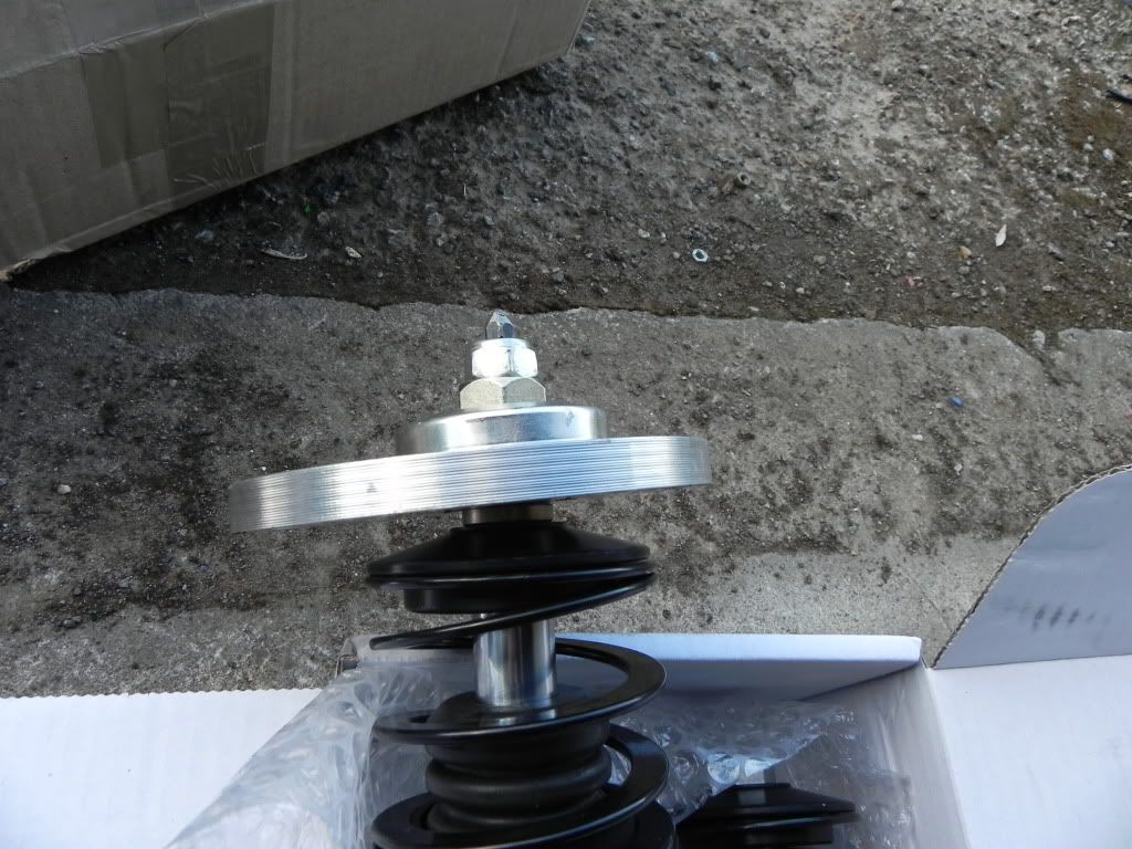

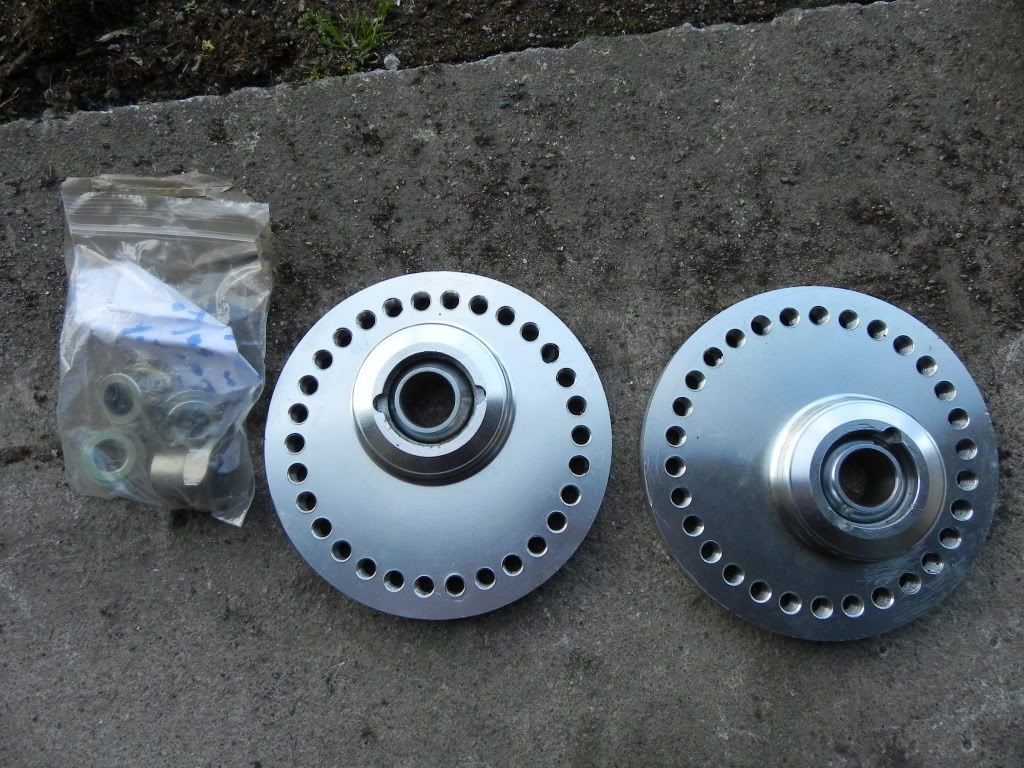

dug out my top mounts which i had bought ages ago
http://i193.photobucket.com/albums/z...8/DSCN3631.jpg
fitted the top mounts on like so, from right to left.
http://i193.photobucket.com/albums/z...8/DSCN3634.jpg
http://i193.photobucket.com/albums/z...8/DSCN3632.jpg
for future referance i measured the body for any body that wants to know it.
http://i193.photobucket.com/albums/z...8/DSCN3641.jpg
and the total length
http://i193.photobucket.com/albums/z...8/DSCN3642.jpg

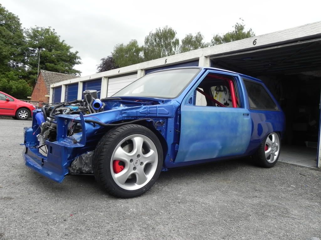

fitted them on, look a million times better than those old shocks i had on there. lol
http://i193.photobucket.com/albums/z...8/DSCN3649.jpg

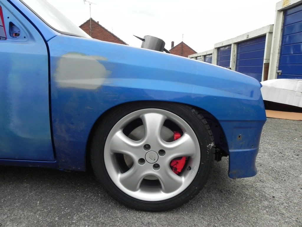

lowered it back on the ground....oops.....rather low.
http://i193.photobucket.com/albums/z...8/DSCN3652.jpg
http://i193.photobucket.com/albums/z...8/DSCN3653.jpg
http://i193.photobucket.com/albums/z...8/DSCN3660.jpg
http://i193.photobucket.com/albums/z...8/DSCN3658.jpg

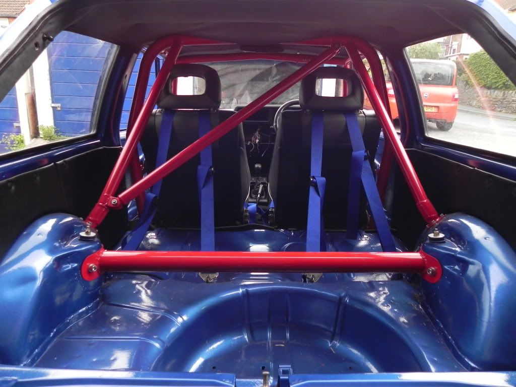

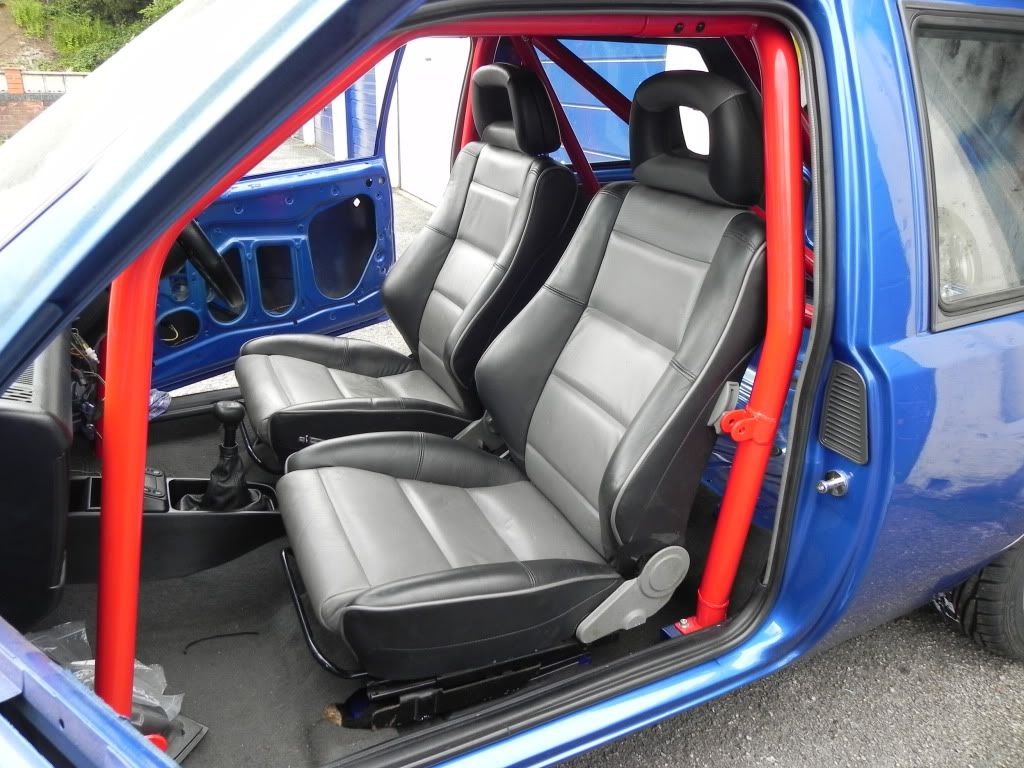

after that i decided to move onto getting the seats back in the car, they need a damn good clean still but they were in the way in the garage.
http://i193.photobucket.com/albums/z...8/DSCN3666.jpg
harnesses washed and attached in the eye hooks
http://i193.photobucket.com/albums/z...8/DSCN3668.jpg
http://i193.photobucket.com/albums/z...8/DSCN3679.jpg

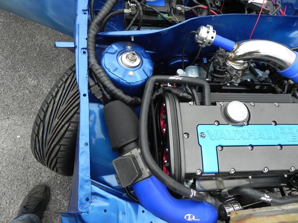

moved on to 'p' clipping the wiring harness down to the inner wing. used aluminium rivits to hold them down.
http://i193.photobucket.com/albums/z...8/DSCN3672.jpg

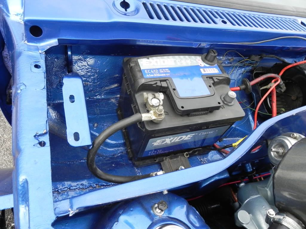

got rather bored after being down the garage so long so messed about with a few things, the main thing was this....
http://i193.photobucket.com/albums/z...8/DSCN3670.jpg
oooooooh it has power. :d thanks to my new battery i got from work.
http://i193.photobucket.com/albums/z...8/DSCN3671.jpg

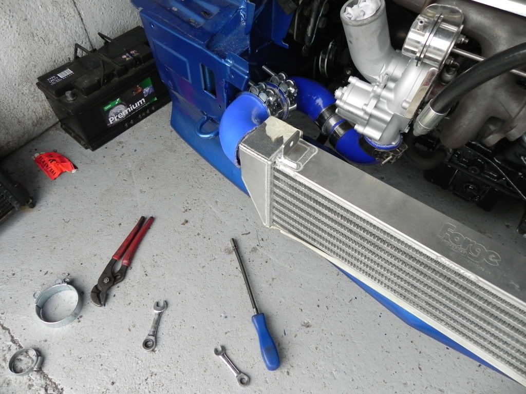

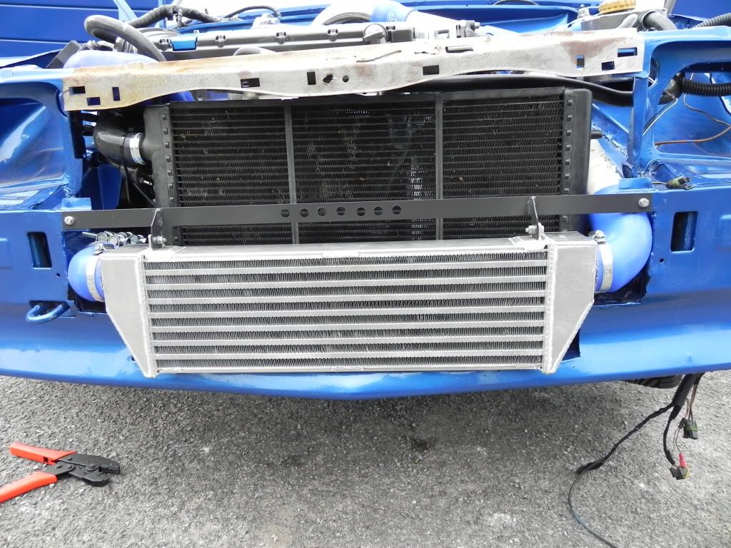

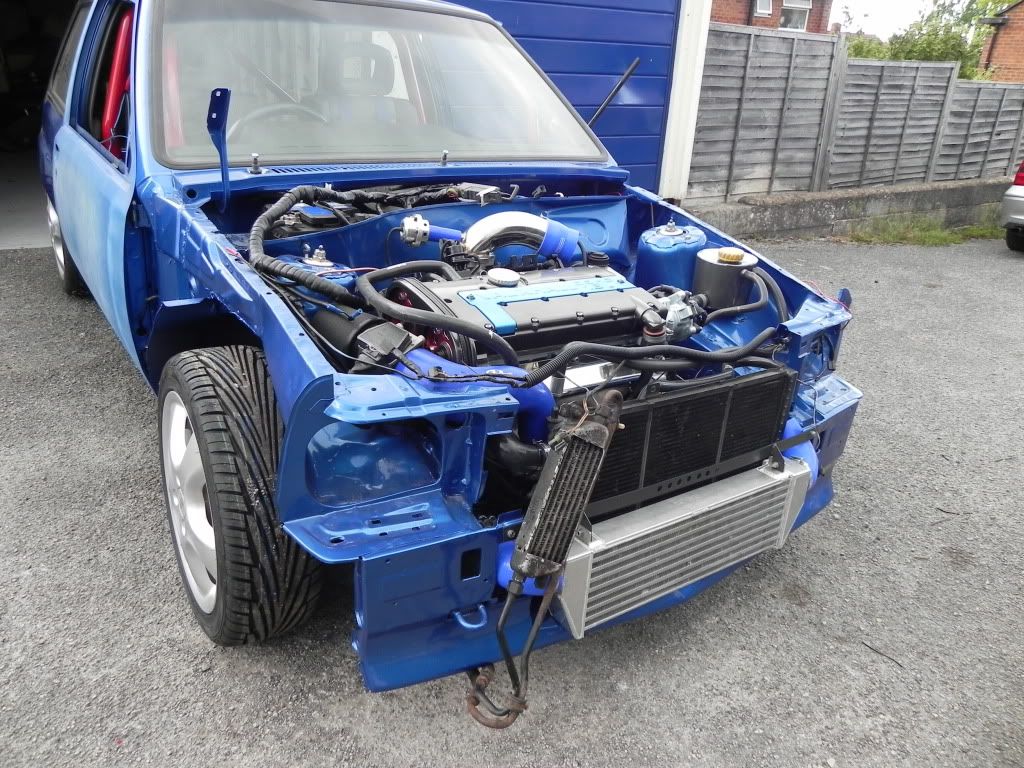

needed to check my boost hoses and intercooler still fitted. dont see why it wouldnt. :tard:
http://i193.photobucket.com/albums/z...52011200-1.jpg

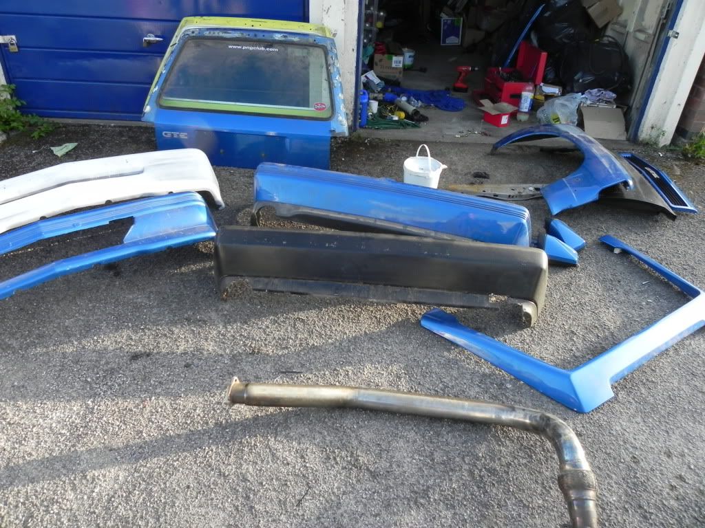

thats it really. its booked in the bodyshop on the 28th to have the rest painted, the exhaust needs sorting aswell which ill get done after the bodyshop. im still awaiting some small bits and pieces to get it running but hopefully shouldnt be too long now.

thanks alot. they are nice seats, when i sat in them for the first time in almost 3 years it felt like home!Quote:

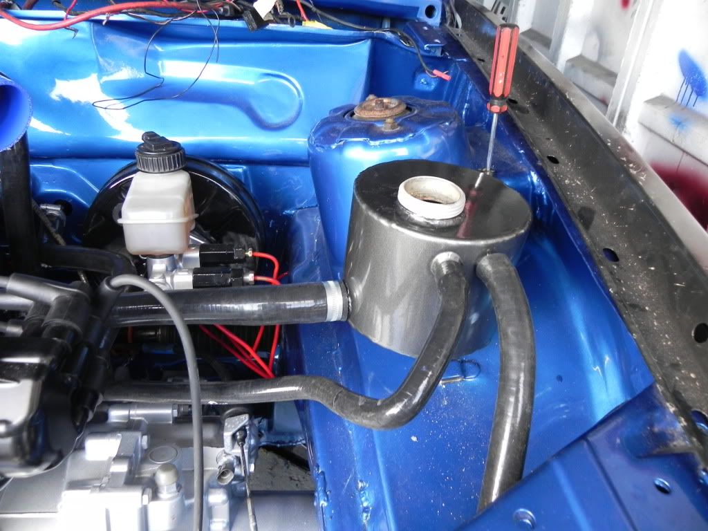

update
saturday

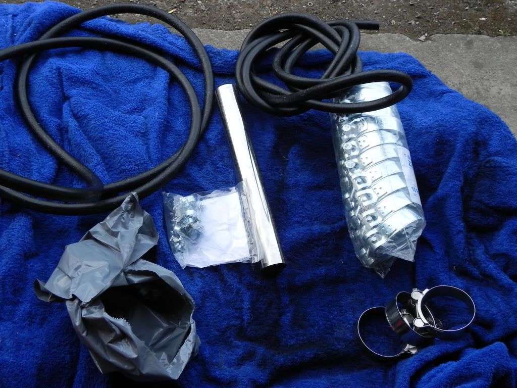

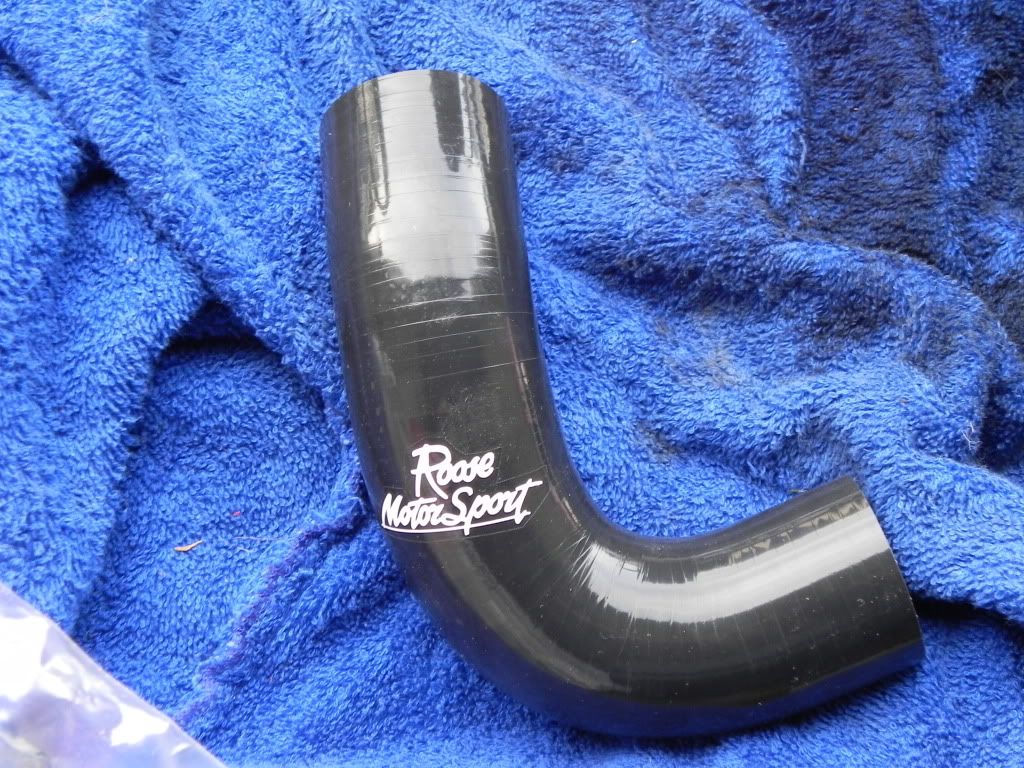

during the week i had received some more goodies from the postman, unfortunately not a large cheque.

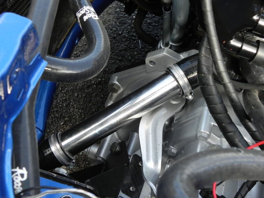

roosemotorsport sent me out a nice new top hose.
http://i193.photobucket.com/albums/z...8/DSCN3683.jpg
mr silicone sent me some 8mm fuel hose, 13mm fuel hose and a selection of 't' bolt clamps, again, 'p' clips, fuel hose clips and polished stainless pipe for my bottom hose.
http://i193.photobucket.com/albums/z...8/DSCN3682.jpg

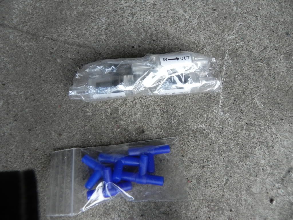

fish tank one valves and 't' pieces for the vacuum tubing.
http://i193.photobucket.com/albums/z...8/DSCN3684.jpg

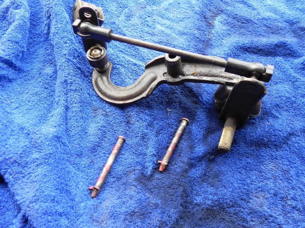

also taken delivery of a gear linkage and tailgate pins. my rose jointed linkage is rather stiff to use so have given up on that one untill i get the car up and running. dont want to be messing around with it for it not to work. it doesnt self centre either as its too stiff. apparently thats what there like until they loosen up.
http://i193.photobucket.com/albums/z...8/DSCN3681.jpg
modyfied the linkage to suit the f28, gave it a paint and fitted it. have all gears selectable but will need a test drive to confirm.
intercooler hoses on the inlet side fitted and clamped up. there not the neatest but i need the car on the road asap so untill i have more time and money to deal with it it will do.
http://i193.photobucket.com/albums/z...8/DSCN3685.jpg
i gave up with taking pictures as i wanted to crack on, ill hopefully remember to describe what ive done.
fitted the radiator, top hose and IC support bracket
http://i193.photobucket.com/albums/z...8/DSCN3691.jpg
piped up all the vacuum hoses from the dump valve, hot start valve, turbo and amal valve. tried to hide as much of it as i could under the inlet
http://i193.photobucket.com/albums/z...8/DSCN3692.jpg
http://i193.photobucket.com/albums/z...8/DSCN3693.jpg

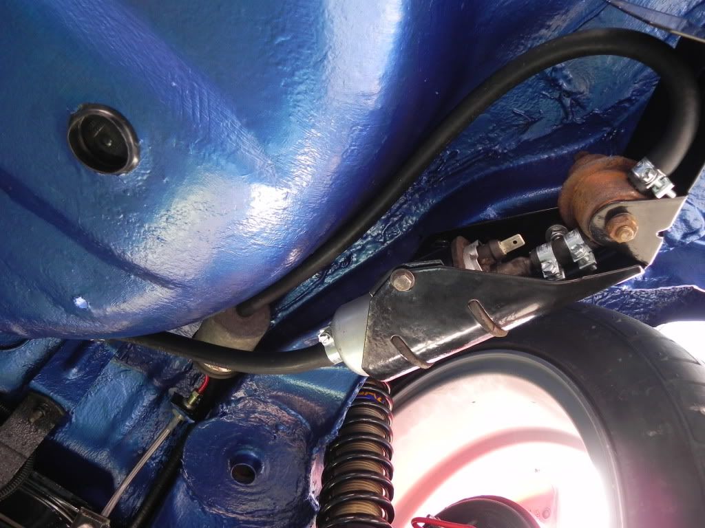

made up the bottom hose with 2 45 deg hoses and stainless pipe.
http://i193.photobucket.com/albums/z...8/DSCN3704.jpg
to make things easy on myself and so i dont damage all the filler in the firewall im going to route the loom across the front of the turret and into the battery area. once there ill take it into the cabin.
http://i193.photobucket.com/albums/z...8/DSCN3703.jpg
at this point i got it so it was cranking over. i still hadnt got my fuel lines in or pump on, didnt have a fuel pump relay or the top nut for the oil feed. so i left it and went home
after contacting will foy i made a very late run down to his at 10pm to arrive at 11pm. picked up the aforementioned so i could make a move with trying to fire it up on sunday.
et voila
http://i193.photobucket.com/albums/z...8/DSCN3705.jpg

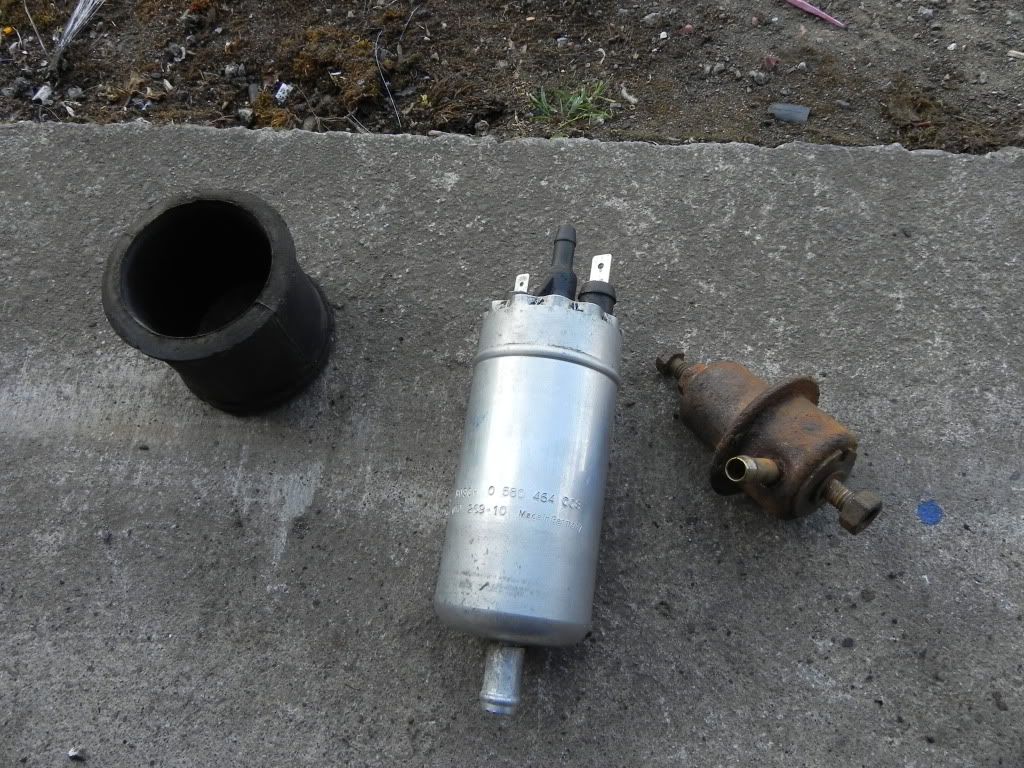

dug out my fuel pump and gave it a clean. the fuel reg thing was way past its best and all i had was my battery drill to try clean it. it wasnt going to happen. so for now it will do.
http://i193.photobucket.com/albums/z...8/DSCN3707.jpg

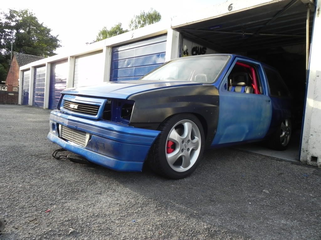

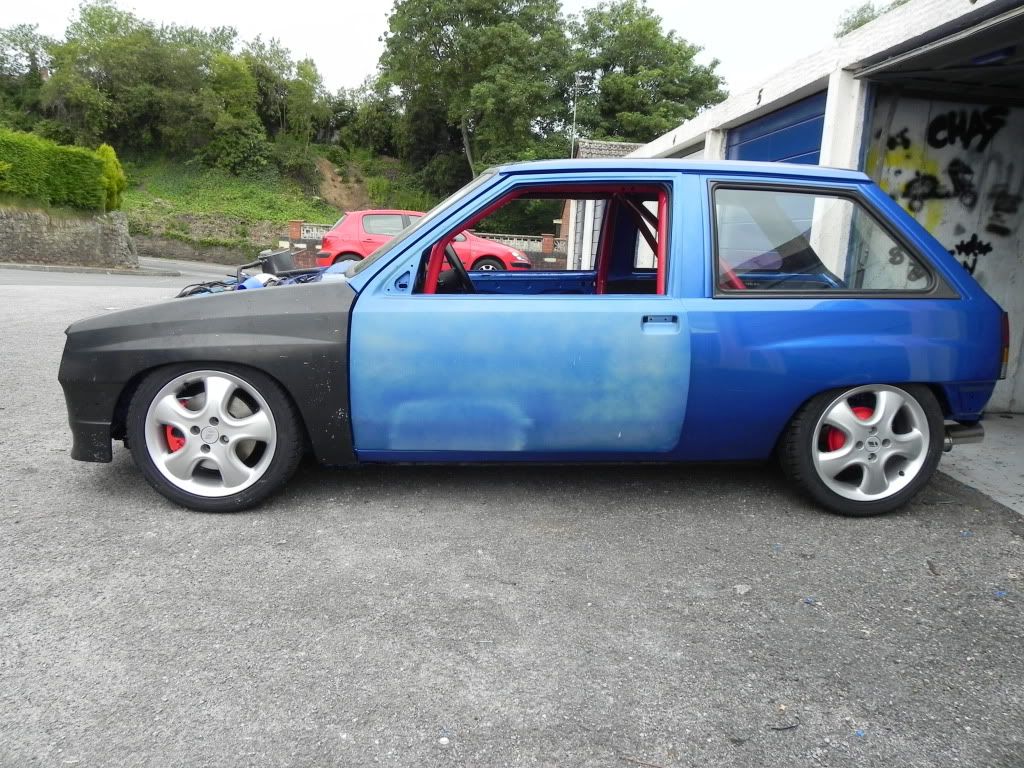

the cars off to the bodyshop on the weekend so tonight ive been sorting the panels out.
http://i193.photobucket.com/albums/z...8/DSCN3719.jpg
some messing around later it looked like this
http://i193.photobucket.com/albums/z...8/DSCN3720.jpg
http://i193.photobucket.com/albums/z...8/DSCN3726.jpg
that isnt the bumper ill be using, was my test bumper. im yet to cut up the one ill be using.

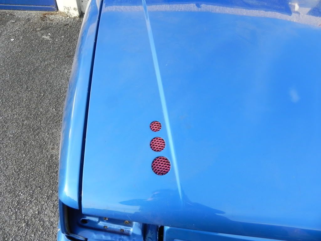

one thing im concerned about it the red mesh in my bonnet. is it too halfords? if so, what do i replace it with? i like the red as it helps compliment the other red on the car.
http://i193.photobucket.com/albums/z...8/DSCN3728.jpg
at the moment ive ran out of thoughts in my head, yet again ive most likely missed something so please ask any questions if need be.
thanks for looking

Looking good dude. Metal pipe in the water system looks familiar... lol
aha, you caught me.:p

What an earth will you be using the 13mm hose for? I'm still waiting for my bracket for the fuel pump. Good ol' eBay, knows exactly when to funk up and mess ones plans.
