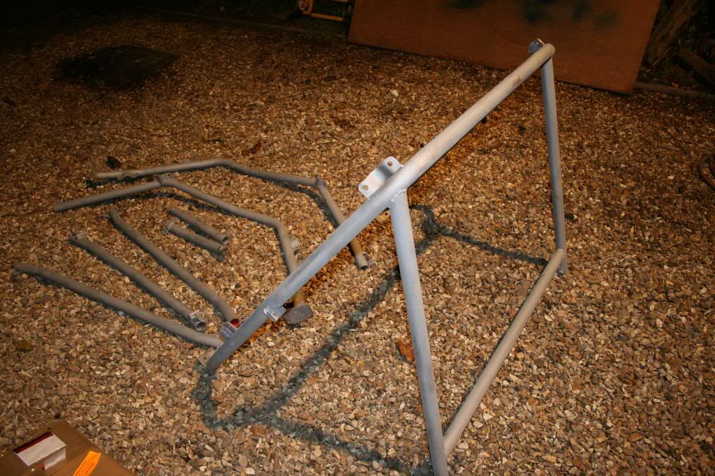

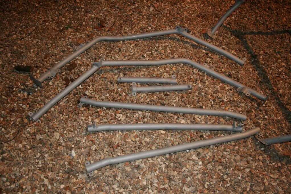

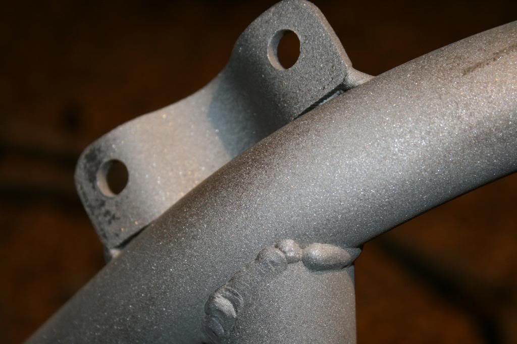

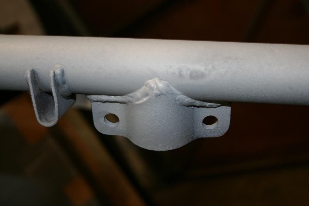

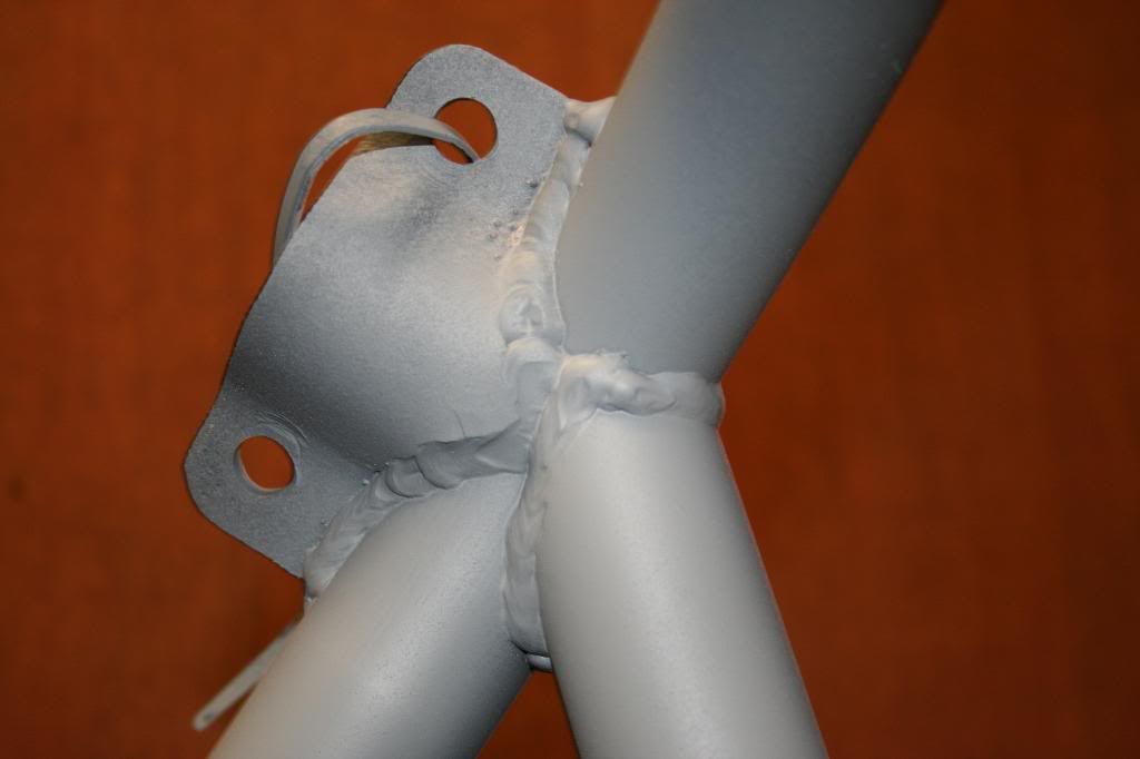

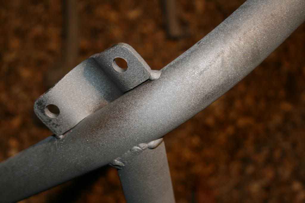

As we are still on the subject of the cage i got it back from sand blasting today nice and clean well worth the investment imo and no effort what so ever lol
It came out like this...the pics are sh!te BTW as it was dark
http://i248.photobucket.com/albums/g.../cage001-1.jpg
http://i248.photobucket.com/albums/g.../cage002-1.jpg
http://i248.photobucket.com/albums/g.../cage004-1.jpg
http://i248.photobucket.com/albums/g.../cage005-1.jpg
http://i248.photobucket.com/albums/g.../cage007-1.jpg

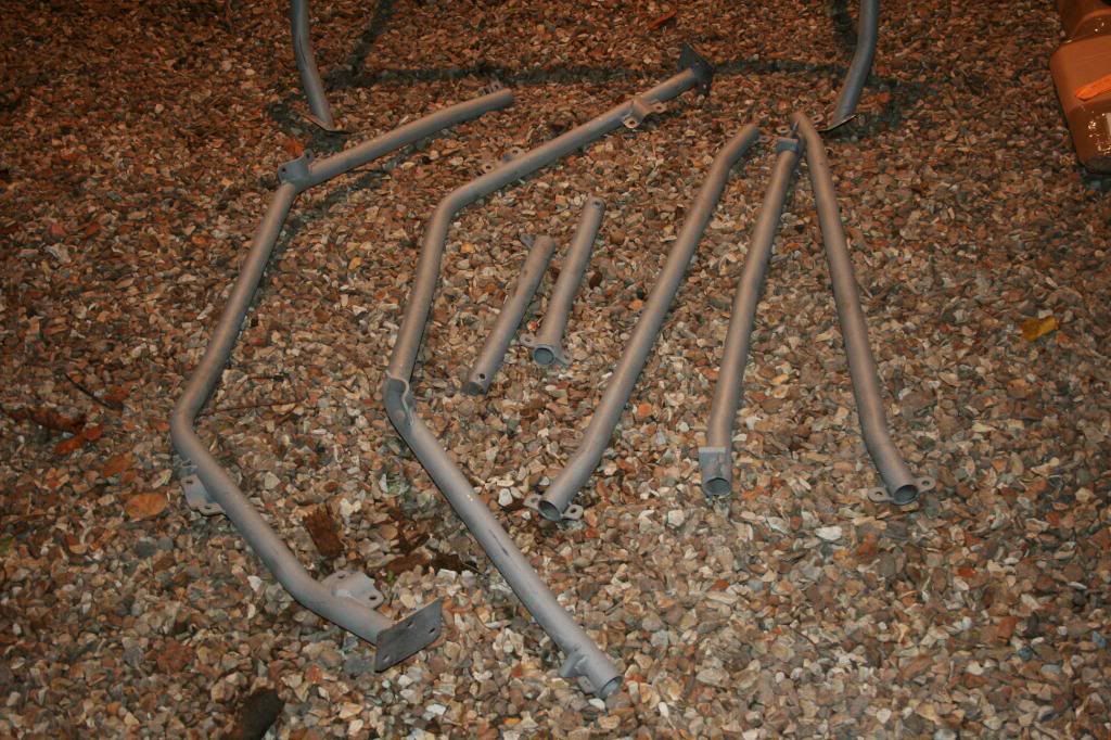

Then i got some primer on it
http://i248.photobucket.com/albums/g.../cage008-1.jpg
http://i248.photobucket.com/albums/g.../cage014-1.jpg
http://i248.photobucket.com/albums/g.../cage015-1.jpg
With the last of the primer in the gun i gave the underside of the spare wheel well area a light coat
http://i248.photobucket.com/albums/g.../cage009-2.jpg

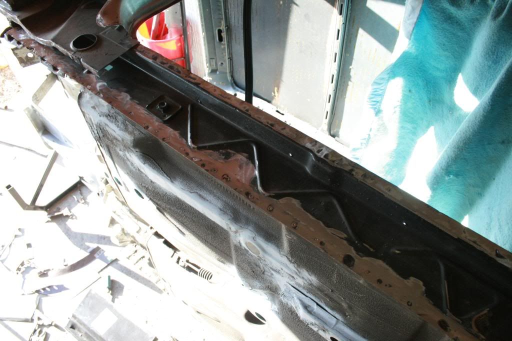

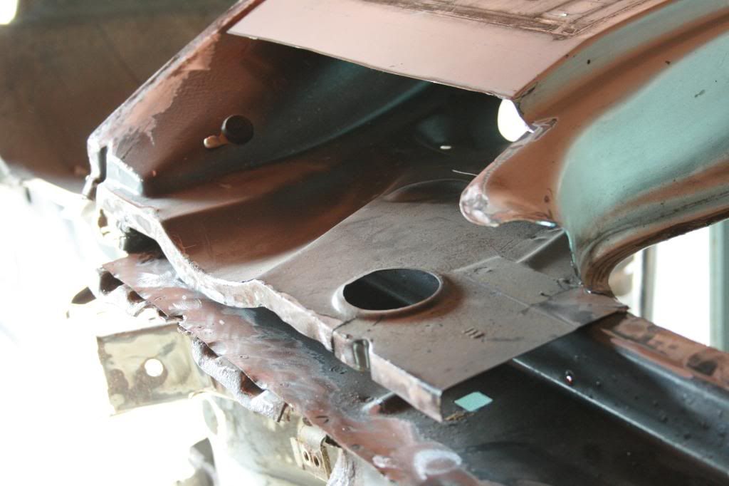

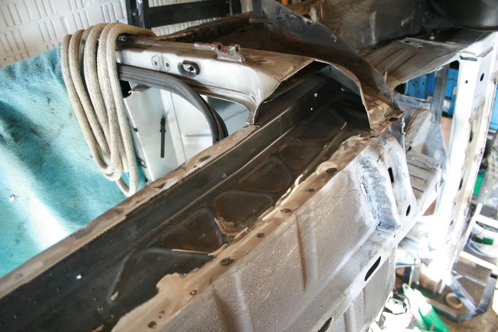

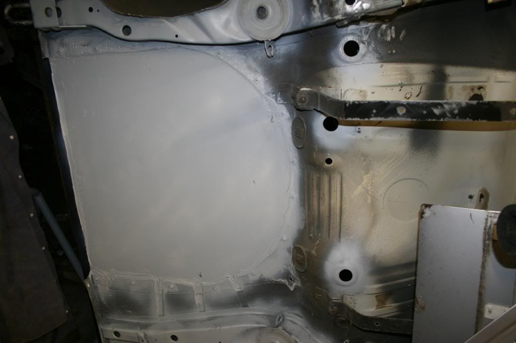

Made a bit of head way with the car today although i had to work until 12 :mad: needed the extra ££ as i've been off sick, anyway got in full of enthusiasm and decided to tackle the sill - a job i didn't really want to do (as it was only because of the rust that it needed replacing) to remove and could have done without doing as ive got loads of other bits to be getting on with but its doen now :D
Here is how.....

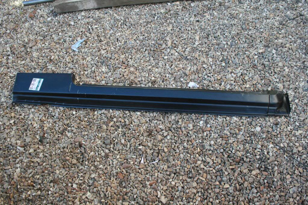

one full sill repair panel
http://i248.photobucket.com/albums/g...turrets001.jpg
Offered up, marked out and cut to size
http://i248.photobucket.com/albums/g...turrets002.jpg
http://i248.photobucket.com/albums/g...turrets003.jpg

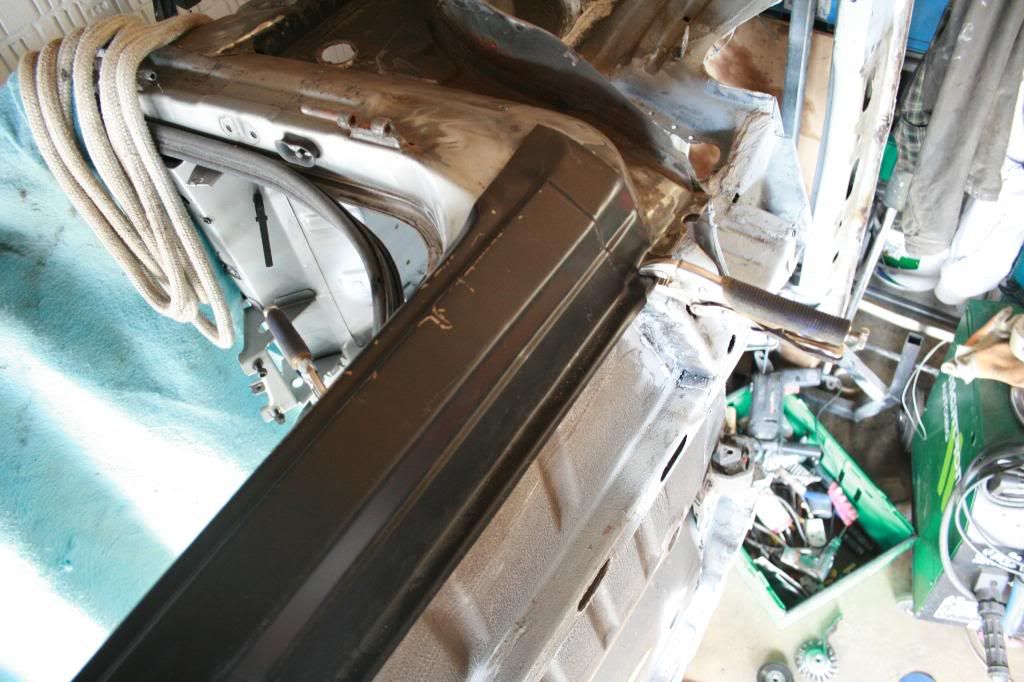

Then i removed the old sill and cleaned up the ****e underneath
http://i248.photobucket.com/albums/g...turrets007.jpg
http://i248.photobucket.com/albums/g...turrets005.jpg
much better

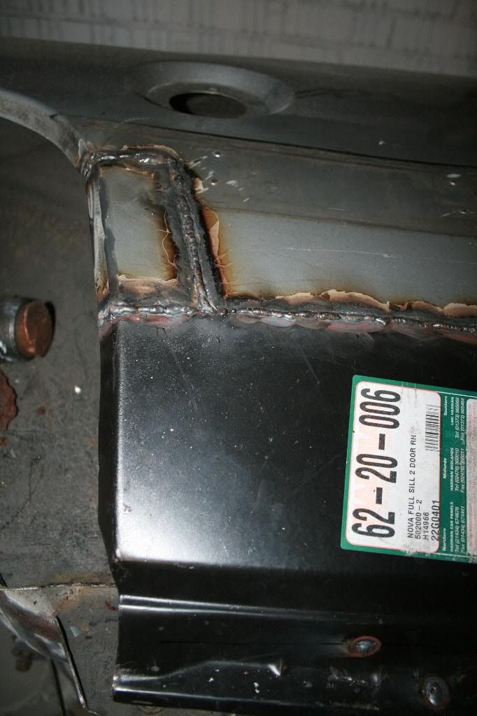

http://i248.photobucket.com/albums/g...turrets008.jpg

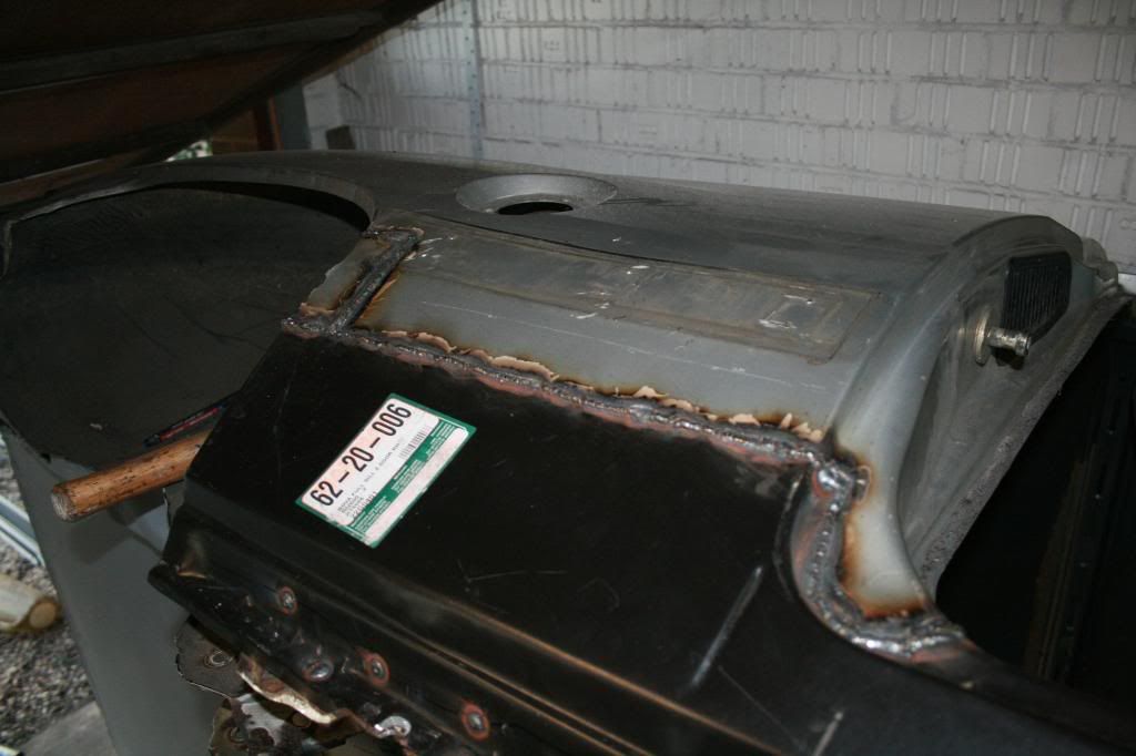

And welded the new metal in - not the prettiest of jobs but no more rust never the less.
http://i248.photobucket.com/albums/g...turrets009.jpg
http://i248.photobucket.com/albums/g...turrets011.jpg

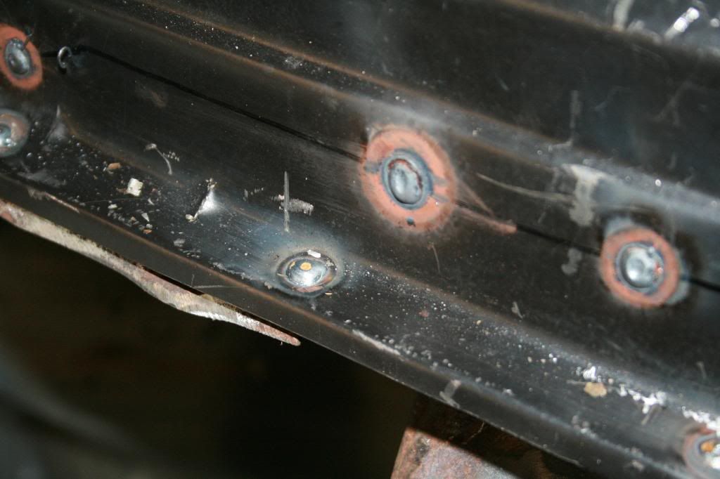

I puddle welded were the original spot welds were
http://i248.photobucket.com/albums/g...turrets012.jpg
and did a small repair further up the arch
http://i248.photobucket.com/albums/g...turrets013.jpg
I'm going to leave the 'metal' finish as i cba with filler its a track car so aesthetics arn't as important and the nosh will only add more weight. I haven't a clue what the repair will look like once the car is on its belly again (dog sh!t i imagin) as its hard to see with the car on its side, but its done now.

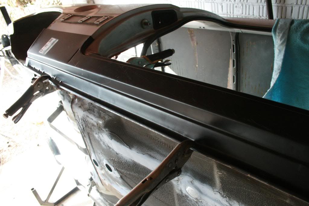

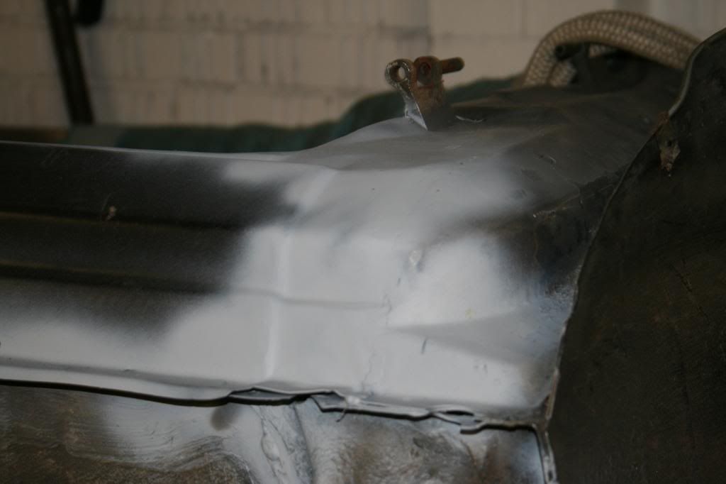

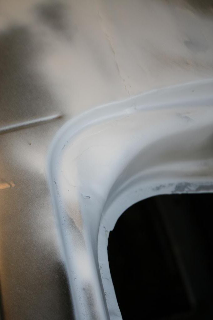

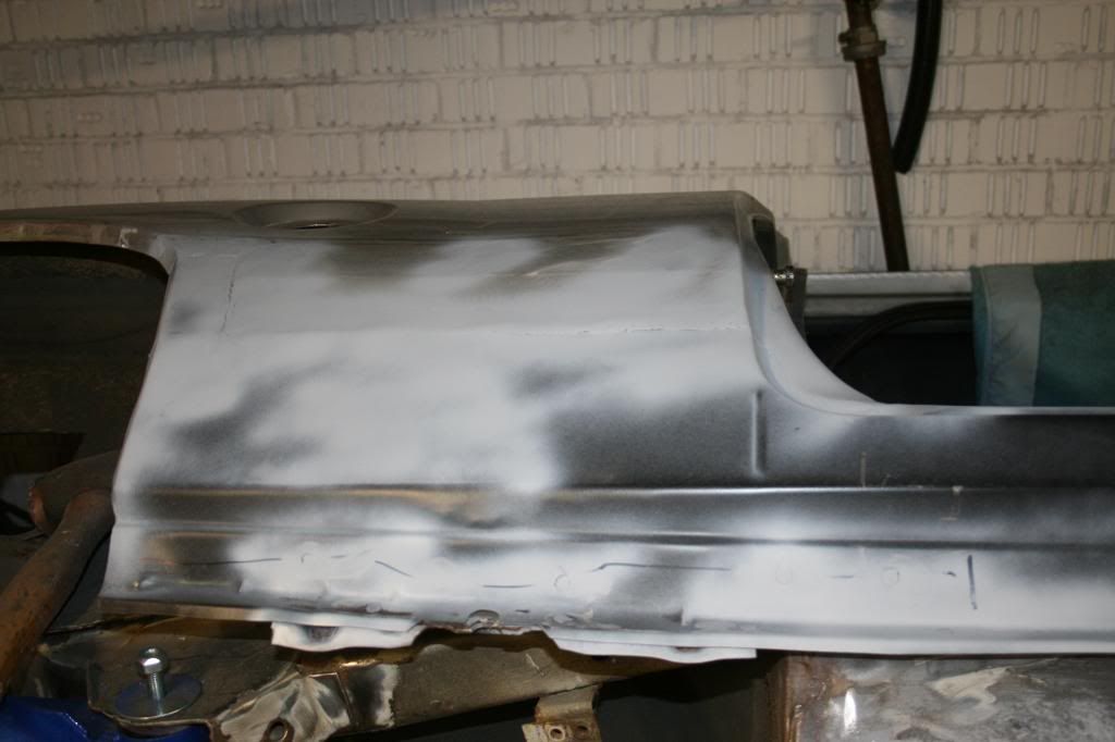

After a session with the grinder and a sanding disc i got some primer on the new metal - job done!
http://i248.photobucket.com/albums/g...rrets001-1.jpg
http://i248.photobucket.com/albums/g...rrets004-1.jpg
http://i248.photobucket.com/albums/g...rrets008-1.jpg
