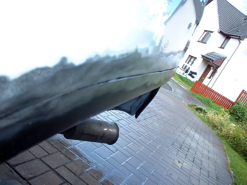

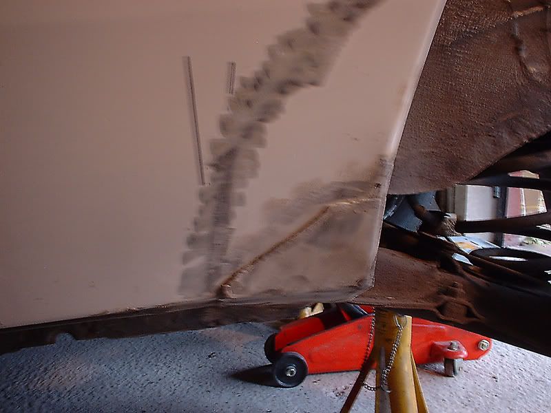

The actual outer skin wasnt too bad but I knew from feeling under the lip that the inner arch weas shot. Plus theres this patch in the corner -
http://img.photobucket.com/albums/v1...DSCF0002-3.jpg

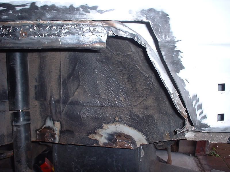

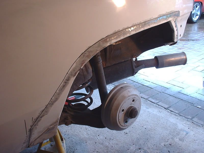

I didnt want to take much metal off as the outer skin wasnt too bad so I cleaned off the paint and parked out my cut line -
http://img.photobucket.com/albums/v1...DSCF0004-5.jpg

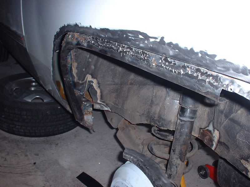

Here's the mess behind that corner piece - I'll need to do some inner repair work I think -
http://img.photobucket.com/albums/v1...DSCF0007-3.jpg

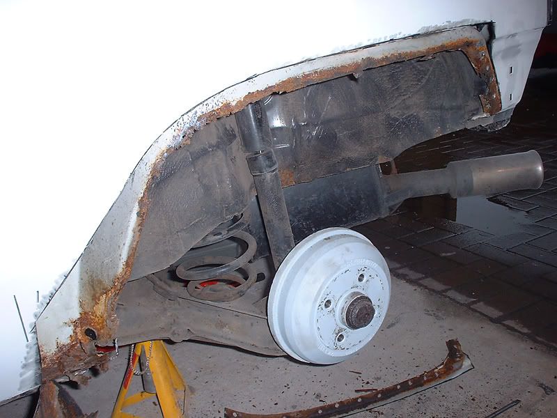

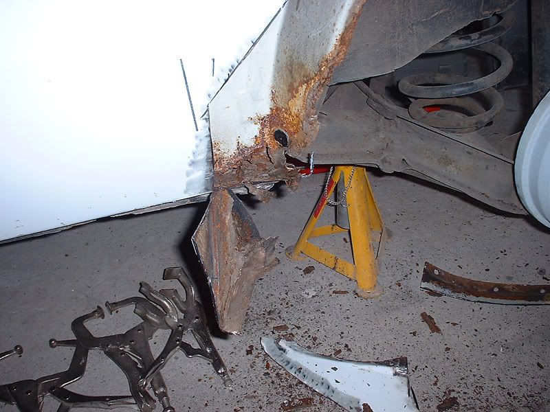

I then cut the outer skin off (after drilling out the spot welds). As predicted the inner arch was shagged.
http://img.photobucket.com/albums/v1...DSCF0008-3.jpg
I then cut this off level with the outer skin.

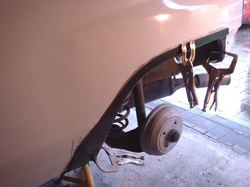

I then offered up the new outer skin panel and from the inside arch drew on the back of it folowing the line I'd cut. I then cut this out and offered the new cut panel to the car -
http://img.photobucket.com/albums/v1...DSCF0003-3.jpg
http://img.photobucket.com/albums/v1...DSCF0017-3.jpg
I now needed to rebuild the inner arch. This was a bit more work than the drivers side as the bottom edge was missing. I started by using another outer skin and cutting and chaping it to fit snuggly to the inside of my other panel that makes my outer replacement skin. This was then offered up in sections and welded in place to the inner arch edge -
http://img.photobucket.com/albums/v1...DSCF0012-4.jpg
http://img.photobucket.com/albums/v1...DSCF0013-3.jpg
