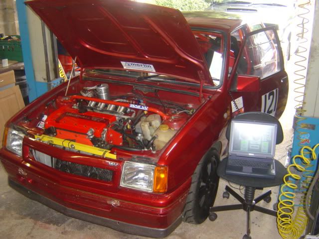

A teeny weeny update. I decided to check my throttle bodies again. The last time I set them up I was really just guessing. However after going to a few rolling road sessions and watching the guys setup a mates XE powered single seater I gained some nice pointers:thumb:
Anyone who has heard my car idle will probably know that its a bit oddlol I've buzzed the thing a few times and the last time I did it no four cylinder sounded odd:eek: I thought bugger I've broken something there, but heyho it still works (Best leave it alone).
So today I check all the TB's and match them up. No four was wayyyyyy out only pulling in 3/5 of the air that the others were. A little tweek and hey presto cured. So i've been running a fair while with the car quite a way out of tune on No:4:roll: anyway setup the rest of it and its sooo much better now. So im hoping it will go even better at the next meet.
I do love using the laptop to setup the car:cool:
