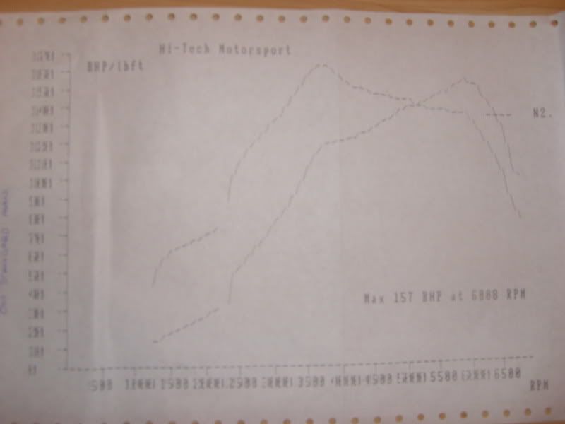

heres the print out from yesterday. i've been out in it today again and im going to end up killing myself in it LOL!!!!!!
This read out is 157bhp at the wheels!!!!!!!

Whats the torque output?
I'll scan mine in when I get a chance.

Just looking at the printout, peak power at 6008rpm is good going IMO. Mine was lower than that & I dont think a 2.0 LET peaks as high as that, typically.
Cant find my printout, Ive got 2 copies but I think one is with my GSi glovebox..... (shed).
if my 1.6t puts out 157 il be delighted fair play lad id say its a animal to go lol

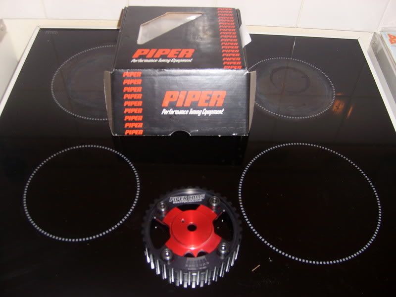

Right then havent updated this for a while. Car has been running mint with no problems until last week when it started smoking one day so did a compression test and number 4 was low so stripped engine that day to find a hot spot on the bore and piston which was letting the oil past. So ive done a rebuild with a different piston new rings, new mains, head skimmed, new head bolts. did all this in about 3 days because i need the car for work. so i had to run the engine in again so did this in 2 nights on the M6 and it was booked in at high tech again for a tune. Night before the rolling road i got this toy-
http://i102.photobucket.com/albums/m...l/STP60569.jpg
So fitted this about midnight and changed the oil. then off to rolling road in the morning.

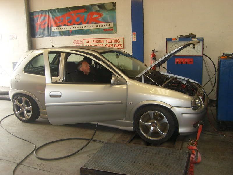

My mate in his corsa 2L 16v
http://i102.photobucket.com/albums/m...l/STP60570.jpg
this corsa only ended pushing 153BHP at the wheels.

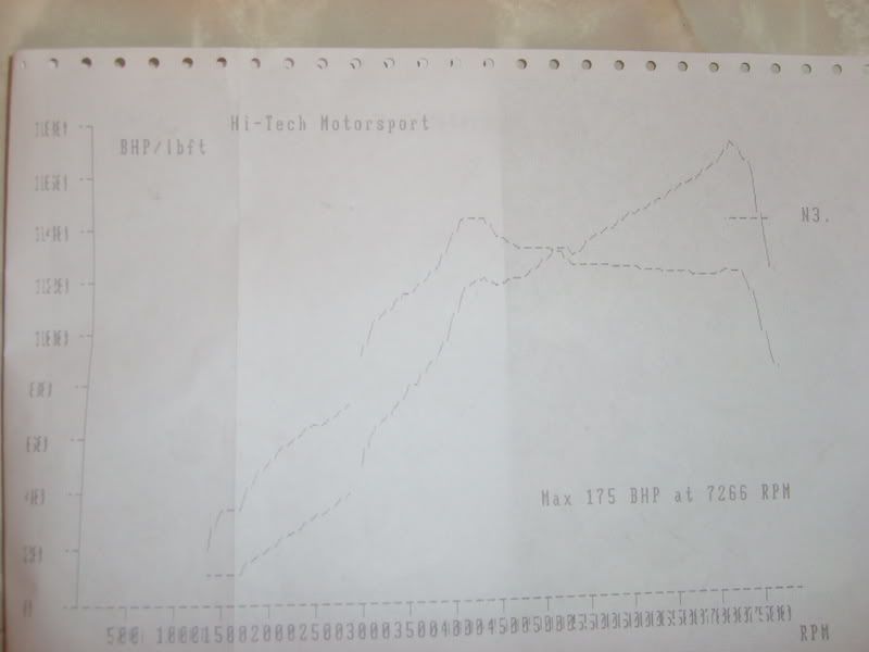

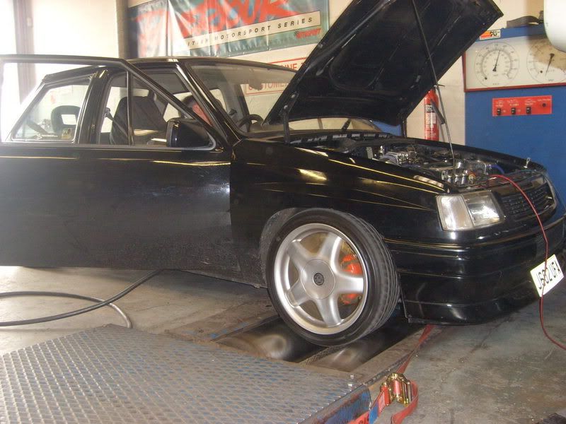

then mine went on and to start with he was only getting 147bhp out of it then a bit more messing we got this-!!!!
http://i102.photobucket.com/albums/m...l/STP60580.jpg
175bhp at the wheels so thats got to be 200bhp at the flywheel?? or am i wrong? before it only pulled upto 4000rpm now it pulls al the way 7200rpm, went out last night and i sat on a Mk2 astra LET and he was only just pulling away from me!!!! its rapid. and best of all im of to the RING fri night so i cant wait!!!! will update with some pics after germany!!!!

fook me go on! thats some impressive power from a 1.6!
