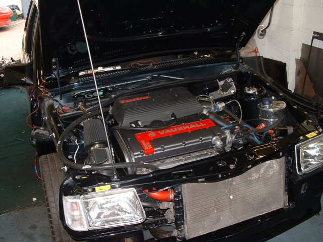

Cheers to Karl Rowntree for coming up this weekend to give me a hand, even though i ended up working all day saturday updating a customers server. Karl had the turbo off 4 times while i was at work as he had problems with the studs going into the head and also getting the water and oil feeds on and also got a few other bits and pieces sorted. When i got home about 6 o'clock we cracked on with some more work on the car, Mark Beeson and Martin Weaver also joined us with Beers in hand!! Need less to say Mart has some entertaining photos, and amazingly we made some good progress, even though Mark was Pi$$ed after having one bottle! It's getting that close now to starting it!! I've now taken rocker cover and cam cover off to paint them up, before anything else goes in.
Ignore the random hoses and stuff, there only going on as a temporary measure to get the car running, and then it will off for custom intercooler, rad, oil cooler and pipework.

The biggest update though is that after 4 years and 2 days the engine started for the first time!! No big dramas, bit of a water leak from the thermostat area and a bit of confusion about if the fuel pump should prime or not, so relays were bypassed and when we had fuel pressure we attemped to start it but had no spark. Rob traced wires and ran a earth from the battery to the fuel rail and it started first time!! So we put the fuel relays back in, started it again fine no problems, removed the temp earth wiring, again started fine!! So there was nothing wrong with it in the first place, we just had'nt tried to start it as the pump did'nt prime!!
Just like to say cheers to Rob and Karl again for all their help getting it running, also cheers to Mark for coming over on saturday and getting oil pressure and priming the turbo ready for us to start it!! Cheers to Beastie and Weaver for their help too!
I even drove it for the first time too today, put it in reverse and pulled off, but the car went forwards! Linkage on it at the moment is impossible to get right, so we pushed the car out into the drive and let it run for a bit and then as it started to spot with rain i drove it back into the garage.

Ignore all the piping and wiring, this is all being tidyed up or replaced, also ignore the oil cooler, it was all put in just to get it running. Car is booked back into the bodyshop for 19th May and will be booked in Radtec for intercooler and Rad tomorrow.
Anyway, pics and videos are on www.nova-turbo.co.uk
But for the lazy ones here's a Picture and a video clip...
