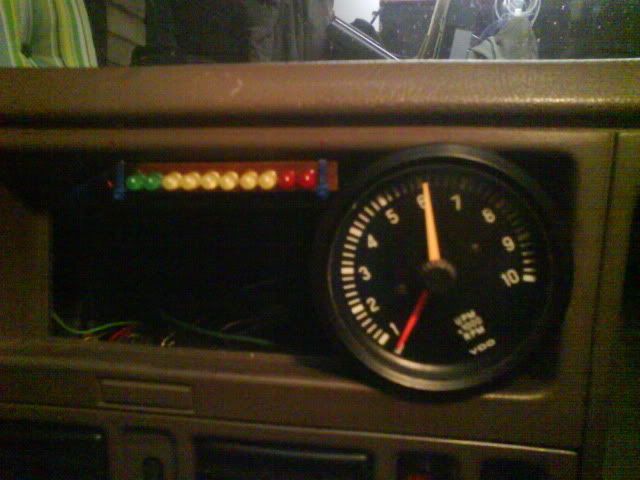

Can the lights be graduated with the rise in revs when connected to MJ?
yes it can be set to any rpm for the lights from the settings with the pc we have set ours to 7500 rpm for the shift light and the rev limiter to 8500Quote:
Originally Posted by tom reid
Made a sequential one last night, five pairs of leds that come on at 5600, 5700, 5800, 5900 and 6000 revs using the 4 user outputs and shift light output. Hardly rocket science but I wanted to do it anyway. Personally I prefer the single shift light though - don't have time to be watching christmas tree lights lol
http://i71.photobucket.com/albums/i1...a/DSC01018.jpg
No photo yet but I have gone back to two single lights for shift related duties, a yellow for a 'spirited shift' and a red for a 'just about to hit the limiter' shift.
