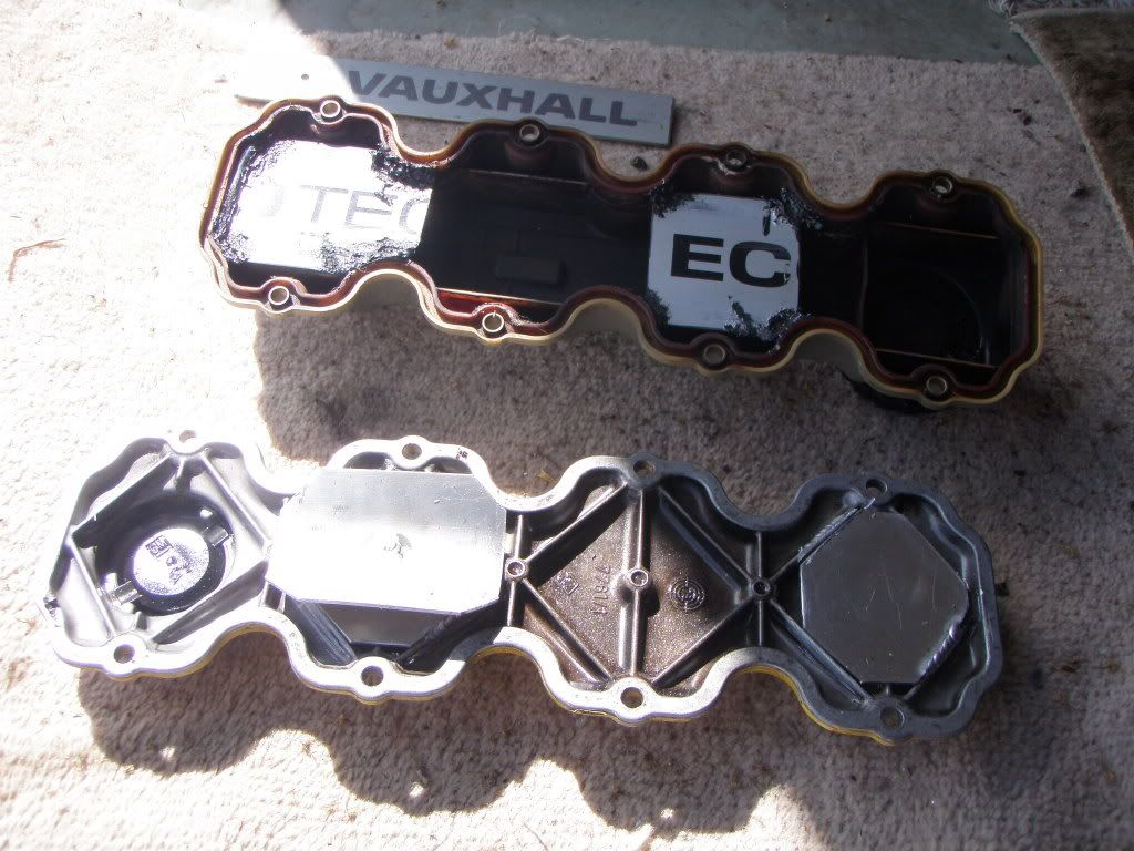

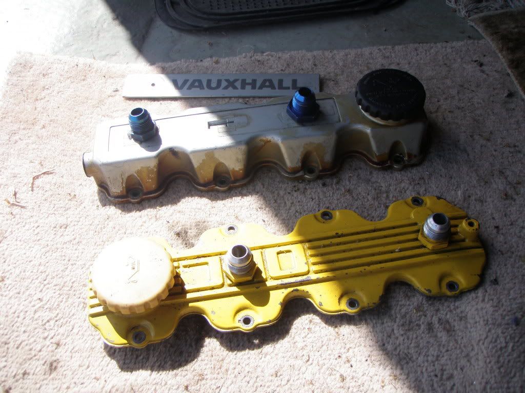

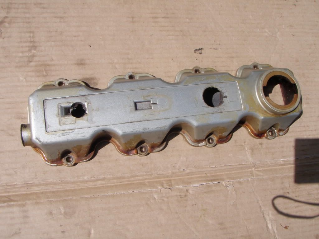

Over the last few days I got around to sorting out the rocker cover. Ever since I got this Nova, the rocker cover gasket has leaked, and has been replaced several times.
It's the old cork type gasket as used with the metal smallblock rocker covers, which are clearly just terrible at sealing. I have to tighten the bolts down after every race (less than 40 seconds sometimes), as they just come loose.
So I've now changed to the later style plastic rocker cover which has the rubber 'O' ring style gasket;
http://i285.photobucket.com/albums/l...cort/001-7.jpg
http://i285.photobucket.com/albums/l...ort/003-43.jpg
http://i285.photobucket.com/albums/l...ort/002-40.jpg
You can see where I've modified it to fit the breather unions in to the top, and where some bits of plastic have been welded onto the inside of the cover to act as splashguards to stop oil going directly out of the breathers.
The eagle eyed may spot that the splash guards have been cut out of an Ecotec engine cover..........

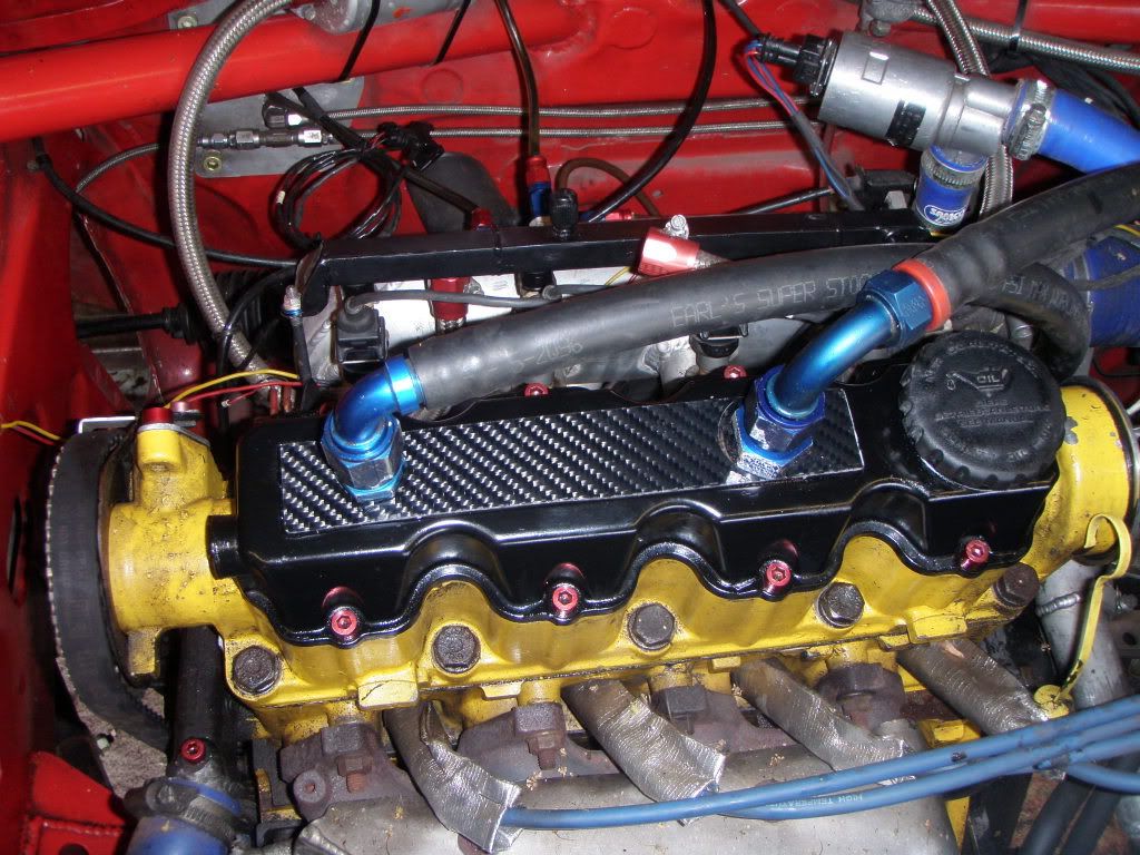

With a splash of paint and a bit of carbon fibre cut for it, it looks quite presentable;
http://i285.photobucket.com/albums/l...ort/004-36.jpg
Hopefully this will solve my leakage problem..........and the plastic rocker cover is over 200g lighter than the aluminium one, so it's all good.

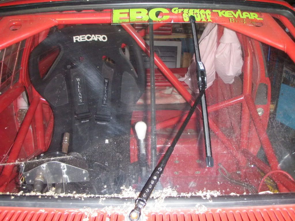

And I've also fitted one of those 'Aero' wipers, which was all of 40g lighter than the previous wiper blade;
http://i285.photobucket.com/albums/l...ort/005-30.jpg
Every little helps I suppose!
