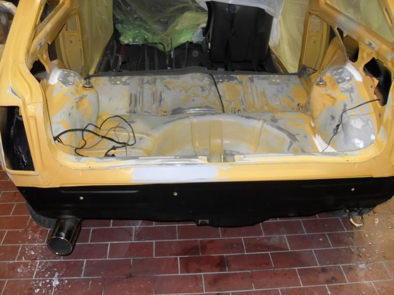

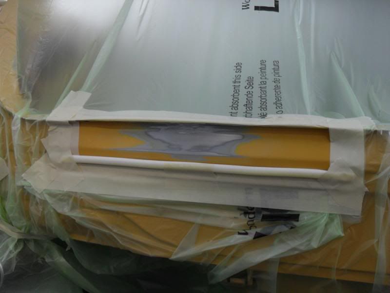

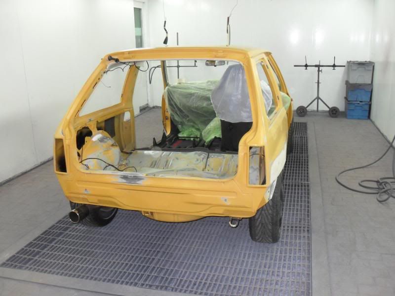

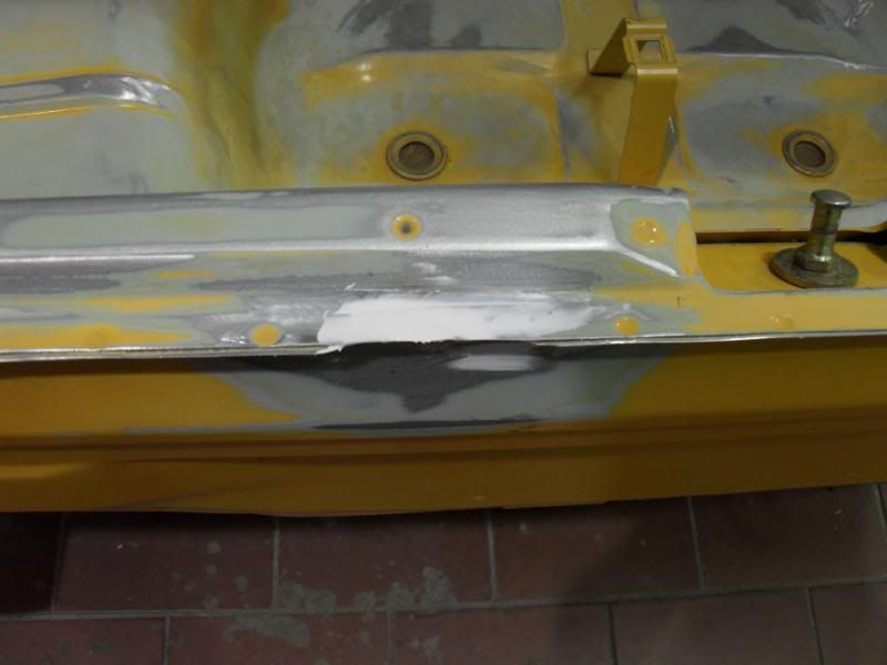

There was a small piece behind the rear boot seal that needed a little attention so a small plate was cut and welded in followed by a small skim of filler......
http://i84.photobucket.com/albums/k2...bowip305-1.jpg
The car then went back on its rear wheels so it could be rolled into the booth for primer........
http://i84.photobucket.com/albums/k2...bowip306-1.jpg
http://i84.photobucket.com/albums/k2...bowip307-1.jpg
And into the booth.........
http://i84.photobucket.com/albums/k2...bowip318-1.jpg
http://i84.photobucket.com/albums/k2...bowip319-1.jpg

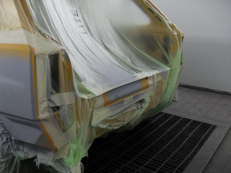

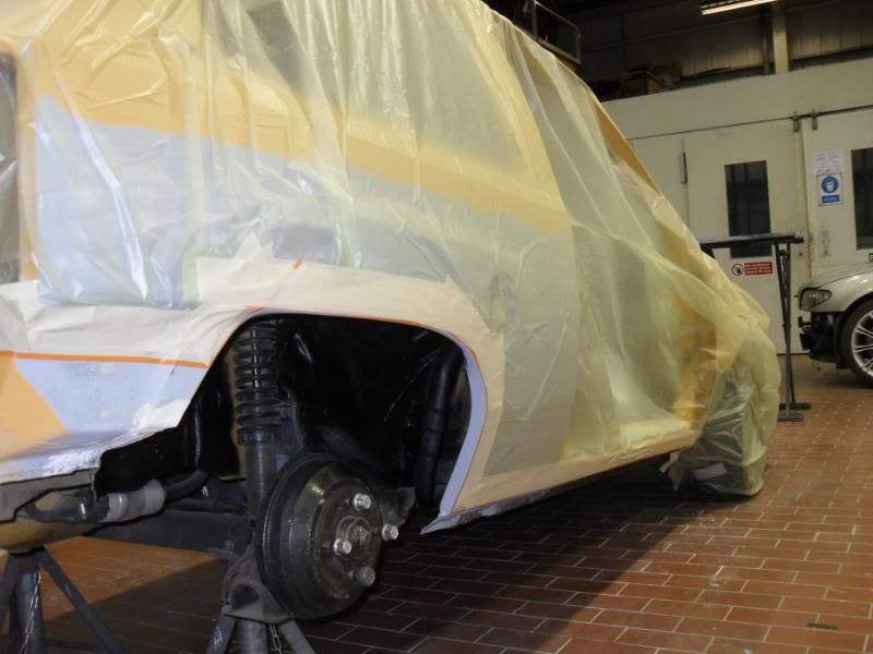

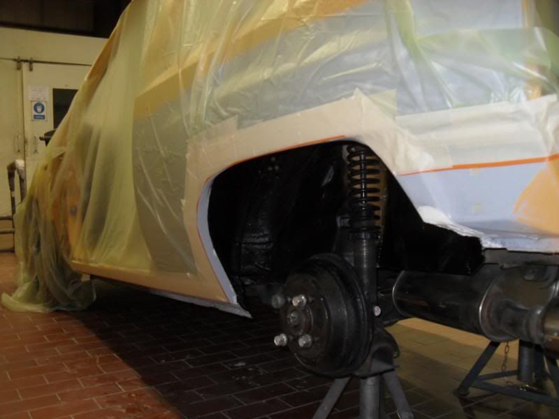

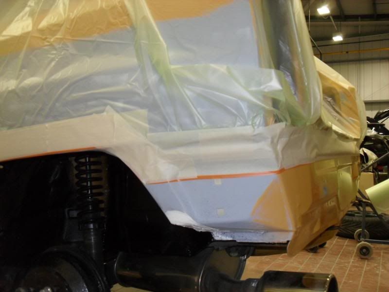

Then masked for primer.........
http://i84.photobucket.com/albums/k2...bowip323-1.jpg
http://i84.photobucket.com/albums/k2...bowip324-1.jpg
http://i84.photobucket.com/albums/k2...bowip325-1.jpg
http://i84.photobucket.com/albums/k2...bowip326-1.jpg

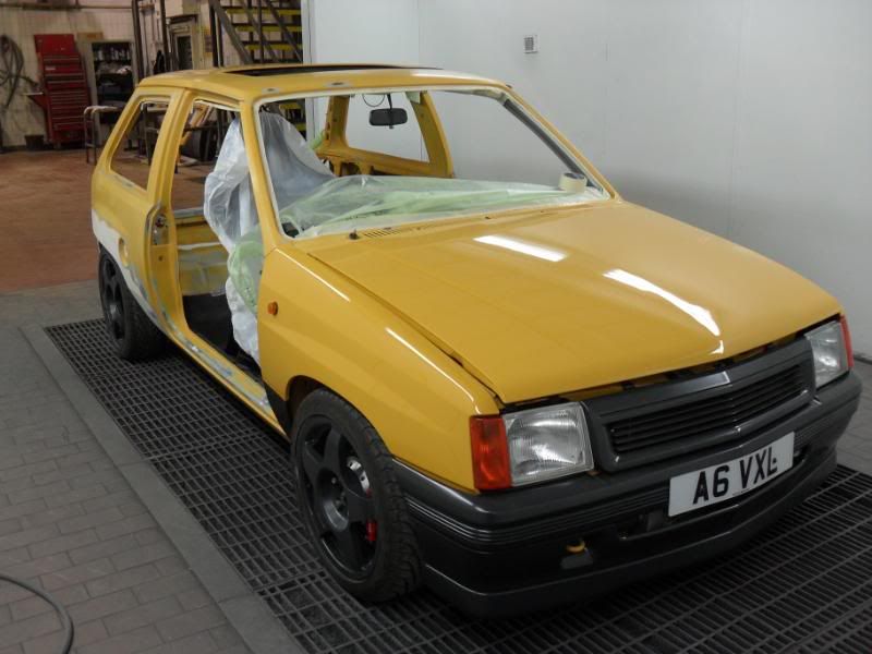

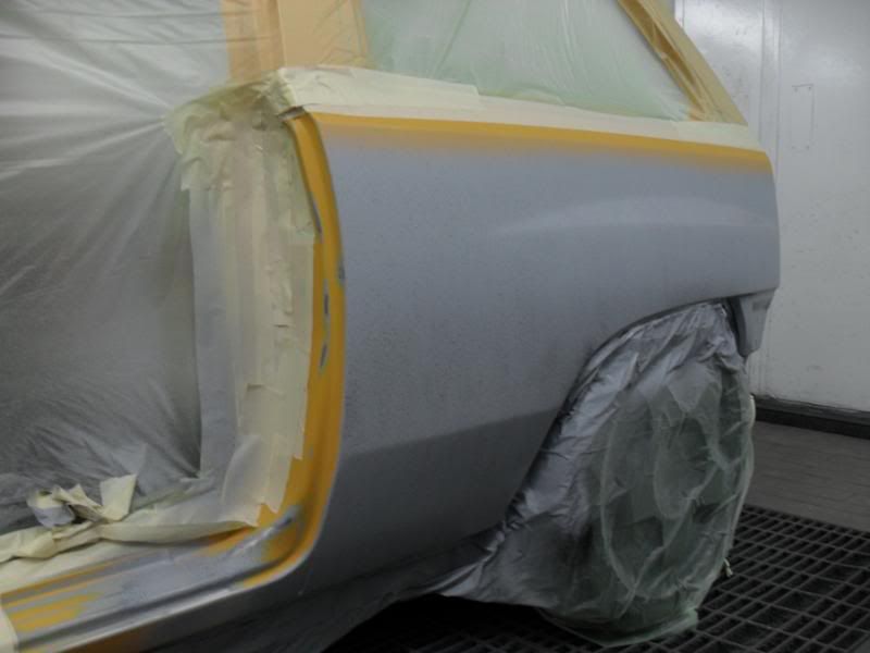

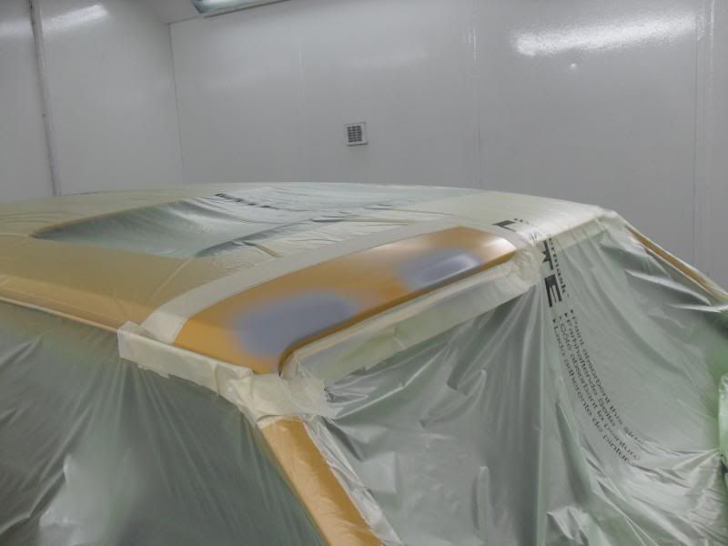

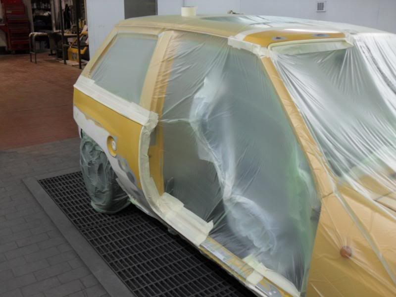

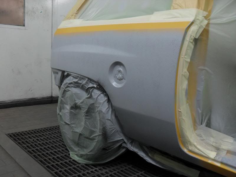

And primed along with a couple of other small repairs that wanted a little primer............
http://i84.photobucket.com/albums/k2...bowip327-1.jpg
http://i84.photobucket.com/albums/k2...bowip328-1.jpg
http://i84.photobucket.com/albums/k2...bowip330-1.jpg
http://i84.photobucket.com/albums/k2...bowip331-1.jpg

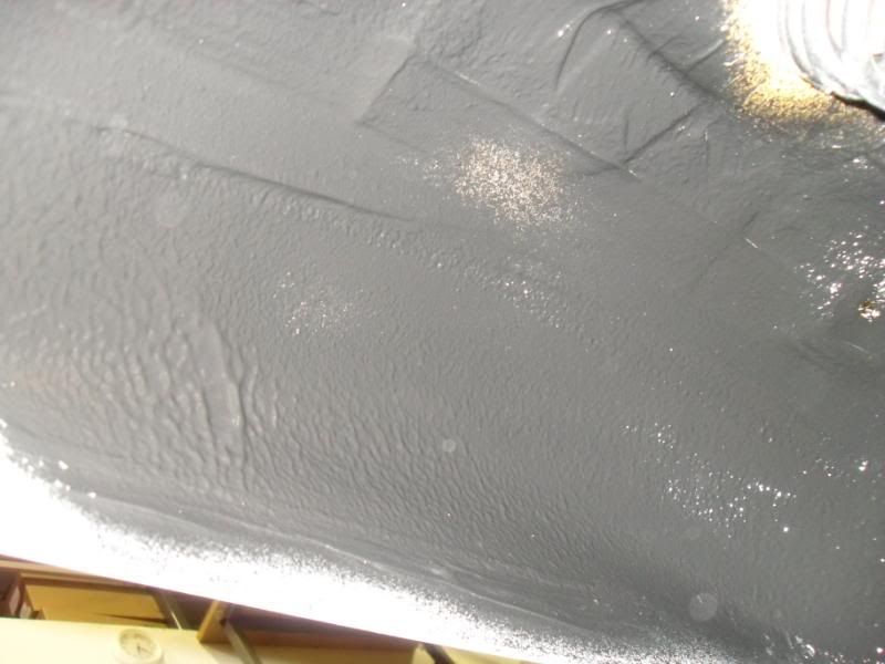

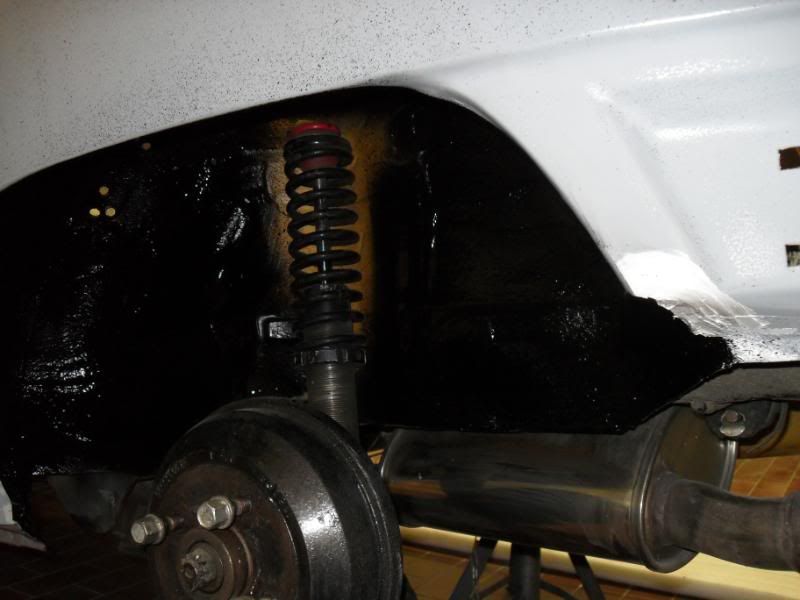

The primer will be left for a few days to allow for any movement as they were fair size repairs etc. It didnt stop me cracking on though! Rear wheel arches were gravitex'd over the seam sealer behind the arch for max protection etc........
http://i84.photobucket.com/albums/k2...bowip334-1.jpg
http://i84.photobucket.com/albums/k2...bowip333-1.jpg

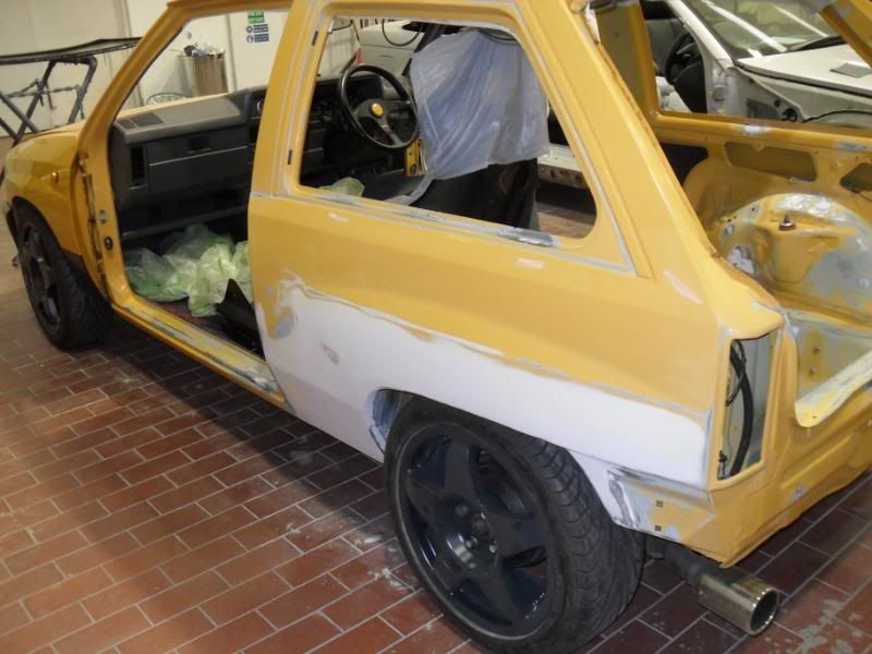

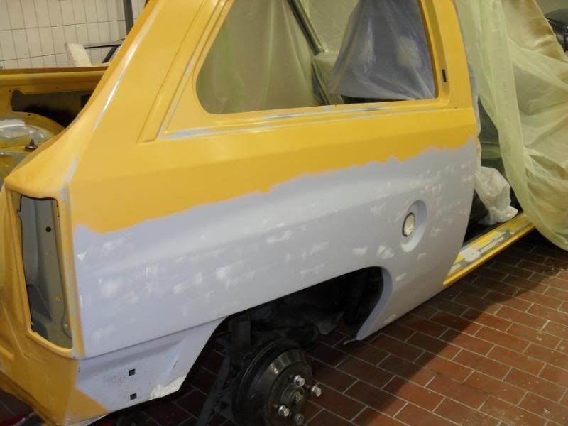

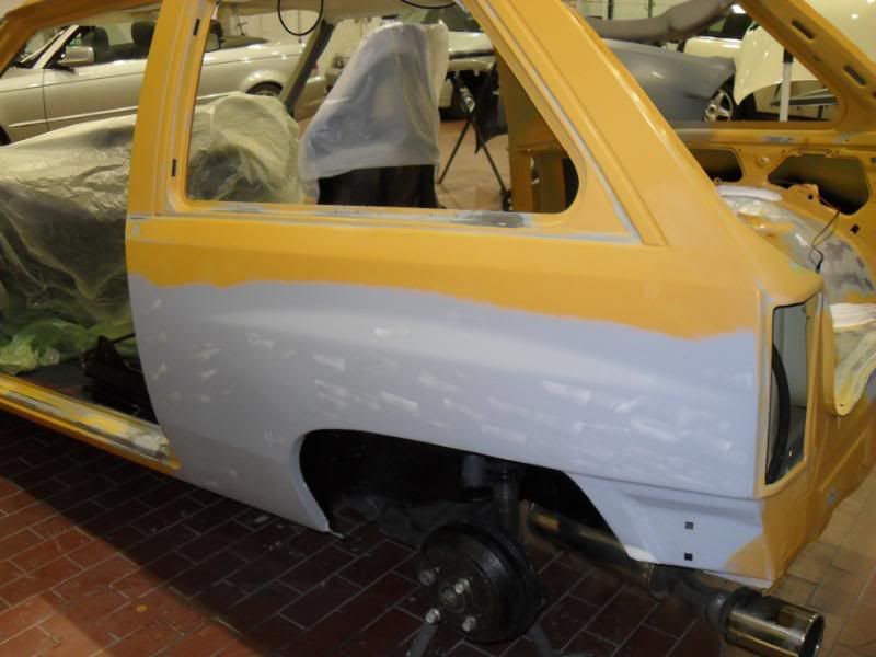

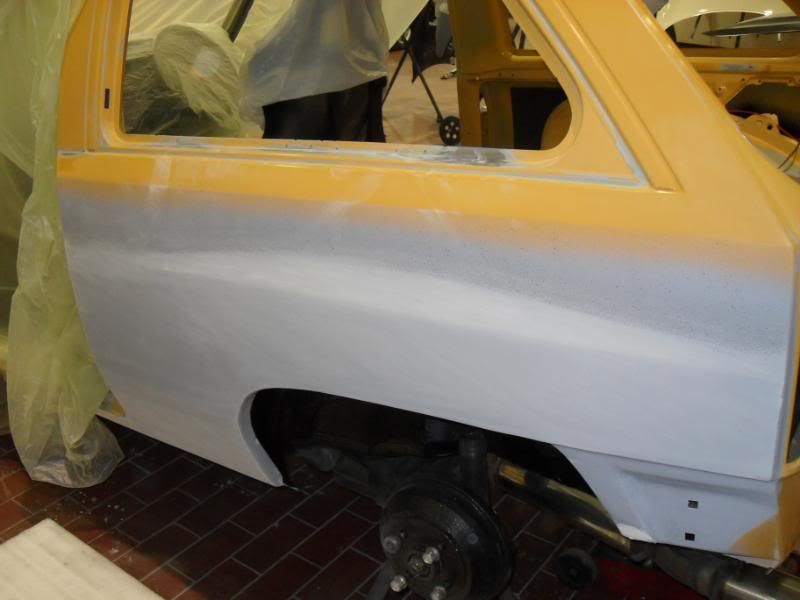

A few days later the primer was then slowly blocked down and stoppered were needed...........
http://i84.photobucket.com/albums/k2...bowip336-1.jpg
http://i84.photobucket.com/albums/k2...bowip337-1.jpg
http://i84.photobucket.com/albums/k2...bowip338-1.jpg

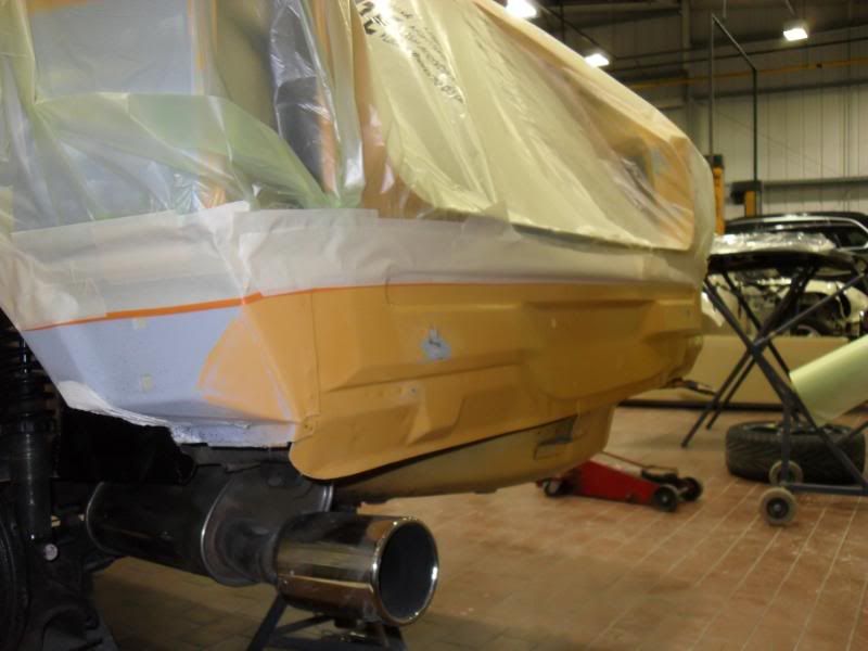

Once all small imperfections were stoppered I thought Id carry on with some more gravitexing adding it to a few more areas than usual for extra protection.........

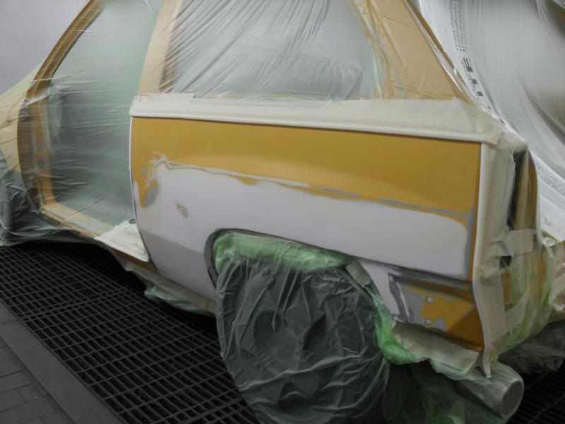

All masked up and fine line taped for a minimal sharp edge........
http://i84.photobucket.com/albums/k2...bowip339-1.jpg
http://i84.photobucket.com/albums/k2...bowip340-1.jpg
http://i84.photobucket.com/albums/k2...bowip341-1.jpg
http://i84.photobucket.com/albums/k2...bowip342-1.jpg

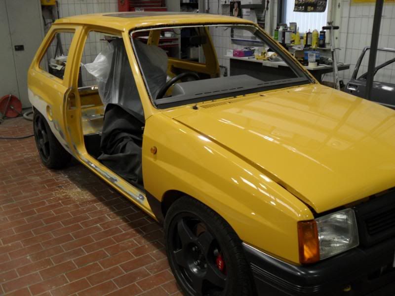

I went right along the sills across the rear panel and around the rear arches too. Ive actually taken the stone guard to the nearest edge on the sill so the whole sills are protected not just two thirds like normal.

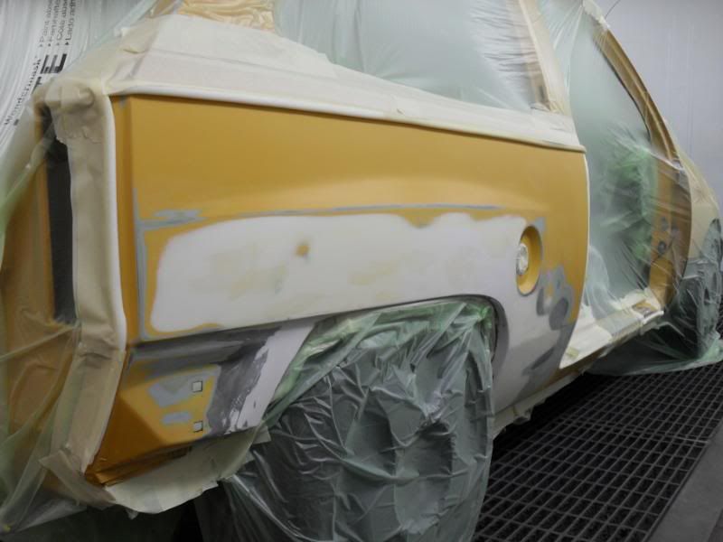

Here shows some finished results......
http://i84.photobucket.com/albums/k2...bowip346-1.jpg
http://i84.photobucket.com/albums/k2...bowip347-1.jpg
Awesome mate! You don't fcuk about do you! I love the high level of detail in all you do. as we all know it's what makes cars like this (and your mk2) what they are. I'm a big fan of colour coding when done tright, and I would have done the same with the wheels and bumpers. A great choice that looks superb. :thumb:
