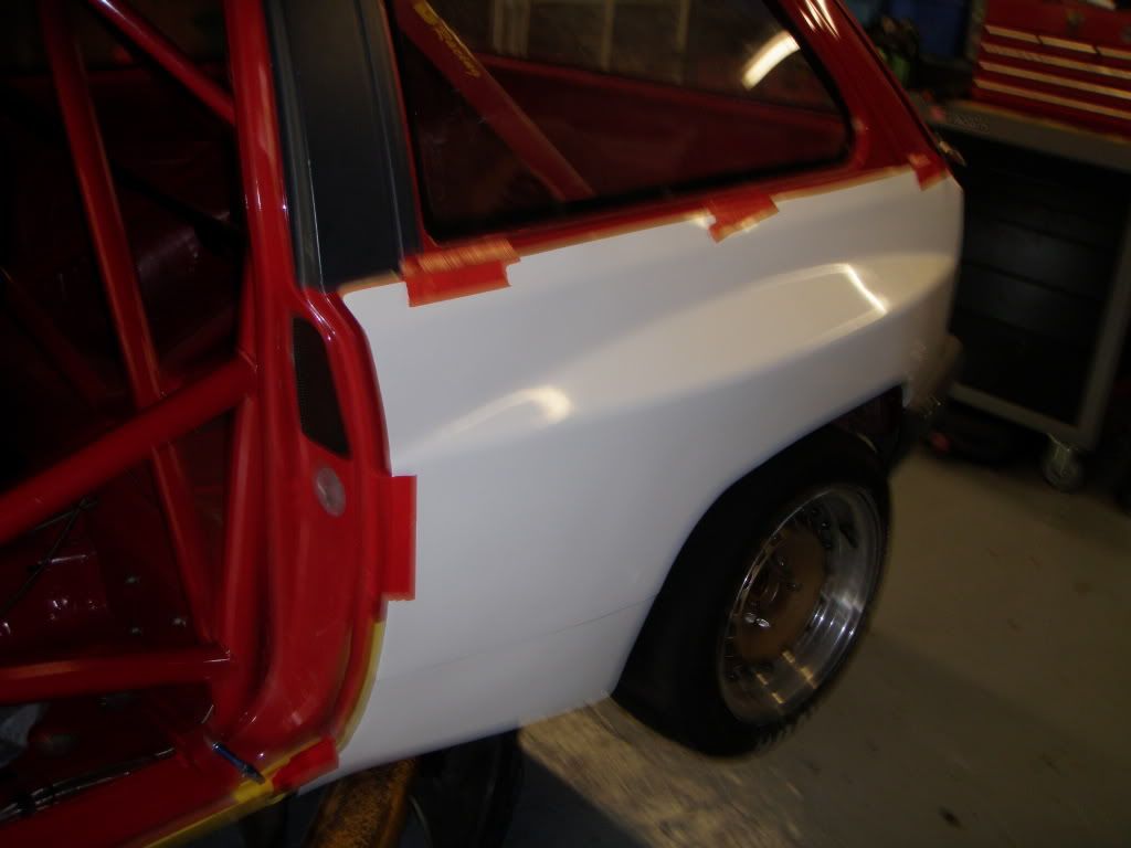

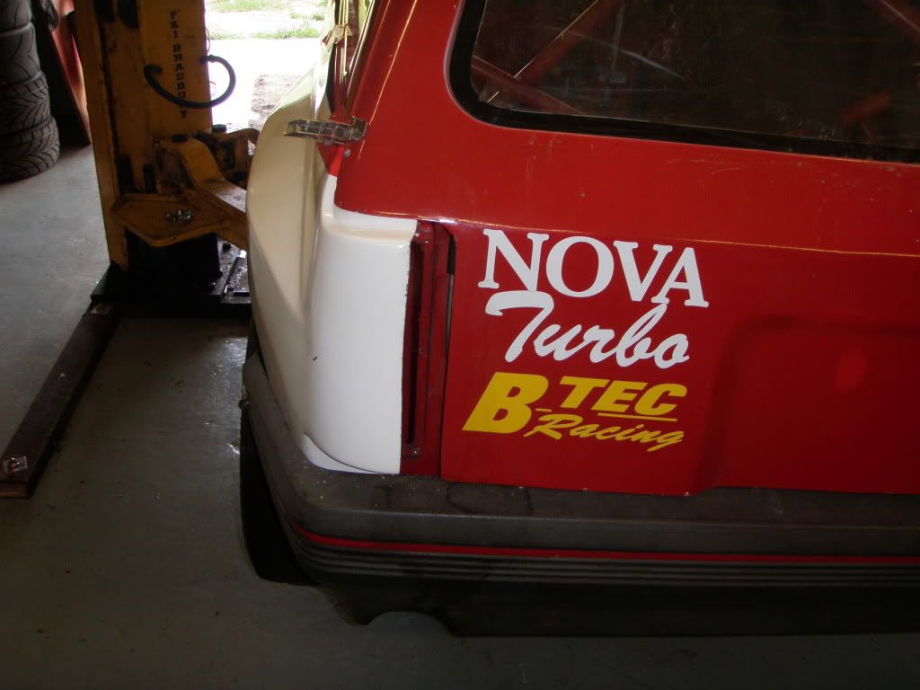

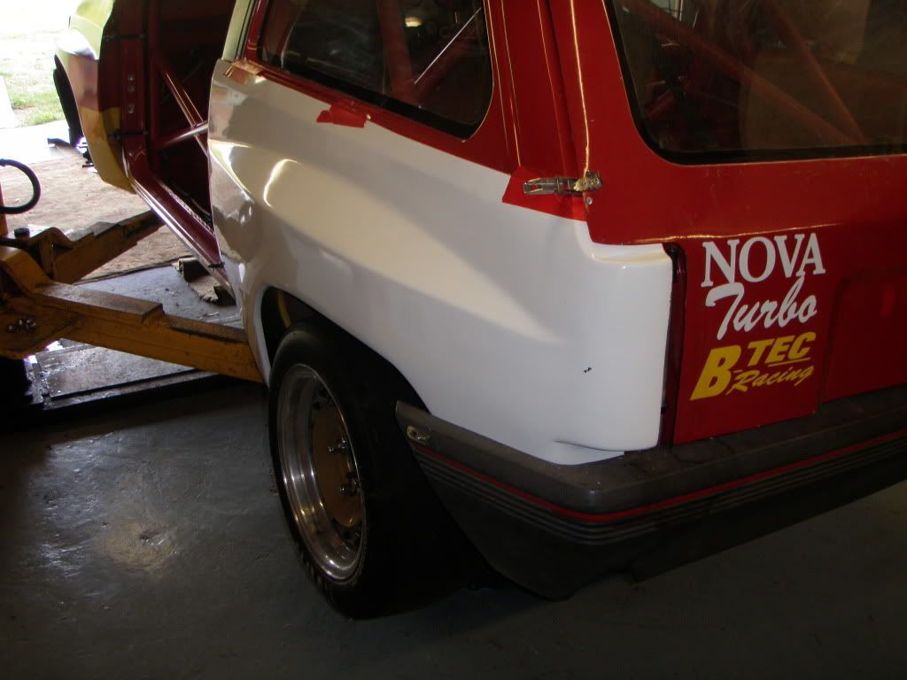

A trial fit of the new rear arches;
http://i285.photobucket.com/albums/l...cort/035-4.jpg
http://i285.photobucket.com/albums/l...cort/036-4.jpg
http://i285.photobucket.com/albums/l...cort/037-5.jpg
The way they fit is a bit different to the previous ones, and as you can see it overlaps the rear light area in a rather odd fashion. I'm not quite sure how I'm going to deal with this yet.........I could cut the arches down to meet the rear light aperture, or I could extend the tailgate to meet up with the rear light 'covers' on these arches.
those wings look very high quality!
"Trial Fit" See; Tape on. :)
They look bloody awesome, I'd personally say cut the arches to meet the aperture, as that's surely lighter than extending the boot?
I cut mine around the rear light aperture but found the arch doesnt quite meet the existing rear quater near the light, if that makes sense ,you could probably persuade it to meet but as its a race car i wasnt too fussed
