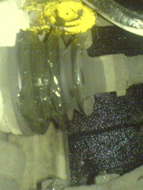

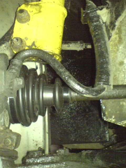

first job was to do the cv boot, up she went on the forklifym wheel off, shaft out, boot on, re-greased, shaft on, wheel on, hey presto
before:
http://i61.photobucket.com/albums/h8...x/DSC00735.jpg
after:
http://i61.photobucket.com/albums/h8...DSC00986-1.jpg

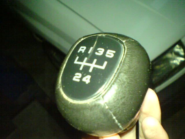

then got a astra mk3 sport gearknob off a white scrapepr
http://i61.photobucket.com/albums/h8...x/DSC00987.jpg
mmm silver numbers lol

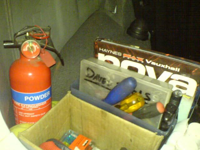

then fitetd the one thing ive been meaning to do since i bought her, just incase, fire extinguisher, powder form incase the engine decided to go at any point lol
http://i61.photobucket.com/albums/h8...x/DSC00989.jpg

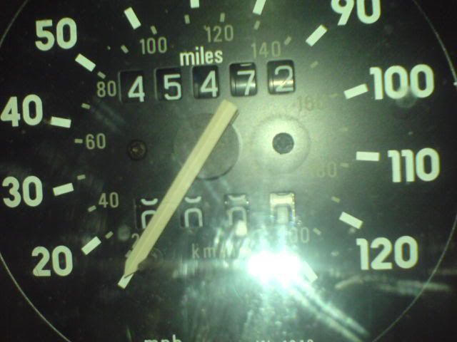

then took the dash out, took it back to its original mileage
old clocks, when i bought her:
http://i61.photobucket.com/albums/h8...DSC00030-1.jpg
the digis all don, plus a mile driven to make sure they still work lol

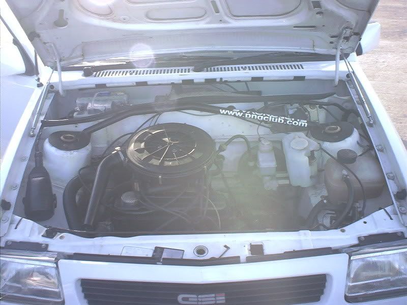

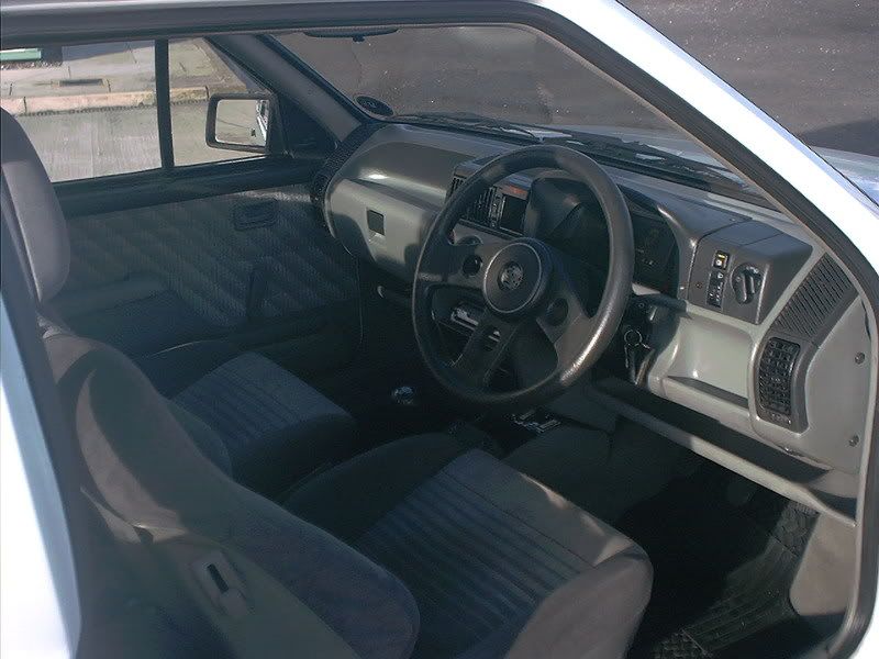

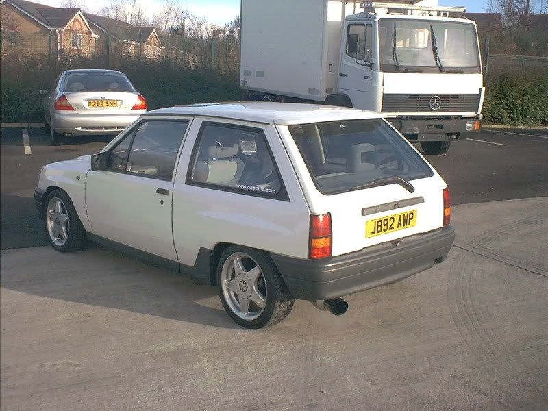

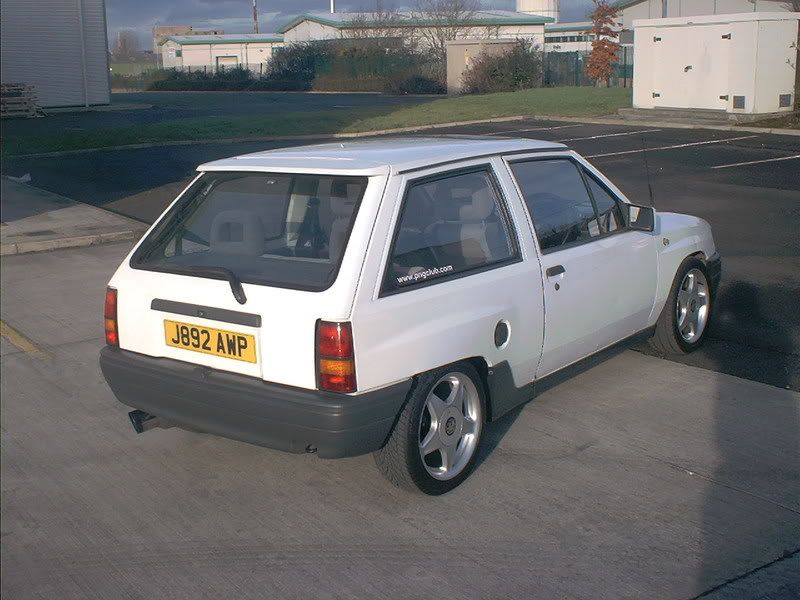

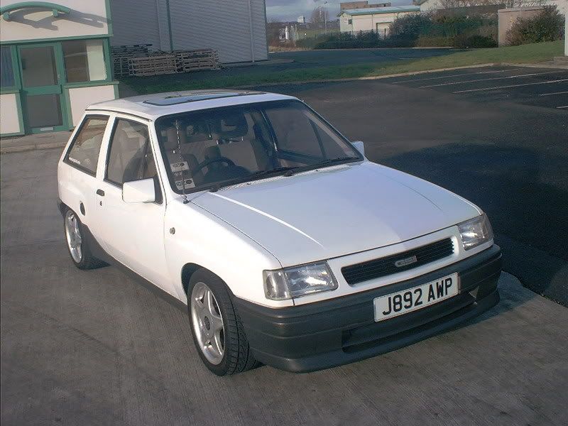

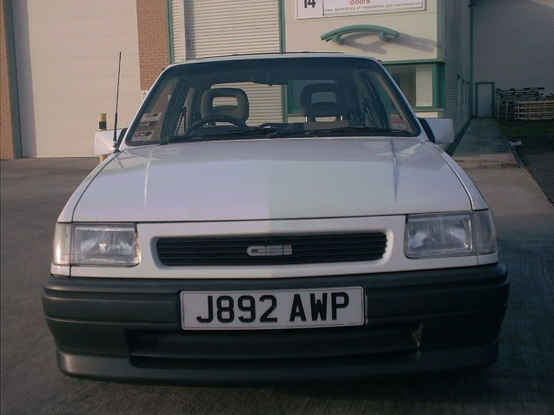

shes now finished, all ready for her mot, swapped the rear lights back to twin fog, checked all the mot necesseties, lights, rot, steering, breaks etc, all tweaked abit, all sorted for her mot begining of february, and i even got some big pics for you all, seen as shes finished lol
http://i61.photobucket.com/albums/h8...x/IM001540.jpg
http://i61.photobucket.com/albums/h8.../IM001540a.jpg
http://i61.photobucket.com/albums/h8...x/IM001541.jpg
http://i61.photobucket.com/albums/h8.../IM001541a.jpg
http://i61.photobucket.com/albums/h8...x/IM001542.jpg
http://i61.photobucket.com/albums/h8.../IM001542a.jpg
http://i61.photobucket.com/albums/h8...x/IM001543.jpg
wish me luck on her passing :thumb:

Nice work on the cv boot.
Did you remove the shaft from the gearbox too?(remember gear oil refill if you did)
Ive spotted a potential mot failure tho.
You have a single outlet screen washer bottle to the windscreen.
But your boot has a wash/wiper fitted. The wiper/wash needs to work for mot, so you need a dual outlet washer bottle ;)
Oh and lifting the car on forklift rails surely cant be doing the chassis any good..
nope we left it in the gearbox, was a hell of alot easier aswell
