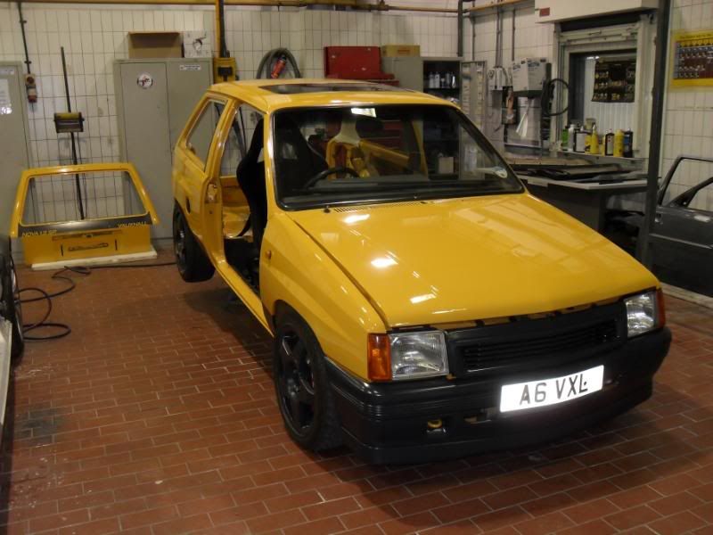

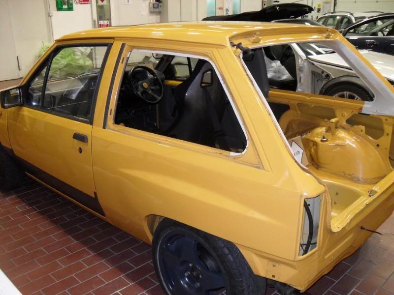

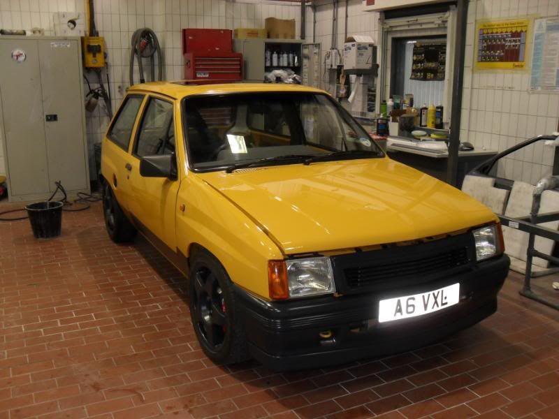

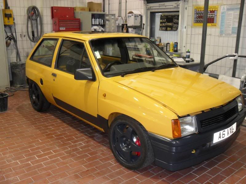

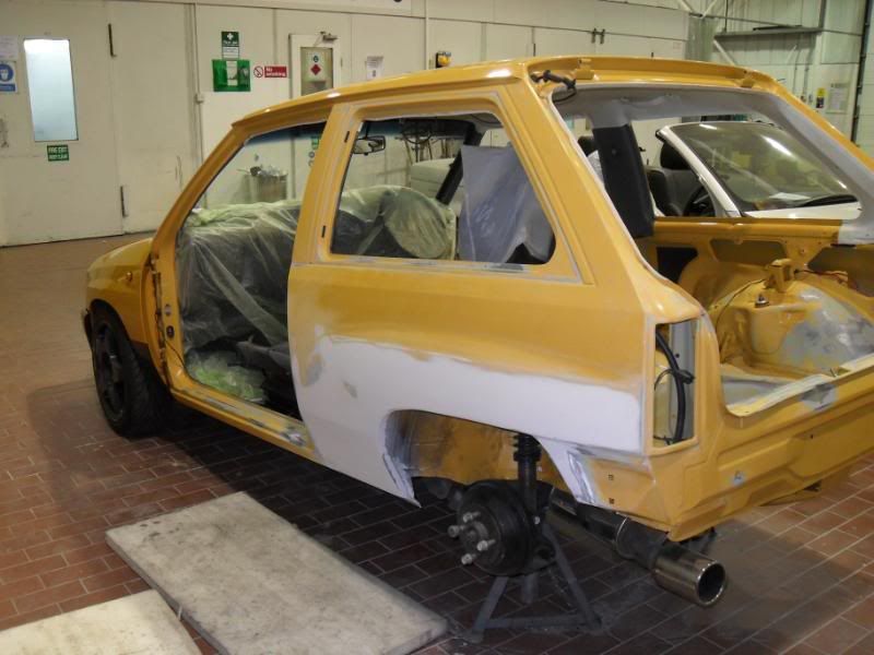

Back to date then....... Last friday I got the car to work ready for paint. Here it is awaiting its fait!.......
http://i84.photobucket.com/albums/k2...g?t=1268857891
http://i84.photobucket.com/albums/k2...g?t=1268858161

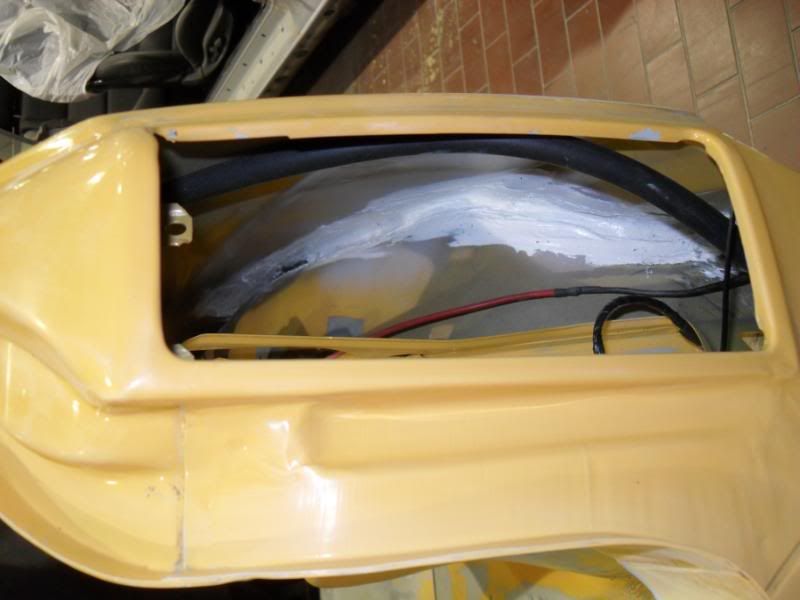

It wasnt long before bits started to come off...........

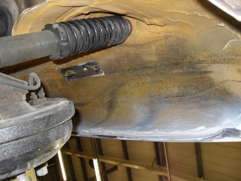

The rear arches had a couple of tiny bubbles but as I know shaun had these repaired previously I bought some rear arches as I thought we may need them. Both rear wheel arches were sanded back to see what lied beneath........
http://i84.photobucket.com/albums/k2...g?t=1268858452
http://i84.photobucket.com/albums/k2...g?t=1268858472

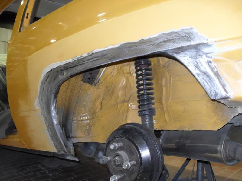

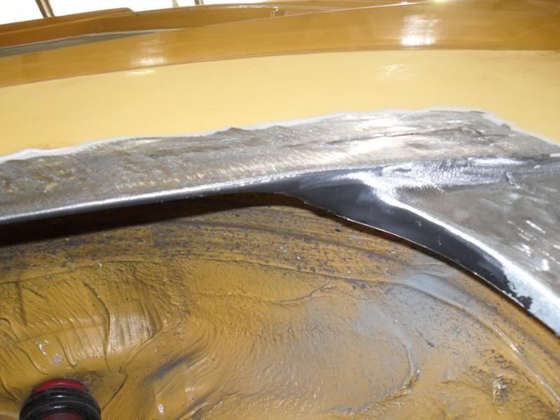

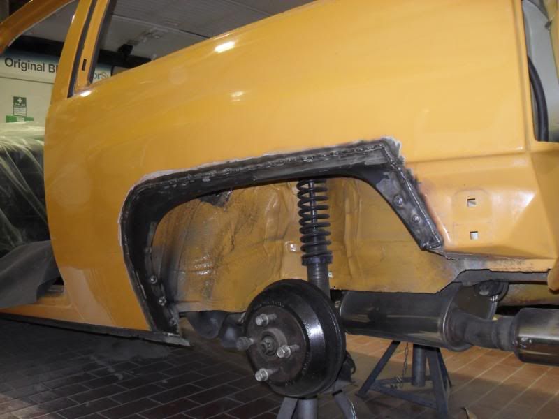

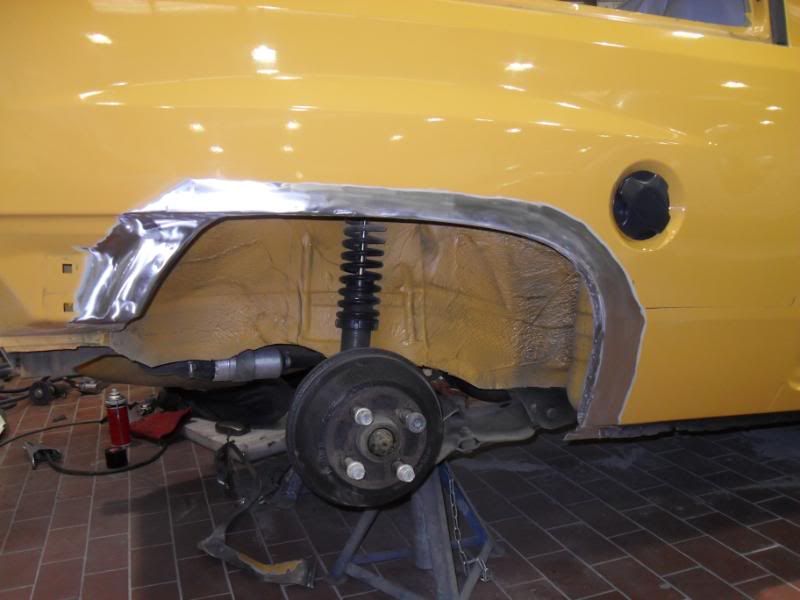

And apart from a few small areas they did look very clean but as I didnt want to be repairing them again in the future the decision was made to fit arches anyway. And to be quite honest it was a decision well made as once the arches were cut out there was some corrosion on the inners too. This was all removed and plated up but what we've done is an idea used by pms on andy and karl rowntrees cars....... The inners have had the lips and a section above removed so the lower quarter area is now only single skin. The new outer lip is then folded over the inner and metal bolded to completely enclose it. However the smallest section possible has been fitted both sides. Heres the new arches going in........
http://i84.photobucket.com/albums/k2...g?t=1268858993
Welded in.....
http://i84.photobucket.com/albums/k2...g?t=1268859042
And ground back.............
http://i84.photobucket.com/albums/k2...g?t=1268859062

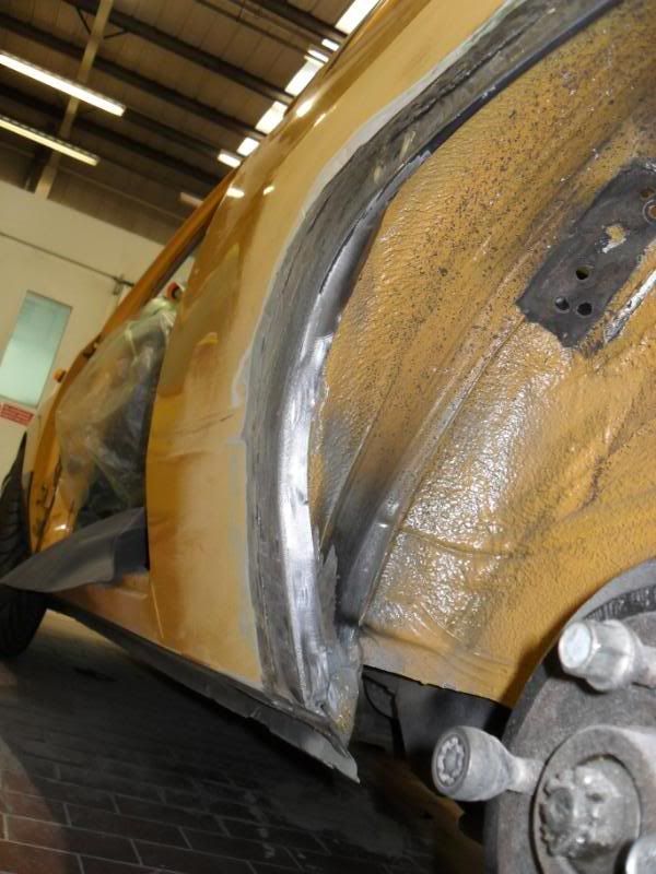

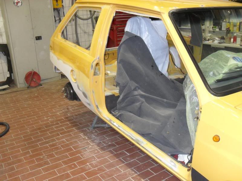

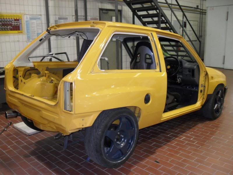

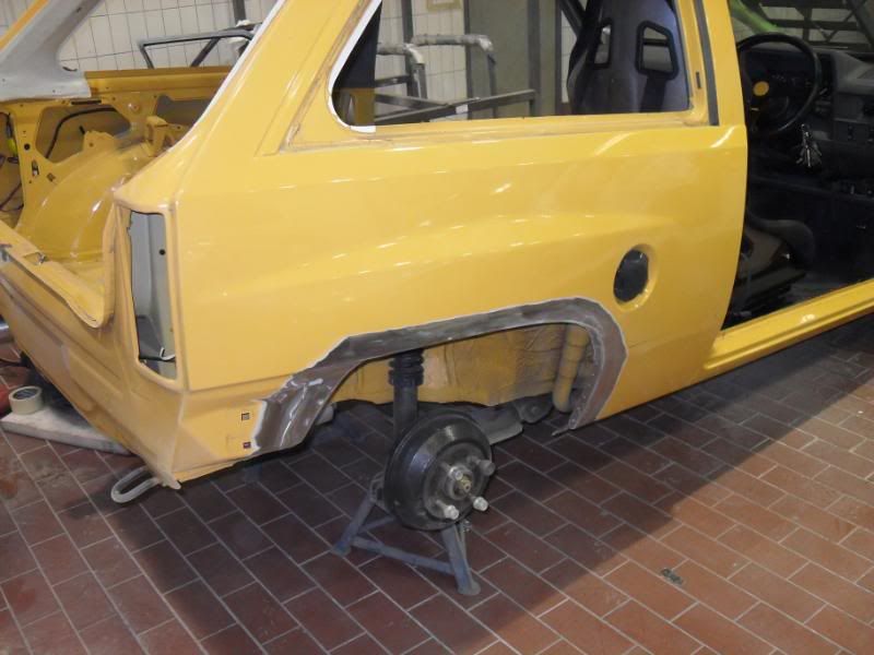

Both arches have also been rolled over with a nice taper at either end same as the front wings etc..........
http://i84.photobucket.com/albums/k2...g?t=1268859322
http://i84.photobucket.com/albums/k2...g?t=1268859403
Then a fair few skims of filler later ............
http://i84.photobucket.com/albums/k2...g?t=1268859486
http://i84.photobucket.com/albums/k2...g?t=1268859572

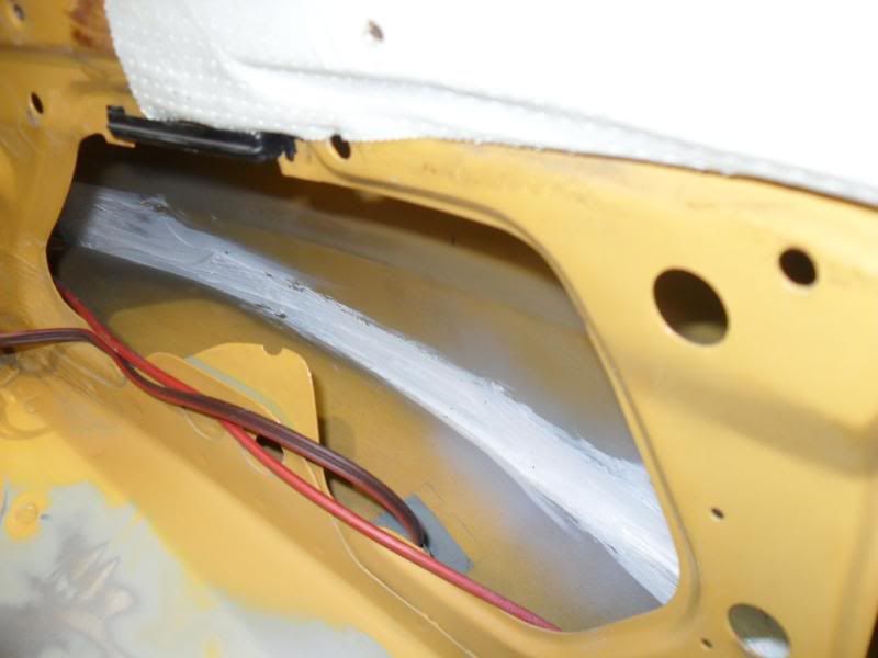

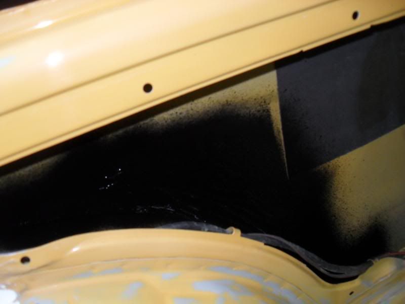

The folded lips were then primed and sealed.....
http://i84.photobucket.com/albums/k2...g?t=1268859647
And the new inners were also sealed in from the inside too........
http://i84.photobucket.com/albums/k2...g?t=1268859730
http://i84.photobucket.com/albums/k2...g?t=1268859775
Followed by some gravitex just for safe measures.......
http://i84.photobucket.com/albums/k2...g?t=1268859806
http://i84.photobucket.com/albums/k2...g?t=1268859866

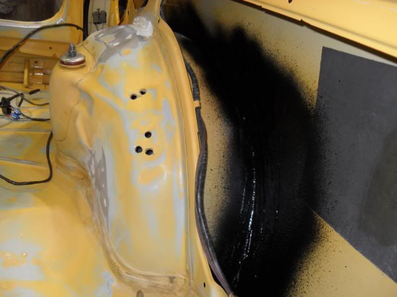

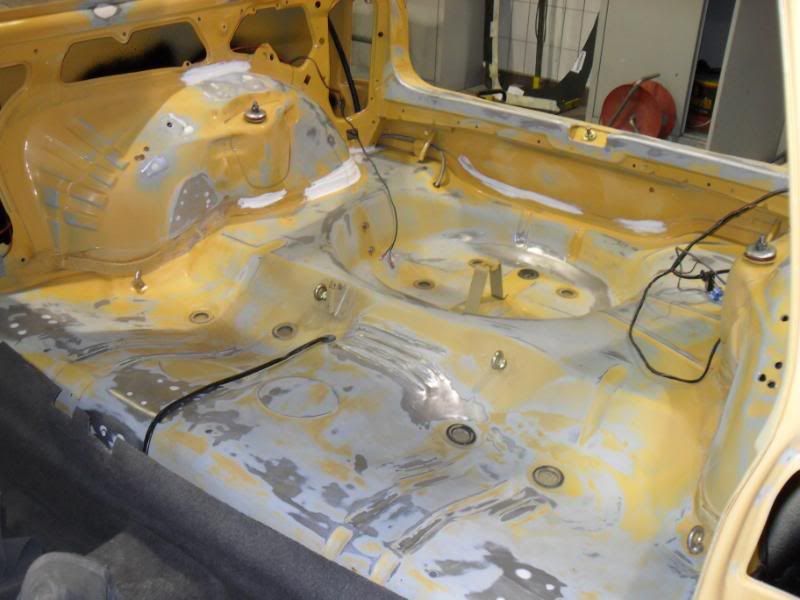

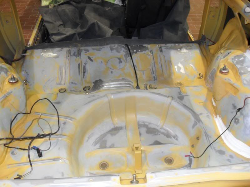

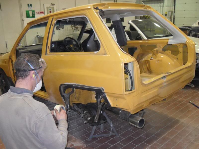

Whilst my panel guy was sorting the arches I was on with preparing the rear of the car..........
http://i84.photobucket.com/albums/k2...g?t=1268860028

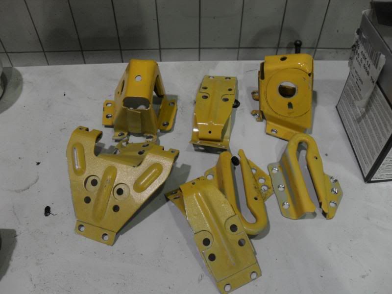

All bracketery has been removed cleanly and the rear smoothed so Ive kept all brackets just in case they are needed in the future etc.
http://i84.photobucket.com/albums/k2...g?t=1268860106
http://i84.photobucket.com/albums/k2...g?t=1268860130

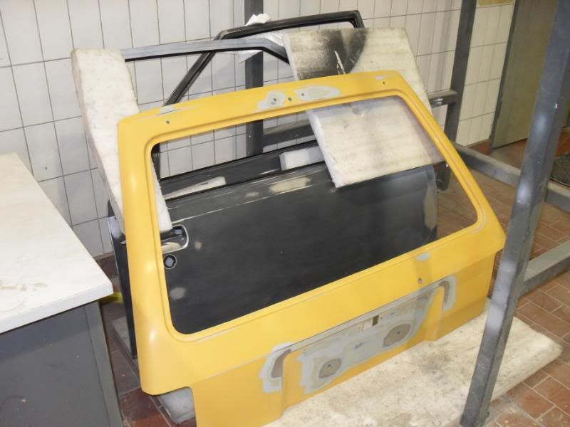

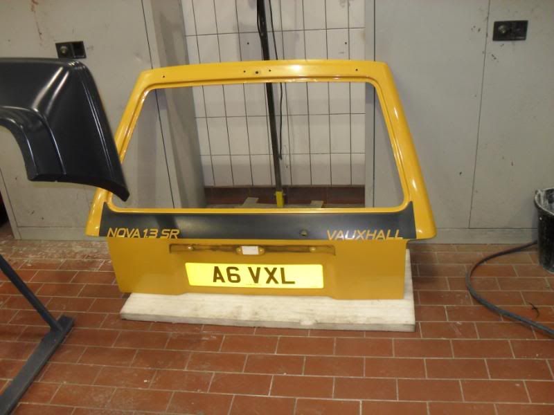

Once I removed the vinyl which took bloody ages! I prepared the tailgate inside and out too...........
http://i84.photobucket.com/albums/k2...g?t=1268860238
http://i84.photobucket.com/albums/k2...g?t=1268860299

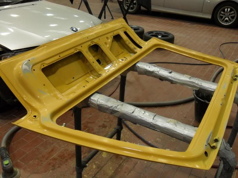

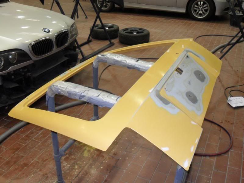

Another panel in the ready pile!.........
http://i84.photobucket.com/albums/k2...g?t=1268860329
