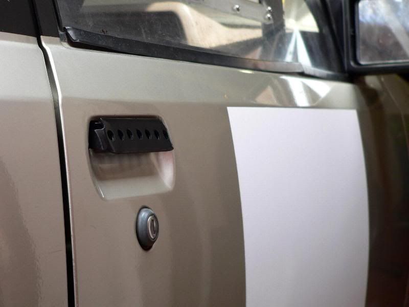

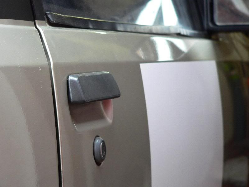

Mainly for weight gains, but also cosmetics too as I like the look of them - Thanks to Oli for the idea on his WIP...
Take a standard door handle complete @ 290grams
http://i136.photobucket.com/albums/q...ure/nc0828.jpg
Remove the thick soft rubber by slicing it up with a hacksaw (always thought it was just thin plastic)... down to around 170grams
http://i136.photobucket.com/albums/q...ure/nc0829.jpg
The take drill bit, 8.5mm for me, and a grinder to the face to remove some of the 3mm thickness from the metal, down to just under 2mm, drill some holes (7 for me)... and finally 120grams... spose I added a coat of paint after this lol
http://i136.photobucket.com/albums/q...ure/nc0830.jpg
From this
http://i136.photobucket.com/albums/q...ure/nc0826.jpg
To this
http://i136.photobucket.com/albums/q...ure/nc0827.jpg
Original handles @ 290g each x 2 = 580g / over half a kilo
After handles @ 120g each x 2 = 240g ... less than one handle used to be
340g saving lol every little helps...

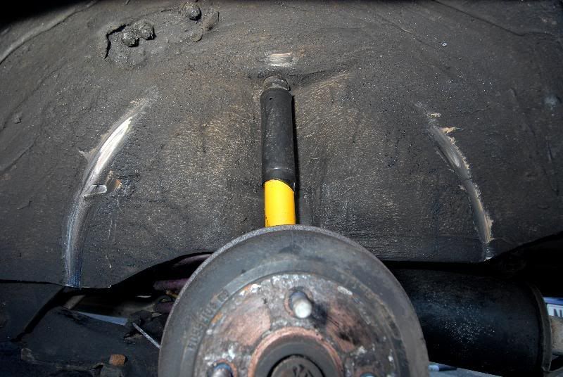

sorry i don't know if this has been asked but why did you now use coilovers at the back?
chris
Couple of reasons...
Firstly... Clearence issues...
I know a couple of people with rear 1.9" Avo coilover that have no problems...
Then I hear of others having to add wheel spacers as they catch the inside of the tyre... but adding spacers means the outer edge of the tyre will catch the arch.
Turretted rears or not, clearence is always an issue so it appears. ie: having to relocate the bottom shock mount more inwards on the beam etc
With me running 888s, and looking for some even wider full race slicks, I didn't want to have to start arsing about with clearence
As you can see, even with a single thin shock, I'm still fairly close to that, now imagine a thicker shock, and a spring wrapped around it in it's stock location
http://i136.photobucket.com/albums/q...ure/nc0628.jpg
Secondly... this setup - which offers exactly the same benefits as "rear coilovers" as in ride height, high poundage springs, damper adjustability, and corner weighting ability... this setup cost me only £50, as opposed to a couple of hundred :thumb:
Also - it's the way the grpA Novas were done 'back in the day', well, without the spring retainers anyway.
