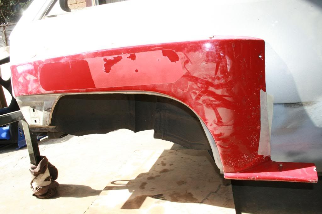

So I decided i needed to get on with fitting the wide rear arches to accomodate my 50mm extra width!

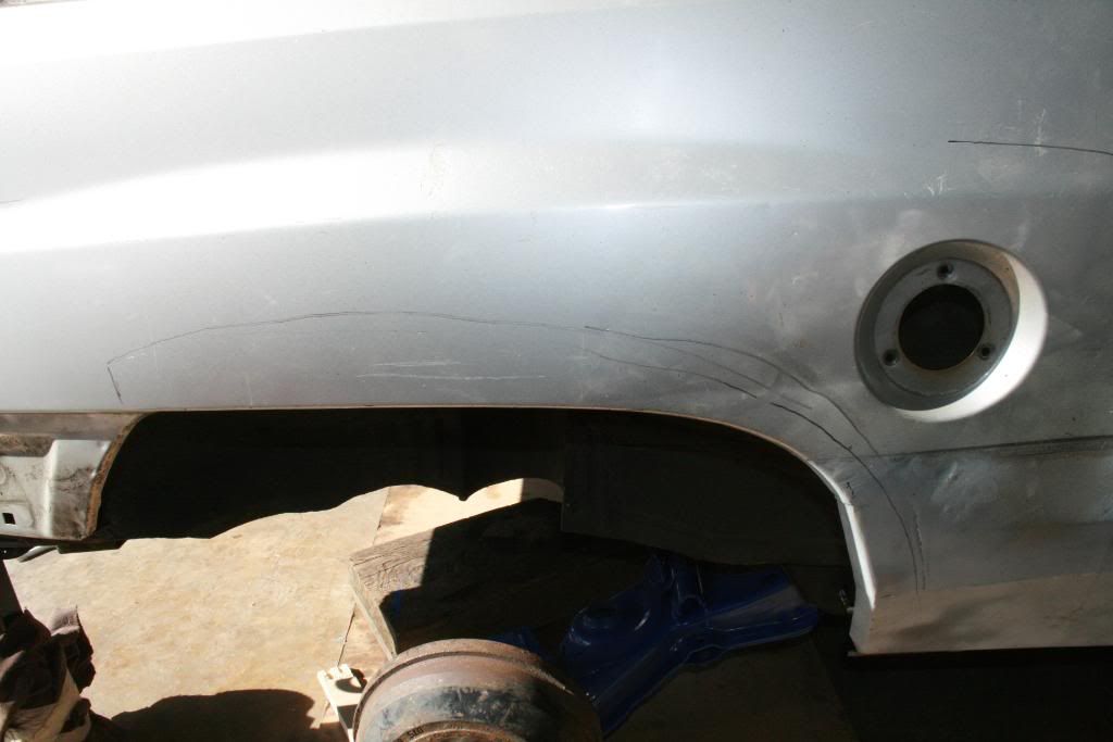

I started by offering up the arch to the car - some one at some point has fitted these, i'm not sure if they came as they are of if they have been 'modified' but the fit is truly w@nk!
Arch offered up
http://i248.photobucket.com/albums/g...etrack1013.jpg
http://i248.photobucket.com/albums/g...etrack1014.jpg

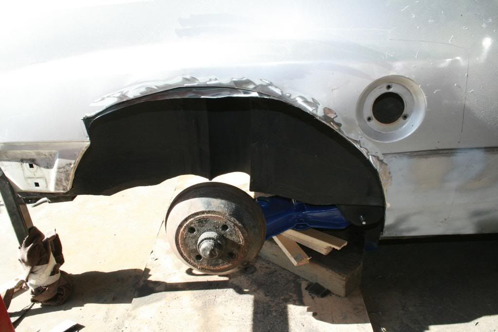

A rough marking of how far up i can cut (although i ended up going further once i knew exactly what was behind were i was cutting)
http://i248.photobucket.com/albums/g...etrack1015.jpg
Out came the grinder and i savaged it off.

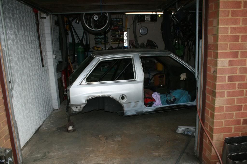

I then fitted the rear axle, the spacer (soon to be replaced by an actual weld in spacer) and the wheel. After some more head scratching and drawing over the car i concluded i could cut higher so i did.
This is how much extra width i now have on each side!!
http://i248.photobucket.com/albums/g...etrack1016.jpg
http://i248.photobucket.com/albums/g...etrack1021.jpg

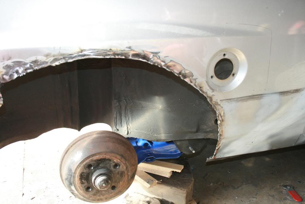

As you can see below i cut the outer skin higher than the inner so i could fold the inner skin up to the outer
http://i248.photobucket.com/albums/g...etrack1022.jpg
And weld them both together again - this arch mod means the wheel can now move up higher were as before it just fouled the arch very severely. All this will be covered by the new F/G arch.
http://i248.photobucket.com/albums/g...etrack1024.jpg
I made sure to sealed up the seam inside the car to stop any unwanted moisture getting in the crevis

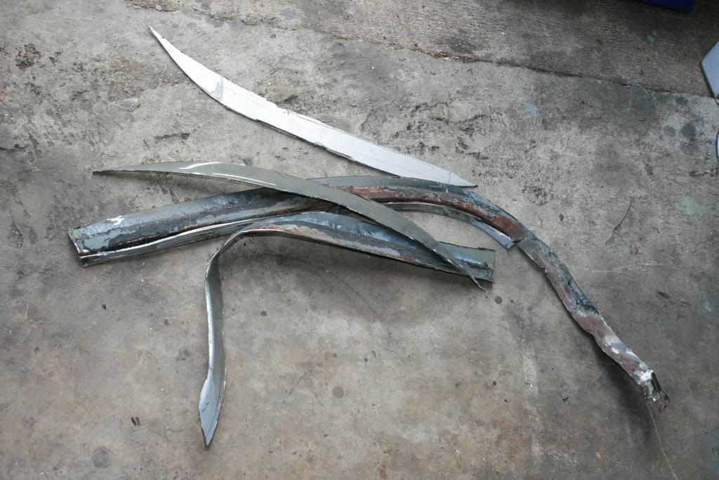

Oh and the remains
http://i248.photobucket.com/albums/g...etrack1028.jpg

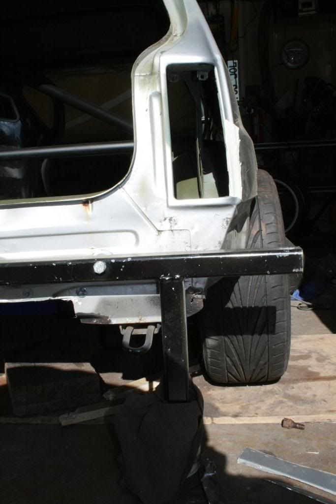

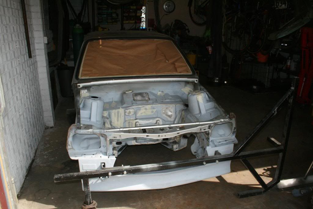

Once i had reached this stage i was comfortably certain that the new F/G arch wouldn't fit as i wanted without some more 'modifications' so i decided to spin the car round to get to the other side and the engine bay as so
http://i248.photobucket.com/albums/g...aypaint001.jpg
http://i248.photobucket.com/albums/g...aypaint002.jpg
http://i248.photobucket.com/albums/g...aypaint003.jpg
Much better!

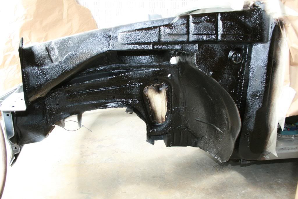

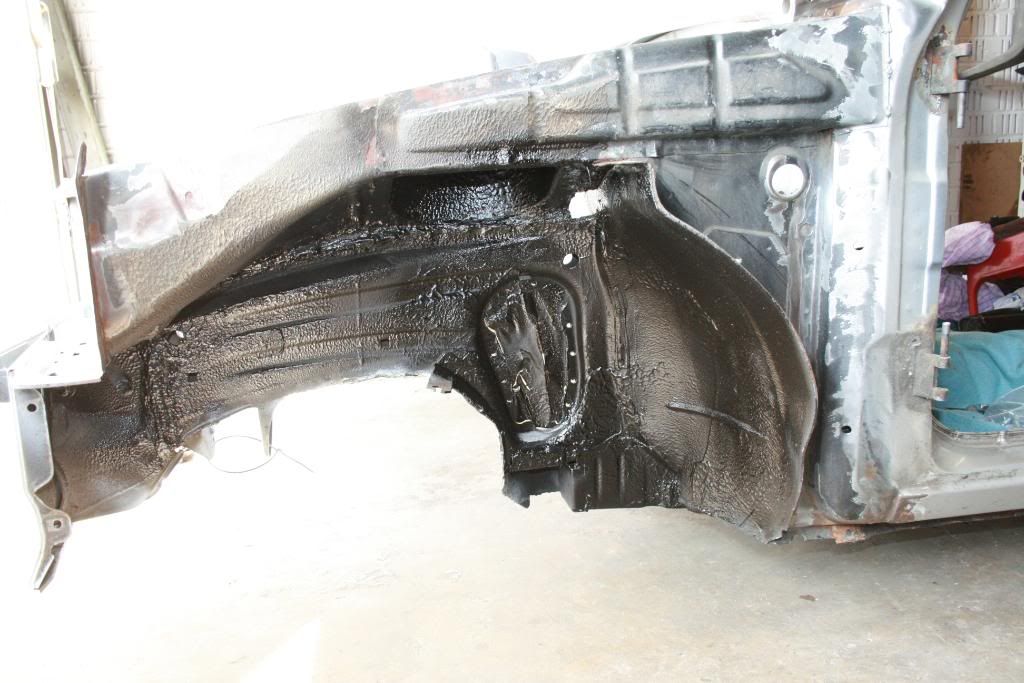

Once i had good access to the front of the car i decided i should treat the front inner arches to some more stone chip for good measure as they were a bit patchy
http://i248.photobucket.com/albums/g...aypaint004.jpg
http://i248.photobucket.com/albums/g...aypaint007.jpg
