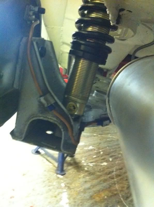

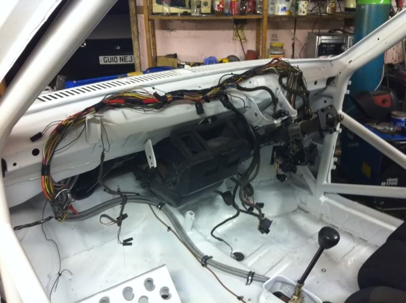

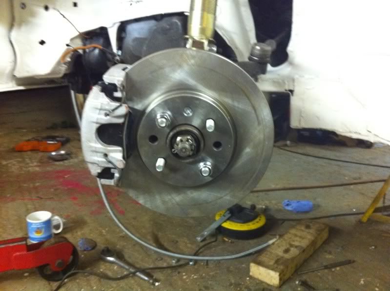

I put some more work into this thing today, decided to leave the seats before i booted it off the axle stands!
Handbrake cables on, shoes adjusted etc, drums on, shocks on, rear brake lines on, front calipers on, loom checked and in place, backplate for TBs is done, wiring to alt/starter etc done, fuel lines all re-riveted on again, looked at fan/oil cooler positioning etc.
The dash id round my mates, has come out ok without being great, but itll do!

Thinking this is too infront of the rad, especially as i have a 'blower' fan....
http://img.photobucket.com/albums/v1...a/19f0842f.jpg

Cut the pass seat rails out.
Clipped some fuel lines down, and wiring.

Could you sit the oil cooler more to the left and stand it on its end? Will still get loads of air then but be out of the way of the rad.
