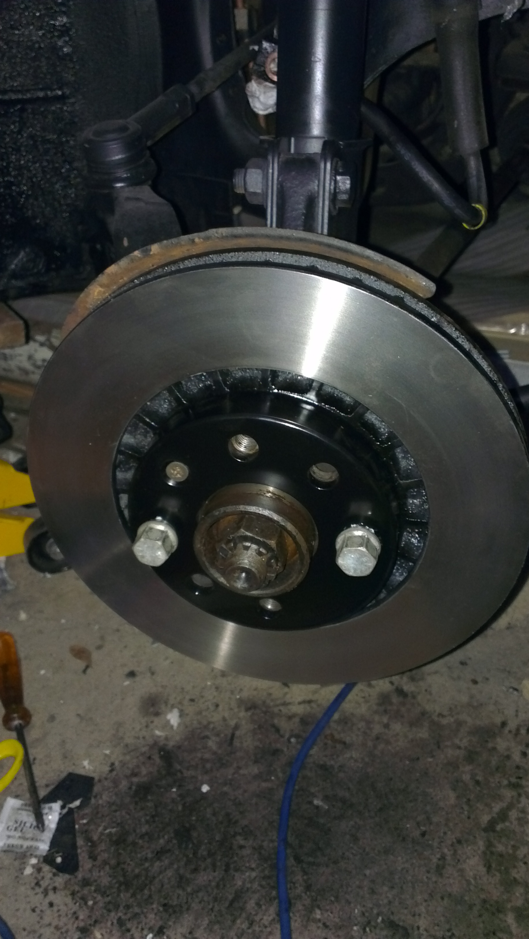

Gave the disc shield a good old clean and gave it a coat of stone chip. I had to also bend the shield back a few mm's as the larger discs would obviously foul the shield.
Trial fit the disc to make sure it cleared the shield.

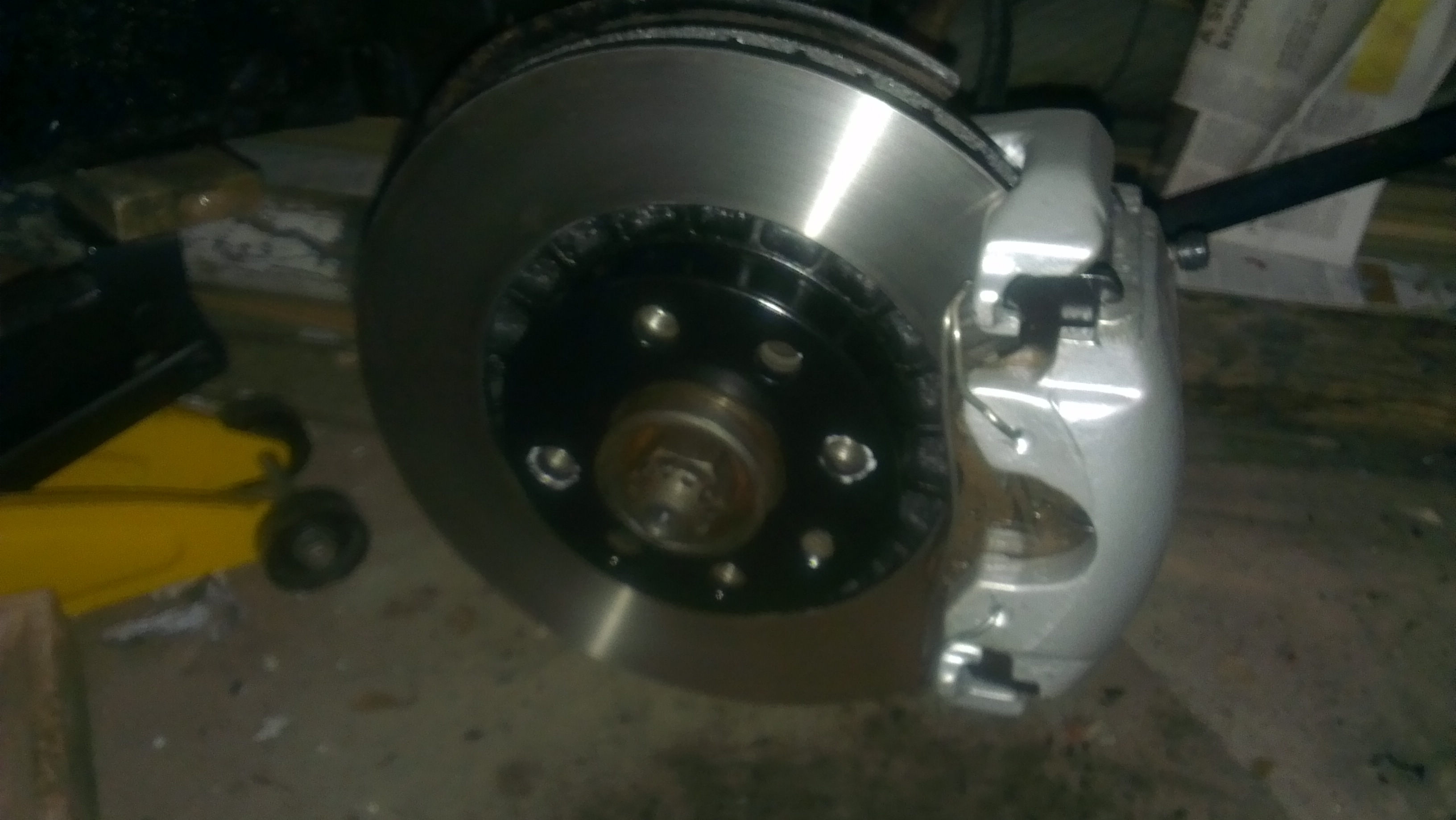

Now it was time to fit the calipers
https://images2.imgbox.com/37/fe/9wyj1pPR_o.jpg
Totally easy to fit which was a breath of fresh air as everything else leading up to it was a bit of a pain. Then fitted the brake lines.

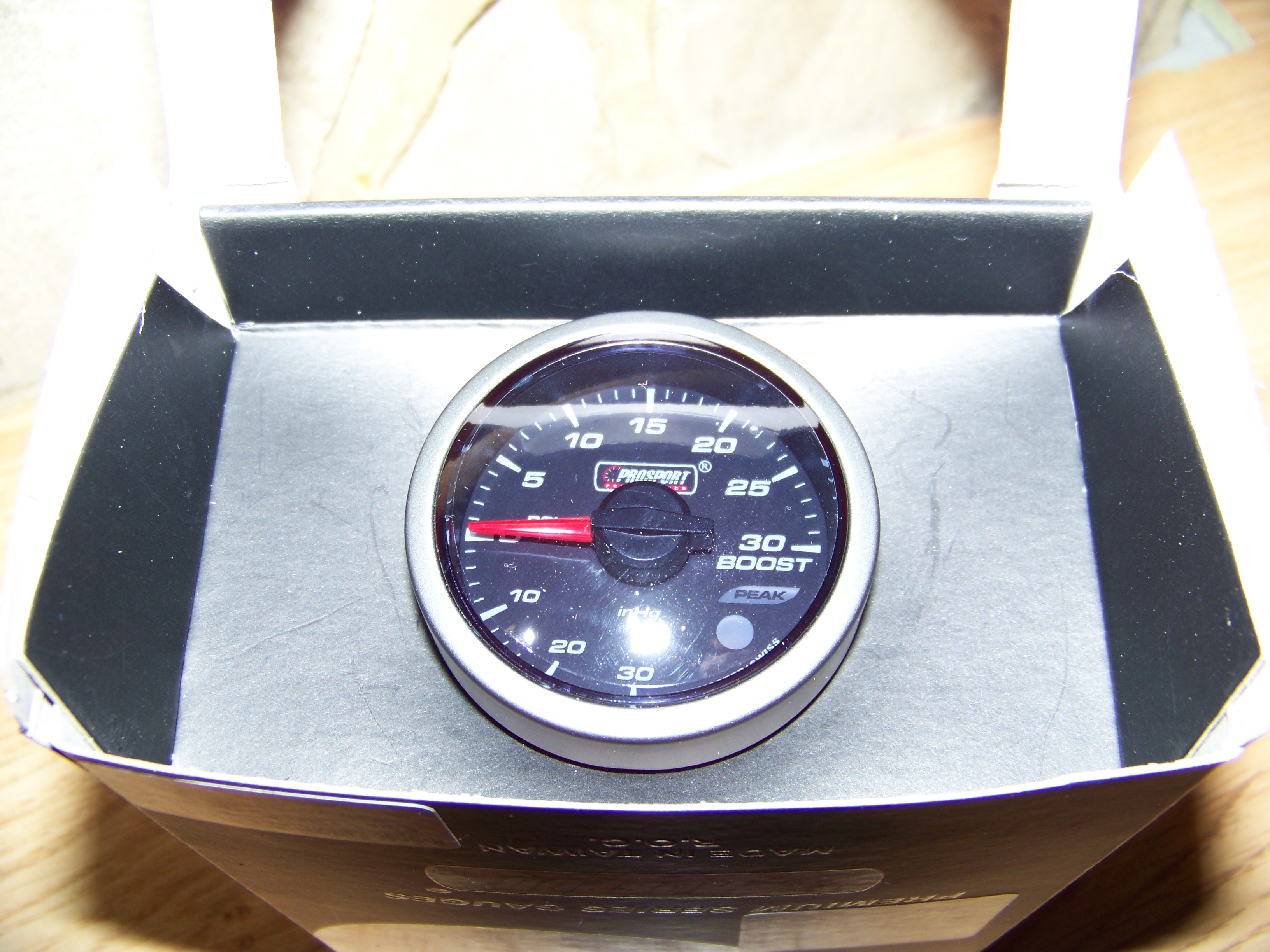

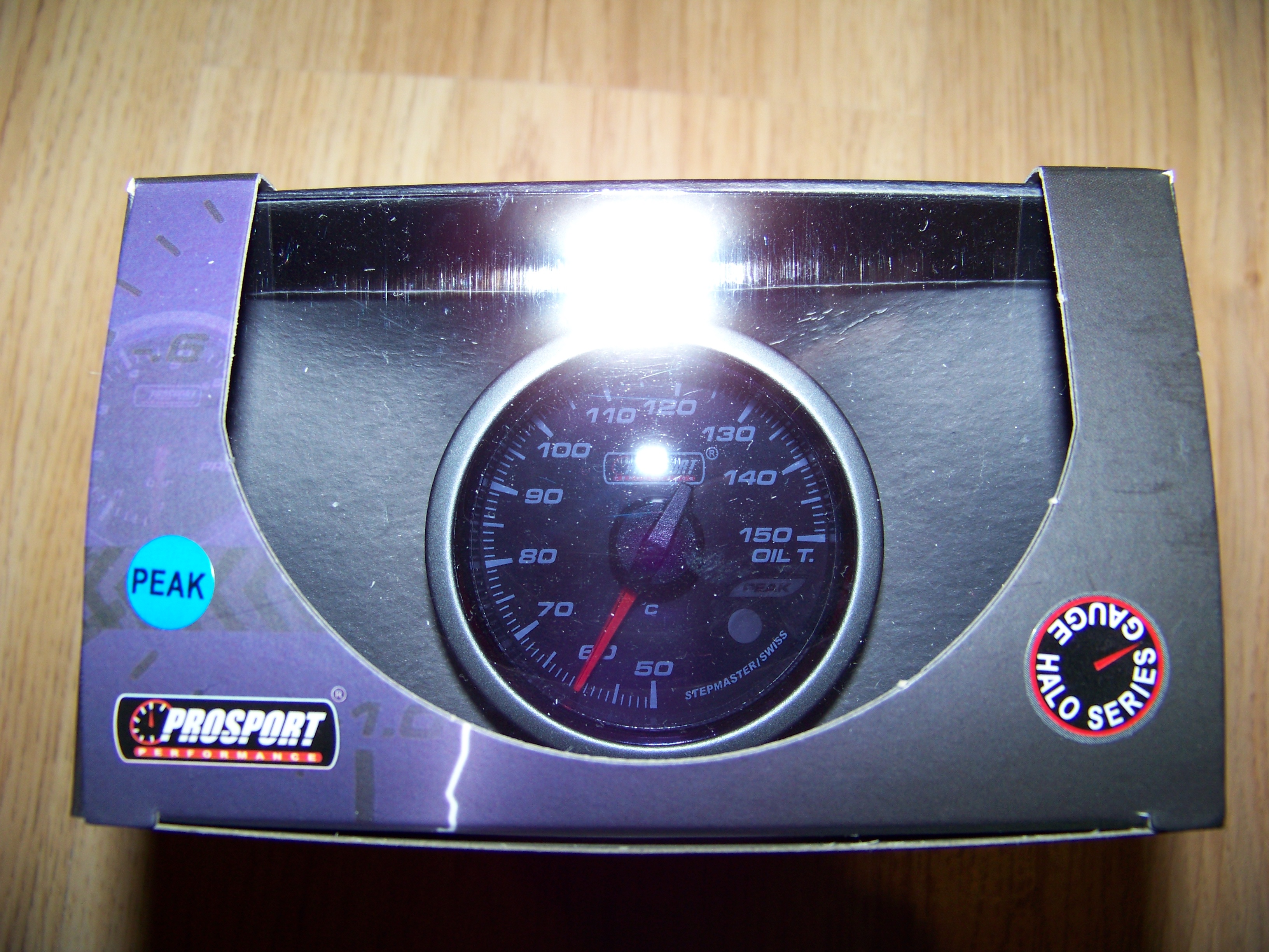

Was my birthday last weekend... got the usual pressies like clothing, money and smellies but also got two things which would be really useful. One of them would be this:
Prosport PSi Boost Gauge
https://images2.imgbox.com/cf/fc/aRmlZePf_o.jpg
https://images2.imgbox.com/82/a5/m3U1NlLS_o.jpg
Comes with everything you need to get them to work, they can be daisy chained so you only need to wire one in and the rest will run off the other. This model is setup by a touch sensitive control switch, multiple colour display and have warning beep or peak light which can be setup to desired value.
Here's how it should look when on as when they are off the dial face is almost blacked out
