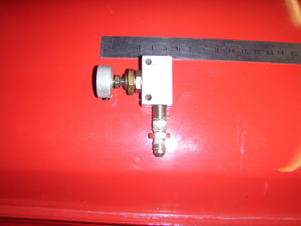

I ran it on the brake rollers at my friendly local MoT station, and the back brakes were locking up with almost no pressure on the pedal.
And it didn't seem to make a blind bit of difference on where the pressure valve was adjusted to either. Also, rather worryingly there was no physical 'stop' on the valve, so you could actually unwind the knob completely out of the valve (and then spray fluid over the whole interior!).
So I pinched the AP Racing pressure valve off my Fiesta circuit race car, and installed that in the Nova.
With the brakes bled and back on the rollers, there was an immediate improvement, as I needed to properly stand on the pedal to lock the backs up.
