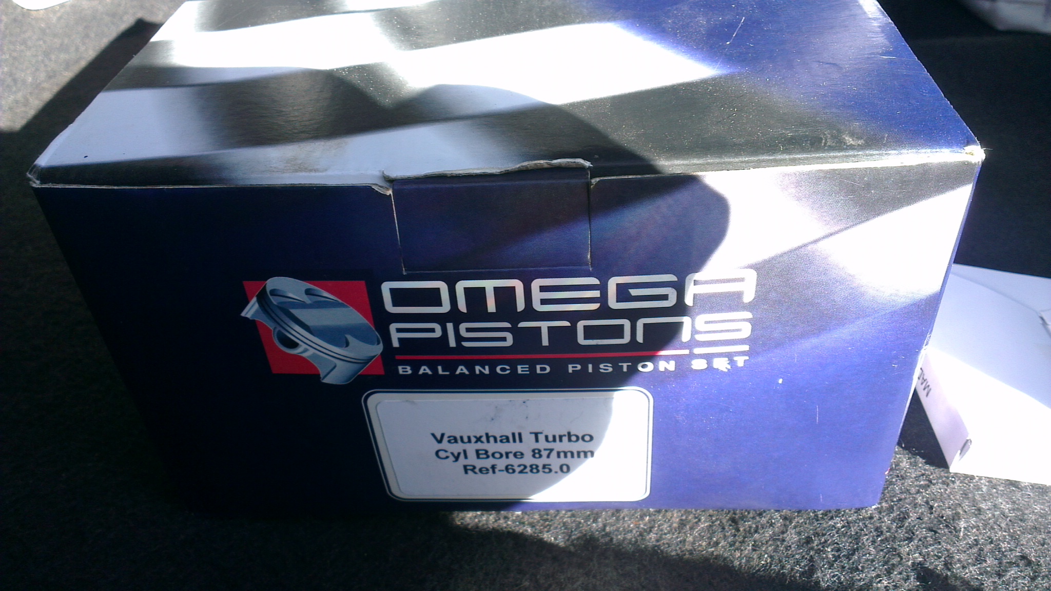

UPDATE
A bit more productive this time...
Went and met Steveboyslim in the morning to pick up my new pistons... we're about 5 miles apart so to save time and postage fees a quick trip to him was best.
He's a top bloke with plenty of knowledge and sense... picked up these beauties
https://images2.imgbox.com/46/4e/Fb0JVCg4_o.jpg
https://images2.imgbox.com/16/af/KXADkTkN_o.jpg
http://imageshack.us/a/img207/1127/imag0621i.jpg
https://images2.imgbox.com/94/3f/BbgOhbYT_o.jpg
http://imageshack.us/a/img850/8783/imag0620n.jpg
Pure engineering Pr0n- 4 new Omega pistons with rings, pins and clips.
Then went and had a spot of breakfast and dropped the pistons to the engine shop to measure up and bore to the exact size.
Should get the block back in the next few days...
