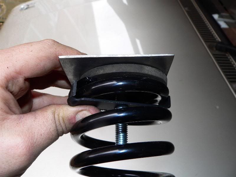

Seconded/thirded on nice work on the spring retainers, I think I'll either go that route or the beam straps at some point in the near future, think my cable tied rear springs are frowned upon :cry:
Well, the beam straps are OK - but I'd personally wouldn't like the springs not being "held" in.
I know I know, standard Novas, and 99% of cars on the road don't have rear springs held in, but then 99% of the cars on the road don't have them this small.
I'll end up doing both, the retainers to hold them up to the car, and the straps to get rid of the "banging" should there become a gap...

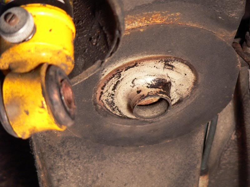

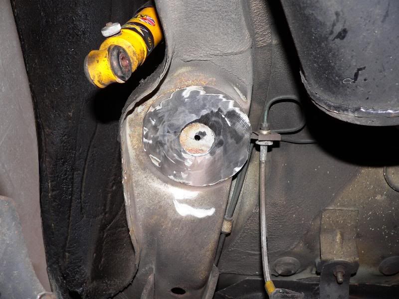

When you remove your rear spring, on the chassis you will have a locating nipple so the spring knows where to be seated
http://i136.photobucket.com/albums/q...ure/nc0802.jpg

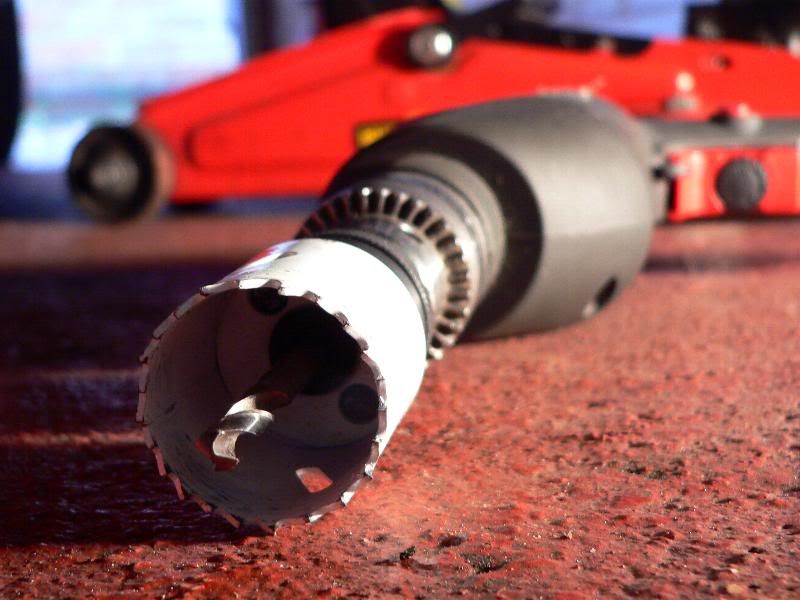

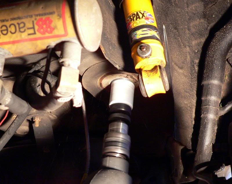

Our weapon of choice, a 40mm hole saw, after deciding a angle grinder wasn't approprate due to space
http://i136.photobucket.com/albums/q...ure/nc0803.jpg
Matt gets with down and dirty with it lol
http://i136.photobucket.com/albums/q...ure/nc0804.jpg
Action shot, gotta love a bit of action
http://i136.photobucket.com/albums/q...ure/nc0805.jpg

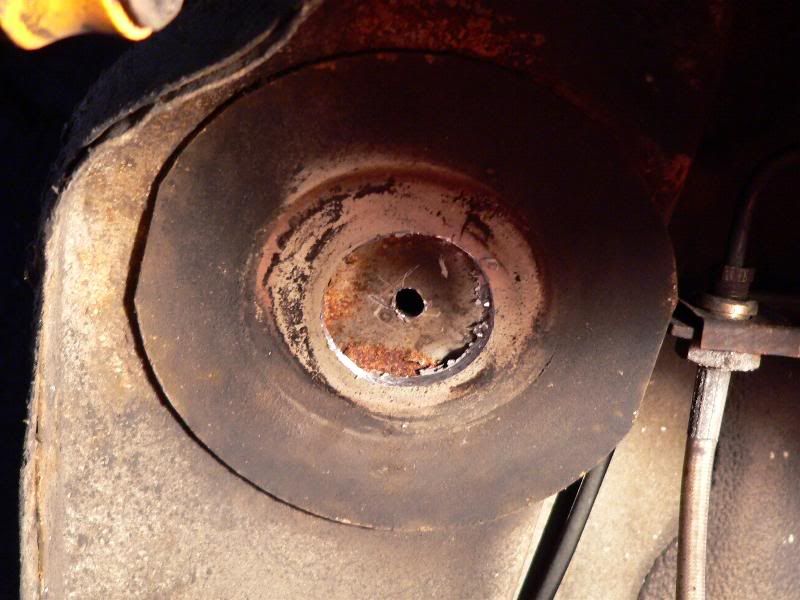

Then you will be left with this
http://i136.photobucket.com/albums/q...ure/nc0806.jpg
And this can be desposed off, unless you'd like to keep it of course
http://i136.photobucket.com/albums/q...ure/nc0807.jpg
Then zapp a flap disk over it to get the metal nice and shiney, so you can see your face it in
http://i136.photobucket.com/albums/q...ure/nc0808.jpg

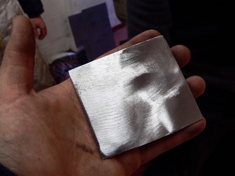

Then cut a 3.5" by 3" section of 2mm steel, which hits the circular part of the chassis perfect corner-to-corner, measured by Matt
http://i136.photobucket.com/albums/q...ure/nc0809.jpg

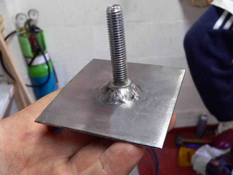

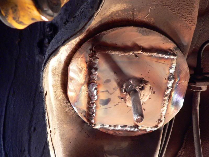

We decided to weld the M10x35 nut onto the steel plate as it'll be stronger, a better weld, and would be easier to weld to the car, so I did this
http://i136.photobucket.com/albums/q...ure/nc0810.jpg

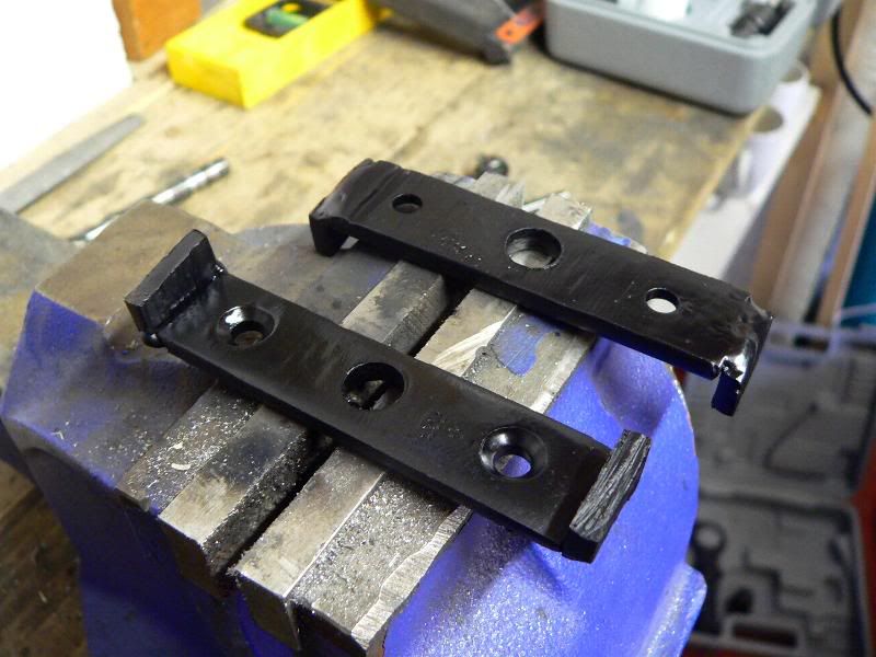

Better pic of the B&Q brackets that I put together
http://i136.photobucket.com/albums/q...ure/nc0824.jpg
And then along with the top rubber seat, this is how it will be seated
http://i136.photobucket.com/albums/q...ure/nc0811.jpg
Enter Rich... (not literally) after faffing about for hours trying to get my poxy welder to work, a call to Rich, 10 minutes later he arrived and did this for us
http://i136.photobucket.com/albums/q...ure/nc0812.jpg

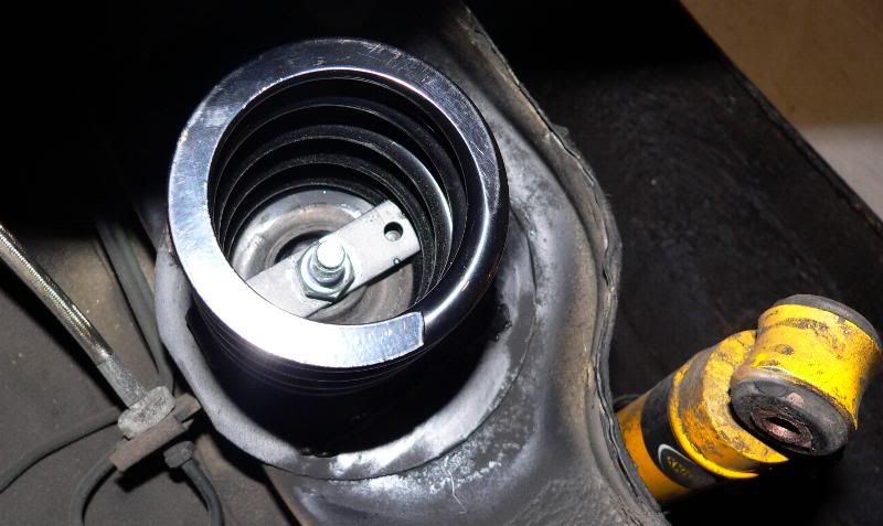

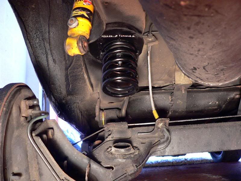

The add the rubber seat, then the spring, then the retainer, then the M10 nut with nylock, to get this - perfec'
http://i136.photobucket.com/albums/q...ure/nc0813.jpg
From below, be sure the spring is sitting central... tis!
