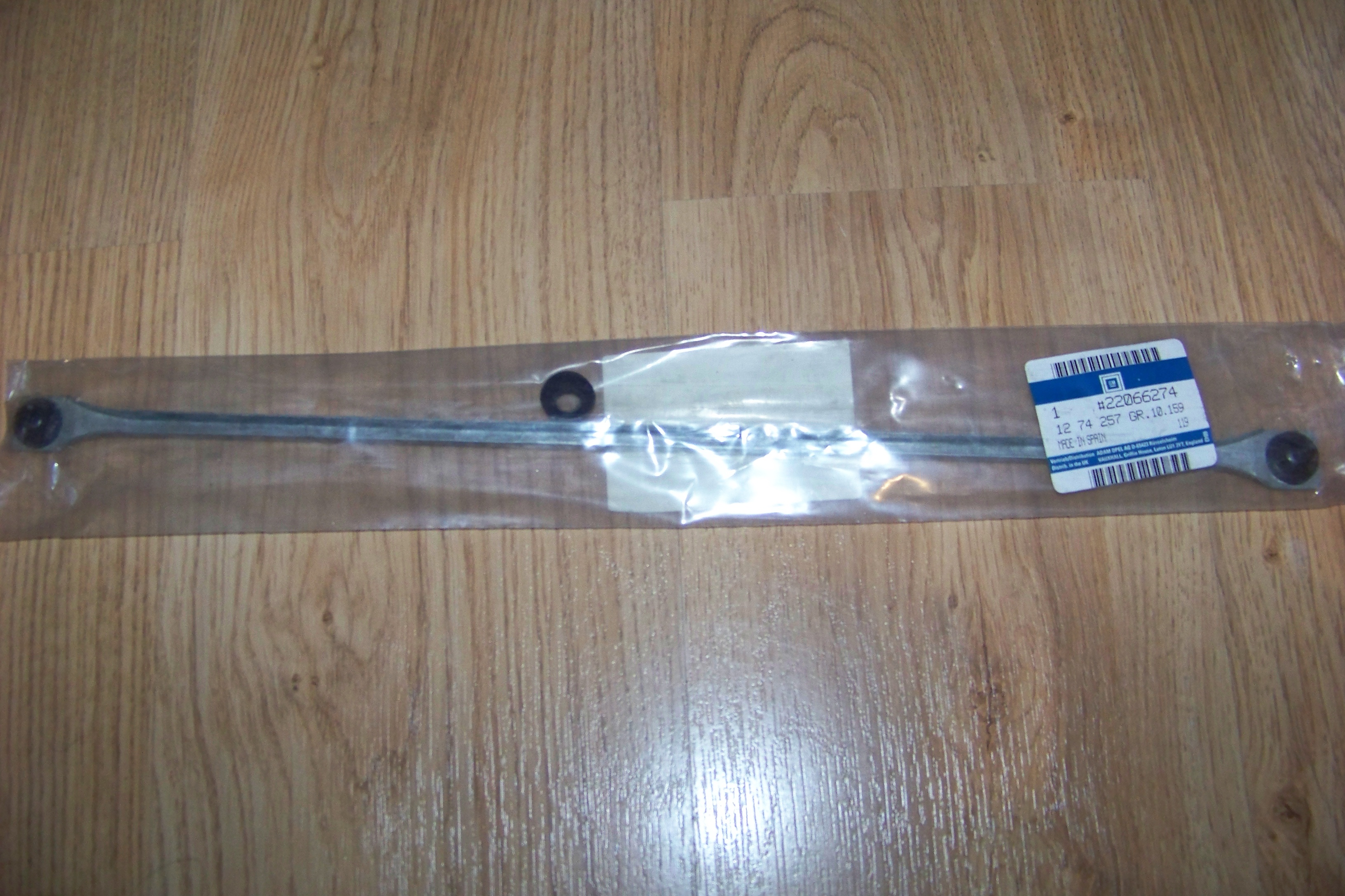

Long wiper linkage as mine was too worn to hold on to the ball joint
https://images2.imgbox.com/f9/8a/UTW009f2_o.jpg
http://img705.imageshack.us/img705/3131/1003192r.jpg

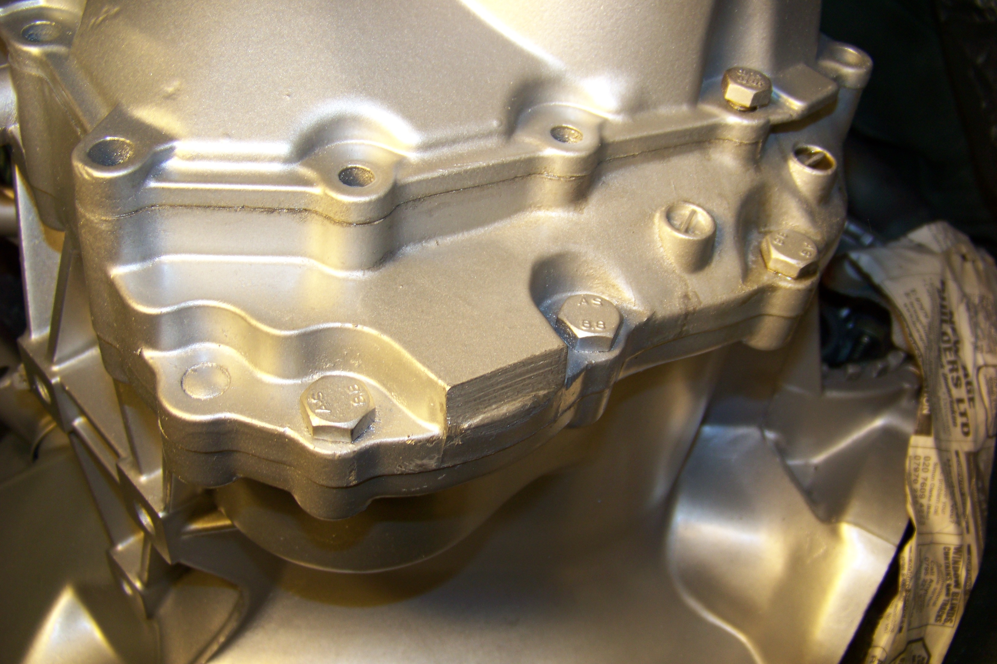

Sun came out so I jumped into the garage to get the gearbox gaskets on... started off with the cluster and forgot to take a picture. I then did the end plate gasket and made sure I took a picture :)
https://images2.imgbox.com/79/eb/0WsaB2RR_o.jpg
http://img826.imageshack.us/img826/7738/1003194o.jpg

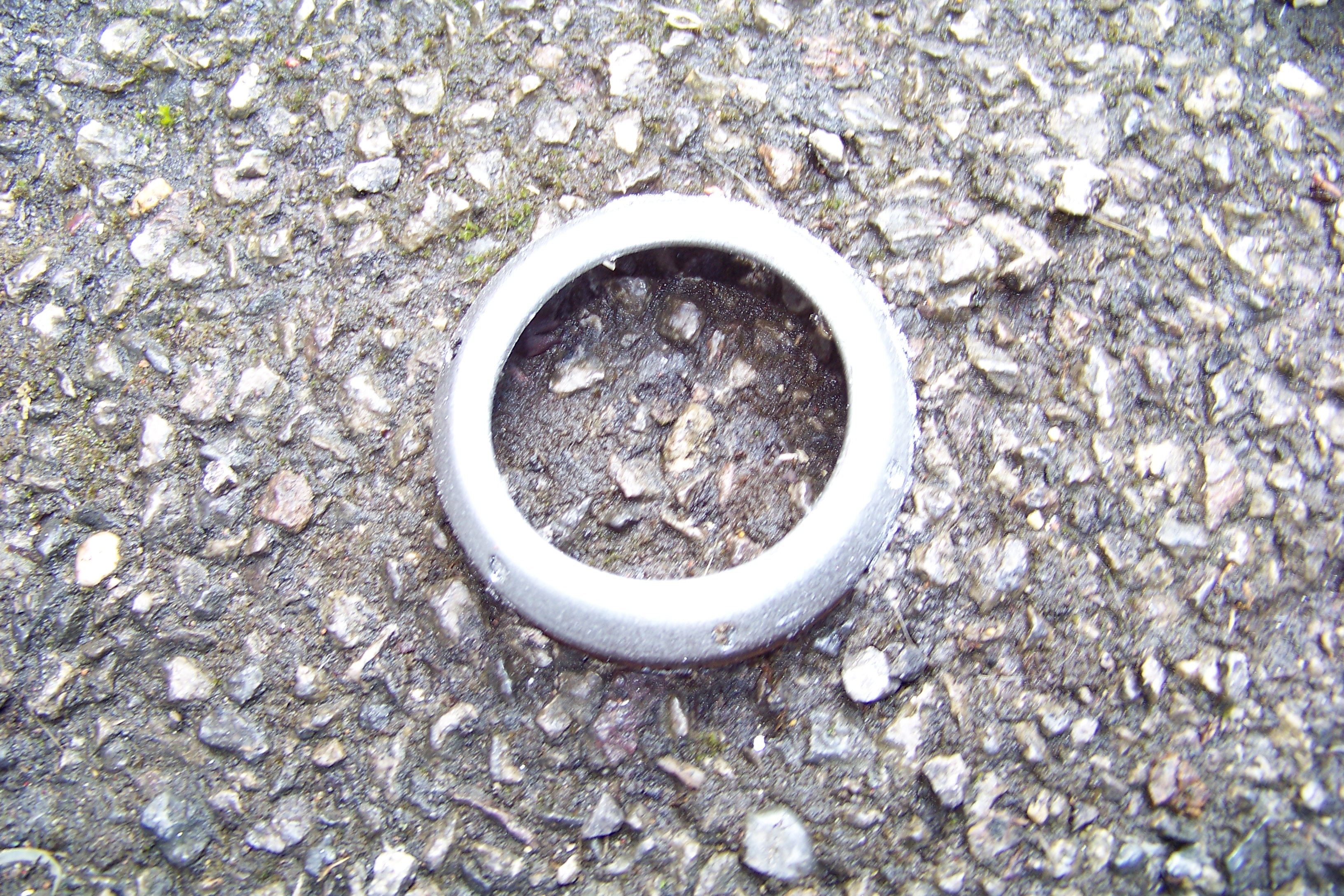

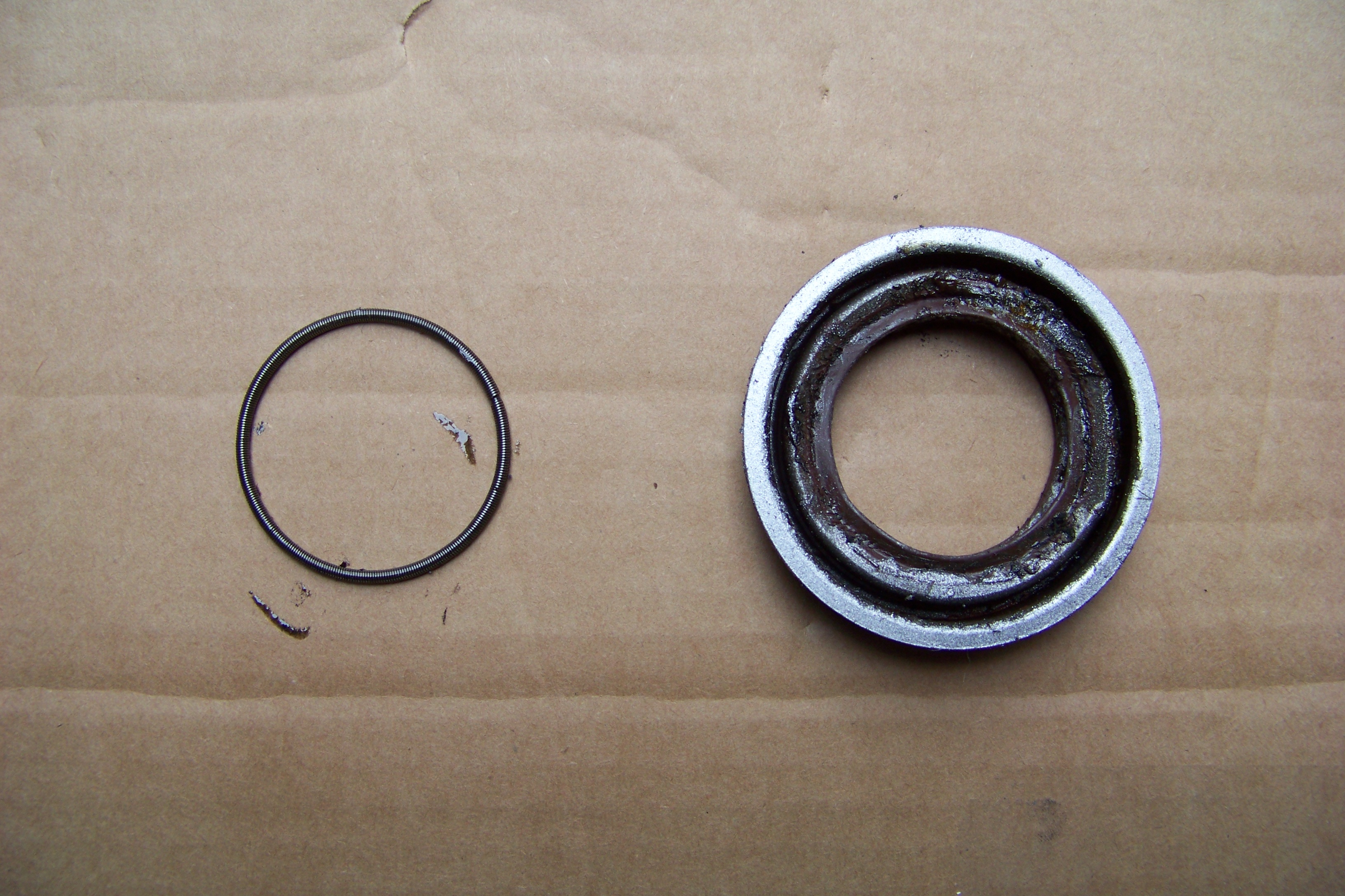

Wanted them to dry completely before I turned it upside down to do the diff cover... so I moved on to the seals. Thought I was on to a winner when trying to remove the o-ring seal but I only took of the metal ring :(
https://images2.imgbox.com/54/7d/D9bzslai_o.jpg
http://img19.imageshack.us/img19/7987/1003197k.jpg
Then came out the hammer. I tried to prise it out with the hammers forks underneath the seal with another hammer persuading it off. I felt it started to give but it didn't budge hmm.....

And one half chewed up seal
http://img607.imageshack.us/img607/6351/1003198r.jpg
https://images2.imgbox.com/d8/fc/yn486ULJ_o.jpg

Is there not a better way to take these out apart from butchering them?
I also realised that the oil filter pick up screw I got yesterday is not the right one... it is the correct one for the LET but won't work with my sandwich plate. It's too short for it to actually fix the sandwich plate to the pump and give enough thread for the filter to screw on to, but too long to use the sandwich plate's own extender pick up thread. I should've got a non-oil cooler pick up screw like off a SEH or XEV etc.
Shall have to order one.
I remove the shaft seals from behind with a punch and they come out fairly easily, although not overly useful unless you're willing to take them out/drop the diff out.
There's a spring behind the rubber part so make sure that hasn't fallen off into the gearbox casing during your butchering.
I had my mate change the diff recently, totally forgot to tell him to get the seals off ( I was at work so wasn't involved with it). I know that these seals no matter where they are, pretty much need to get ripped out for them to come off but this one didn't shift with all that force. May need to make up some sort of pulling device.

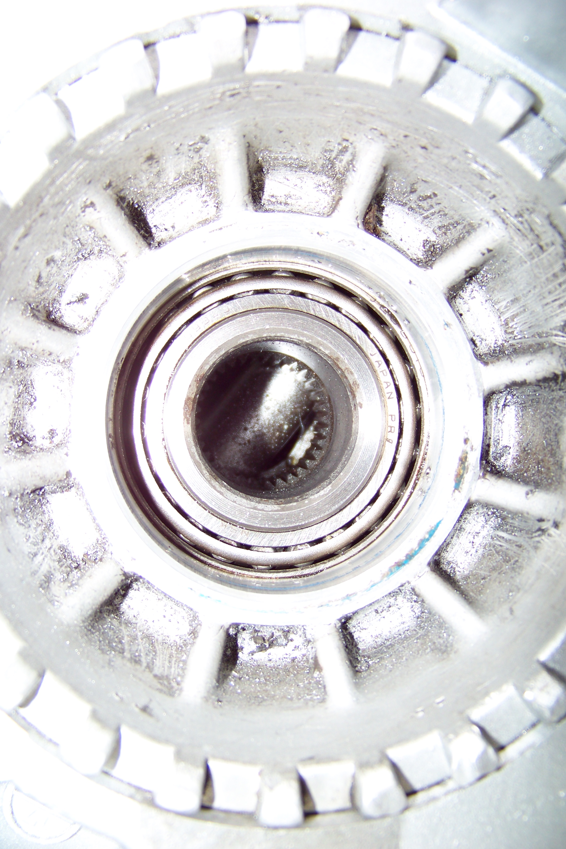

Cleaned up the area
https://images2.imgbox.com/28/b6/BBIAQMVz_o.jpg
and gave the bearings a good covering/packing of LM bearing grease.
The seals I took off had a bit of gasket type sealant around it so I did the same with the new ones. Took out my largest socket to 'persuade' the seal in and ended up butchering it
Got the other one out and tried to use a different tactic... nope still messed it up. Need a much bigger socket in order to uniformly apply pressure around the outer most edge and not the middle of the metal section of the outer part of the seal (which is what had bent while trying to fit it). So contacted the ebay seller that I got the seals off to see if I can buy some more.

That's the level plug, filler is the breather on the top. Never seen one with a magnet on before.. Wont really do much being up there either... Seals are a night mare too fit. I use a bit of 2.5" exhaust tubing to tap them home.
Make a scuttle cover, they are easy as.
I use a 30something mm socket to fit the seals,acting as a drift.
I also fill mine via the selector housing hole,much easier imo.
