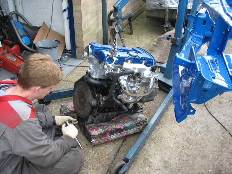

I started getting the clutch and flywheel off my old xe, and sorting any bits that are needed.
Got the lightend flywheel on,

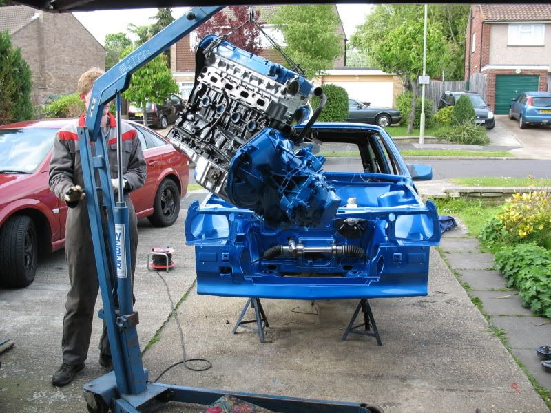

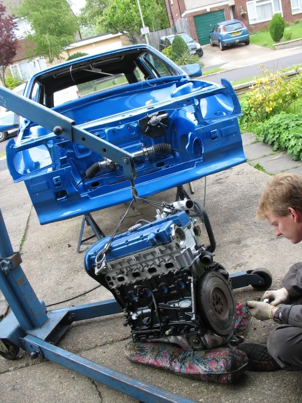

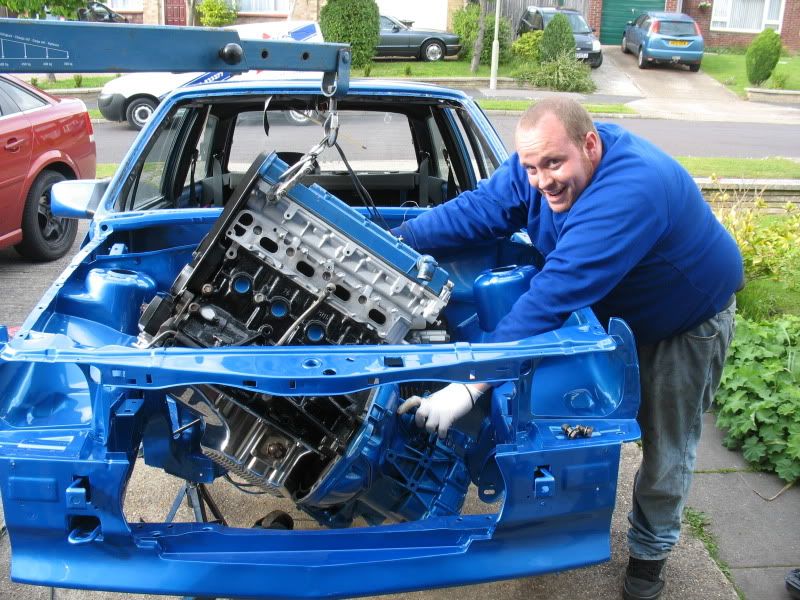

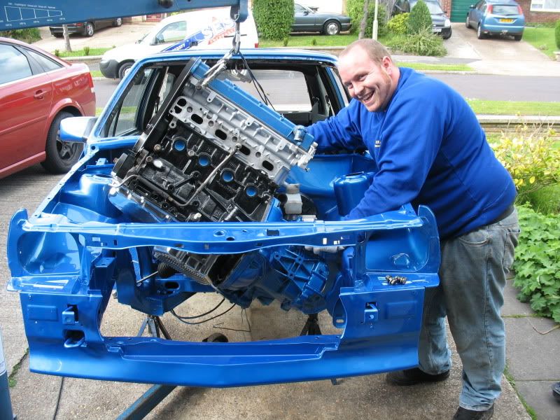

Gearbox on, with engine ready to fit in thru the top..
http://img.photobucket.com/albums/v3...tfitting11.jpg
Little angle needed..
http://img.photobucket.com/albums/v3...tfitting13.jpg

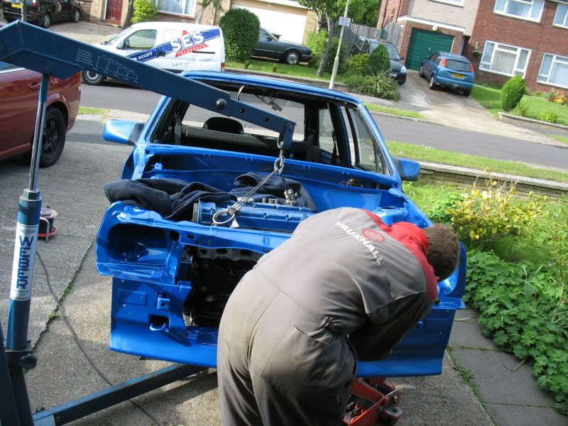

http://img.photobucket.com/albums/v3...tfitting17.jpg
Get ilined to bolt the mounts on,

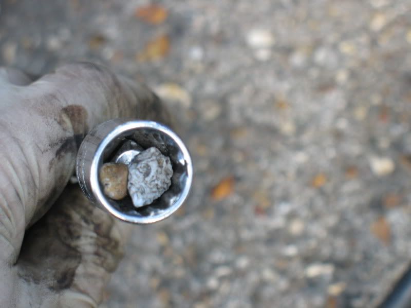

When you have probs getting the rear gearbox mount on, cause the bolts fall to far in the sockut... You find Jake Pebble and Robert Stone ...
They stoped the bolts sitting to far in to the socket.

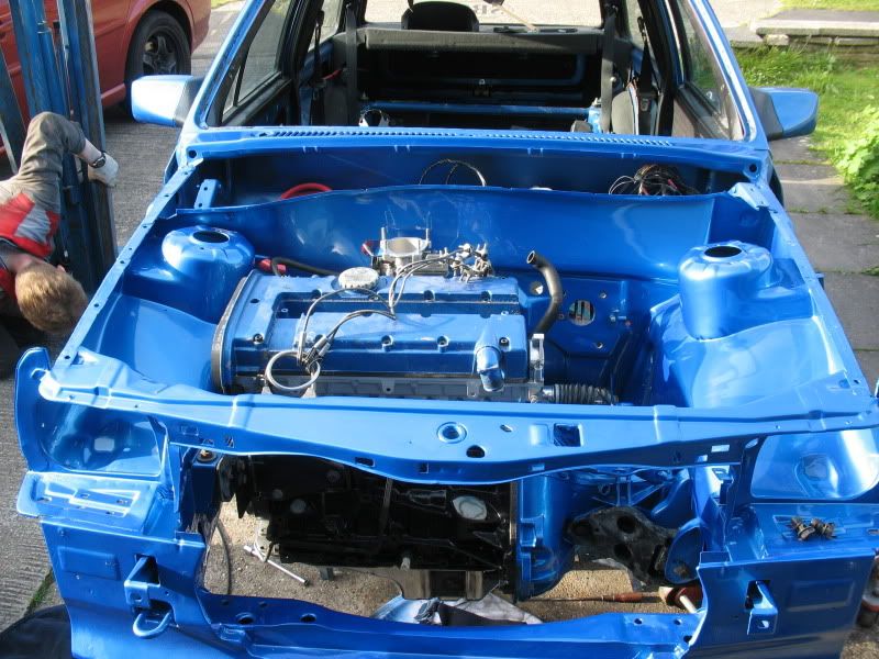

Bolded in.
http://img.photobucket.com/albums/v3...etfitting7.jpg
Dan's GTE kept a watchfull eye over us..
http://img.photobucket.com/albums/v3...tfitting15.jpg

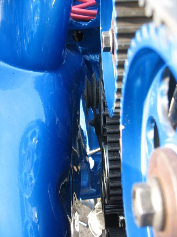

Lots of alt clearace.
http://img.photobucket.com/albums/v3...etfitting4.jpg
