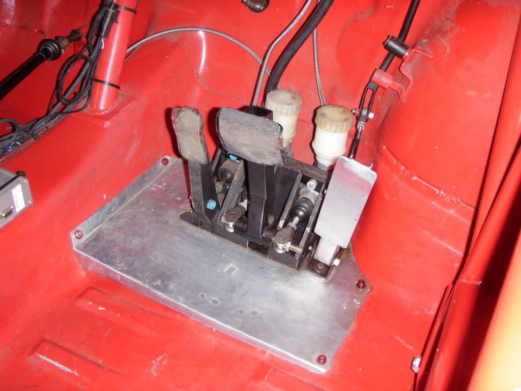

I've changed the brake reservoirs over from being remotely mounted (under the bonnet), to feeding directly into the master cylinders. This has saved the weight of the pipework and some unions, plus they hold less fluid, so there has been roughly a 350g saving. Not much but it all helps.

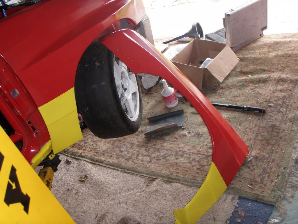

The wide arch front wings and kevlar door skin for the passenger side have been painted and fitted. The painting was done by me so it's rather amateur, but the long term plan as mentioned is to get the whole car stripped and painted anyway, so my dodgy rattle can painting has had to suffice for now.
I still have to fit the wide rear arches........I'm not looking forward to cutting out the metalwork and rivetting those on, it's got the potential to look rubbish as there will be no time for professional finishing of the job!

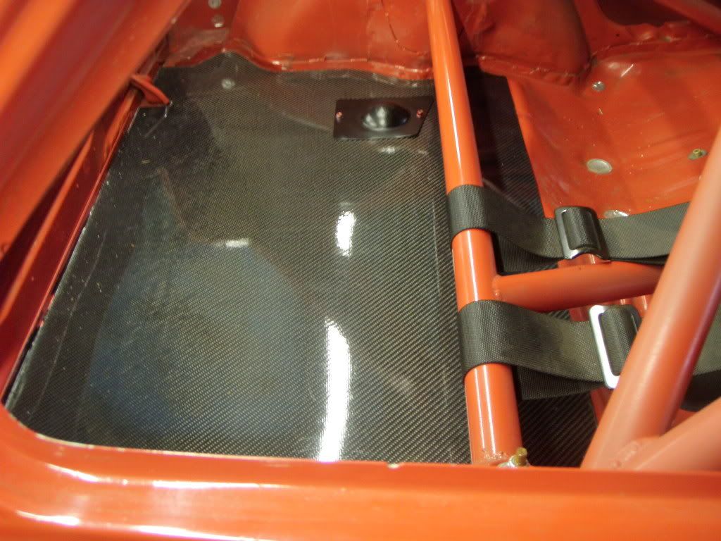

The new carbon fibre floor;
http://i285.photobucket.com/albums/l.../070411072.jpg
http://i285.photobucket.com/albums/l.../070411073.jpg
The direct mounted brake reservoirs;
http://i285.photobucket.com/albums/l.../070411074.jpg
http://i285.photobucket.com/albums/l.../070411091.jpg
I need to get hold of a matching AP master cylinder and reservoir to do the clutch circuit to match.
My efforts at painting the front wings. I will not be seeking a career in this field;
http://i285.photobucket.com/albums/l.../070411076.jpg

floor looks awesome
