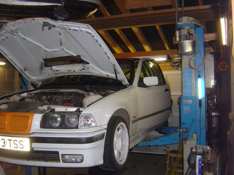

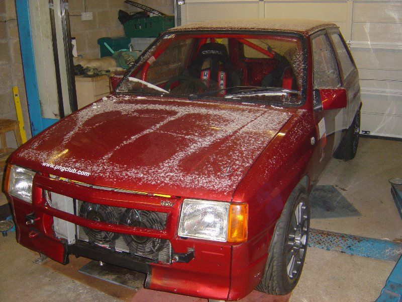

The Nova gets turfed out in to the cold again.
Another drift car has some work done.
http://img.photobucket.com/albums/v4...31_800x600.jpg
http://img.photobucket.com/albums/v4...30_800x600.jpg

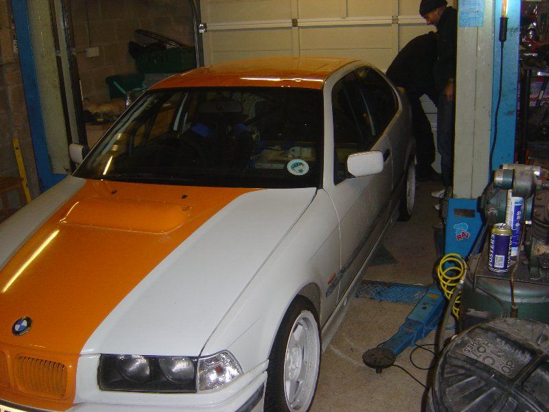

and the Nova comes back in from the cold
http://img.photobucket.com/albums/v4...32_800x600.jpg
