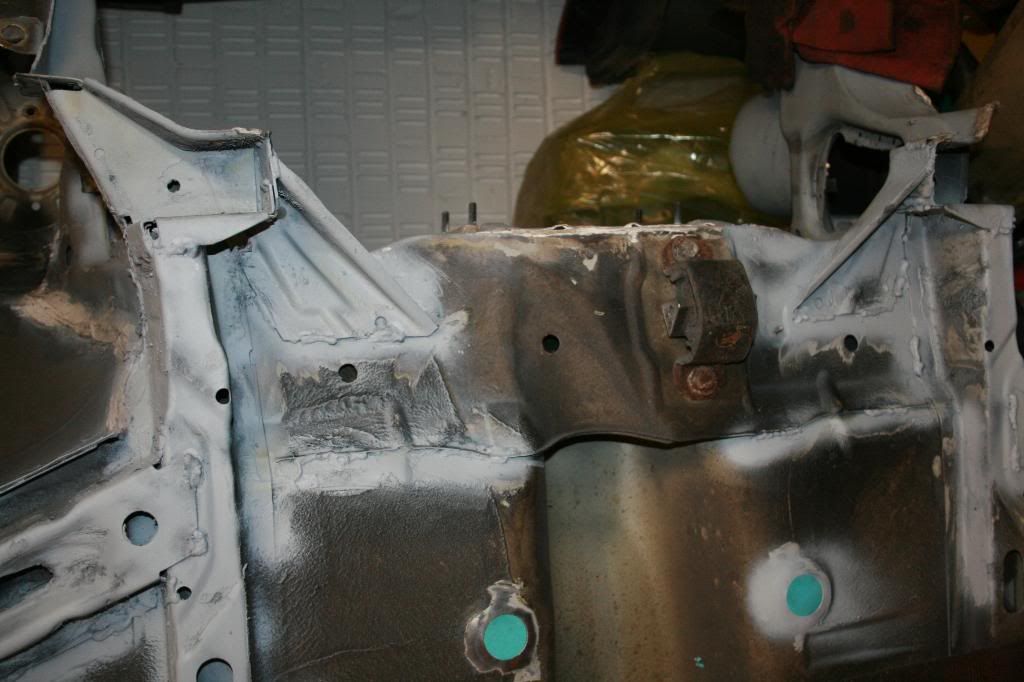

During the week before death a la food poisoning i finished off the stitching on the under side of the engine bay and gave it some primer
http://i248.photobucket.com/albums/g.../engbay268.jpg
http://i248.photobucket.com/albums/g.../engbay269.jpg

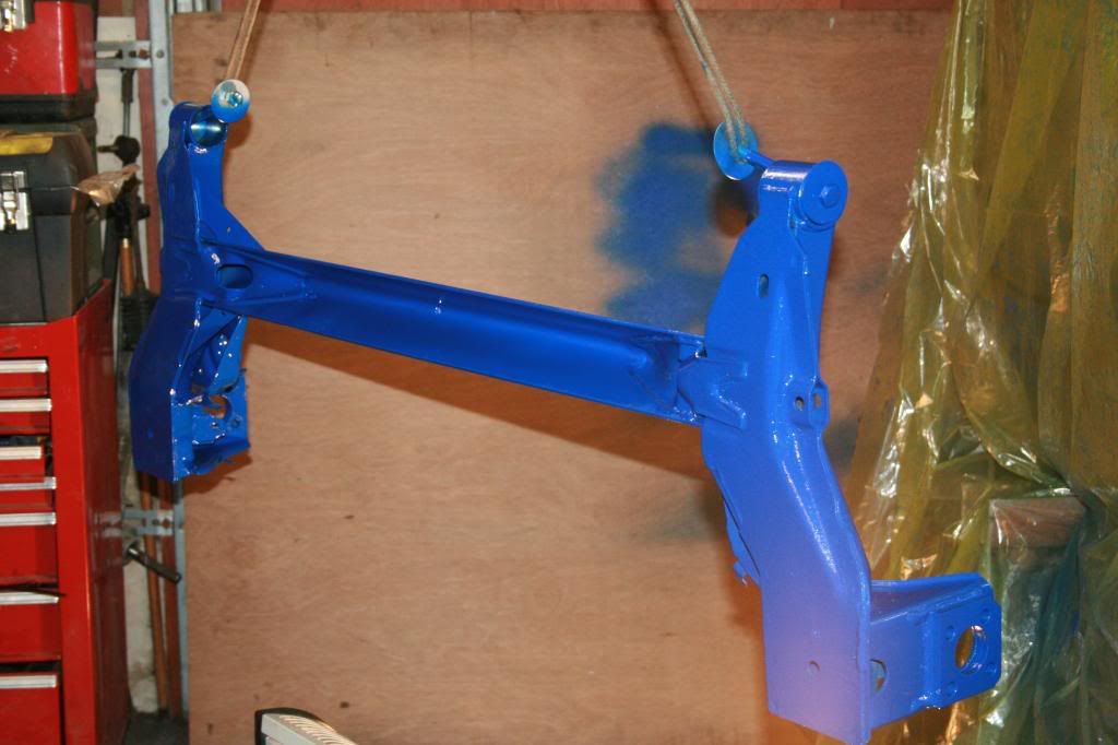

Then gave the rear beam a lick of paint...i like the blue
http://i248.photobucket.com/albums/g.../engbay270.jpg
http://i248.photobucket.com/albums/g.../engbay271.jpg

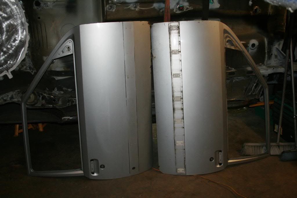

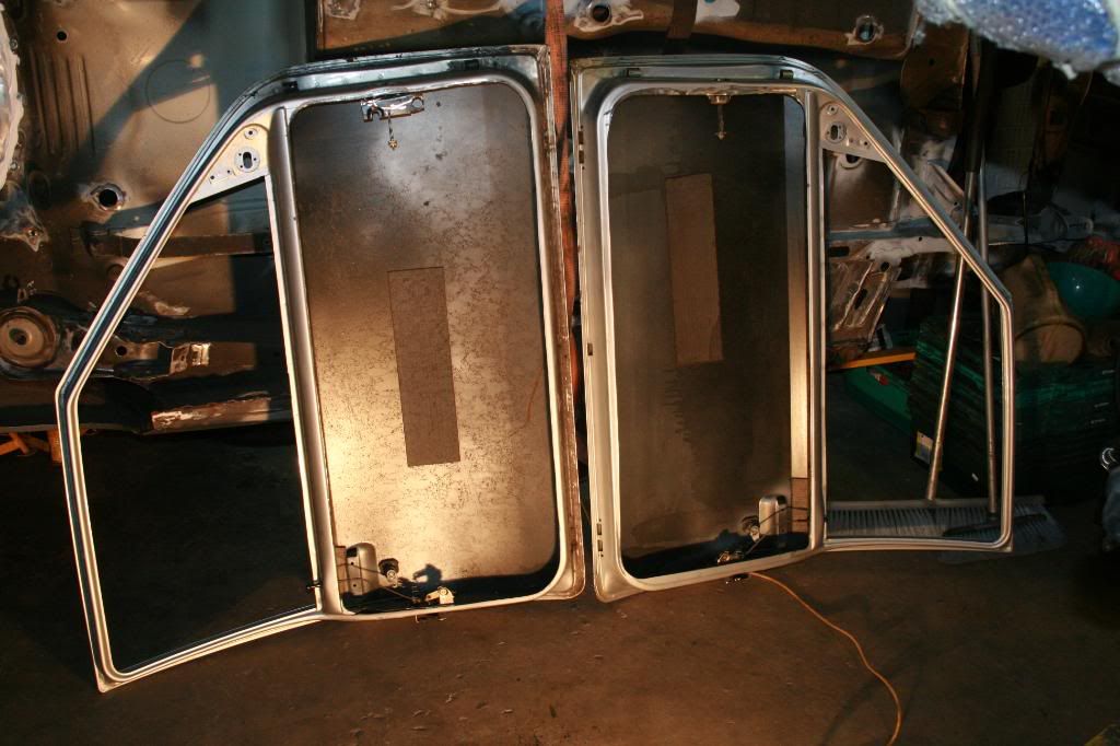

He did a super job of stripping then gutting the doors they went from around 22kgs as a whole door (without the card) down to 11kgs fully stripped and then down to 9kgs gutted (this is with out the plastic windows though) so a saving of 13kgs a side!!!
The doors as they started at 22kgs each
http://i136.photobucket.com/albums/q...ture/ncTC1.jpg

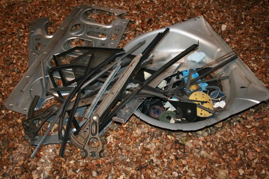

The strip begins
http://i136.photobucket.com/albums/q...ture/ncTC2.jpg
The left door at 9kgs and right door at 11kgs
http://i136.photobucket.com/albums/q...ture/ncTC3.jpg
HHHHMMMM sexy smoooooth
http://i136.photobucket.com/albums/q...ture/ncTC4.jpg
Top work fella, how'd you get the seams so clean before welding?
Hope you're feeling better dude. Good progress and neat job from Olly on the doors! Grinder and steady hand? or air nibbler?

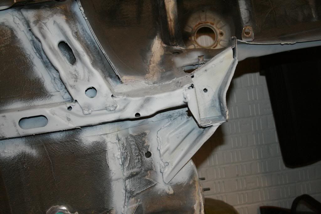

While Olly was getting on with the doors i started on the rest of the underside of the car cleaning the back end up (funking crust and under seal!!)
As it started
http://i136.photobucket.com/albums/q...ture/ncTC6.jpg
Rear chassis legs cleaned
http://i136.photobucket.com/albums/q...ture/ncTC7.jpg

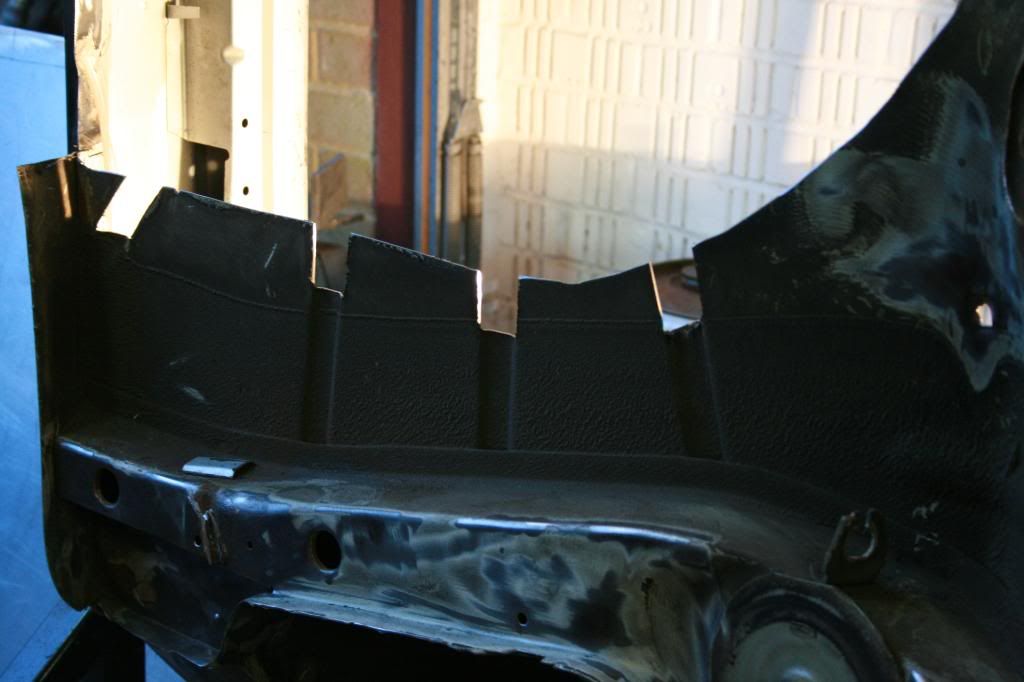

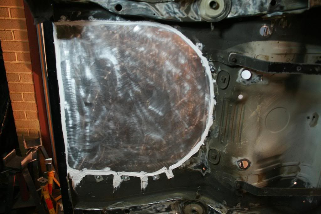

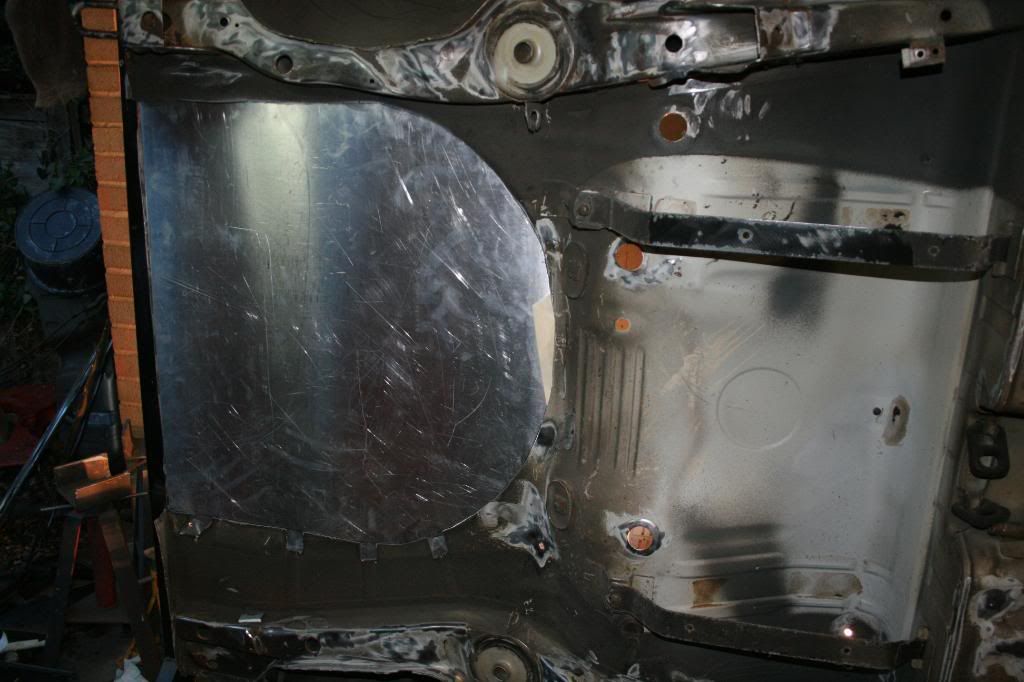

And on to the spare wheel well
The beginning
http://i136.photobucket.com/albums/q...ure/ncTC11.jpg
The middle
http://i136.photobucket.com/albums/q...ure/ncTC12.jpg
The end
http://i136.photobucket.com/albums/q...ure/ncTC13.jpg

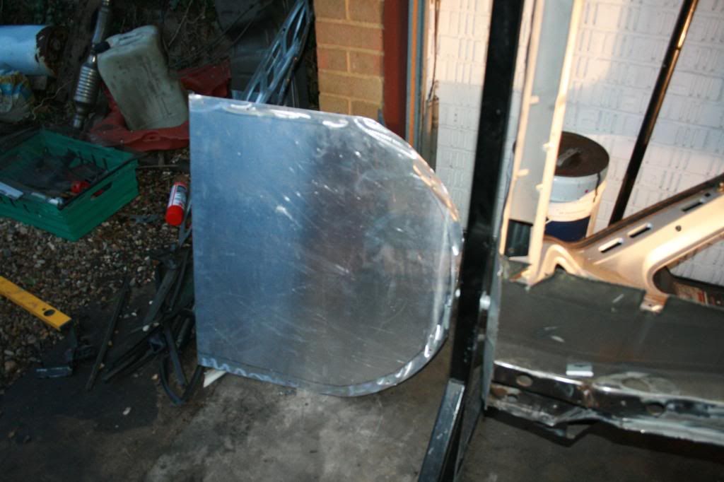

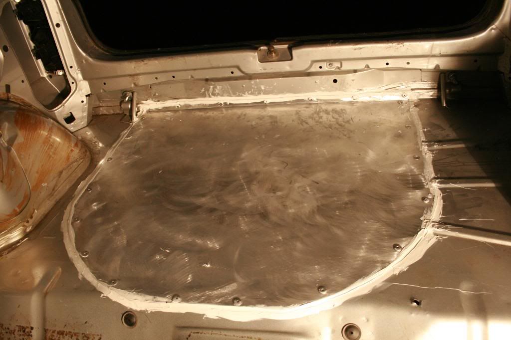

The wheel well weighed in at 4.8kgs and the ali at 2.6kgs so a saving of 2.2kgs and a flat floor for the centre exit and any splitter
type device i might wish to craft

I cut out the ribs so the ali would lay flat
http://i248.photobucket.com/albums/g.../engbay272.jpg
Shaped the panel
http://i248.photobucket.com/albums/g.../engbay278.jpg
And trial fitted it
http://i248.photobucket.com/albums/g.../engbay279.jpg
A few rivets and some sticky later and its home for good
http://i248.photobucket.com/albums/g.../engbay281.jpg

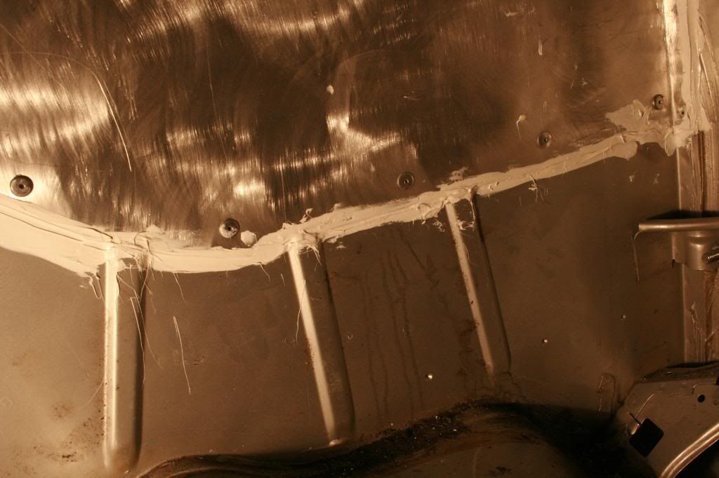

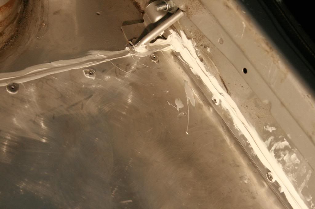

And the inside (it looks like a lepper did the sealer but bollox to it)
http://i248.photobucket.com/albums/g.../engbay287.jpg
http://i248.photobucket.com/albums/g.../engbay288.jpg
http://i248.photobucket.com/albums/g.../engbay289.jpg
The doors side by side
http://i248.photobucket.com/albums/g.../engbay294.jpg
http://i248.photobucket.com/albums/g.../engbay296.jpg
And the remains of the day lol
http://i248.photobucket.com/albums/g.../engbay293.jpg
Just a wire wheels on a grinder buddy!Quote:

really nice job on the wheel well, looks really neat and thought out.

It was a grinder and a steady hand btw :thumb:
JB i see what your saying and i could have got it pressed but didn't think DOH! if i experience buffeting or 'bong' in ollys words at high speed then i will add a brace but i plan to hang the exhaust in the centre so that should the panel from moving as much (aledergedly :confused:)Quote:

Wheel well plating is done very nicing, as are the doors, really nice and cleanly cut. Good work.

Absolutely love the doors for some reason! Stripped out to the max
