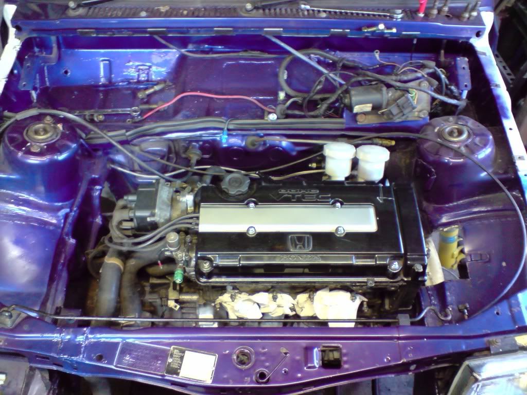

this is the first pic this is the engine being offered into place to decide how far to the passenger side it needed/could bo moved
http://i828.photobucket.com/albums/z...10809_1851.jpg

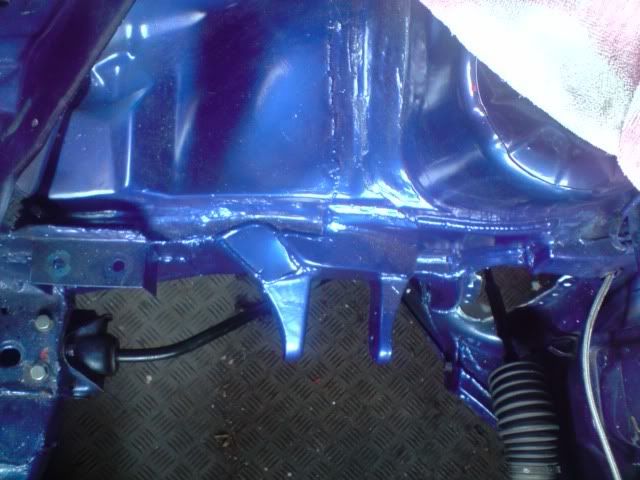

you will of course have noticed the hole in the inner wing this is where the new mount was to be welded in as below
http://i828.photobucket.com/albums/z...40310_1211.jpg

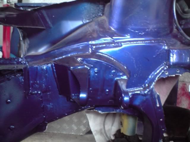

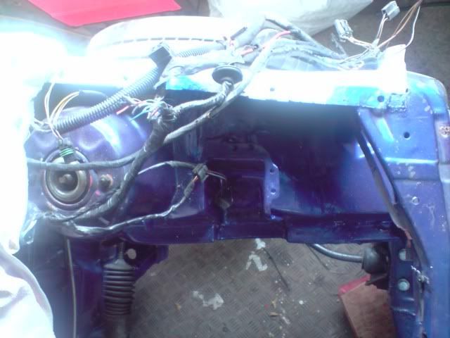

next we had to build up a mount on the drivers side inner wing which would hold the gearbox mount
http://i828.photobucket.com/albums/z...310_121101.jpg
http://i828.photobucket.com/albums/z...40310_1651.jpg

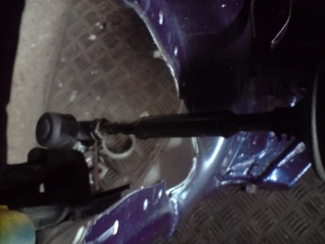

in the first pic you will see that there is no inlet on the engine and the clever among you will be thinking the bais peddle box would be in the way this was cured easily by using an interior floor mounted bais peddle box which also helps solve the hydraulic clutch problem
as to the extended lower arms and steering rack ends i mentioned earlier in the thread i cant find the pic of the lower arms but will take a new one when i get a min but heres one of the extended rack ends
http://i828.photobucket.com/albums/z...310_164902.jpg
it was simple to achive just cut the rack add a thread too both the cut ends then make a piece of steel with the same thread in either end but with a 25mm blank section between so that when screwed together again the rack ends would be 25mm longer i also welded them to be sure
