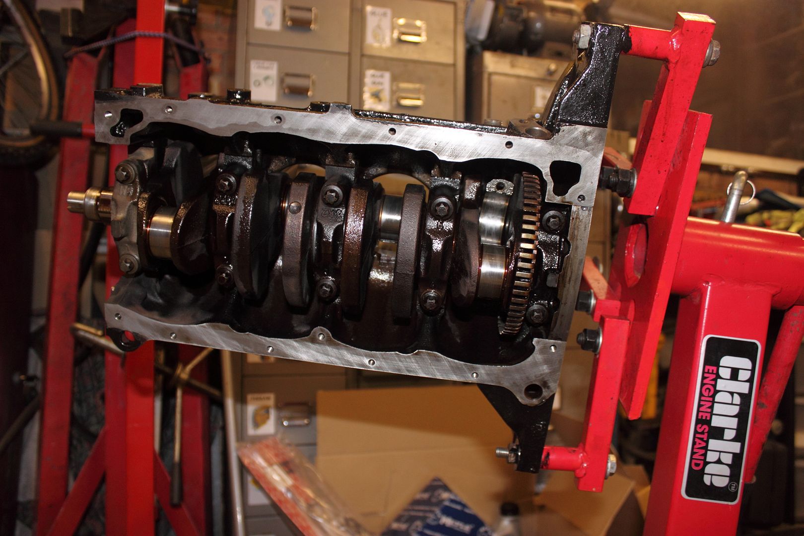

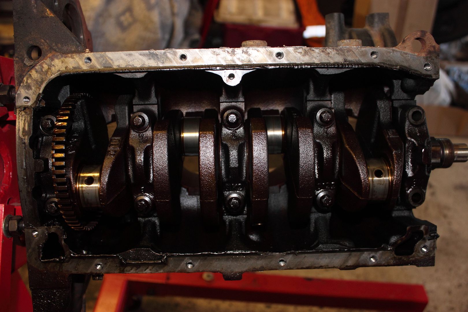

All the shells seem in good condition with minimal wear on the thrust bearing which sits under cap number 3 right in the middle of the engine ......

No major issues with the crank either....

Pics aren't working but glad your thrust faces are all good :)
Might just be the clean section but it looks like there might be a little wear on the thrust face of the crank? as long as there's no lip you can feel though, just double check the end float when it's all back together.

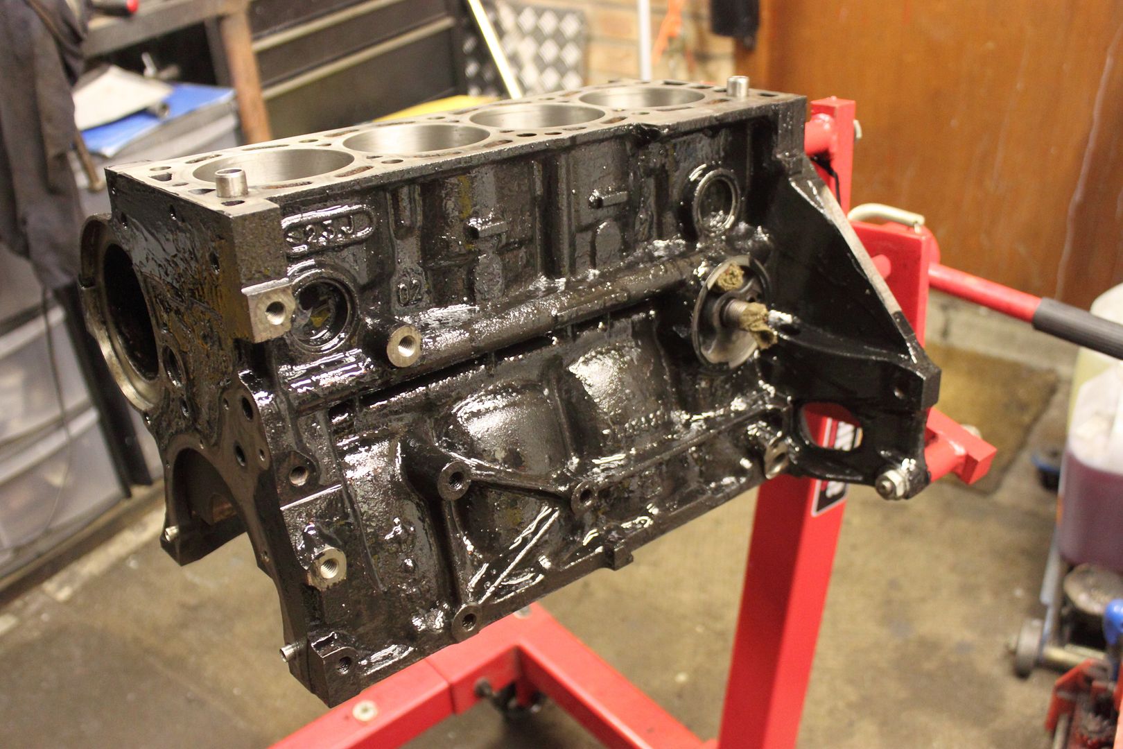

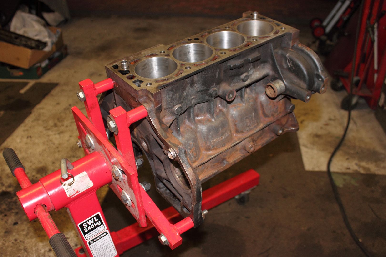

Got the block honed out nicely on Wednesday and then got it back home Thursday and put back on the stand with the engine hoist (very handy item to have!).
Next job was to clean down the block on both sides :-
http://i2.photobucket.com/albums/y15...a/Z18XE019.jpg
http://i2.photobucket.com/albums/y15...a/Z18XE020.jpg
And then give the block it's first coat of engine enamel paint :-

Tomorrow the block will get another coat of paint and whilst that's drying I hope to start stripping the head and getting the valves out . May give the ports a bit of a smooth with the die grinder whilst its bare as well !
