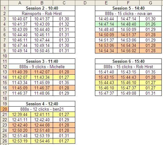

Went back out the hour later, 10:40am, this time with Rob Hirst as passenger, and it was a complete transformed car, the changes we made really brought out the rear spring poundage advantages, knocking around six seconds of our lap time, which was corking... still on the Rainsports at this point, however it was damp, but with a dry racing line - so I made the decision that for the next session to arm the car with 888s, however on the last but one lap, I noticed my oil pressure gauge had gone off the scale (full max, not full min) so not wanting to risk anything we came in, to find the wire to the sender had got caught and ripped in half, so replaced the wiring, and whilst the car was up - put the 888s on

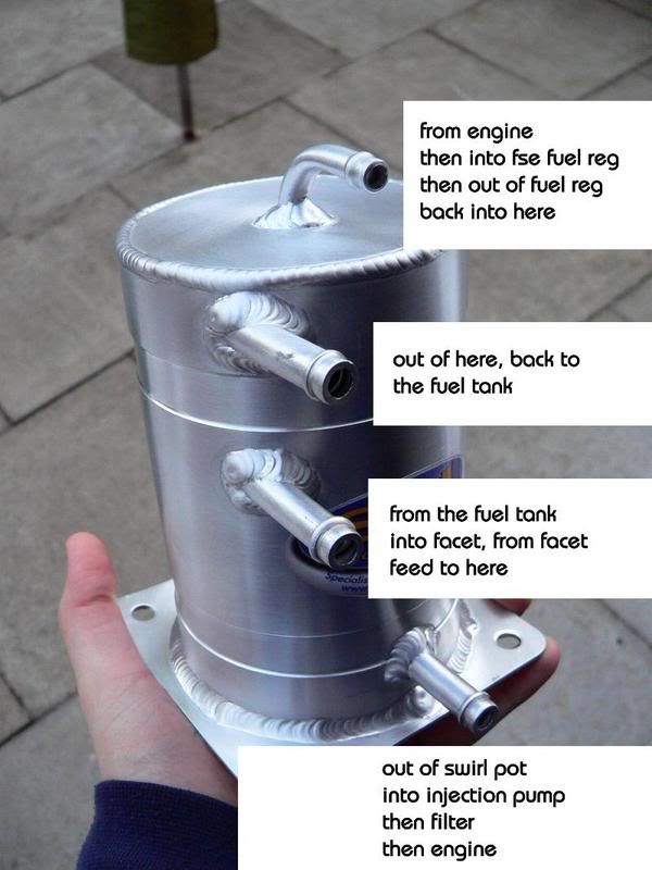

On the 11:40am session, I took out Michelle again, with exactly same setup as the previous session however with added 888s with tyre pressures of 23 (cold) at front, and 17 (cold) at rear, it was another blinding session - apart from when I started to get hesitation coming out of corners... again (previously at Donny I was getting this, pre-swirl pot), very odd, as my swirl pot is in place, it says I have half a tank left (i should have clicked at this point, that no way would I have got 3 sessions (read 1 hour at nigh 7k rpm) from 17quids worth of petrol) so we came in from that session early, and went across to the onsite petrol station that was selling Super for less than garages do @ £1.20 a litre... bargain... told him to fill up the tank, expecting to pay around £10-12, seeing as I had half a tank left... up up up it went... £36 please... ahhhh, so my gauge is reading dodgy, and I was out of fuel, hence the hesitation... so back to a full tank
Session before lunch, 12:40pm, ben21 was passenger, only slight adjustment that now the track was drying out, was to stiffen the suspension a little bit, was I was getting quite a bit of body roll, but not too much to hinder the traction, so I raised the clicks allround by 4, and a full tank of fuel... all hesitation gone - awesome lap...
1pm - 2pm - stopped for lunch, was absolutely knacked
Session after lunch, 2:40pm, nova ian as passenger, again, left the car untouched, but just upped the stiffness of the suspension again by 3 clicks allround, so rears were now on 15, and fronts on 16, I also upped the tyre pressures of the 888s as Mike had noticed how much they were rolling under the lip of the rim under hard cornering, so I did, and it made an improvement... less squealage, more speed
Session number 5, 3:40pm, again - left all suspension alone, however I felt the brakes had been taking a battering going from 130mph down to 30mph in the space of a hundred yards or so every lapBut again, towards the end of the session, again I was getting this hesitation again which was royally pishing me off because I know when my fuel tank is low, as my Facet becomes much noisier from not picking up fuel, thus not filling swirl pot - but this wasn't happening. Rather annoyed that every time we hit the craners, and redgate, and the chicane I wasn't getting full acceleration out of the corners... so we came in a lap or two early again... must be out of fuel again...
I only had 1 session after that left, I decided to give it a miss as I'd already had a fantastic day... what bothers me is... my fuel gauge has always read accurate, and I got home (40 miles) without a problem on the fuel that was left, and my facet is still quiet, which means its still pumping fuel from my tank, upto my swirl pot...
Oh well - any suggestions would be greatly appreciated... maybe my standard Nova GSi fuel pump can only take 4.5bar / 62psi for so long?
