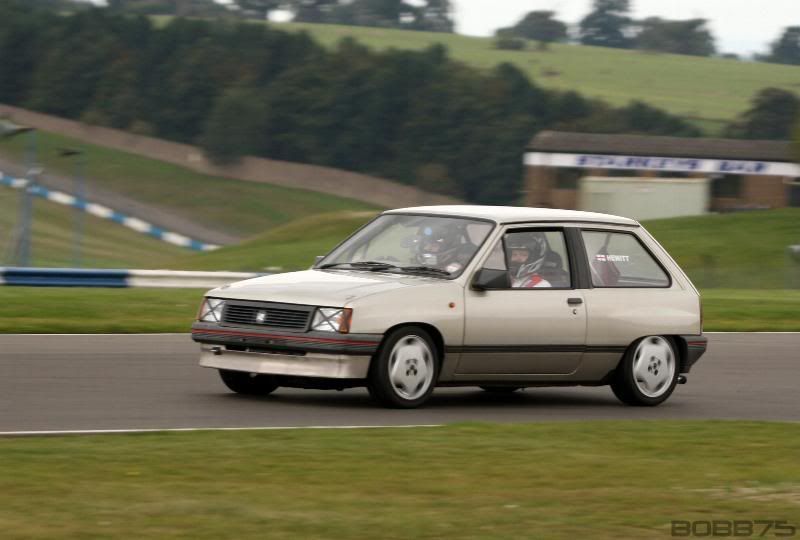

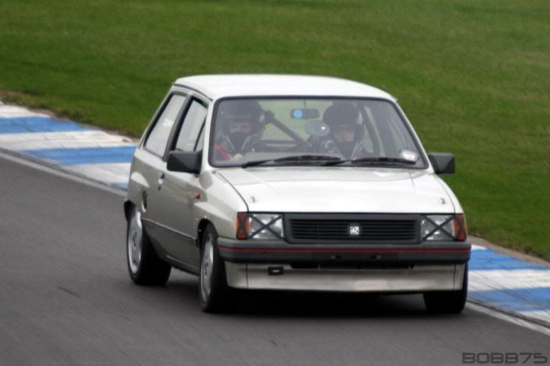

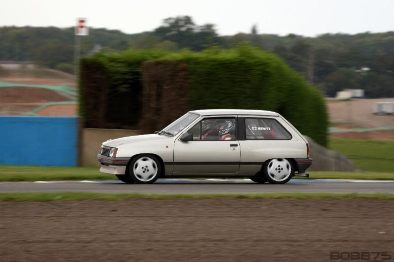

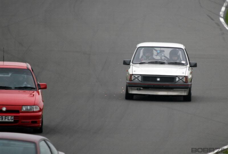

got lots of video footage - just getting it from camcorder now, here are some pics...
