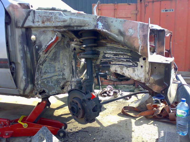

    Im doing a bareshell rebuild which will eventually house an XE. (I know its been done lots before, but always fancied building one!)

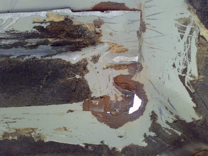

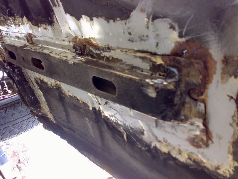

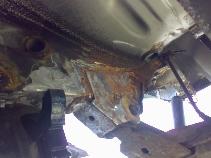

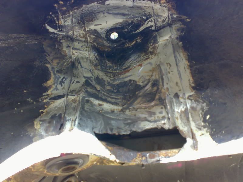

    So here goes!! The build began with this 1.2 Merit which I found in a local Scrapyard of all places! After having a nosey around I thought sod it I will take it as it wasnt in that bad condition, and it didnt have a sunroof. So I swapped another 1.2 nova I had which was a 110% rust bucket and a small amount of cash, and trailored away my new shell. The main areas that were bad and tin worm had set in were, the slam pannel and passenger side rear arch, The drivers side rear arch and boot floor were solid.
    Passenger Side rear arch, behind rub strip.
    So that is the base for my project.

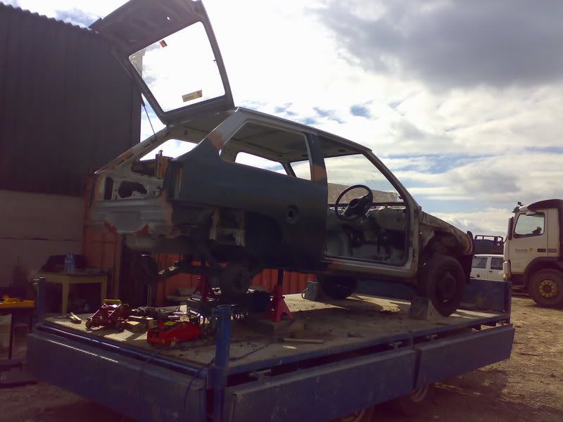

    Since then I have stripped it down to a bare rolling shell.

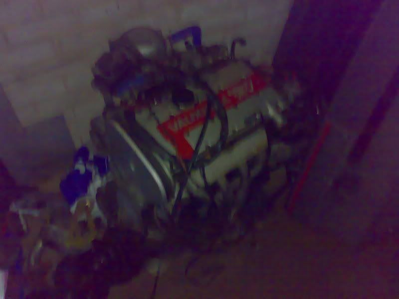

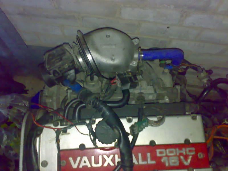

    Engine out
    Had to laugh, when you compare the 1.2 Lump with the jerry can behind!

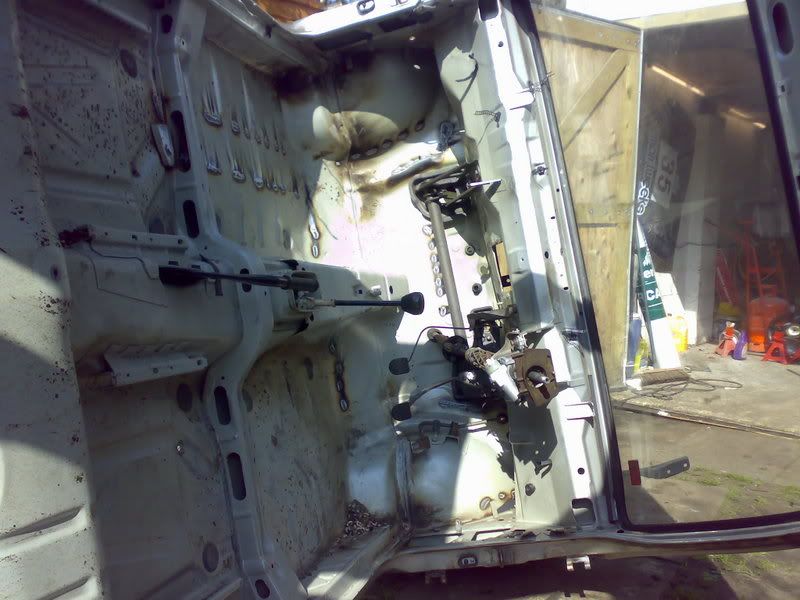

    Interior out, roof lining, interior pannels, Sound deadening removed, Dash out, and wiring loom labelled so i remember whats what! LOL

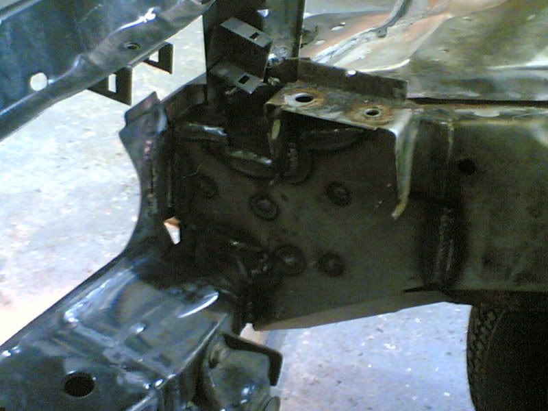

    Also I have had a new front crossmember and slam pannel.

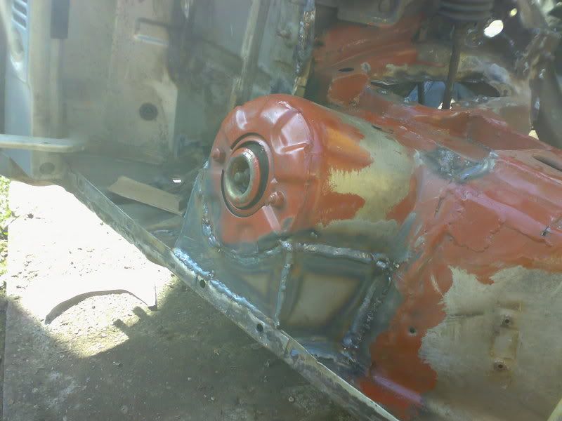

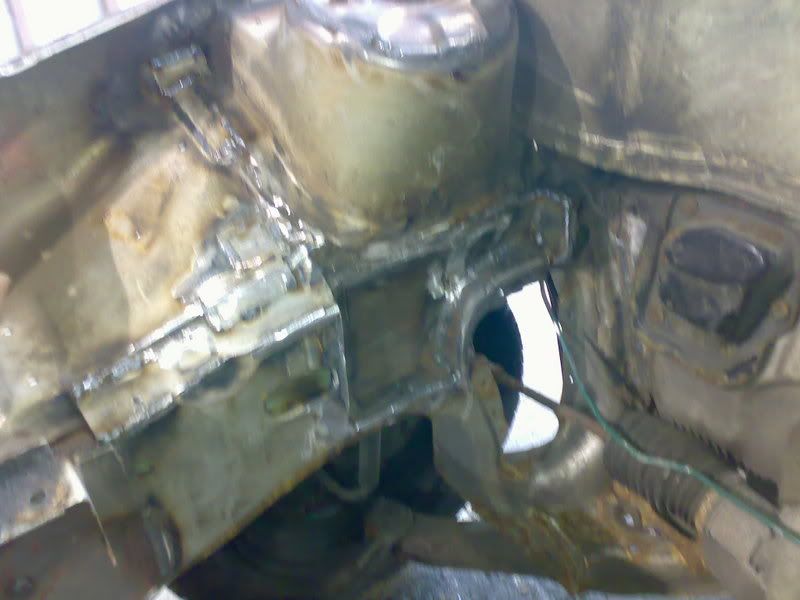

    I also had any other bits that were a bit worse for wear plated up, such as the inner wings
    http://img.photobucket.com/albums/v3...4102006012.jpg

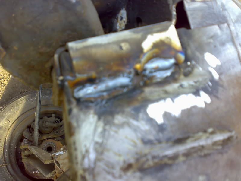

    and today I have took a few more pics, and done abit more work.
    The wiring loom has been removed.
    I also seam sealed the lips on the rear arches, which were rolled for me when the quartes were fitted. Also just gave a sweep out as there was loads of dust and bits everywhere.

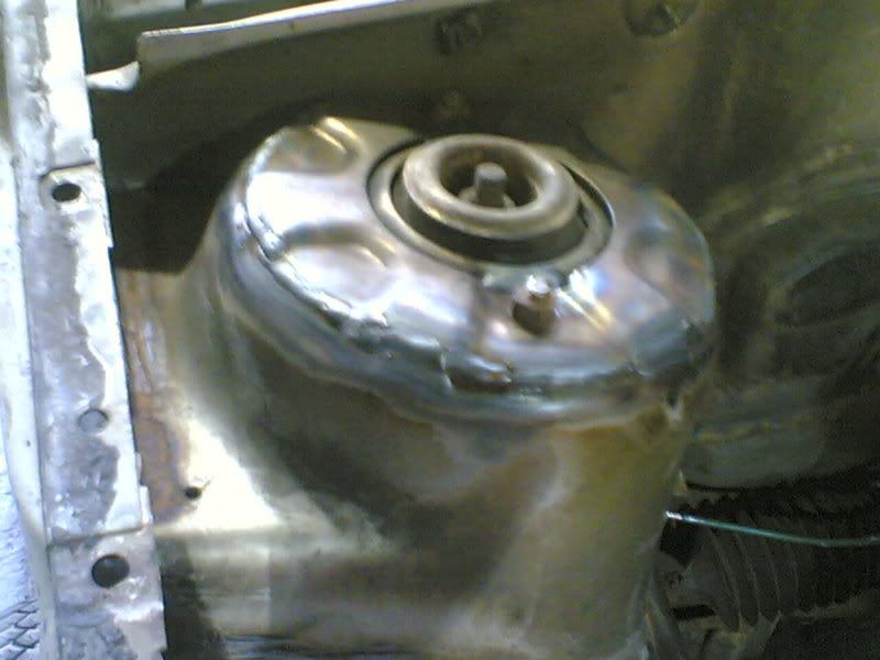

    Next on the list is to have my plating kit welded in, which I recieved the other day from Chris Astley Motorsport. And also sort the chasis leg for alternator clearance, aswell as move the drivers side front engine mount down a bit lower.
