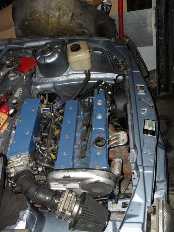

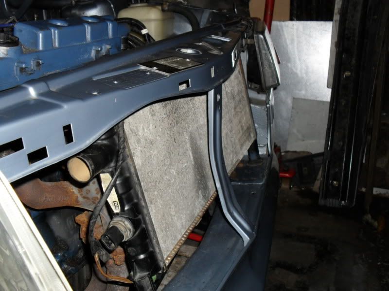

    past few days have been spent doing little niggly crappy jobs to allow me to do bigger jobs

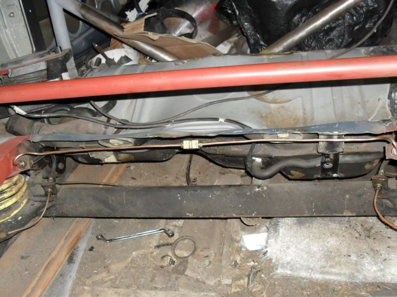

    radiator in
    engine bay looking more complete although rather dirty, that can be done whilst waiting in the cue though
    rear brake lines done
    boot floor and rear panel cut out

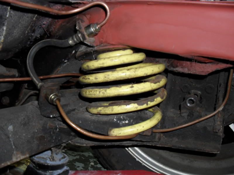

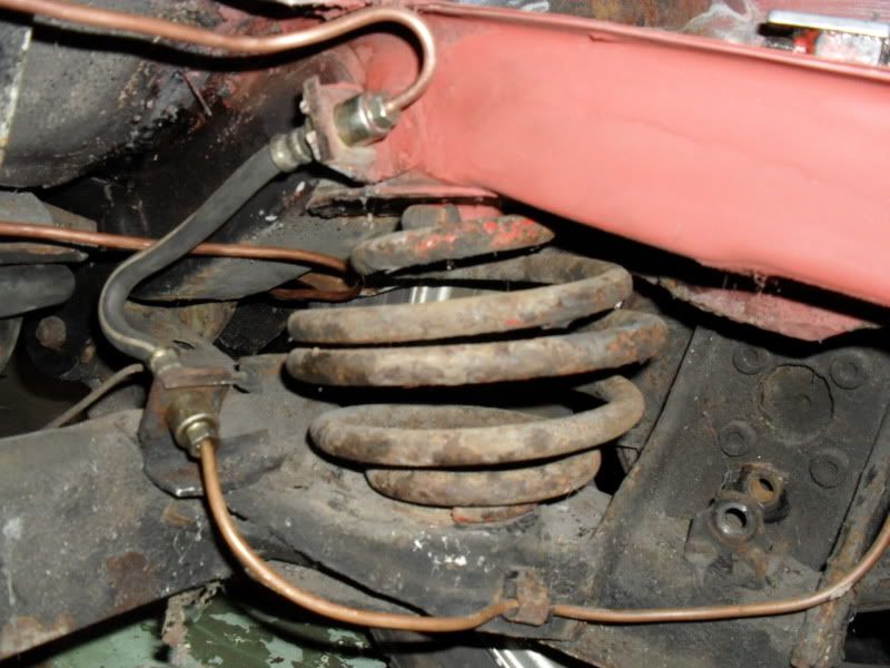

    trying to work out where the springs need chopping and then re-'pigtailing', sitting like this they still need to go down another 30mm for the car to sit level
    for reference these are old saggy 60mm springs

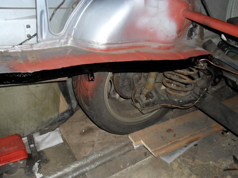

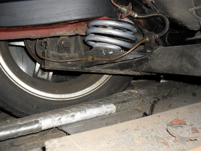

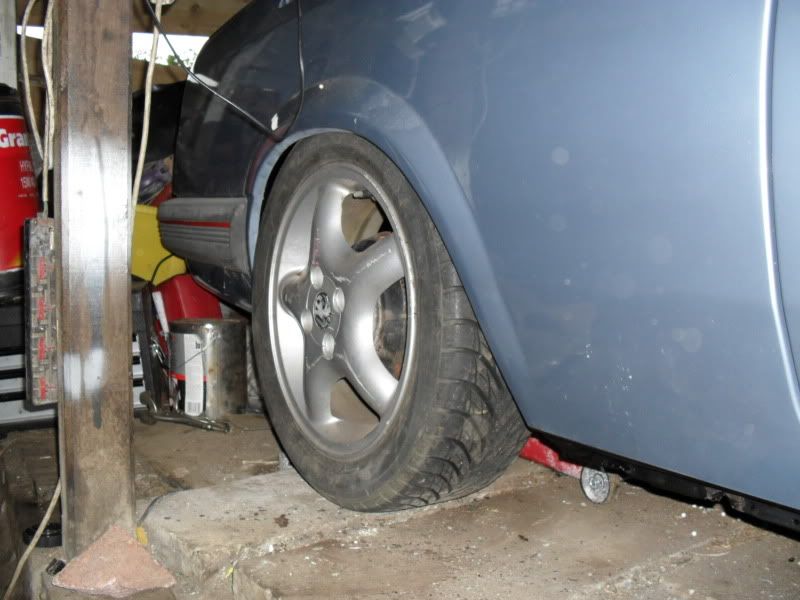

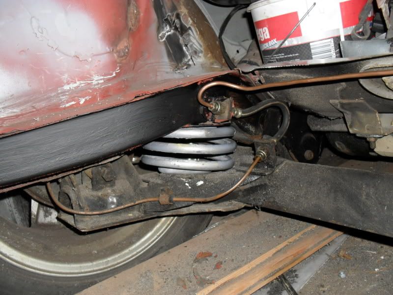

    well me brother has finished making me springs for me, they fit a treat and sit the car level now
    they are only 3 inchs tall
    this has it sitting here
    and still got loads of suspension travel
    plenty of clearence on the handbrake guide
    angle of the beam is errr interesting

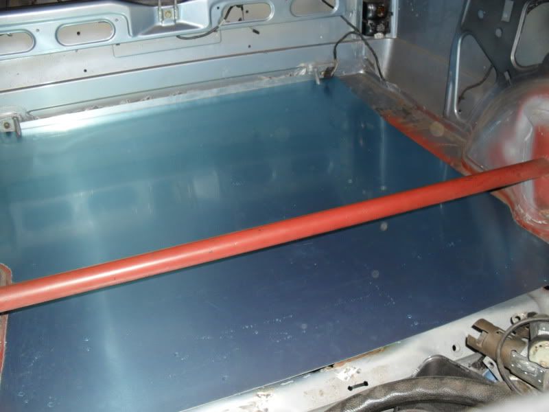

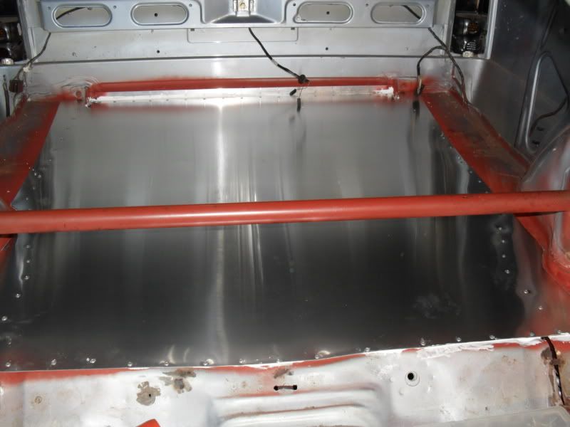

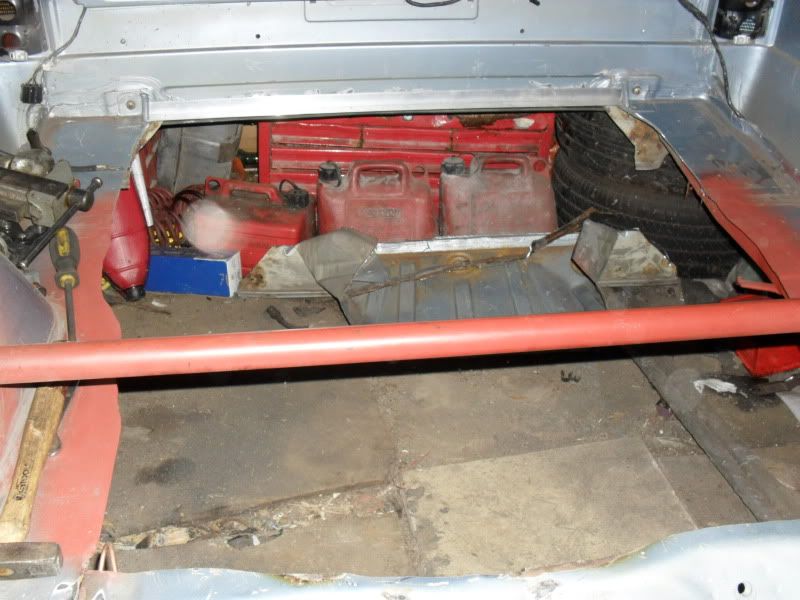

    with that sorted i started on the boot floor
    cut to fit

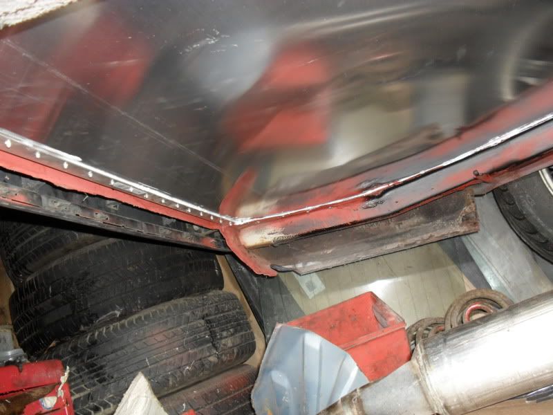

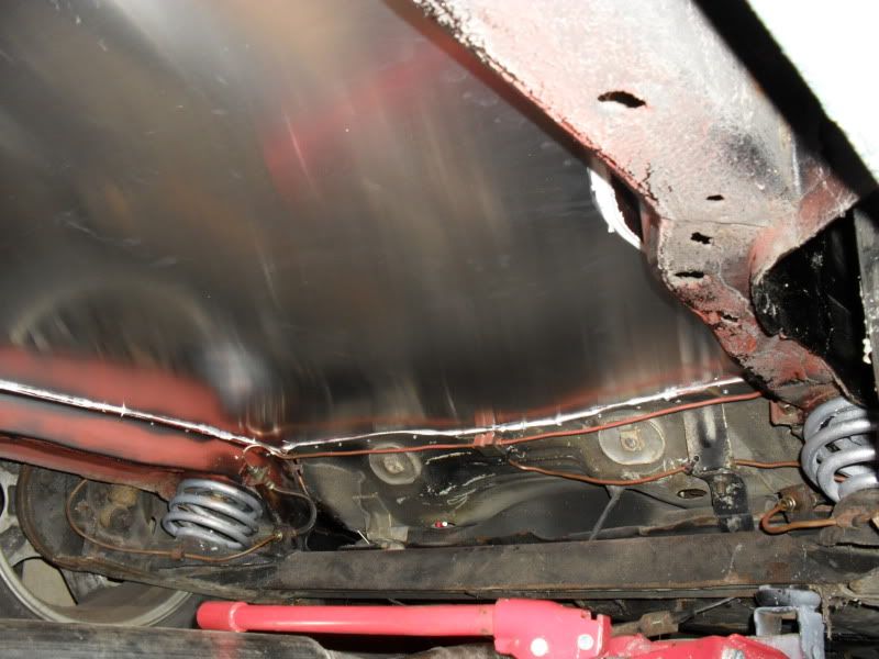

    i then put a bead of sealer all the way round and placed the panel in, then rivited at every 2 inches
    and underneath
    because of the natural bend of the floor it is actually very rigid and doesnt need any more bracing. to say im chuffed with it is an understatement and the huge space under there now is begging for a proper diffuser

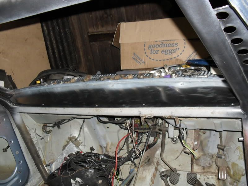

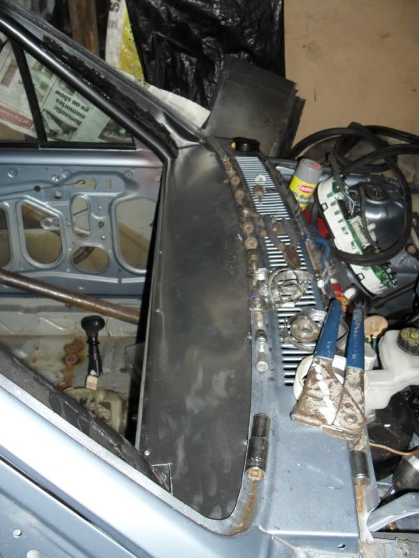

    with the success of the floor i moved onto the dash panel

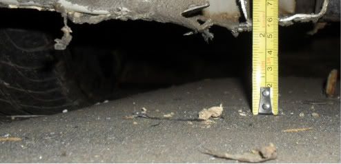

    it turns out when your sills are 100mm off the floor your gearbox rear mount and front chassis rails are only 50mm off the floor :s which means when i go down to the 14's ill only be 20-25mm from bottoming out!! far from ideal so gonna have to get my brain in gear and do some re-engineering
    proof of lowness
