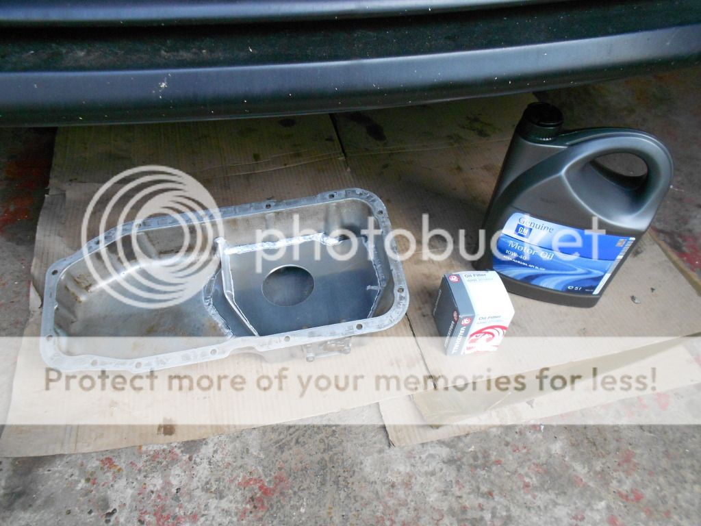

My sump was baffled when it suffered from oil starvation ,its the long sweeping bends that are the killers

Will look at baffled sumps, probably a good idea, cheers guys.
I would look into an Accusump aswell to be on the safe side

Maybe keep a beadie eye out on the competition/race/rally scene/forums etc for used competition wet and dry sump set ups - the c20xe is a lot more popular that most vauxhall engines; stand a better chance of finding something suitable.
I seem to remember finding some interesting stuff on westfield/caterham sites? (though that might have been more to so with finding rwd sumps to fit c20xe's)

If you want the details of a friend of mine he will be more than happy to tig a baffle into your sump.
Think he charges £50, I have one of his on mine.
