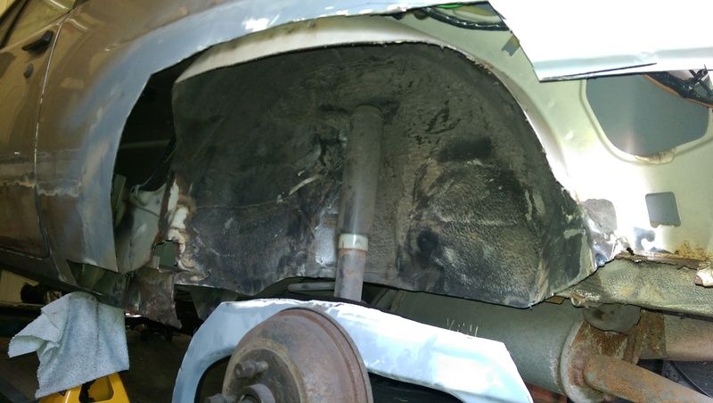

[IMG]http://i5.photobucket.com/albums/y15...9.jpg~original[/IMG]
Inner arch finally finished, etch primed and seem sealed and then painted over although you cant see that in the pic because i forgot. Not the best looking repair but it wont be seen so i can live with the fact its strong and done properly.
This was a real mess and was rusted quite badly after i cut all the rust out it looked like this so i'm glad its finally done

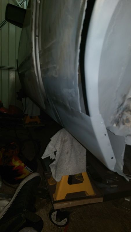

[IMG]http://i5.photobucket.com/albums/y15...1.jpg~original[/IMG]
ive welded in the outer arch but its nowhere near finished yet so i'll leave it there

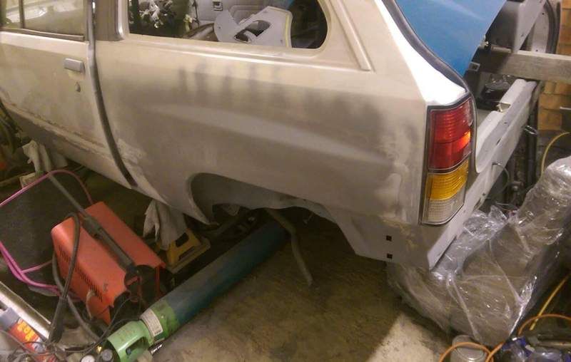

[IMG]http://i5.photobucket.com/albums/y15....jpeg~original[/IMG]
First time I've ever done anything like this, its not finished just yet as far as the bodywork goes as I don't want to fill my garage with filler dust until I can do the whole car. I feel like ill be able to do the metalwork on other side no problem at all now and probably half the time.
That looks really well done mate, come a long way from when I saw it. Just ordered the rebuild bits for mine today so hopefully I'll can get started on it
done a good job on that rear wing, looks tidy :thumb:
Looks like a good job. Well done.
Cheers guys, just sitting here now thinking what to do next, offside rear arch or engine bay. Decisions decisions
