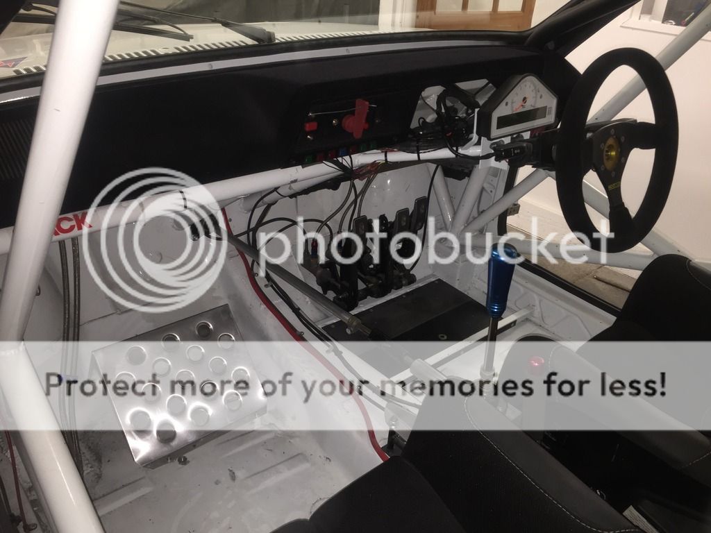

A little more work today, but not a lot. Just re-fitting the dash and making some changes to the wiring. It will stay as it is for now, but after a bit of racing a full loom will be made to do away with anything not required.
http://i995.photobucket.com/albums/a...squfw2c5o.jpeg
http://i995.photobucket.com/albums/a...sljqw4aom.jpeg
Tidy, but will look more professional with anodised pieces matching (black tbh).
