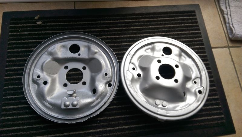

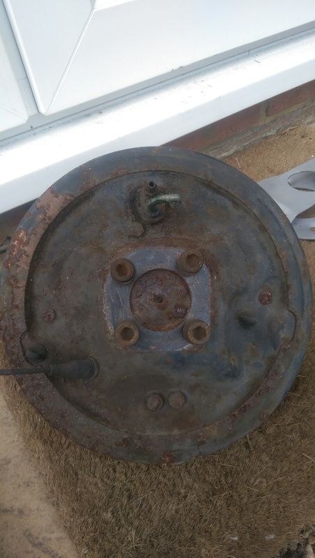

got the sandblaster out and gave the drum back plates a good seeing to, they had seen better days
[IMG]http://i5.photobucket.com/albums/y15...4.jpg~original[/IMG]
After the blasting I etched primed and then gave them a couple of coats of paint
[IMG]http://i5.photobucket.com/albums/y15...7.jpg~original[/IMG]
very pleased with how these came out.

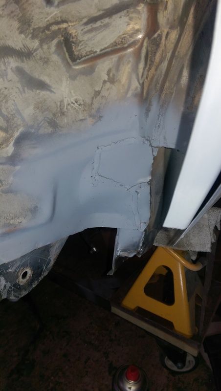

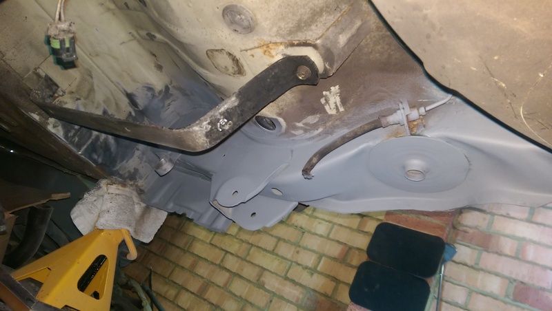

I also made a start on the inner arch
[IMGhttp://i5.photobucket.com/albums/y15....jpeg~original[/IMG]

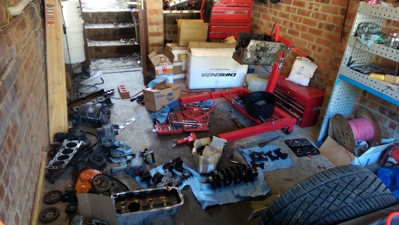

Few bits done to the nova, the engine is currently being rebuilt at my mates
[IMG]http://i5.photobucket.com/albums/y15...3.jpg~original[/IMG]

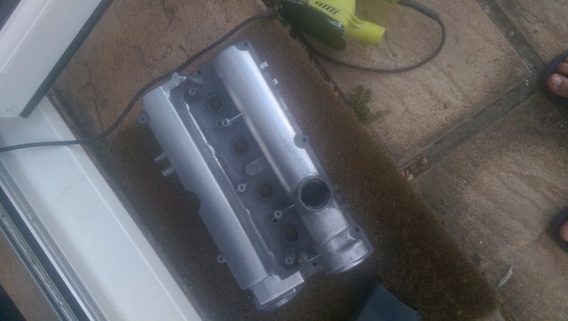

And im tarting up the rocker cover so it's nice and shiny

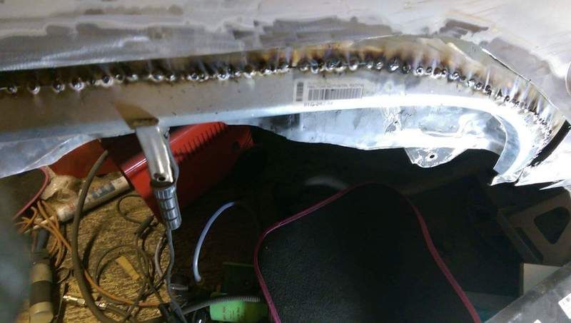

ive been carrying on welding, but it's taking a lot longer then I had hoped.
Still need to cut the circular hole for the fuel breather to go

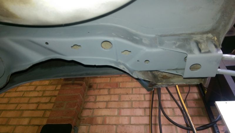

and I've done as much to the inner wing as I can until I finish were it meets the sill and the bumper end
[IMG]http://i5.photobucket.com/albums/y15...5.jpg~original[/IMG]

Chassis legs look good! Welding will be worth it in the end
It's about time I had some good luck with this shelll, but it feels like I'm making progress and getting some of the smaller jobs done here and there when I have an hour free.
