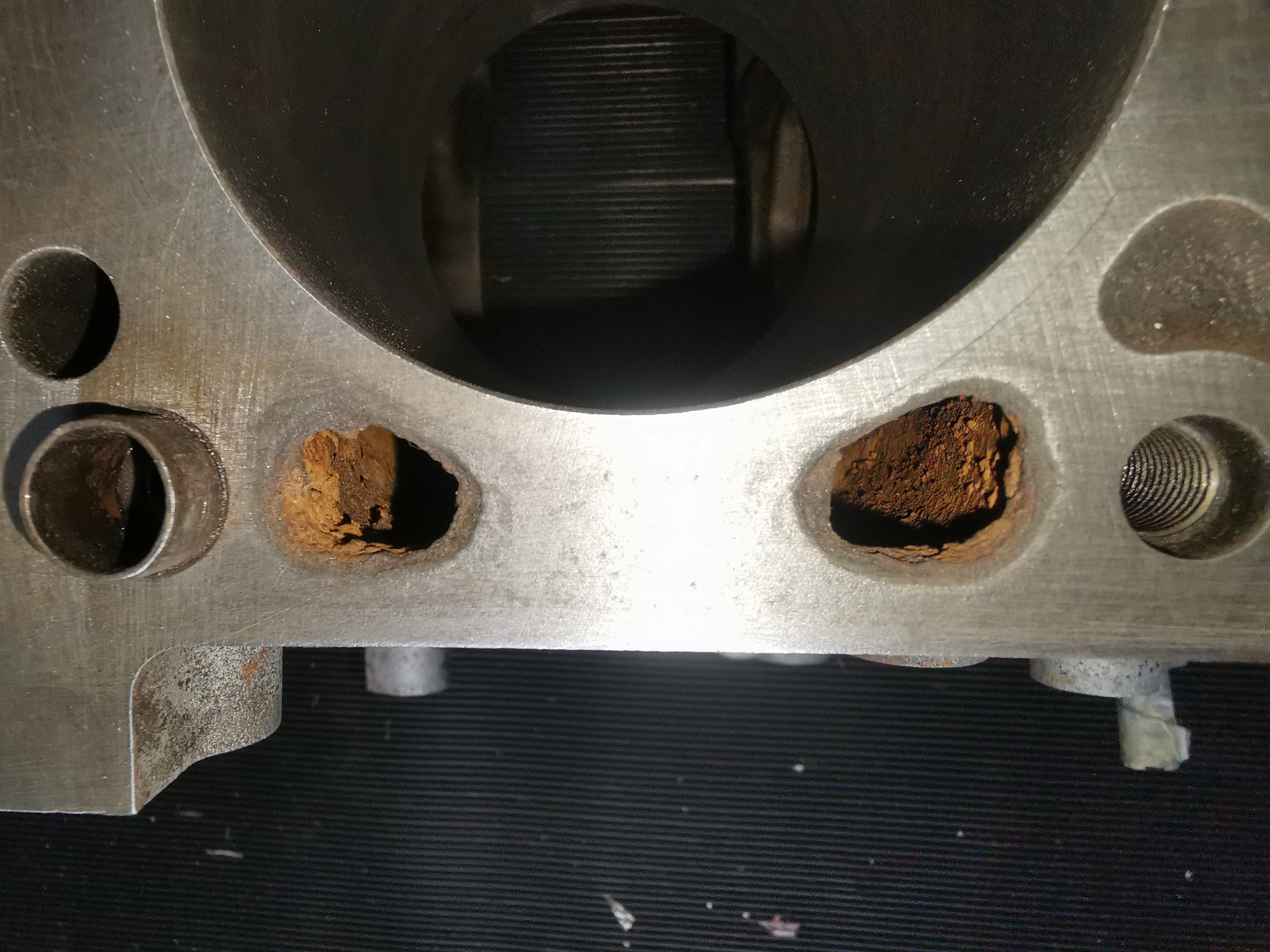

A few things have been done over the last few months to progress the project forward. First up was the block. There was plenty of signs of rusty crustiness in it, so I had to try make it better. It started out in this way:
https://images2.imgbox.com/bd/7a/Gd167dw6_o.jpghttps://images2.imgbox.com/83/2c/VSfq4Pm5_o.jpg

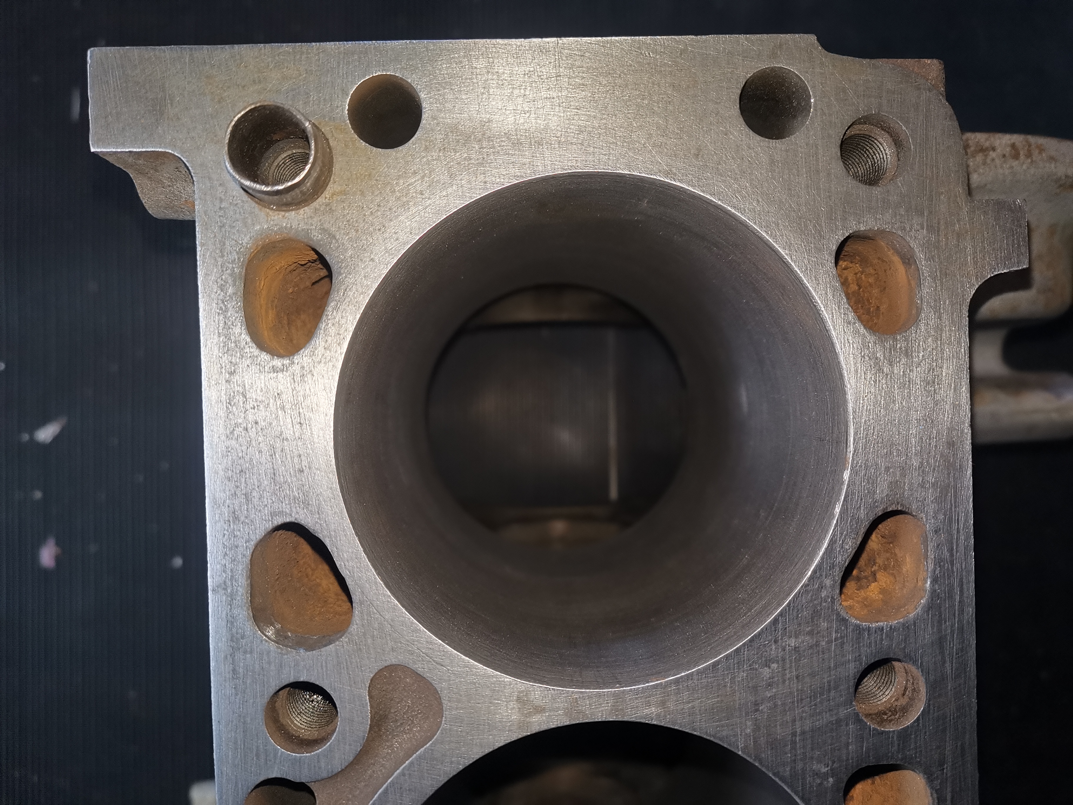

It was pretty much like this all over
https://images2.imgbox.com/c8/d0/f62WOlDG_o.jpg
https://images2.imgbox.com/c1/25/6AZgOIgg_o.jpgz
You can see the crust around the top of the waterways as well as get a glimpse of the rusty material in the block itself. Some might say leave it as is, but I'm likely to opt for waterless coolant seeing as the there is no trace of water in the system at all, it's a perfect time. Granted, it'll need a proper flush out but it's worth getting as much out whilst dry.

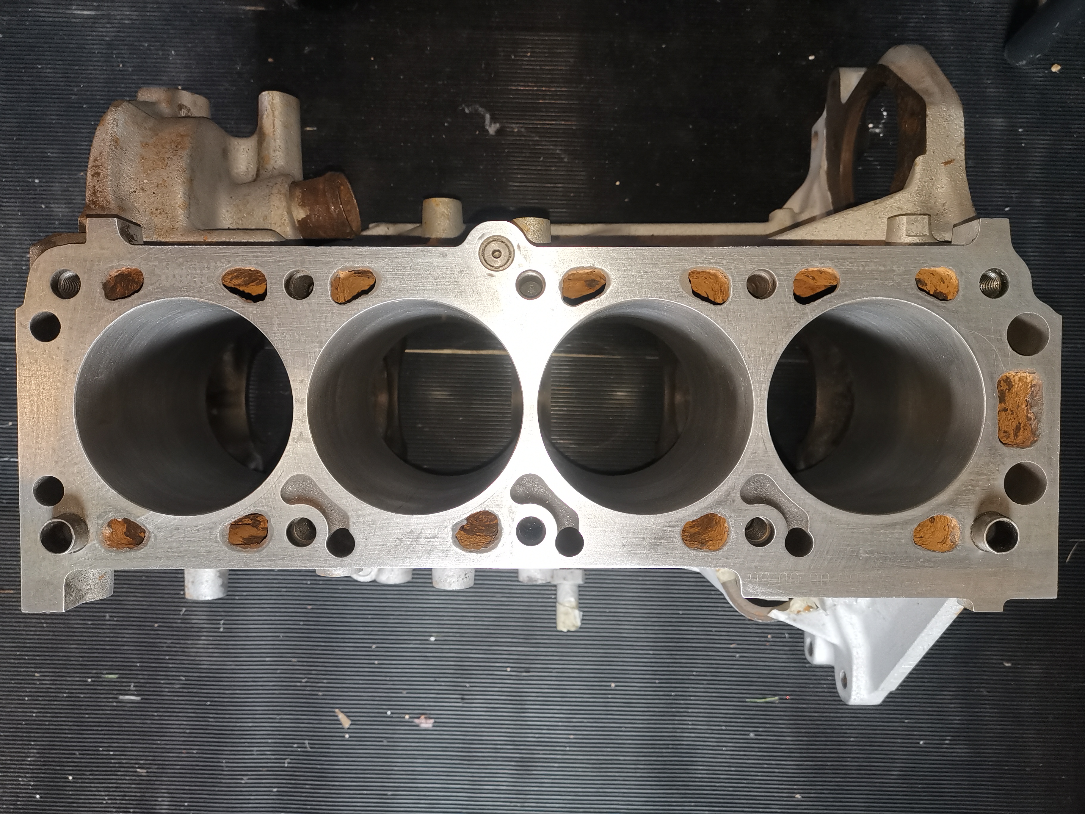

This is how it looked after a going over it with a sanding cone and the dremmel, didn't want no harsh grinding which the grinding stone would've done. Tried to get in there as deep as possible... it eventually looked like this:
https://images2.imgbox.com/7e/42/QtdHIhFf_o.jpg
https://images2.imgbox.com/92/91/Y2VRs6tw_o.jpg
https://images2.imgbox.com/bf/0b/6Ar2TZbj_o.jpg
Far better.

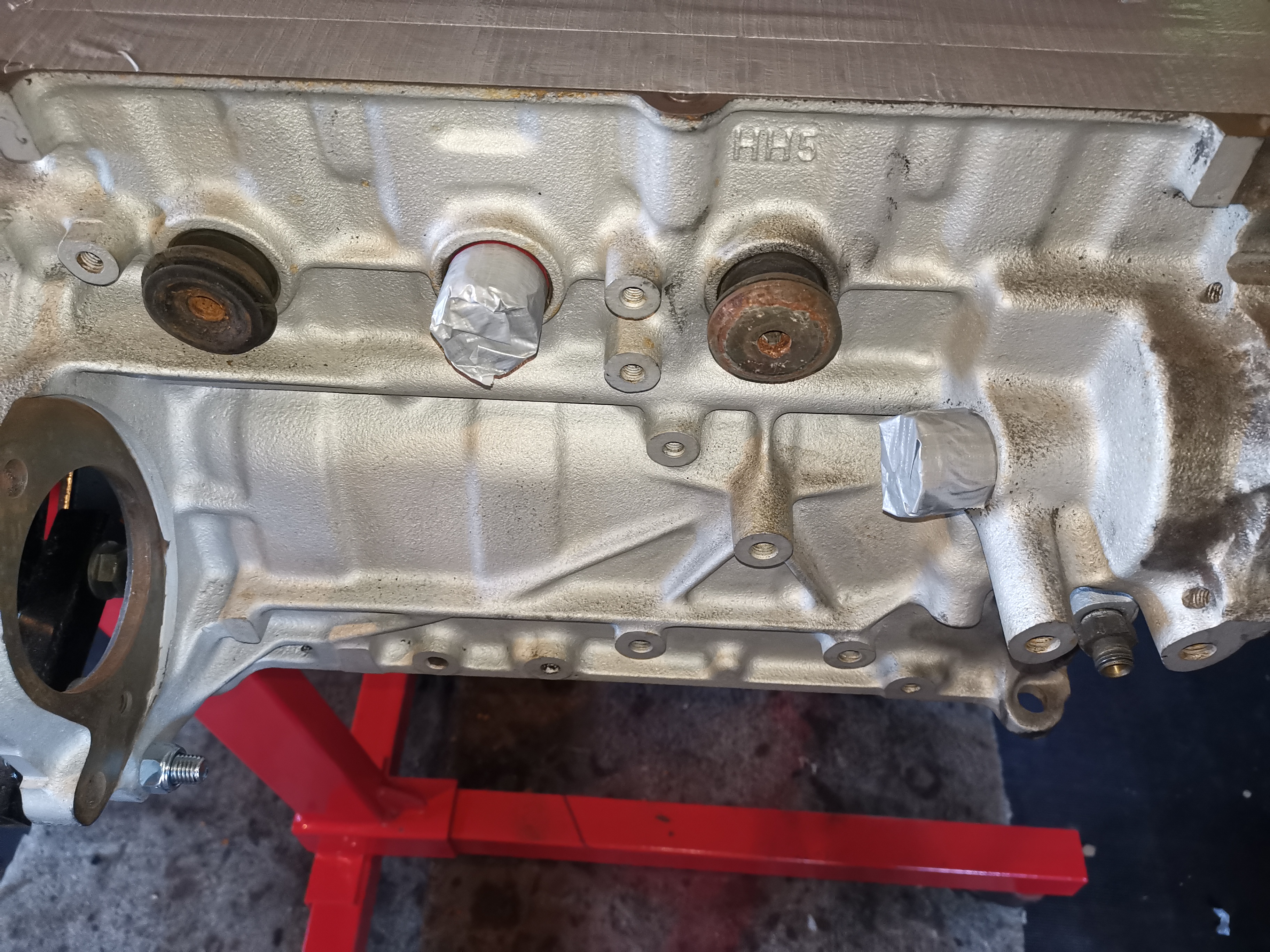

Having seen all this I had to clean it out with something, so I decided to get the block flushed with some distilled white vinegar, which most of us will know has some rust clearing abilities.
Got the block plugged up and sealed:
https://images2.imgbox.com/05/4c/ZVLT0eGT_o.jpg

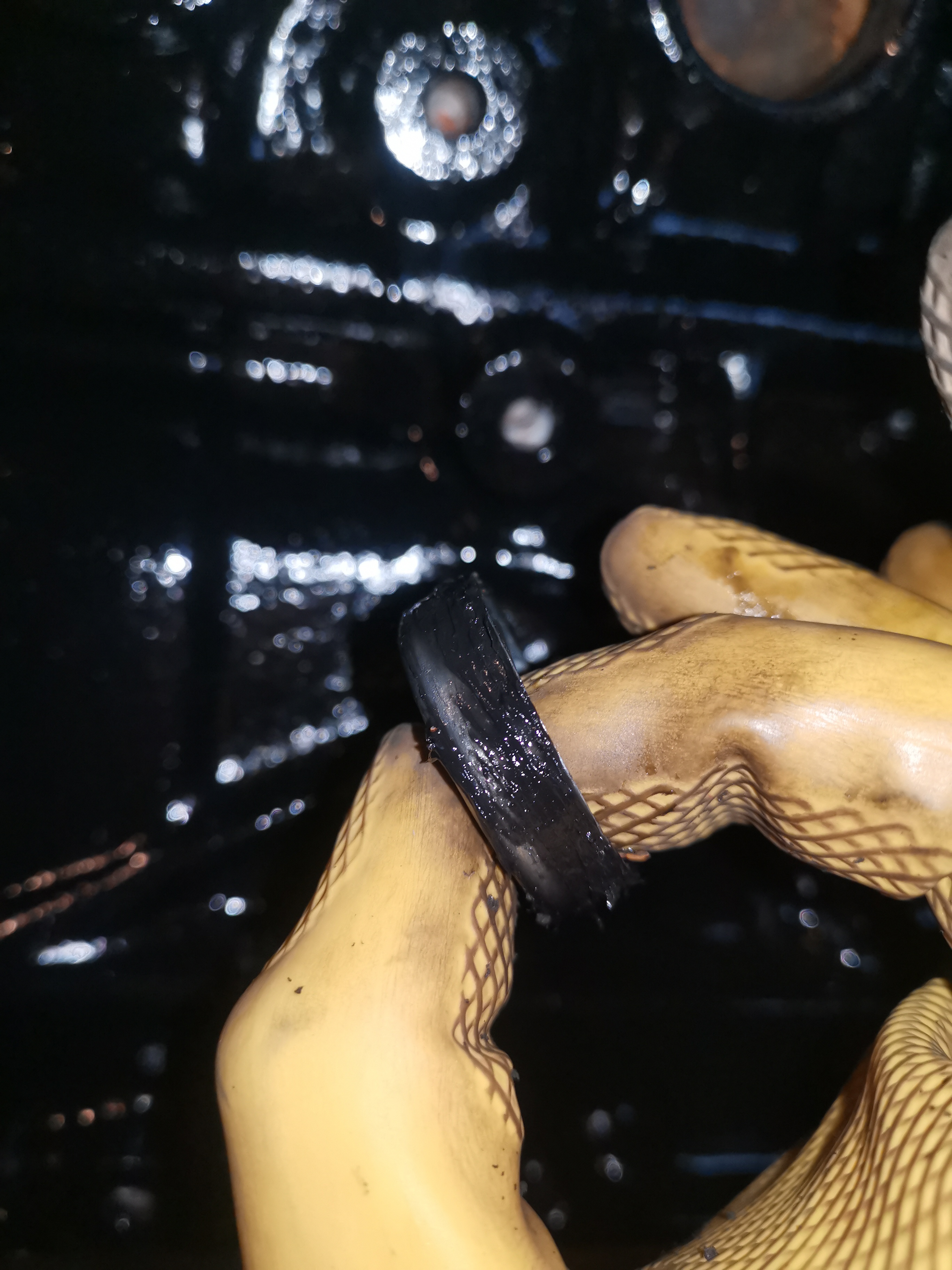

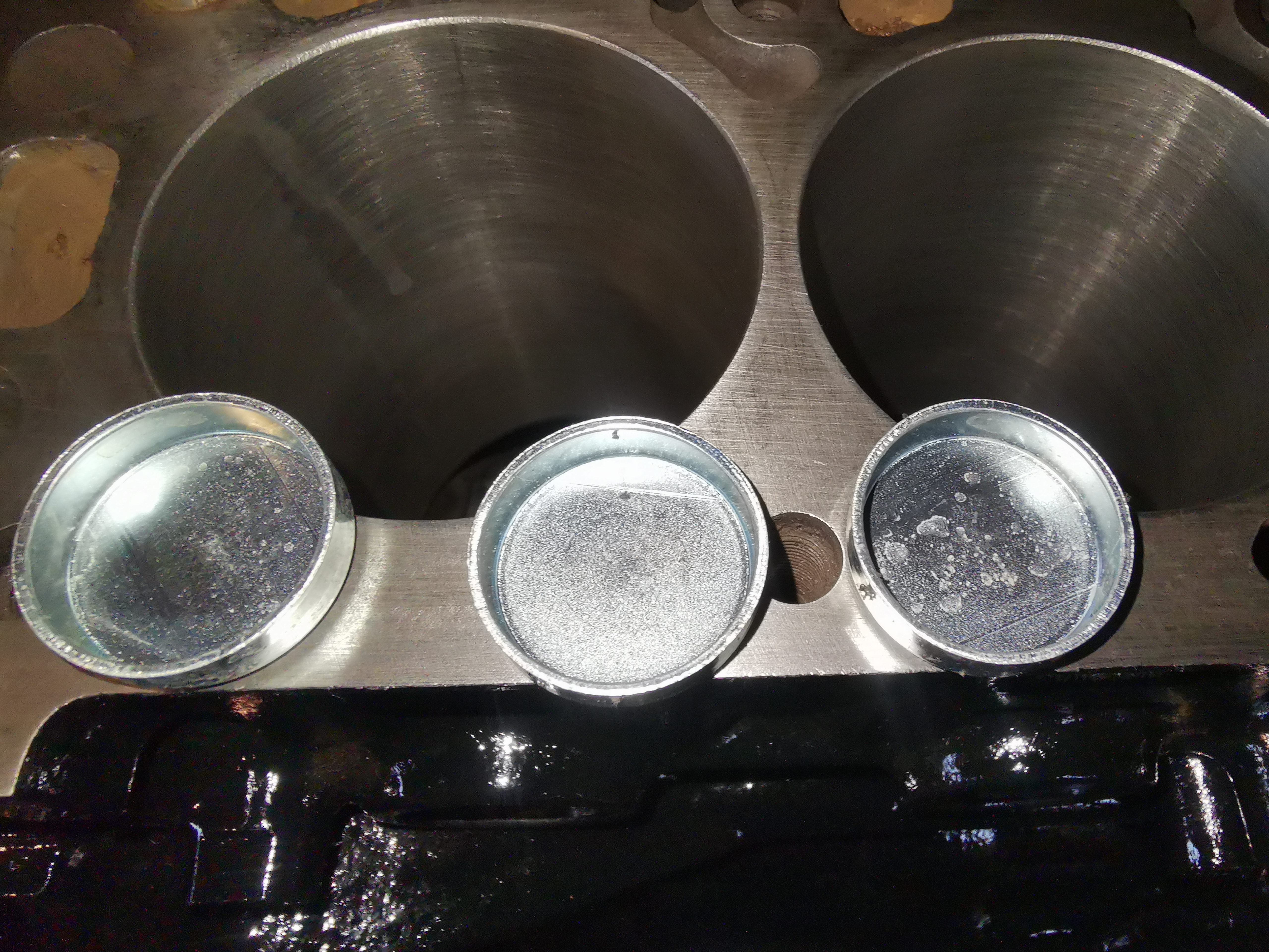

Who knew that Cavalier mk3 rear shock rubber mounts are a perfect fit to plug the block?
https://images2.imgbox.com/af/4a/ZGvnrCFh_o.jpg
Then filled it up with the vinegar
https://images2.imgbox.com/83/1b/lCKHOjyJ_o.jpg

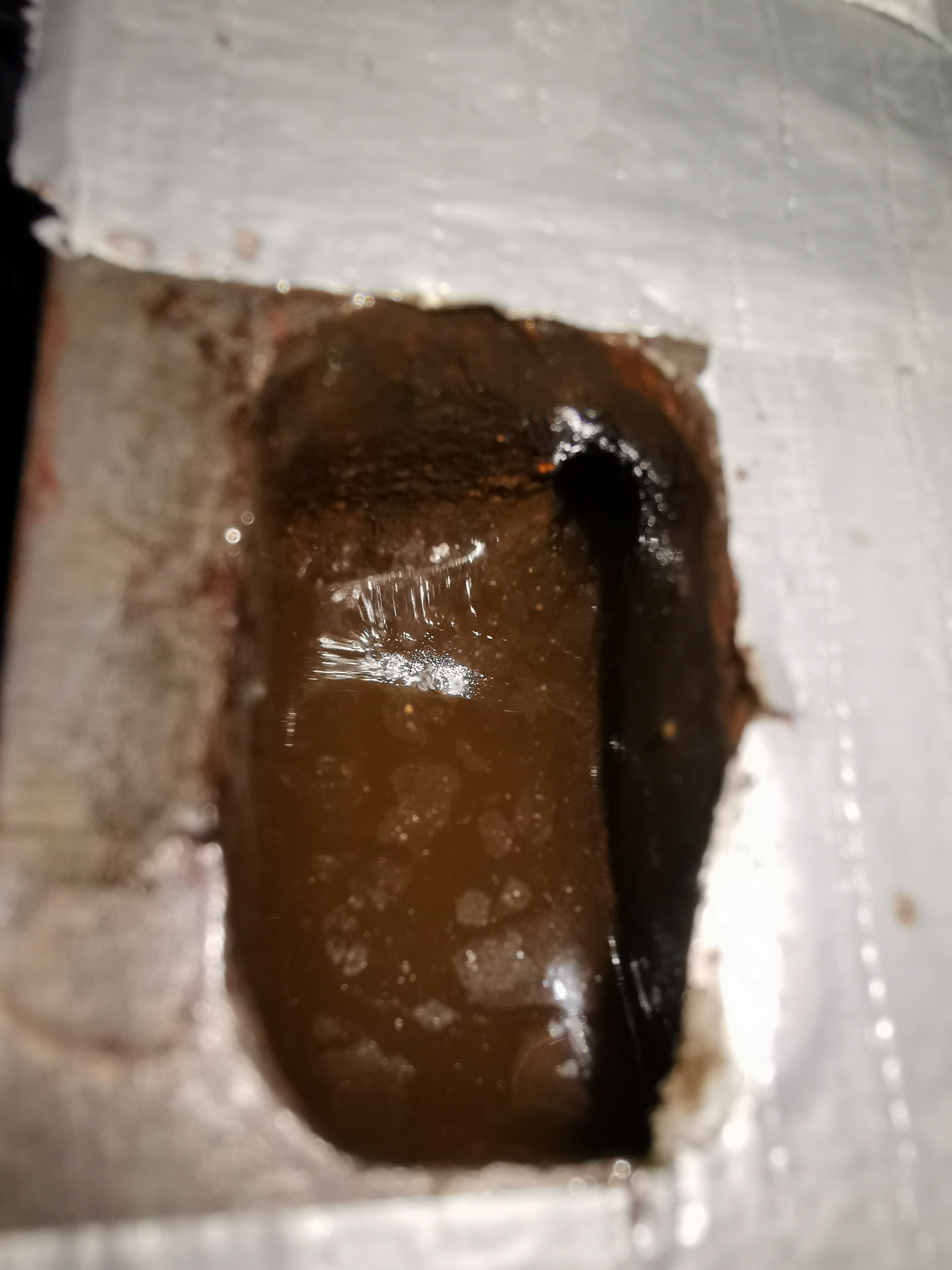

I actually left it for a couple days and emptied the block, ran some more vinegar through it allowing it to come out from the water pump aperture. Thought I snapped more pics but this was the only one I actually took... none-the-less from starting off very crusty, the vinegar dissolved most of the crust
https://images2.imgbox.com/f6/5a/KiSR9UKV_o.jpg

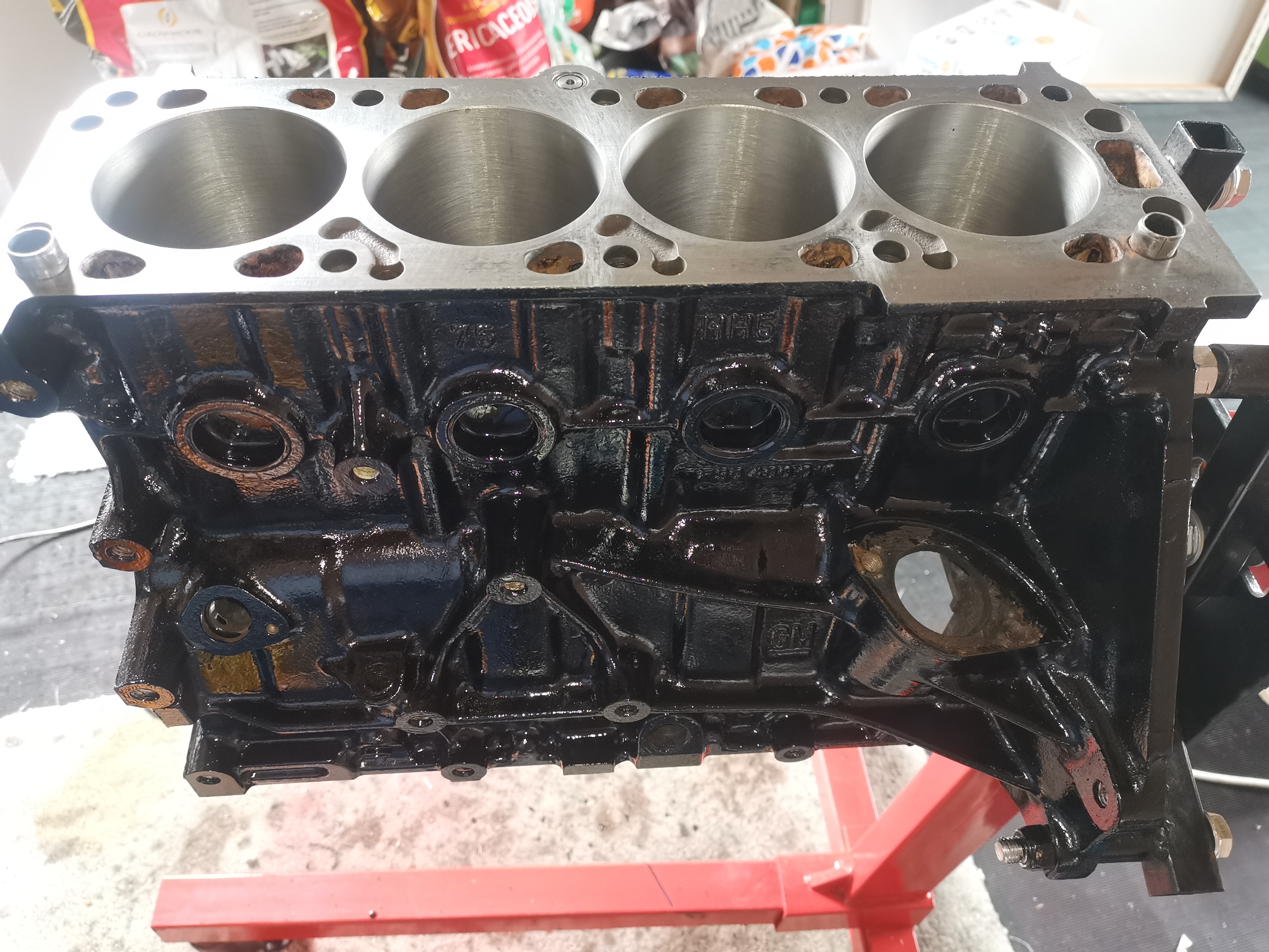

After allowing the block to dry off with the help of a hairdryer, there was a fair bit of residue on the silver paint. Seeing as it was already masked up, I thought I'd recoat it in high temp block paint, but this time in gloss black.
https://images2.imgbox.com/1d/dd/1cCBC7cx_o.jpg
https://images2.imgbox.com/8c/a9/UMws27K4_o.jpg
Certainly prefer it in black...
